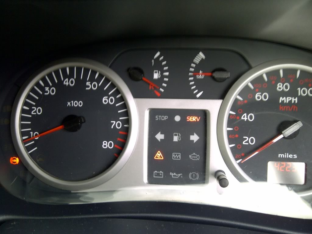

basically driving my 04 plate 182 today and the abs, traction control and serv light suddenly came on...i drove home and left it out side.. when i started the car up again about an hour later all the lights where gone.. i drove the car for a good 50 miles and no lights.. then on the way back from work they suddenly came on again.. below is a pic of the lights.. i have no idea why they would of come on then gone off.. anyone had this or know what it could be??

Just be aware you may have no ABS and possible 50/50 braking.
Pottering round town etc is fine.
Search for brake switch adjustment, that's what it was for me. Either free fix or a new one is about £15.

There is a thread on here some where for doing it.
Vasicaly there is a switch under your break pedal you need to pull and and reset by pulling he plunger out and clicking it back in to the correct position but I'd read the thread it will make more sense then. I had the same problem and this sorted it out, for free :)

Here's the guide...
http://www.cliosport.net/forum/show...w-to-alter-brake-pedal-switch&highlight=brake
If you need a new one you can buy from West's Renault or whatever his name is.
For me, I adjusted it until the brake lights came on as soon as you applied pressure, then I moved it one more click... been perfect ever since!
