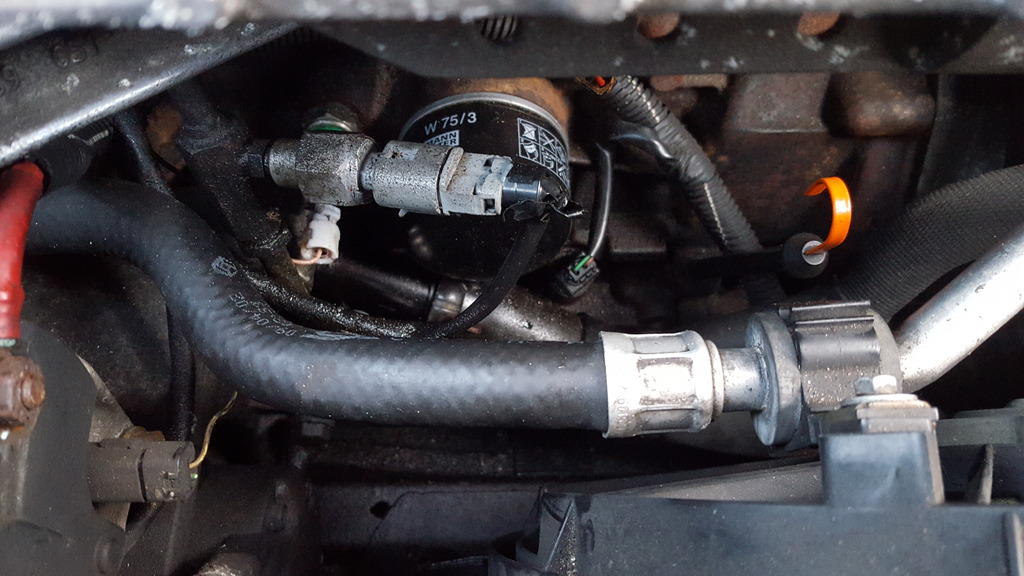

My AC isn't working, I slapped a code reader on it and had a fault for AC pressure switch.
Is this the right part? (Grey plug in the middle)
The copper wires were exposed for about 10mm out of the back of the plug which was quite alarming, I slapped some tape on as a temp measure.

That grey switch in the pic is not the A/c pressure switch , but the Power assisted steering pressure switch .
My PAS switch is next to the PAS pump from memory, unless I've got my PAS and AC switches mixed up in my head?
A/c pressure switch is located next to the left headlamp squeezed between the Rad. The small A/c pipe runs across the condenser and down to the drier . It's on that pipe .

Me being special then.
Would explain the random spare plug I had flapping about working on my mates cup a few months back *doh*
The pipe didn't look right tbh, but I was half hopeful it was the one as the wiring was kinda buggered (also it was easy access)
The AC pressure switch is down near the AC radiator i'm sure.
