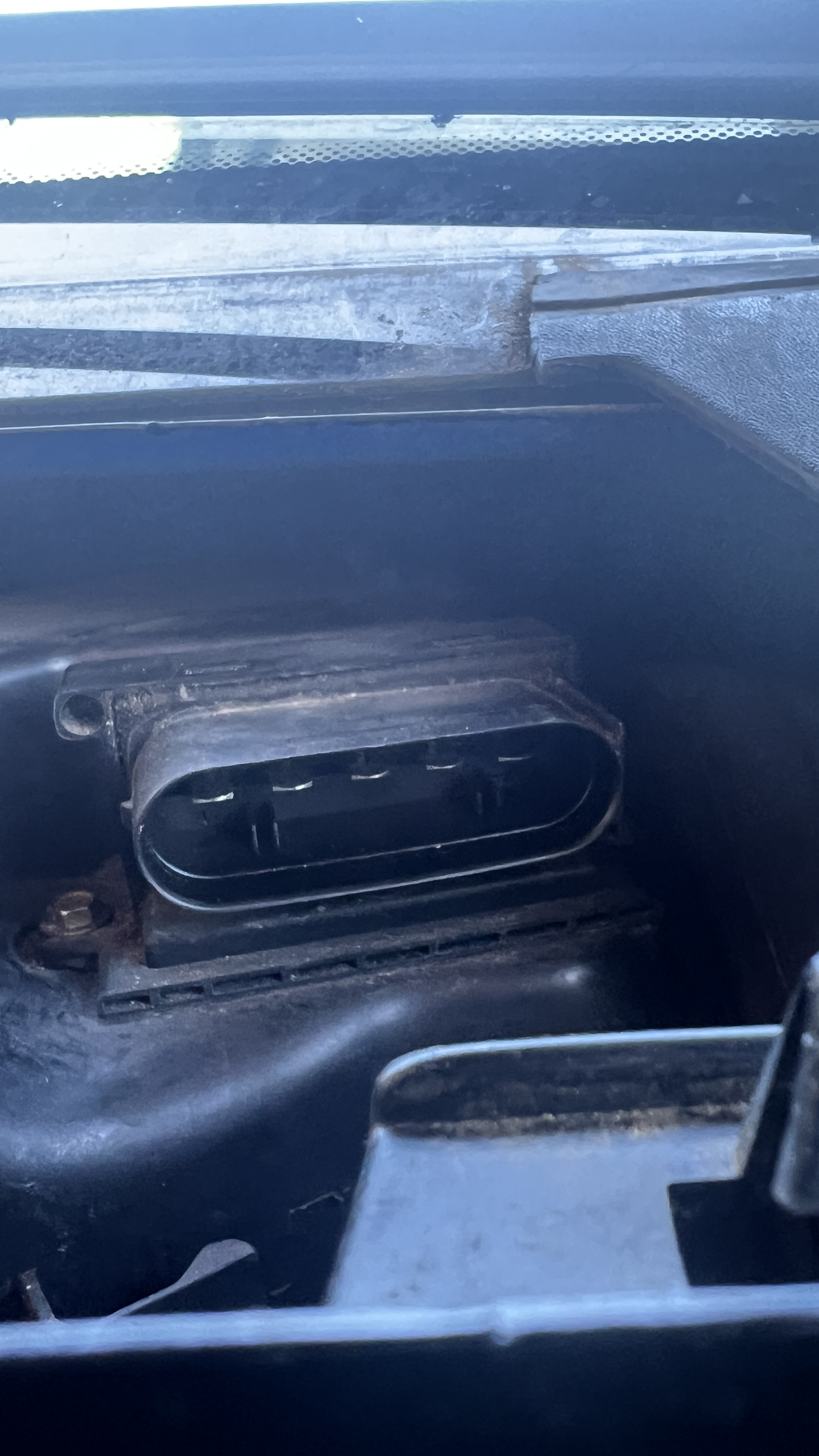

I put the new resistor pack in this morning assuming that it would fix the problem, however it did not. I tested both the resistance of the new and original resistor packs, and these are the measurements I got (I had the red lead of the multimeter on 'prong' 5 - furthest left- and tested the others with the black lead) See image 1. Original resistor pack: Prong 4: 1634 ohms, Prong 3: around 1500 ohms but different each time and only flashes up before going back to 1, Prong 2: between 1400-2000 different each time and then quickly back to 1 again, Prong 1: 360 pretty stable and stays on. New resistor pack: Prong 4: 1728 ohms, Prong 3: Between 1400-1900 ohms different each time and quickly back to 1 after flashing up, Prong 2: 1600-1800 and again different each time and only flashes up, Prong 1: 390 pretty stable and stays on. In my eyes some pretty strange things happening, but they seem to be pretty similar between the new and old resistor packs, so I deduce from that, that the resistor pack is not the problem.

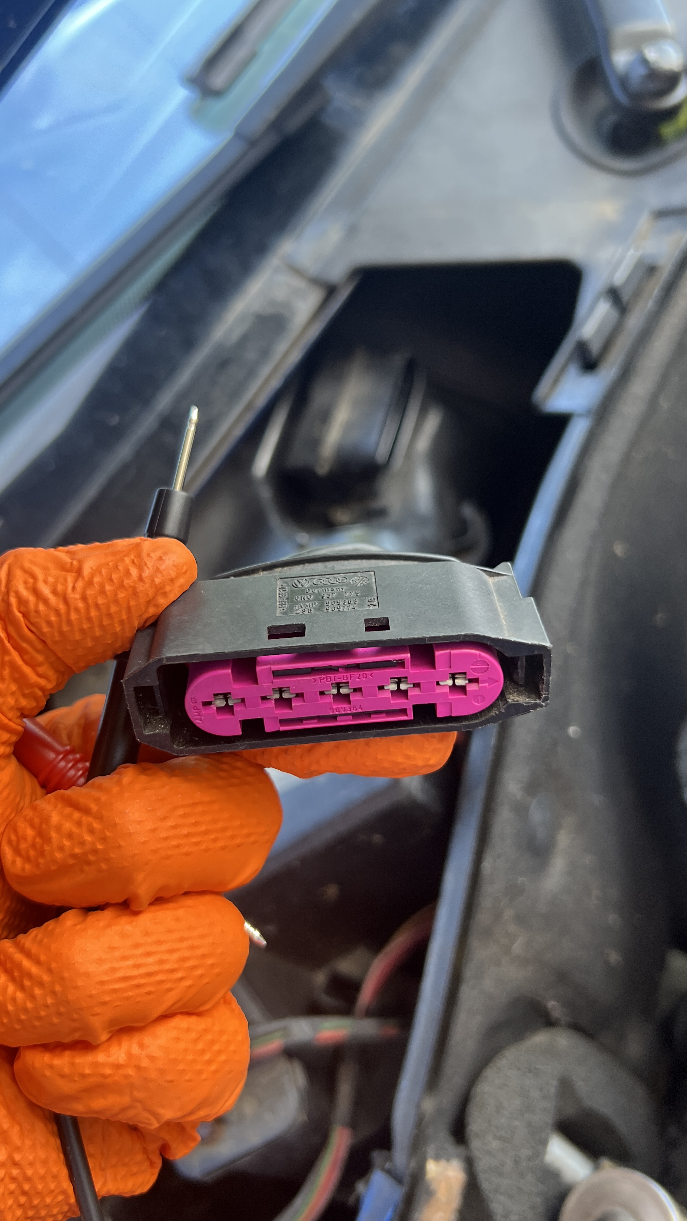

Next, I checked the pink plug that connects to the resistor pack with the ignition on and blower on max and had the black lead in 5. 4: 12.4V, 3: 0V, 2: 0V, 1: Goes down as I check it? Not sure what's normal with that to be honest.

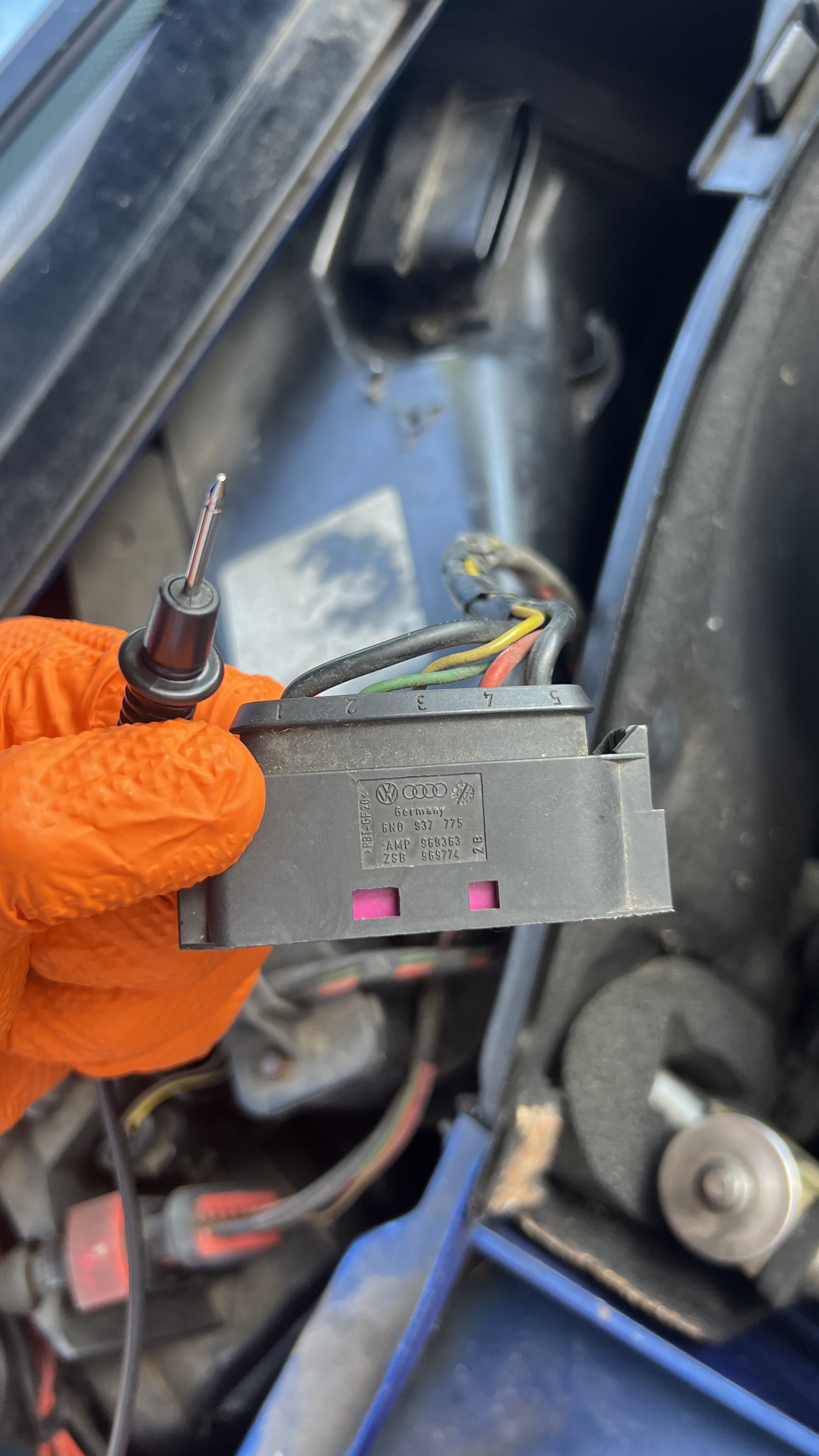

I then checked the small connector with the brown and yellow wire coming out of it, which had 6.4V, which doesn't seem abnormal to me, but again I don't know much haha.

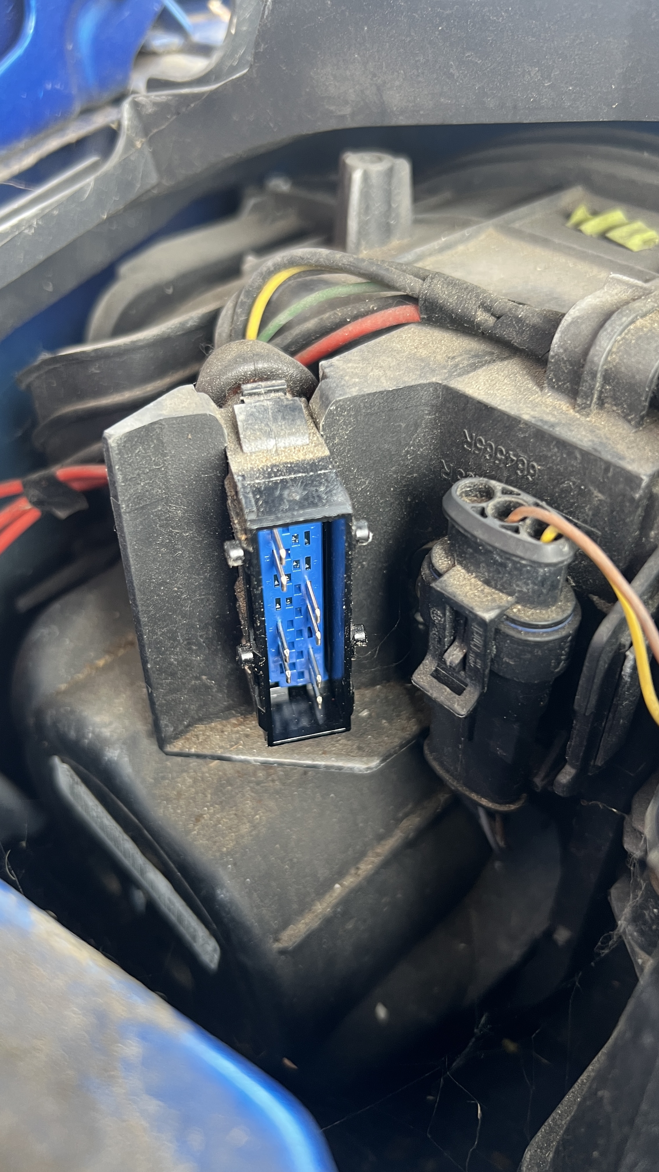

Then checked the resistance of the blue connector, which I think would tell me if the fan motor is good? I checked each prong 'couples' and had less than 1 ohm across it, except for the couple which is middle right in the photo, which was an open circuit.

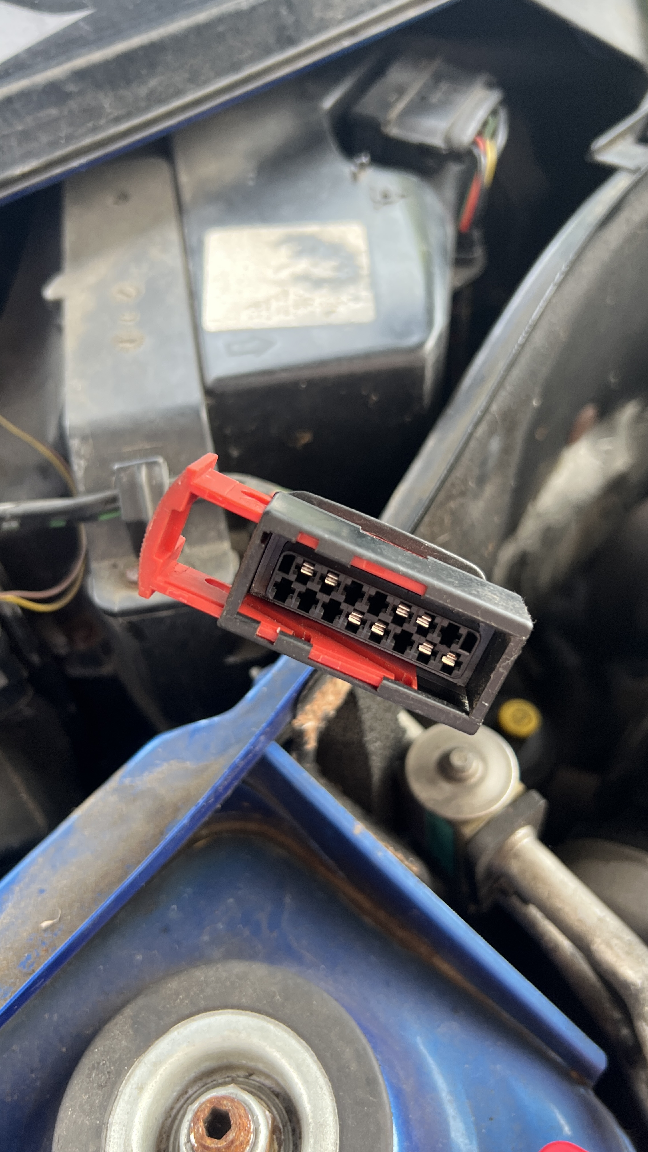

Lastly, I checked the plug which went into that for voltage, and had some which had 12V, some around 6.4V and some which had 0.
