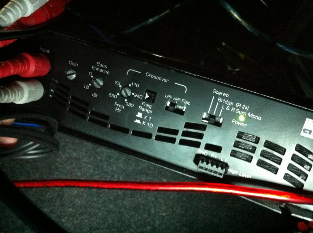

Current settings on amp found: I think the frequency is pointing to 55
Sub is a Vibe space SQ 900w. Thanks.

Also, you have the amp on bridged? rather than Stereo, unless your running your speakers on 2 amps linked together than you need to switch it across.
Your Freq range button looks pushed in on x10. And you'll have to tune it in rather than guess what to set the dials in.
Ok so I'll switch it to bridged yeah? I haven't got a clue about the amp
Settings, only the sub runs off the amp, I think the button is pushed in so x1?

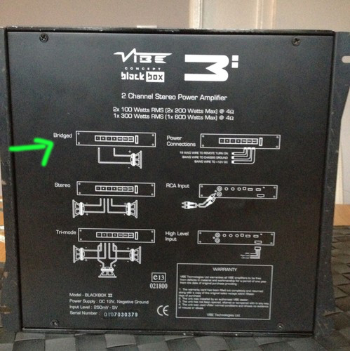

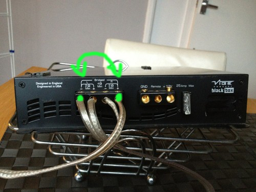

Just the sub wired into the amp, but i followed the instructions on the bottom of the amp and bridged it I think? so should it be in bridged?
Tbh Im not sure if the bloody thing works, sounds rediculous I know sometimes I can definitely feel it working but others it doesnt, I need to get testing at the weekend.
I've read to set my headunit volume to 3 or 4? and do something with the frequency whilst the bass is on 0. I think its either set up wrong or the amp is fucked.
Nicked this picture and re-hosted it, connections are highlighted in green for the sub.

After that I tried to set the gain and frequency on the amp, still after advice I didnt really know what I was doing but I found an old 'Fast Car' (dont laugh ;)) cd with different frequency tracks on. Turned up my head unit till it started to max then back down a bit, with that playing I started to bring the gain up, 0 was around 11oclock, and I settled for about 3oclock as a setting. I left the button on x1 because x10 made a weird high pitched squeal, setting was left on bridge and LPf, If i switched it to anything other than those again I got a high pitched chugging type sound. I left the bass on 0 and the frequency 'seemed' good at about 110.
Sound about right? music sounds 10 times better now.
  2003 1.2 billabong
sounds about right to me fella, one thing you could do is set your hpf to 50 or 80hz to save some power to make the midrange more clearer
