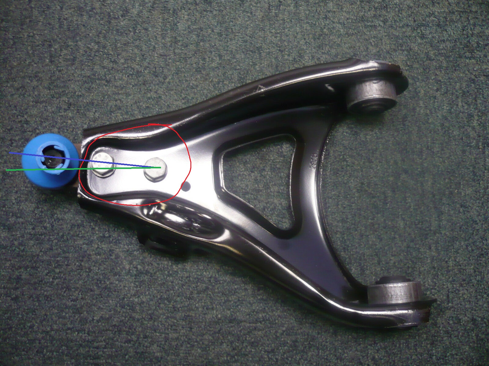

You might have the older wishbones, if you can have a look at the lower bj bolts you can see which one you have. Blue is the new one but I dont think do as you have 1.5 on one side.
Ah yes, i remember fitting cup wishbones to my 172 back in the day! seems like a good mod to do anyway if it's not done already!
mucking around with wishbones will be more expensive than the £60 it would cost for a pair of metric springs.
The other way - modify your top mount position and move the mounting backwards
I mean just the newer factory wishbones not modifying them, you sell them and someone left a review about them being increased caster :)

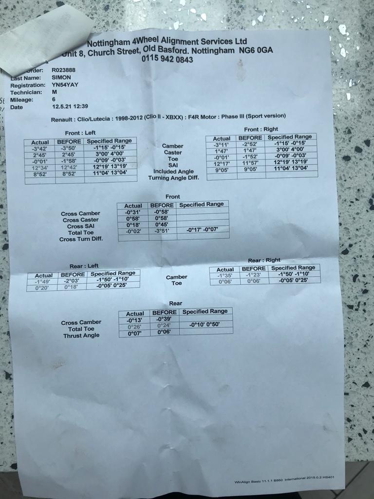

Ah ok. Monday I can get the printout of my car on newer dampers and max caster on the top mounts

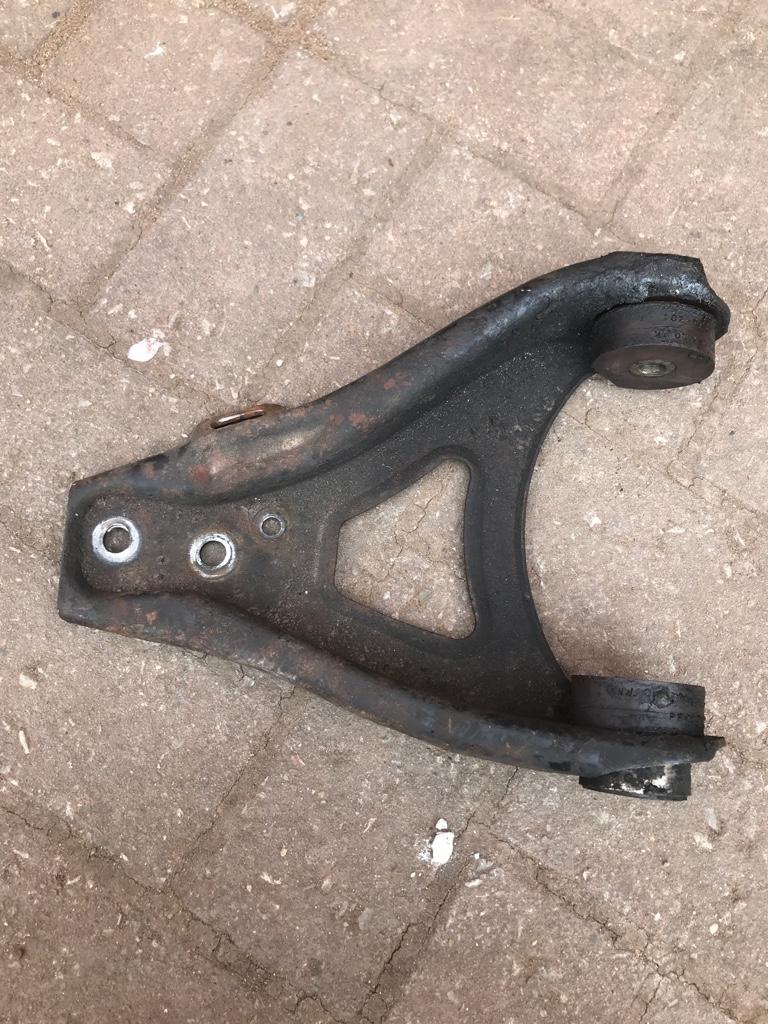

Looks like my 182 has gained some non cup 172 wishbones at some point in its life, how strange!!
At least I can remove the poly bushes and just buy some knackered cup ones then refit my bushes I guess.

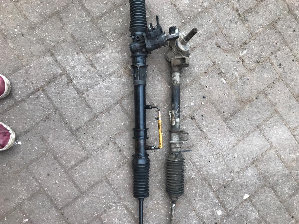

Can you source a manual rack? The wishbones and the rack should solve most of the problems.
The car came with one, the previous owner just didn’t fit it!
Need to work out how to fit it now, the mounting points seem a little different?

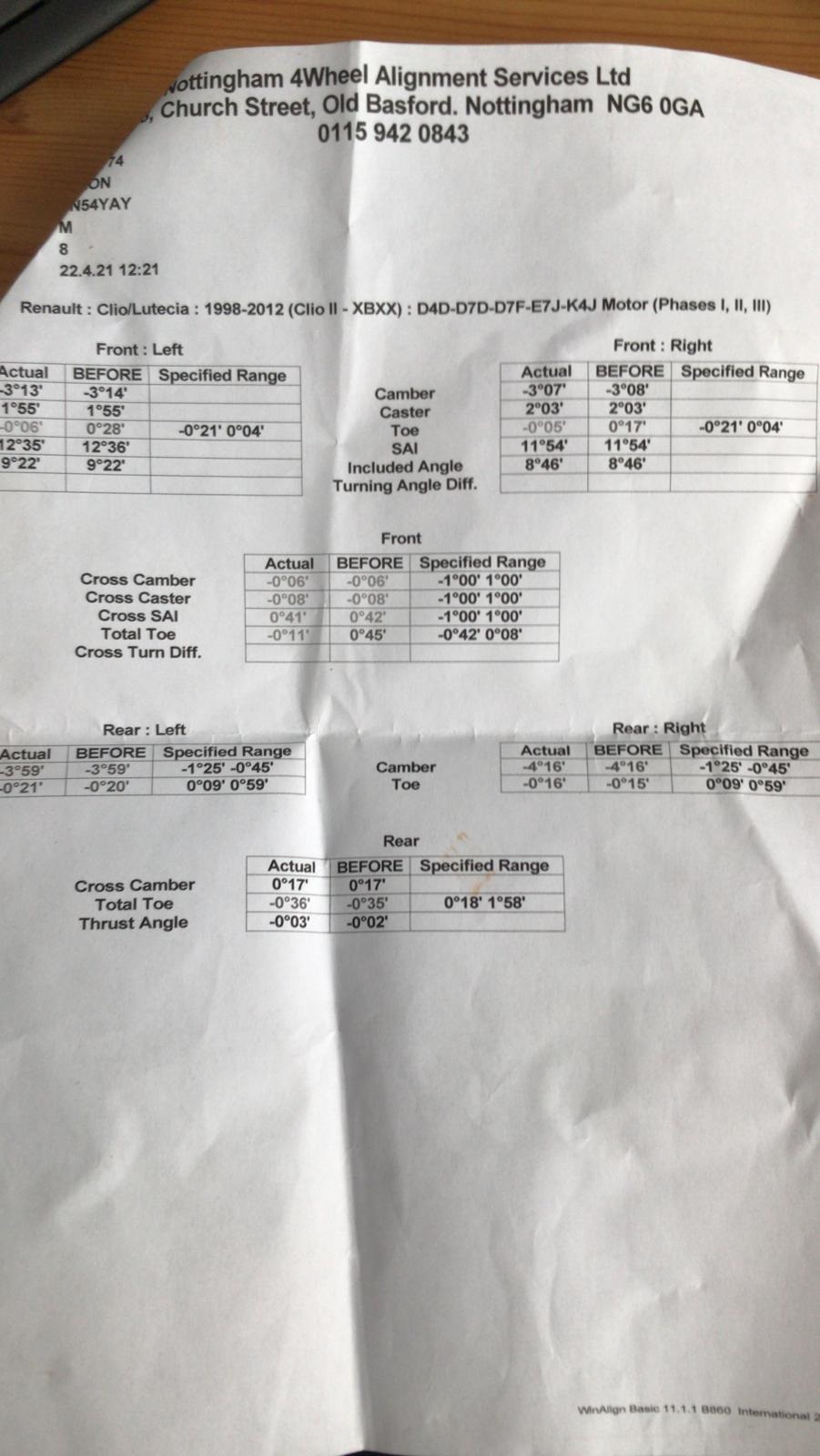

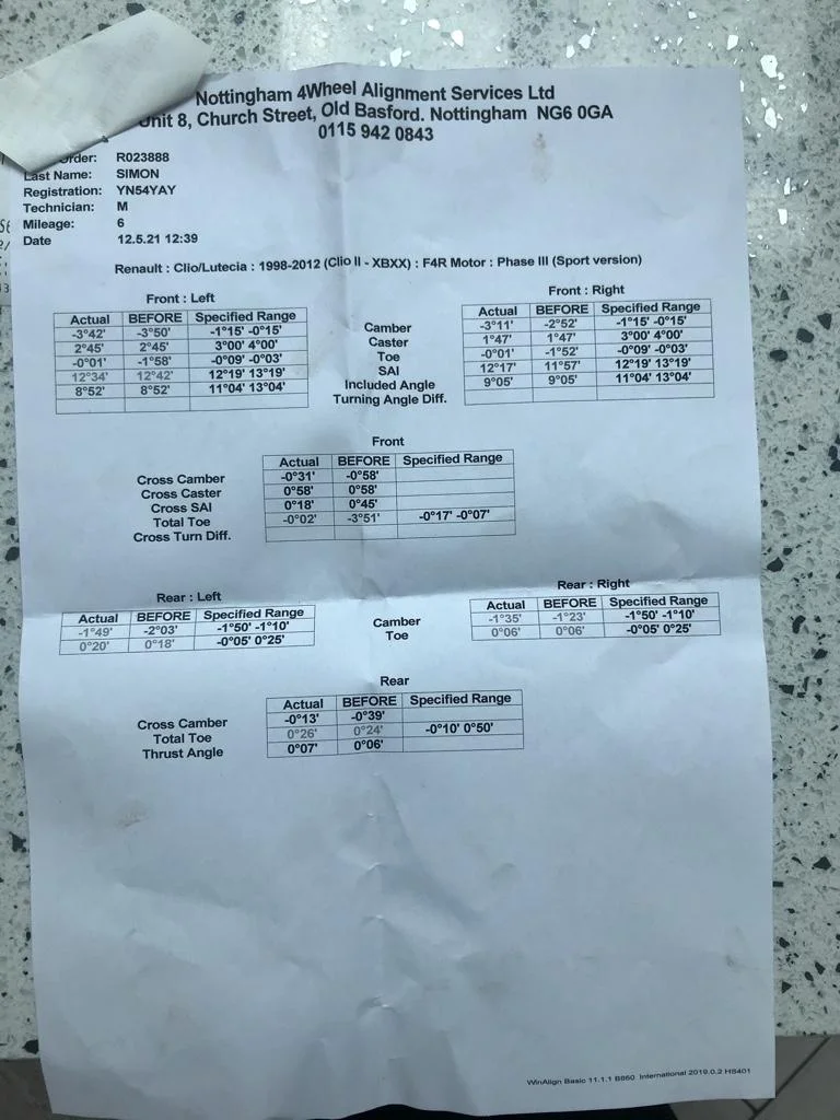

Bit of an update though a slightly disappointing one.
I replaced the steering rack, tre’s, ball joints, drivers side driveshaft and the wishbones with the advanced caster ones plus the pure motorsport subframe fixing washers/inserts.
I’ve managed to gain a bit of caster on the passenger side but the drivers side isn’t looking great :(

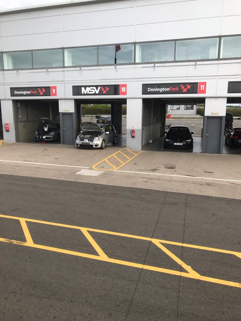

It’s on track at donnington tomorrow evening so I’ll find out how it feels then but I suspect I’m either going to need to swap the subframe or add adjustable top mounts.

Yeah I put the ones from the for sale section on here with power flex black series bushes!
Will have to see how it handles at donnington then consider a alignment check somewhere else before tweaking other bits of the setup

Well the results are in and the changes made a huge difference!
The car is very happy turning both left and right plus the steering is a lot less vague with the manual rack fitted!
Only negative is I managed to knock the steering out of line somehow, probably need to be less aggressive on the kerbs [emoji56]
Thanks for the help along the way Zach it’s much appreciated.
