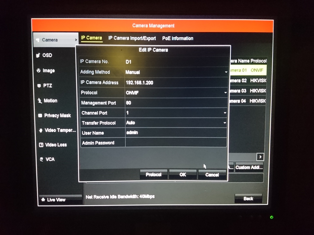

ok just received a hikvision ds-7600 and its like rocket science trying to get a camera to work.
so the camera isn't a hikvision camera
the wizard doesn't pick the camera up when I do a search
and when I go here again cant get it to see the camera in port 1
manual is utter crap, what to do now?

What camera have you got?
If it's on port 80 I'd be changing that to something like 8000 first.
Enter IP, user name and password

sadly it looks like my oldest ip camera wont allow me to change its IP address.
the hikvision is 192.168.254.1
my ip camera is 192.168.1.1 so the hikvision wont pick it up
time for a new purchase I think

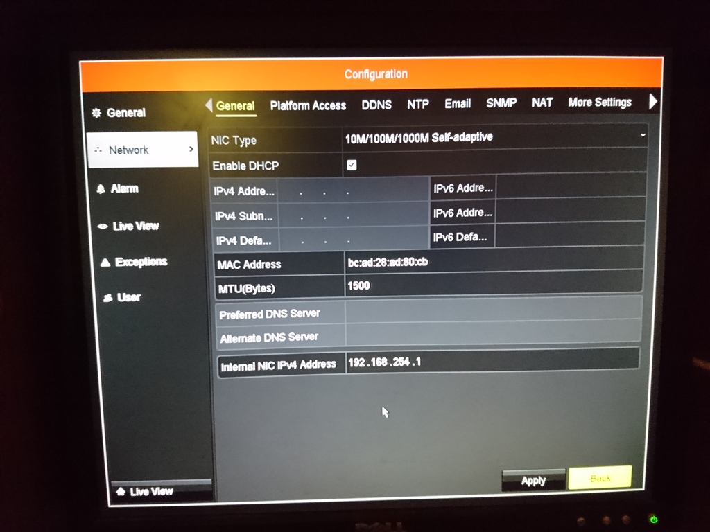

Did you set that IP of the NVR.
That's usually the IP address of cameras that go directly into the NVR and not sit on the network.
Need to set your NVR IP to match your other IP address so I'm guessing 192.168.1.*** and set gateway and DNS to your router which I'm guessing is 192.168.1.1 or 192.168.1.254
Is camera plugged into rear of NVR or a network switch elsewhere?
Let me know!

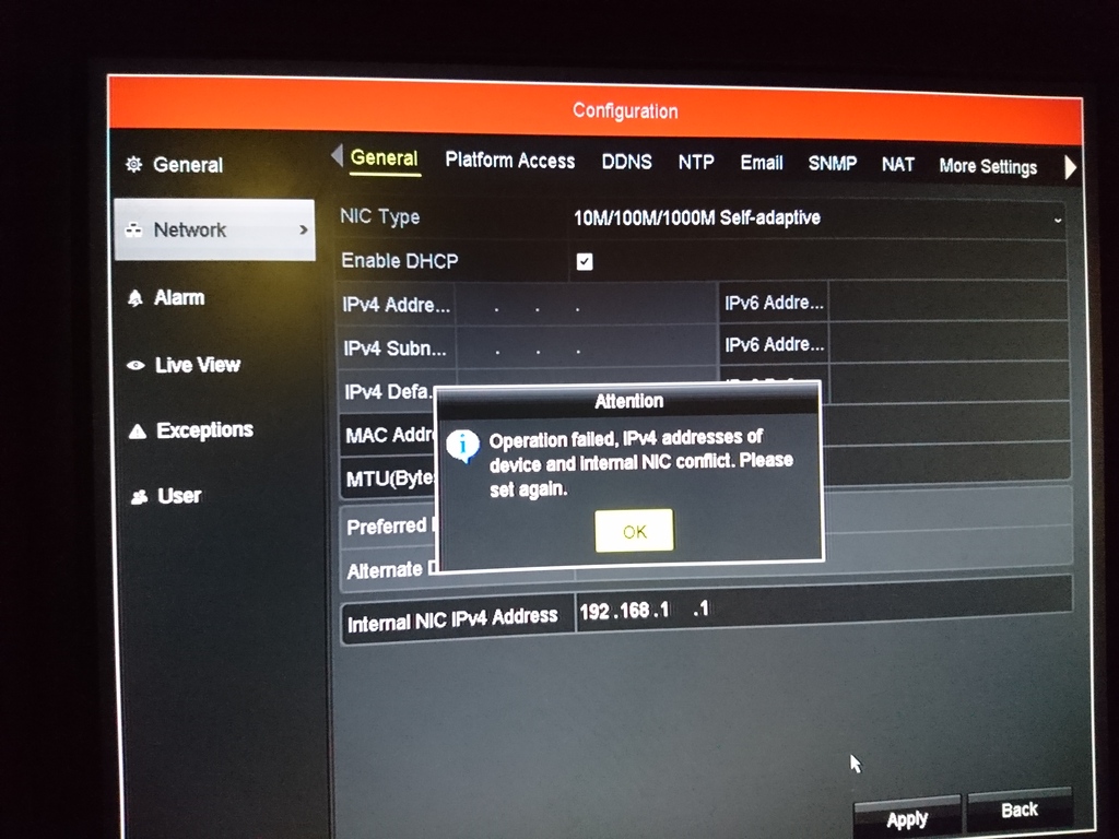

no
i did try to change ip on nvr but it wouldnt let me, it kept coming up with an error. ill post a screen shot when I get home.
all my cameras are on 192.168.1.***
cameras are plugged directly into the back of the nvr.
not connected nvr up to bt HH yet
  DCi
254.1 wont talk to 1.1
you probably need to either
-set them to all 254.*
-or 1.*
-or set them to take addresses from your HH DHCP (and probably give them reservations so they always stay the same)

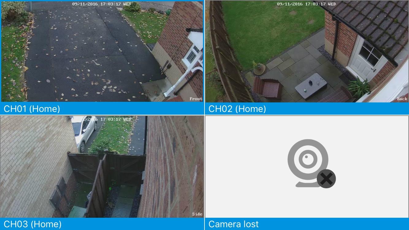

I've learnt they won't talk ;)
I've changed one camera to 192.169.254 so that's working, another I've not got round to doing. And my third I can't change the ip address on.
But if I could change nvr to match cameras then all three would work, I just couldn't work out how to do that on nvr.

so when i try change internal nic ipv4 address I get this, no matter what address I use
If it's a home network can't you just change your subnet mask to 255.255.0.0 and then you should be able to share the .254 and .1 address space?
