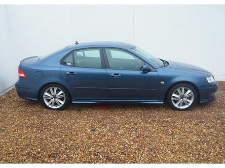

Oh and the car is a fusion blue saab 9-3 aero that I would like to get it looking it's best and keep it that way.
