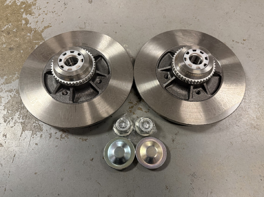

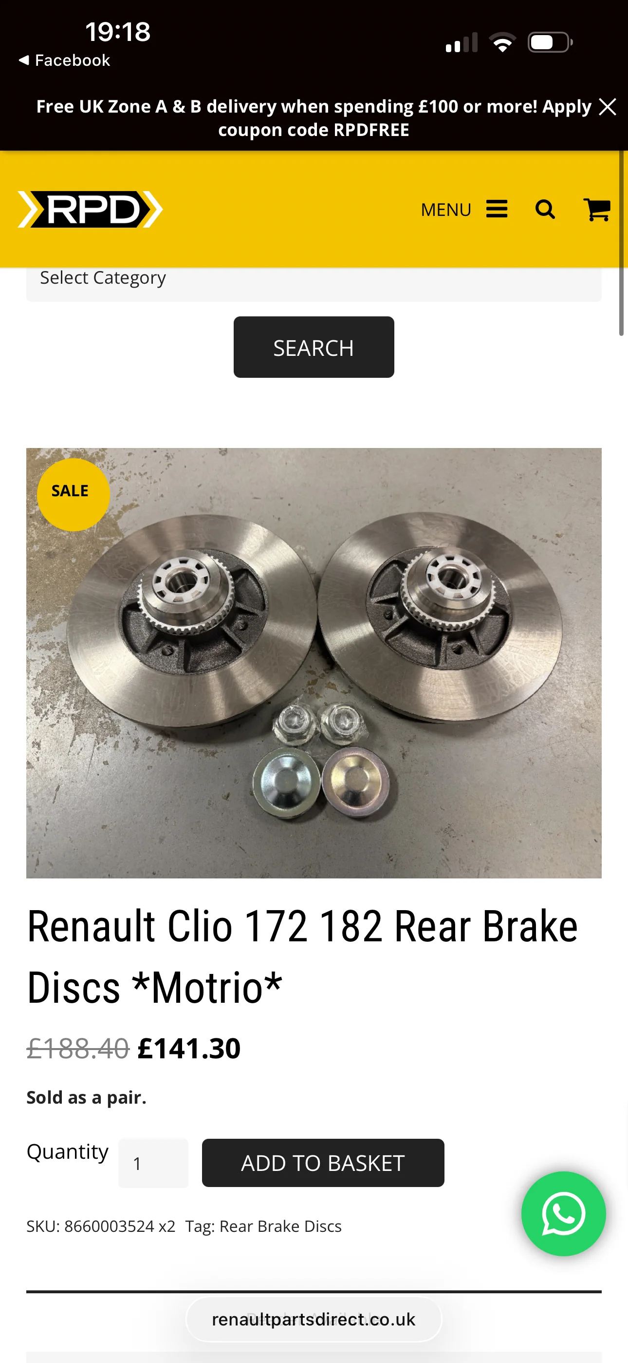

I'd go with rear discs with the bearings already in place, so much easier than trying to press a bearing in etc. Fronts and rears I would go with Brembo which are a decent brand and good value, if you go too cheap on the rear the bearings will be rubbish. Just remember to put the spacer/washer back on when you do the rear! Also the rears will need the ABS ring on as you have a 182.

Pick a set of rear discs with bearings in, oem renault is best for them if available.

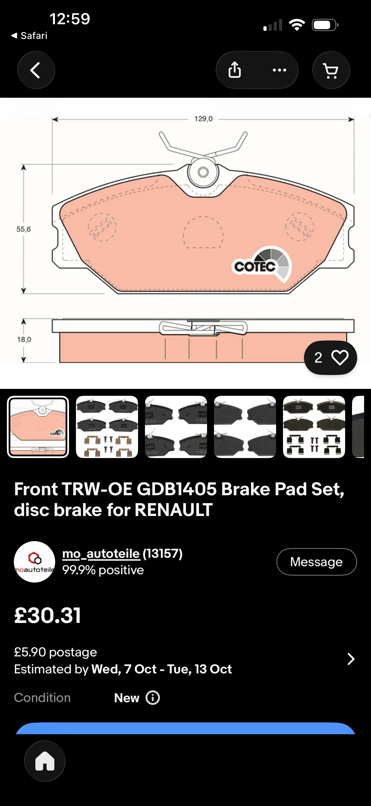

Get these front brake pads.
