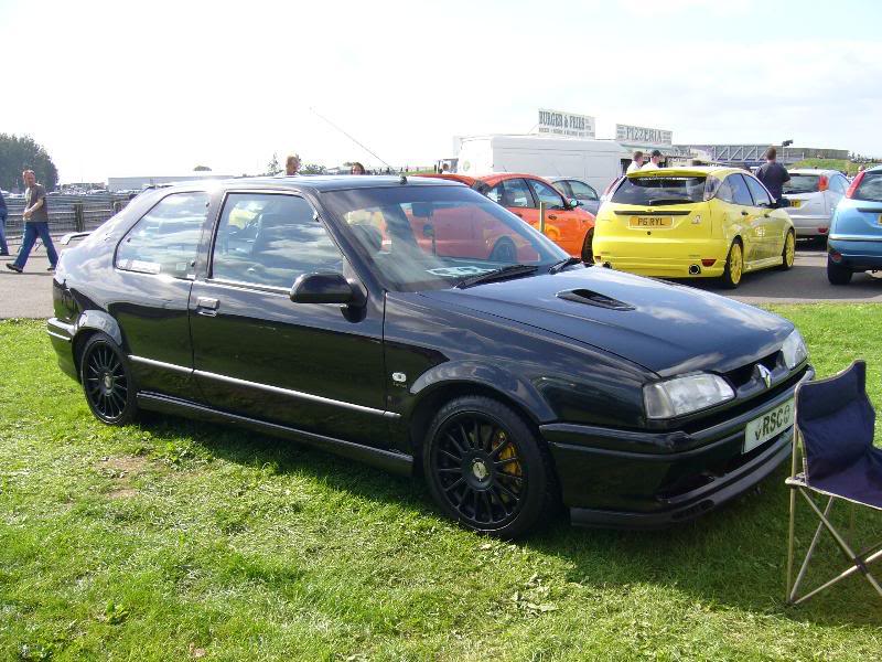

I had these:

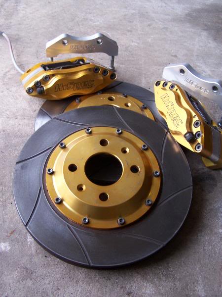

On this:
... below 30mph it was annoying but maybe it was because the HiSpec setups use a Volvo pad(?)
