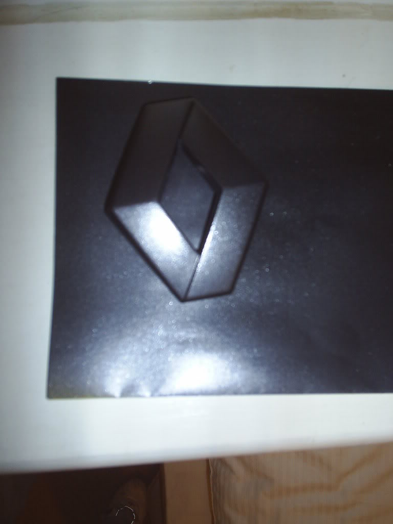

Thanks for the advice, photobucket has killed the quality but a couple of pics...

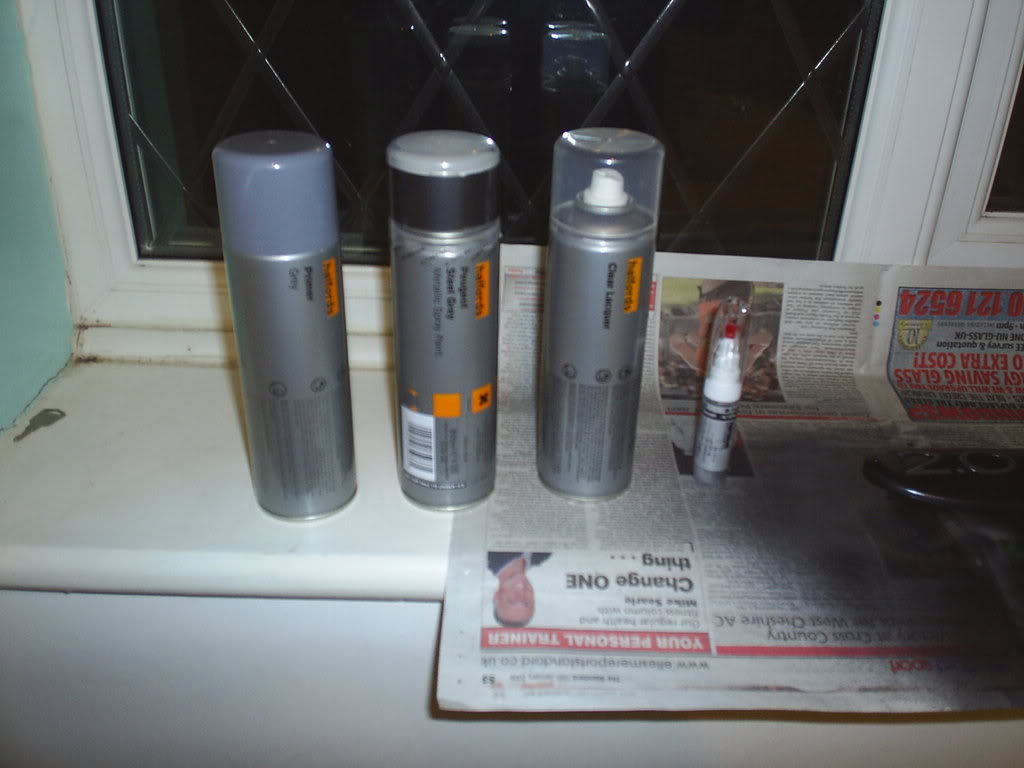

Items used:

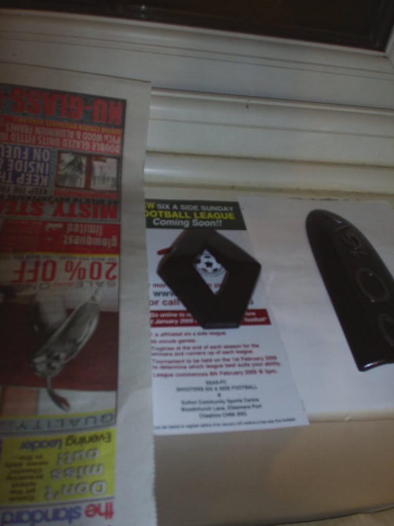

Painted Diamond:
Lacquered up Diamond:

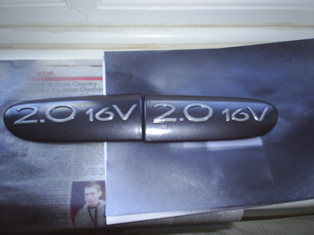

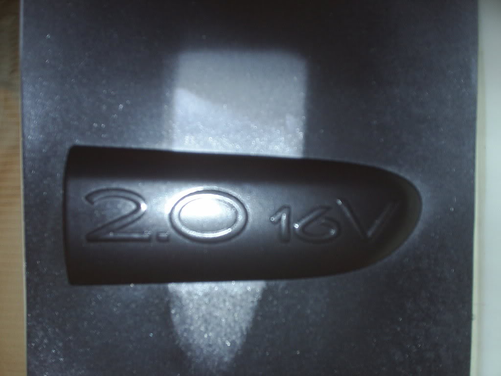

Painted Bullets:

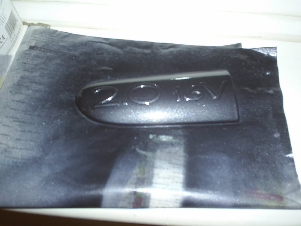

Numbers done:
Lacqured:
(Pic of other one lacquered hasnt come out too well).

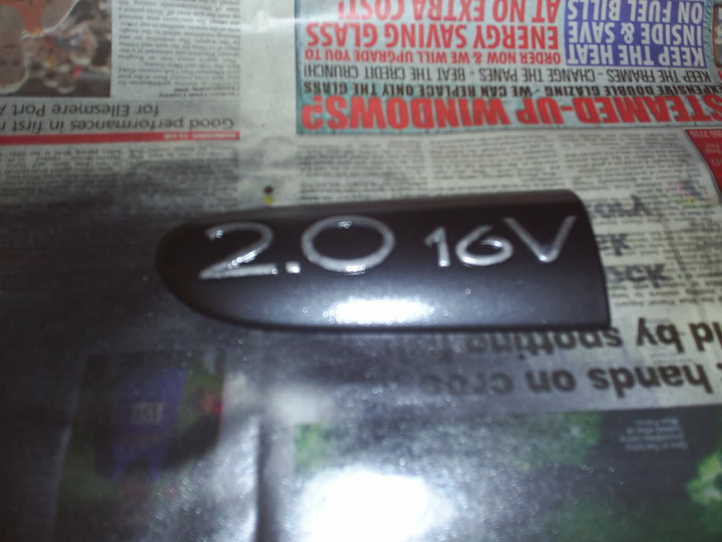

Pug steel grey for the main colour and aluminum generic colour for the numbering.
how did you do the numbering? brush?
In the first pic the little touch up pen - this has a fine nib on it and i used that. Tbh it doesnt look as good as that lad with the monaco blue and white bullets but I couldnt get it any better. The prob with mine was that the colour scheme used was silver on dark grey and it was difficult to get it to stand out... To get it like the above would take about 100 coats.
Mine took 1 good coat over the blue but thats with proper standox automotive paint that you use with a spray gun, Its thick and covers well. I just used a small art brush but it is very very fiddely, you need a good sterdy hand as jamie will have discovered. The touch up pens you buy such as the halfords ones tend to has paint in thats p**s thin so it never covers very well.
Nice job tho Jamie to say they were done at home with rattle can from halfords. All mine are done in a proper spray booth with proper automtive paint.
I orignailly tried it with a touch up kit from reno. i did about 3 coats, looked rubbish as you could see the brush marks. Was also trying to do red lettering and black bullets, not a good combo to stand out. Oh well.
