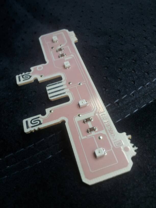

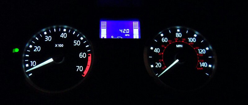

I would personally not buy the kit as it's overpriced. Just purchase what you need.
With the center LCD you need 4 PLCC-4 3254 SMD in the colour of your choice then 4 PLCC-2 3254 for the dials.
For all other MK2 dials you'll need 10 PLCC-2 3254.

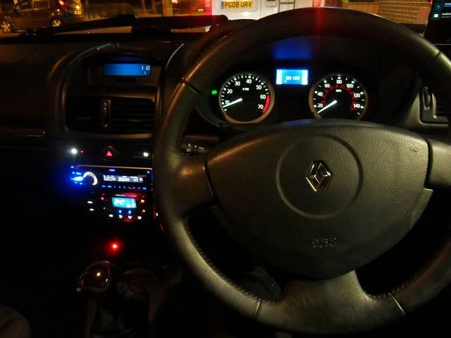

The radio is a little bit harder than normal you'll need 4 PLCC-4. For the heater panel you'll need T5 'Dashboard LEDs' although you'll have to remove the panel as there is an orange light filter so you'll need to remove that.
If it's not the same as this then you'll need 2 more T5 LEDs.
That looks insanely good!!
​Shame I'm such a techno spaz.
