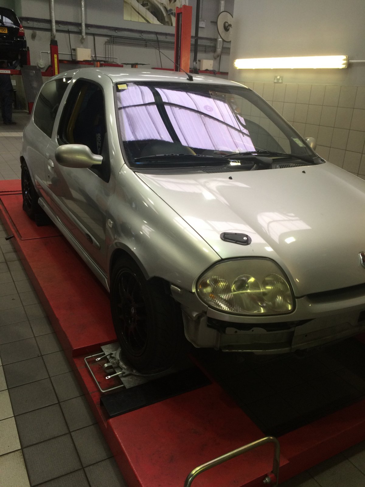

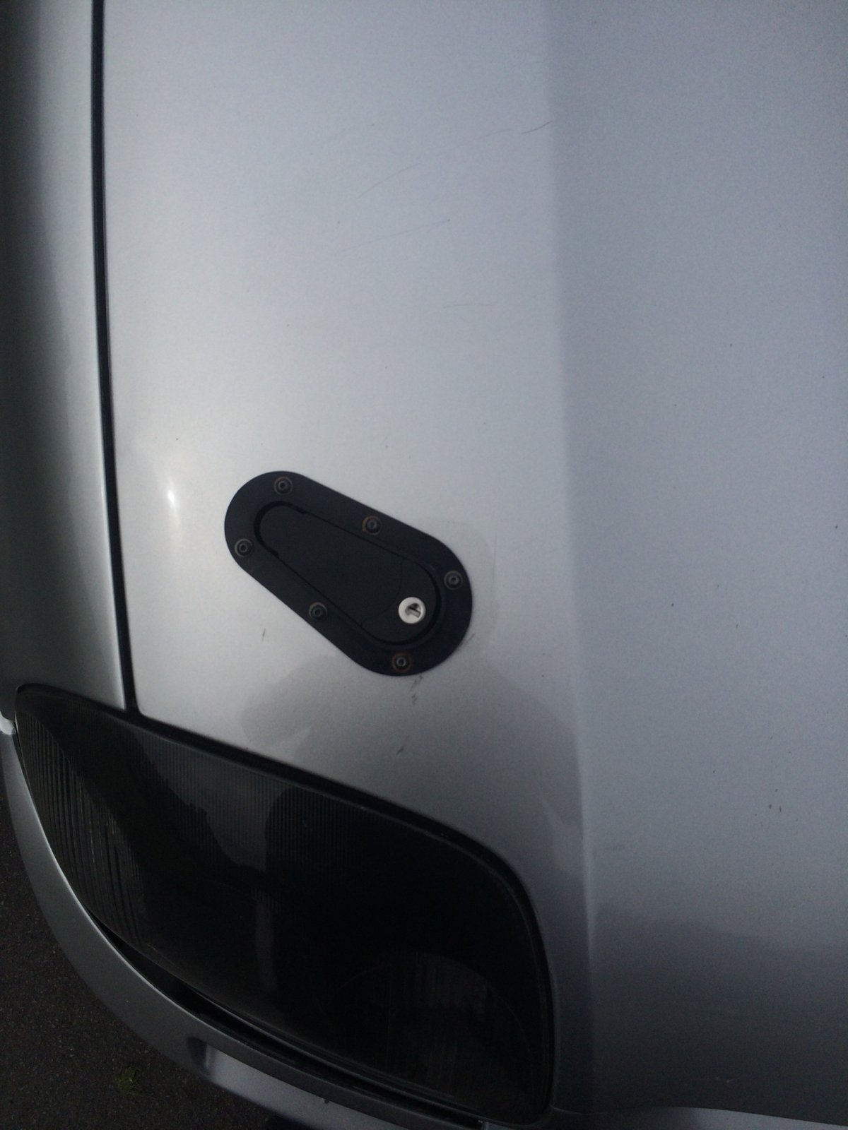

Glad to hear it. Well I have mine here as they line-up with existing bolt holes. They're not incredibly flush but I don't mind them.

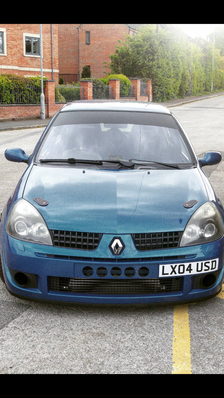

love the colour think its the best out there in my eyes, well this and the rb :hearteyes::hearteyes: but yours does look good thats the sort of place i would like mine but from the pic it looks like a little lip at the front not sure if it is.
i was thinking of having mine more towards the middle at the same angle but not sure on how it will line up under the bonnet

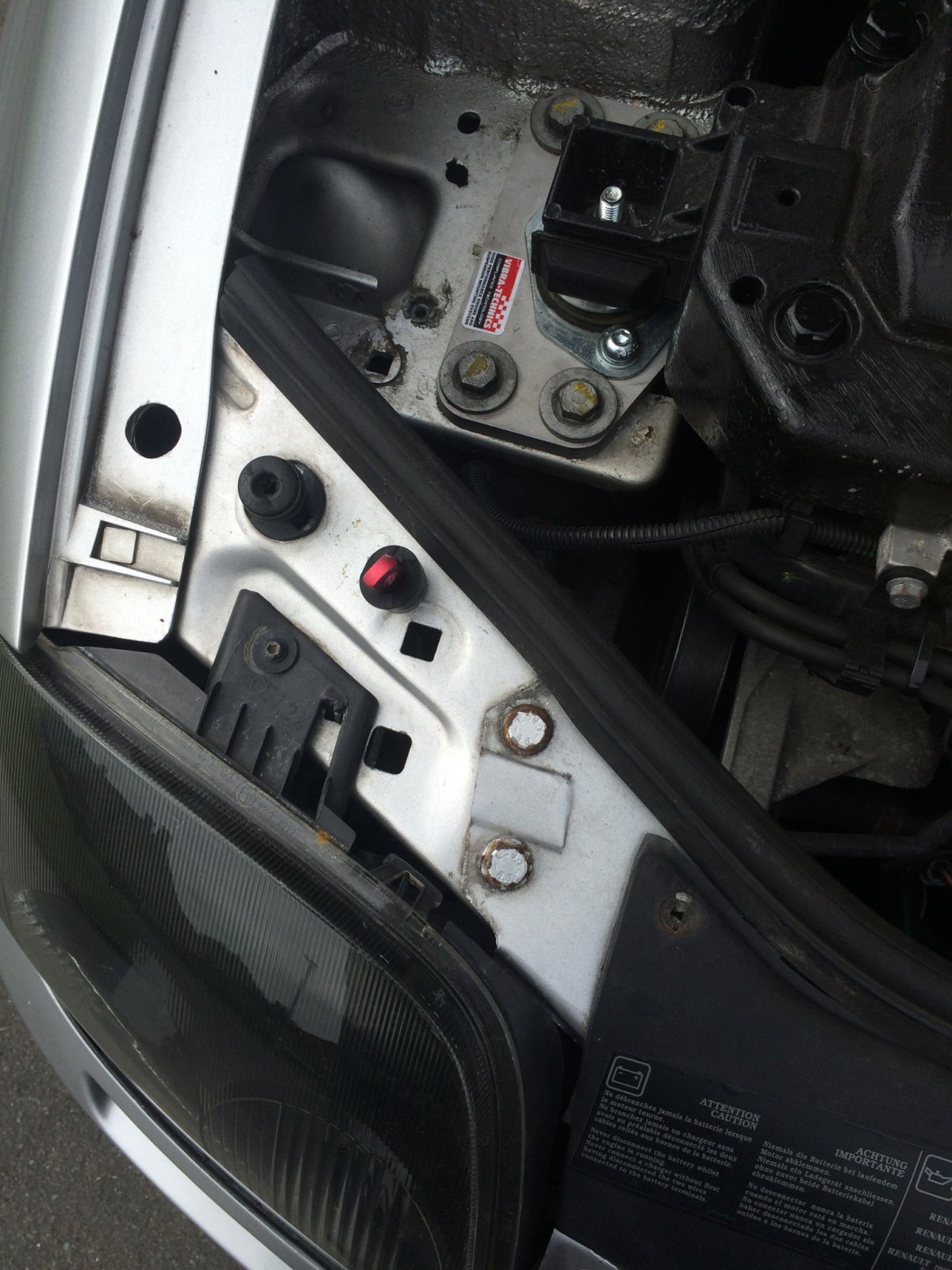

You can see pretty much see where you are limited to where the catches will finally sit , due to limited space unless you use brackets off the original two bolts the hold down the slam panel . Note the slam panel will need removing for this to be carried out.
Ph2 has a similar if not identical front panel , although you prob know my bonnet is different.
i can see what you mean mine is a ph2 so going to have a play this weekend i have got a spare bonnet to test on before cutting mine so im hoping this will turn out ok wish me luck :smile::smile:😊
