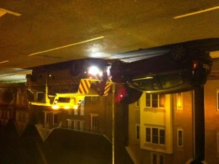

So we called the AA as my brother luckily had breakdown cover that would even cover me :) the technician diagnosed a dead alternator which was only kicking out around 8-9 volts instead of the 13-14 volts it should. He gave my battery some charge and I attempted to drive it home with most electrical systems off except for side lights and what ever else is running in the background. After 3 miles electrical faults started happening again and my dash light went out and sidelights so I pulled over and got towed the last half a mile.
