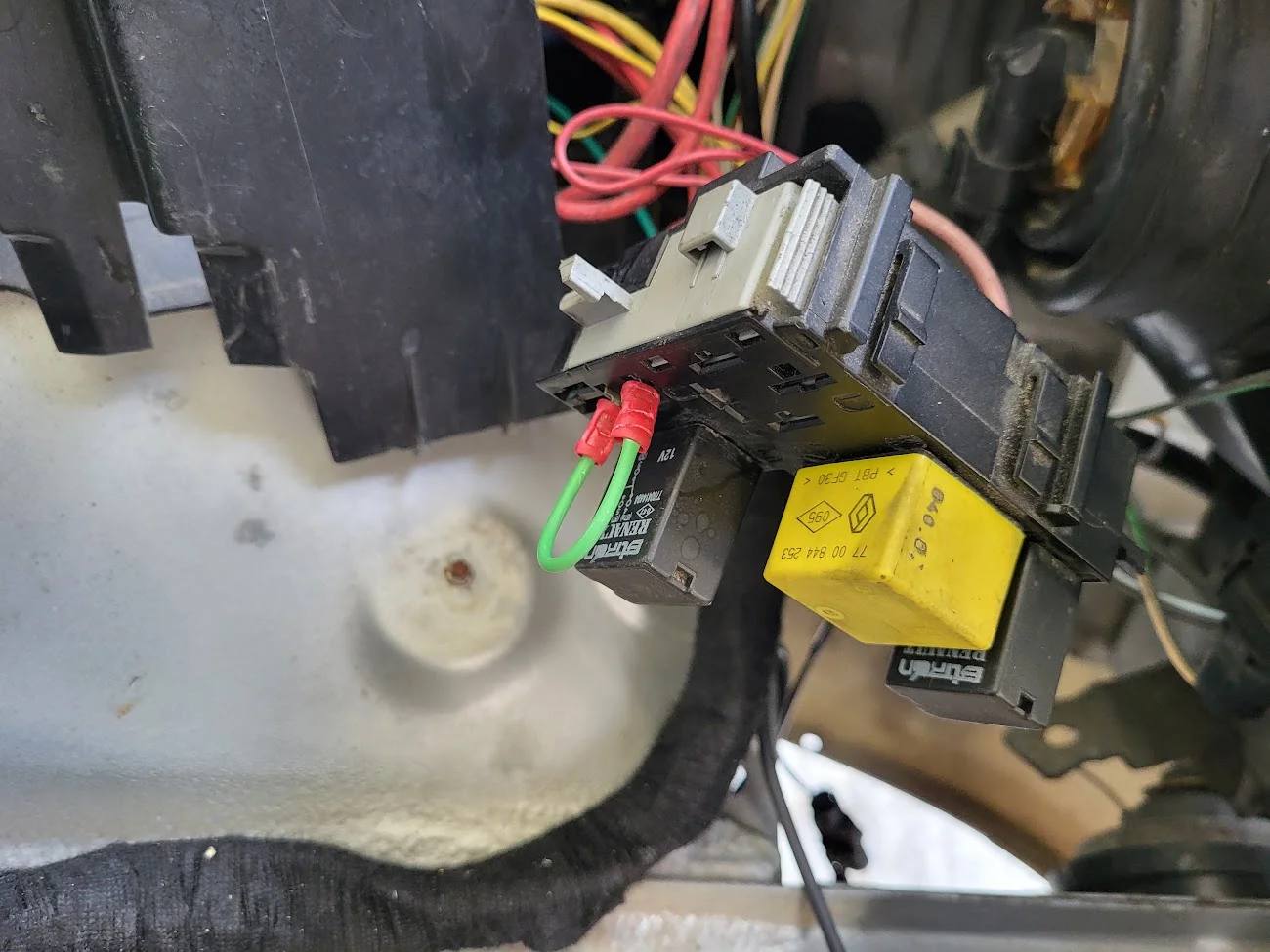

Is there a main ignition relay somewhere I can investigate? A sticky relay sounds more plausible to me, perhaps that's just me hoping it's not the UCH as that sounds like a headache.

Is there a relay bank in the car that houses a main ignition relay do you know? Sounds like a good start.
