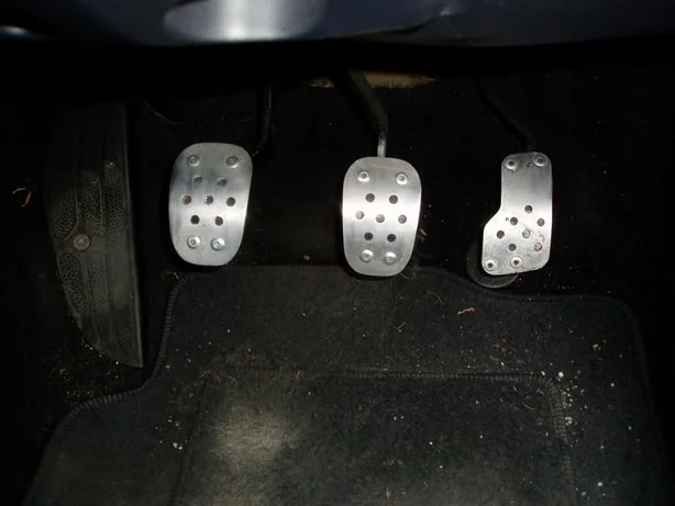

I just made some new pedals when the ones on my 172 wore away on the edges .
Excuse the sh*t on the floor and the dirty pedals , the car needed a good clean .

^^^^ You could probably make some like i did out of aluminium sheet , whereas i pop riveted mine on in the original holes , you could epoxy resin them onto the original pedals underneath the rubbers .
Probably cost you about £15 tops for both the ally sheet and expoxy , plus you'll have enough aluminium left to make at least another 3 maybe 4 sets :)
The original Renault pedal covers in the 172 / 182's are 1.5mm thick , i used 2mm .
