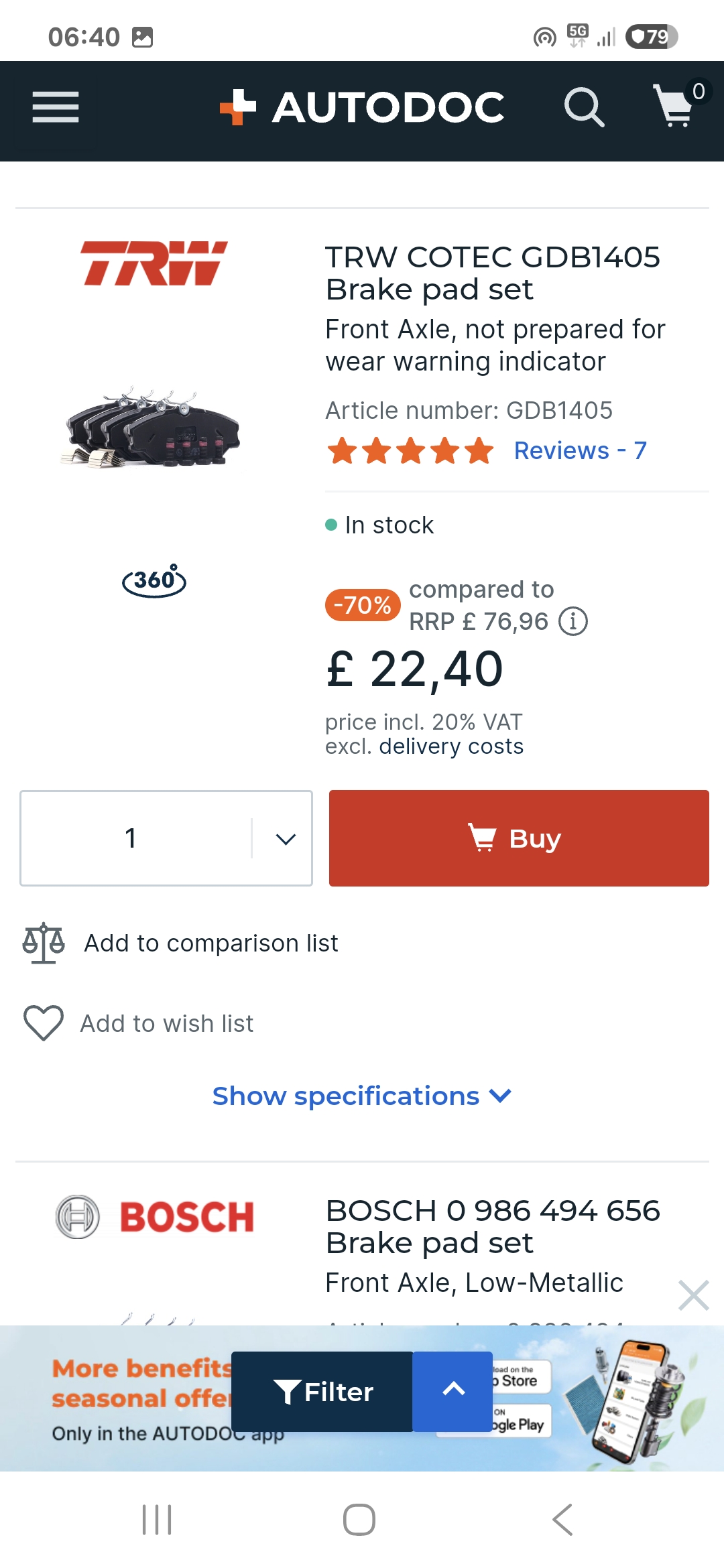

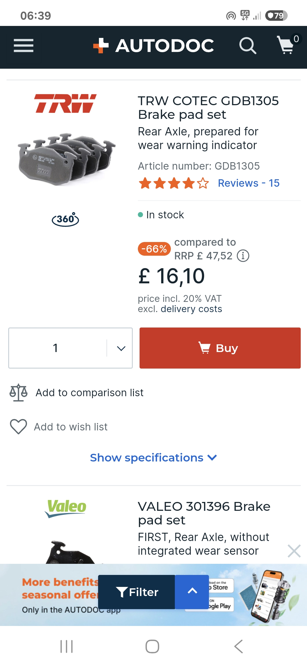

Have a look on Autodoc. It says that they ship to South Africa. They sell TRW pads for a 182.

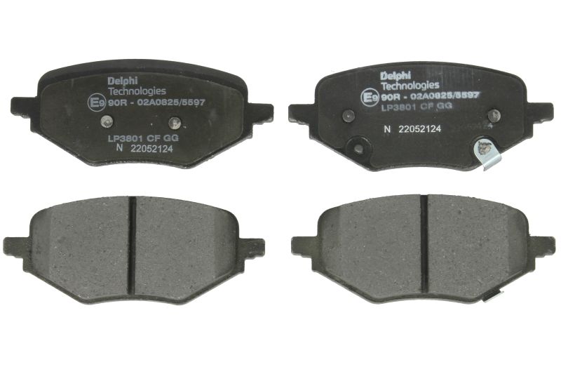

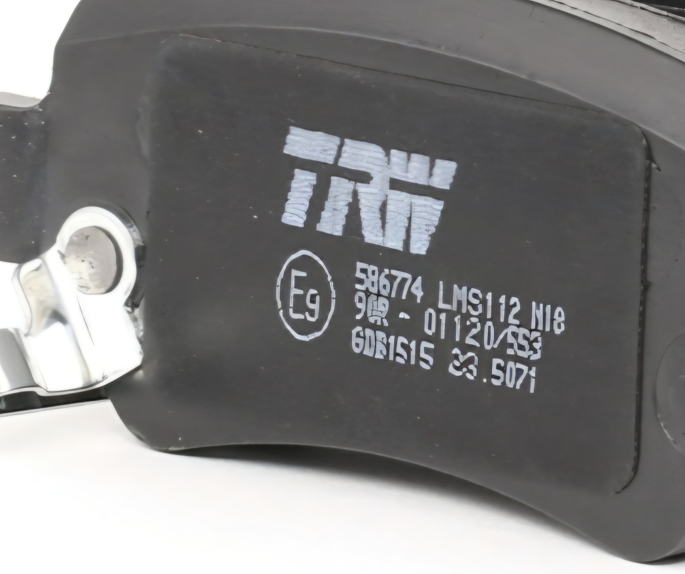

If you're getting stock/oem type pads, look for ones that have GG printed on the code on the backing plate.
That's the highest friction coefficient for a road rated pad.
Most are FE or FF.
I'd say most people order brake pads online.
So checking the backing plates would be impossible,unless you ask the seller for that information or better still send a picture of the backing plate 🤔
R3k1355
If you were selling pads and some melt started asking what letters were printed on the back.
Would you be opening boxes and taking pictures, or ignoring them?
