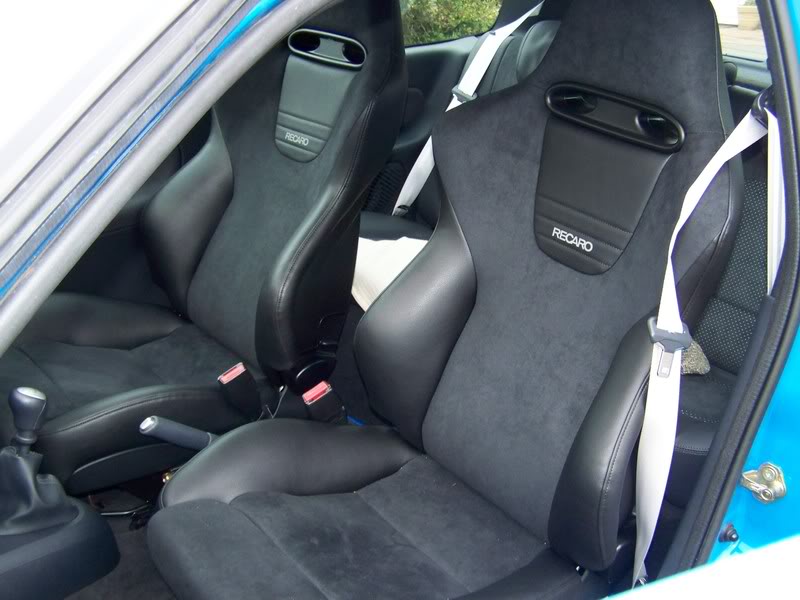

When i went to testdrive my new 182 before i bought it a month ago the service and airbag light were on, and the salesman said he'd get it sorted before i'd pick up the car a few days later, which he did.
Que to a few days ago when we had passengers in the back and had to move the front seats (recaro's, added by Deb after the car was bought) and we initially struggled a bit to get the seat back in place, it kept moving and wouldn't click in untill my other half sat down in it and tried for a while.
Then yesterday during driving there was a small click and her chair moved back a little bit, and the service and airbag light came on again.
Where do i look for the wiring, and what am i actually looking out for to find the problem ?
Under the seat- the Seat wires into the loom that comes out of the carpet- the wiring is more than likely loose creating an open circuit ( or corroded connectors)
Make sure you take the battery connectors off if you are undoing wiring.
