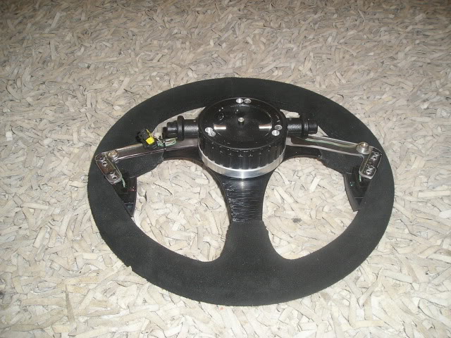

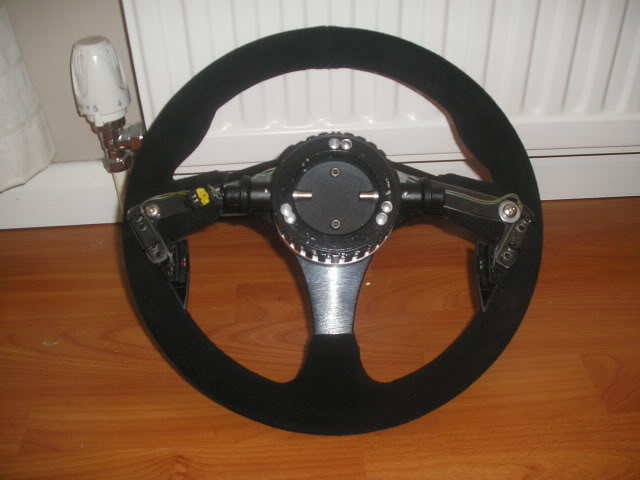

After recently buying a Trophy i have realised how much i have missed cruise control on the V6 - i fitted my vee is with a small aftermarket wheel with quick release 4 years ago due to not liking the bus size standard unit. Therefore had a few hours spare today and came up with this:
Not sure if this mod has been done before? Not to difficult and i have not modified the original switches at all and could therefore be returned to a standard wheel.
The only unreversible modification so far is drilling 2 holes into the back of the wheel but a small sacrifice i guess.
I know the switches have been swapped from side to side but due to keeping the oem look i wanted the switches to curve with the wheel.
Now just need to wire it all up :)

Thanks chaps.
Quite easy to do and took a couple of hours.
Only parts used was a cut up number plate, 4 cable ties, 6 washers and 2 large self tap screws.
Tools used - angle griner, drill, screwdriver with philips and torq bit.

Thanks everyone.
Amnesia they had to go that way around as that was the only way they looked right.
