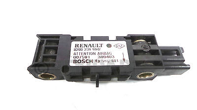

Where are the crash sensors you mentioned? I can only find posts mentioning them being on a "sill" by the seats. I don't even know where to start looking!
  172 cup
I'm unsure if every Clio has them but I could be wrong ! What's ur Cleo? They are on the sill next to the seat ( maybe under the plastic trim ) look like this.....
