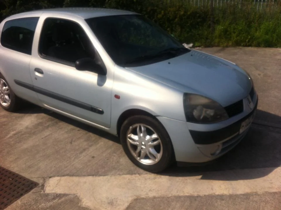

Clipped the latest rebuild and its brought up the usual suspects
Halfrauds connectors and tape......nasty!!!
DF183 circuit open..... Pretenisoner fired
DF253 Circuit Open..... new one on me although odd coloured rear seat belts....
DF077 memorised ..... some tit had cut through the wires at the block (now repaired)
DF065 CO........ above tit has also cut through the seat postition microswitch
DF002 memorised ......Flat battery at some point
DF060 ........ Someones unplugged the ECU with the ignition on (naughty)
DF194 1.Def ....... As it says..... needs reprogramming
Didnt think such a base low spec model wold have pyrotechnic rear belts?
DF253 is odd, DF056-what exactly does this do? My lad's is stuck in the reclined position (400 ohms?).
