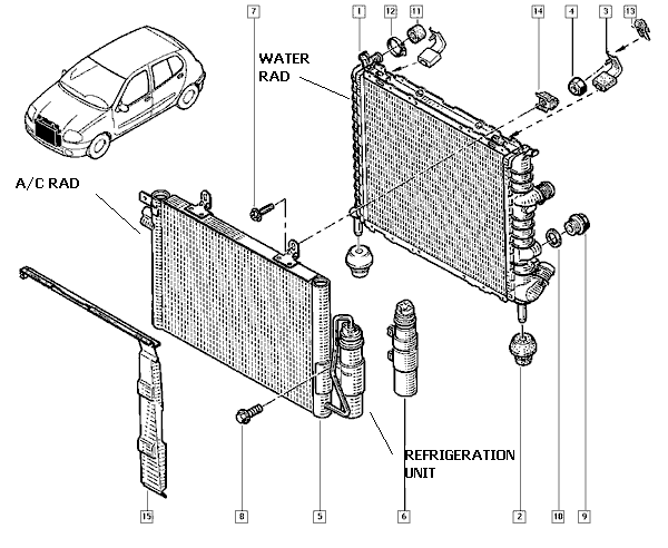

Where is the condensor? Is it under the black panel with all the other bits? How would I tell if its fault. Would it come up as a fault code when pluging into the ECU?

The condensor is the A/C rad - situated in front of your water rad
  MERCEDES CLS AMG

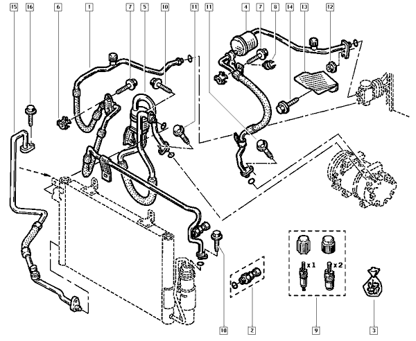

RADS
AIR CON PIPES
