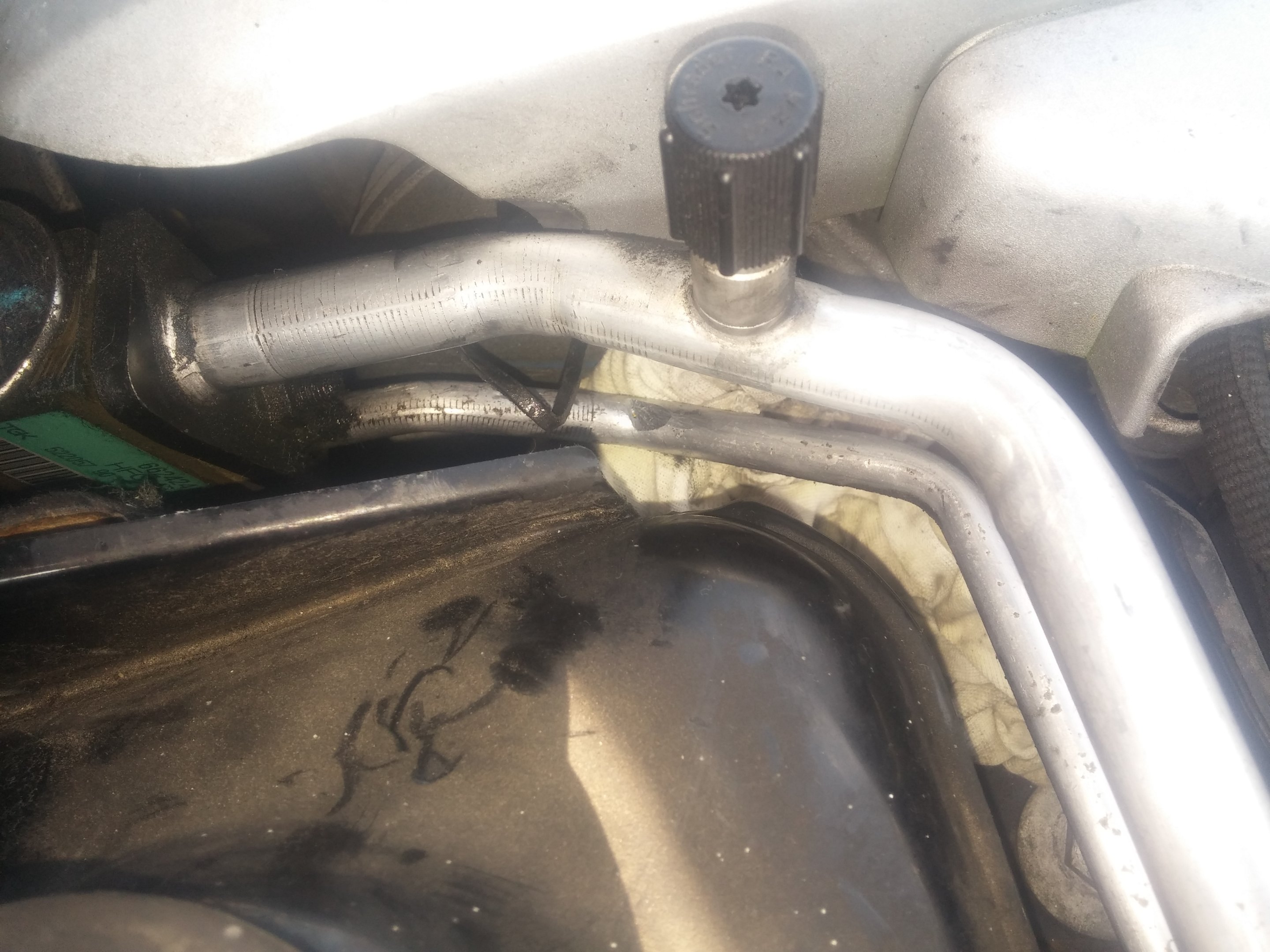

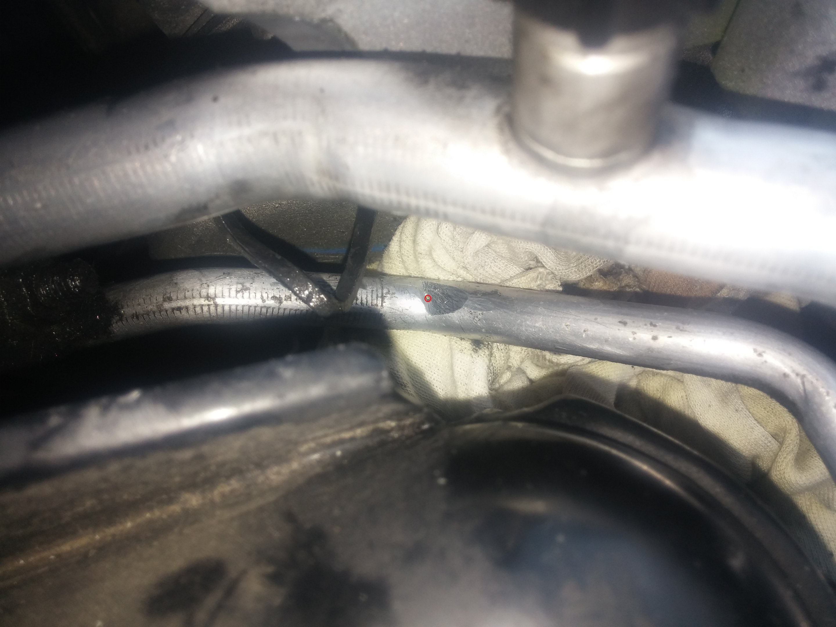

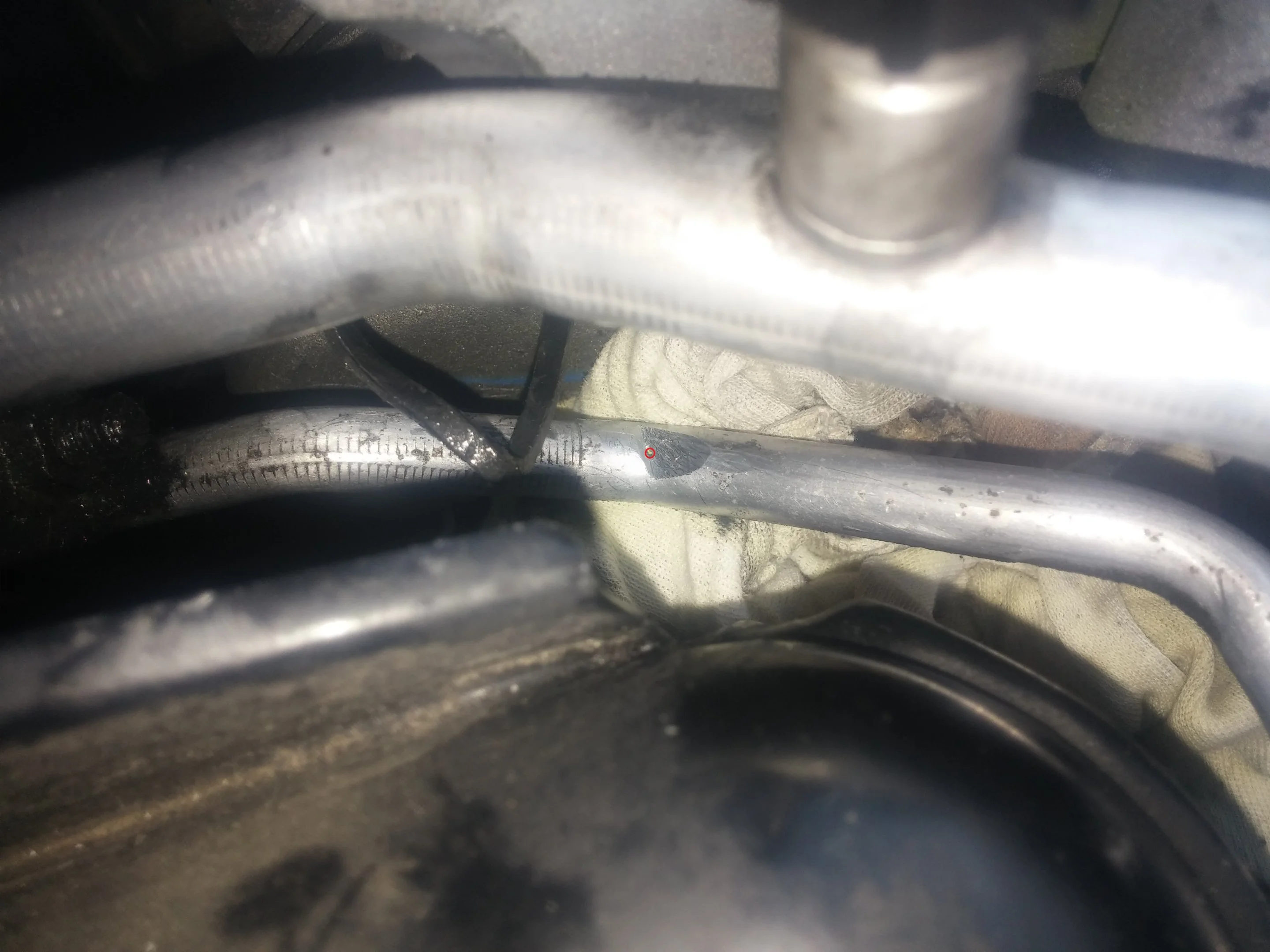

I have a very small hole on the smaller of the two air con pipes caused by a plastic bit of clip rubbing against it grrrrrrr

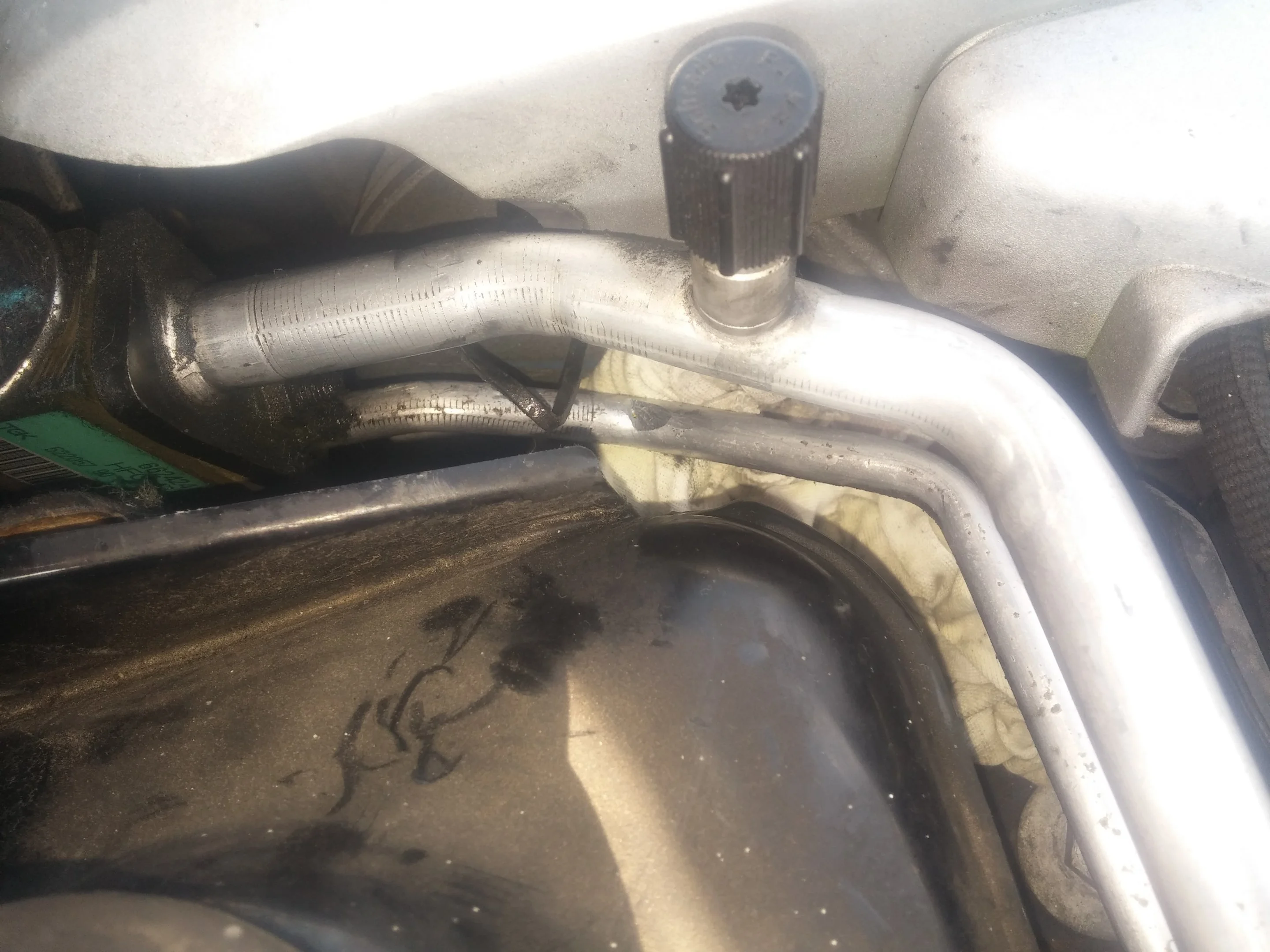

Hmm, not sure on that STEVE.M but here's a pic!
I think No. 1 smaller of the two pipes.
No 1 it is.

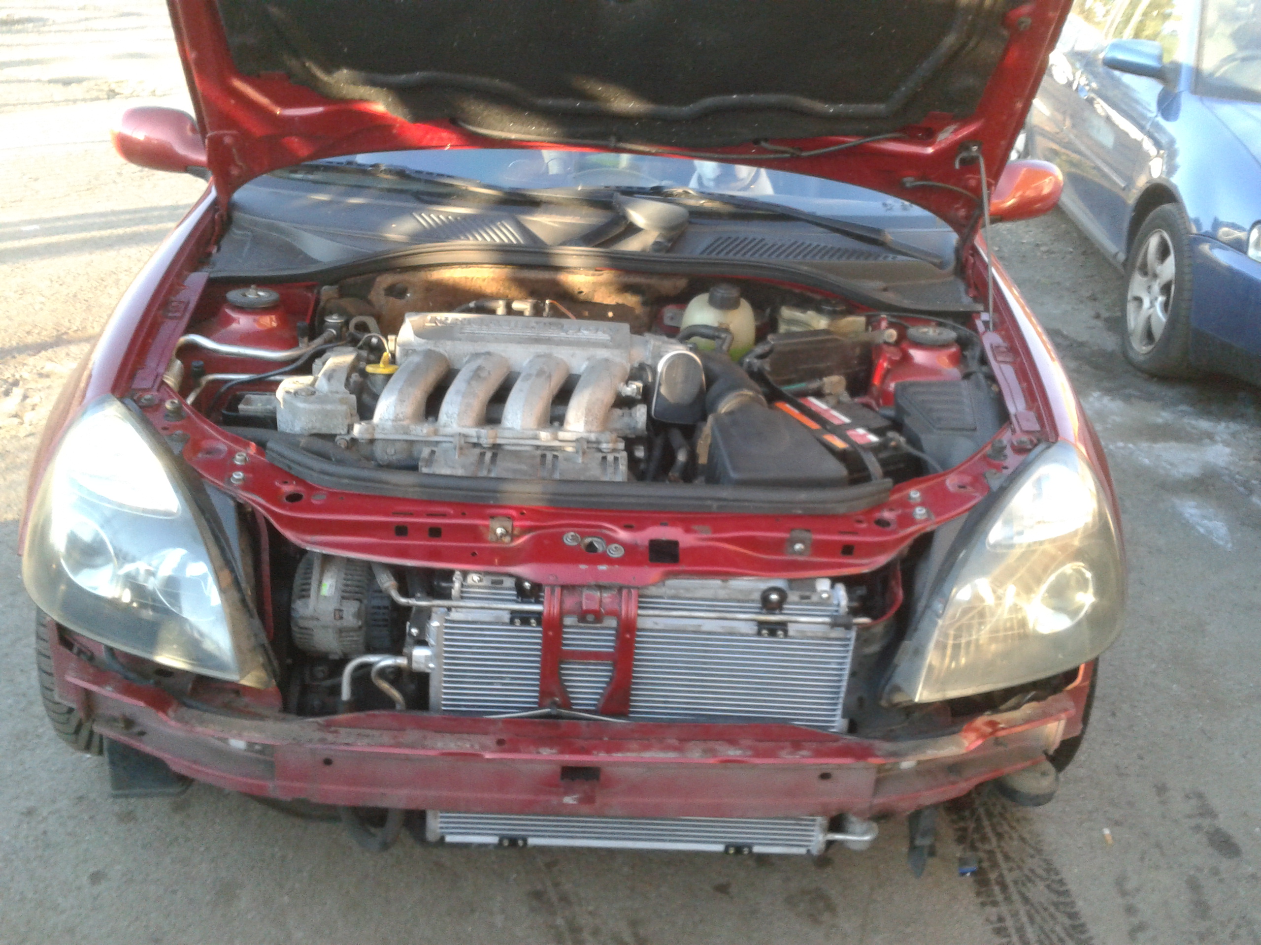

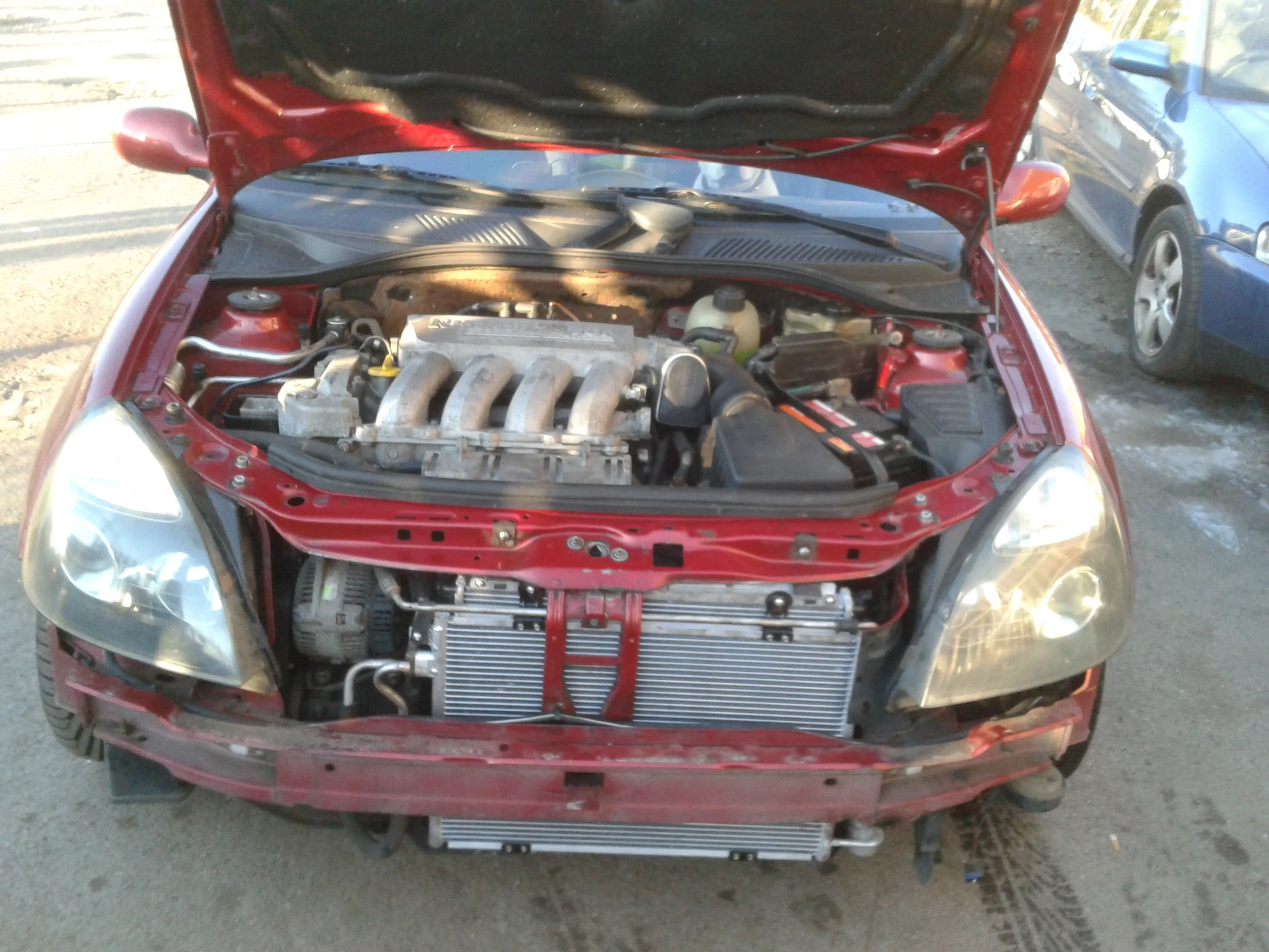

Bumper removal is quite simple in theory, unless it`s not been disturbed since 2004.
Bumper hasn't been off since I bought it in 2004! So the bumper has to come off then 100%? can't do it without??

Yes, you will have to remove the bumper to release the slam panel.

Once the bumper off is it relatively easy job to do? I see one bolt to undo but not much else - bumper is hiding others I presume.

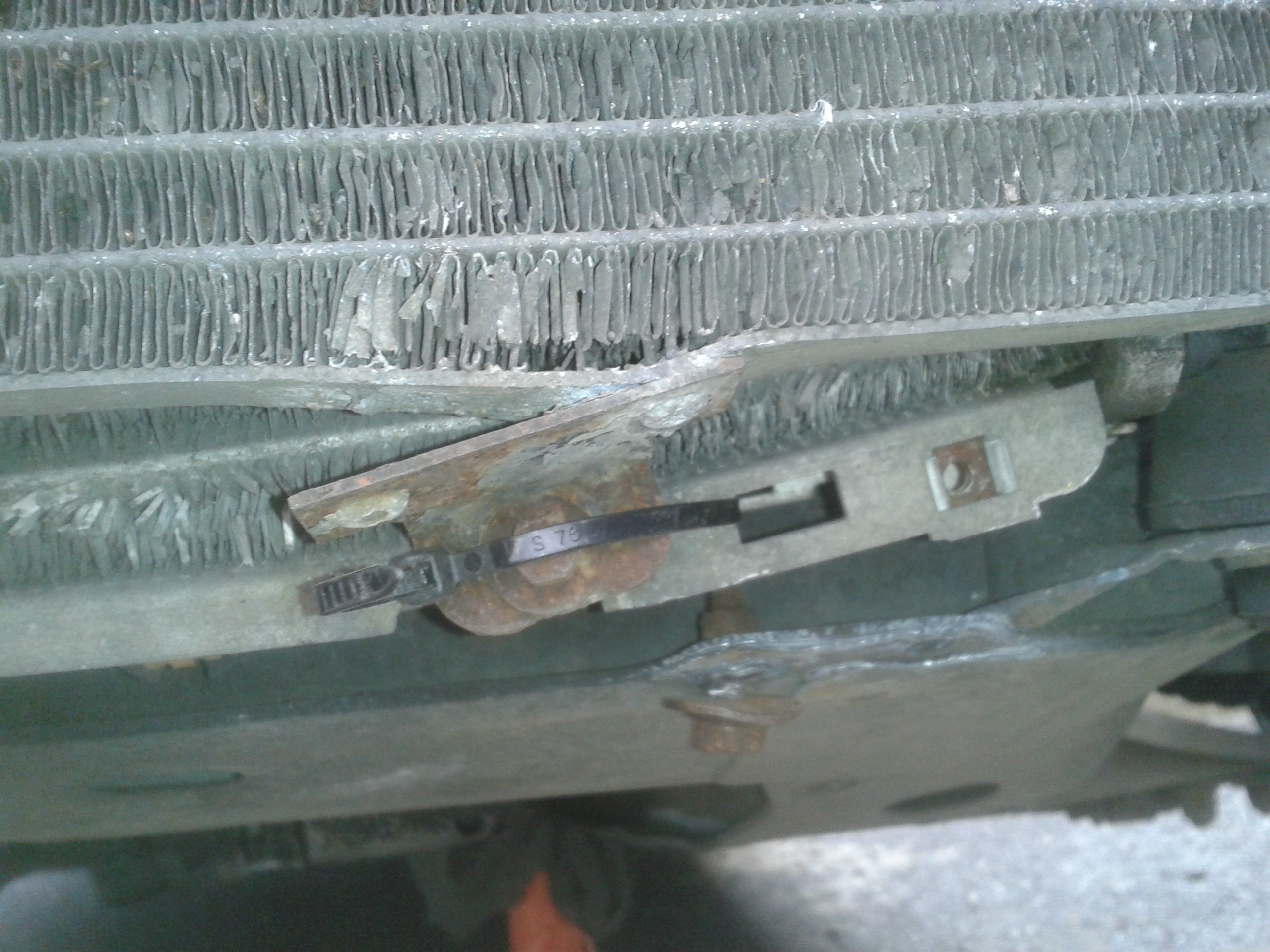

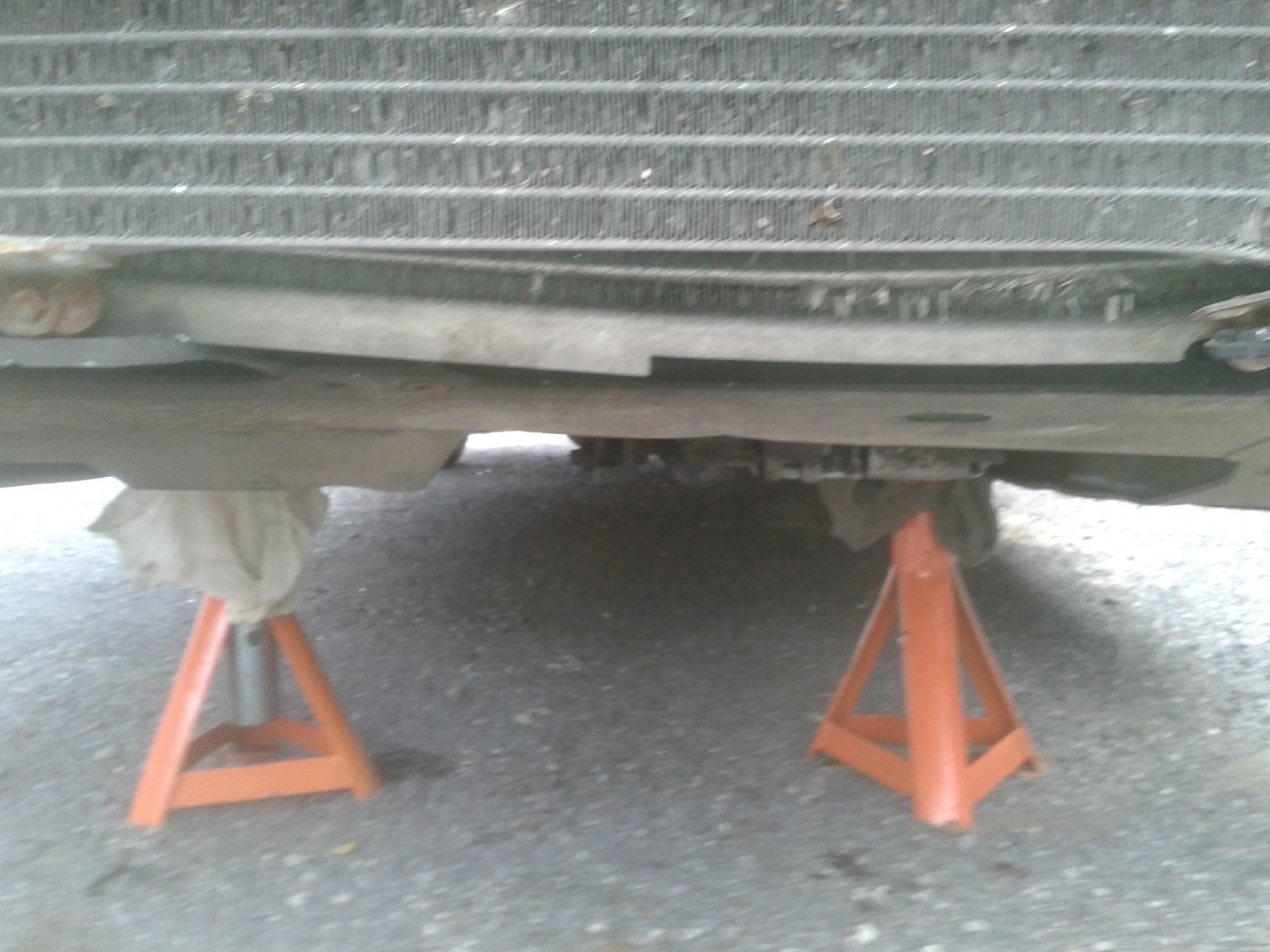

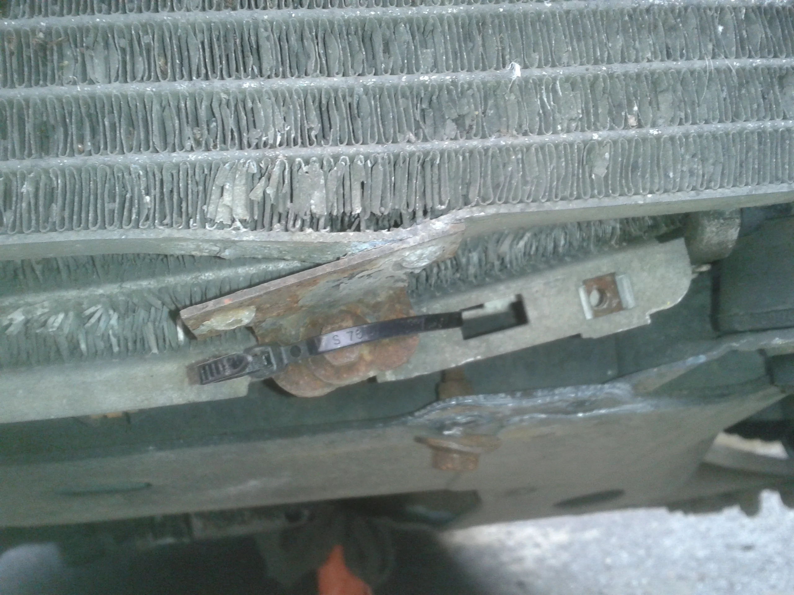

Once you get the bumper & slam panel off, you will probably find this.

I had it regassed today and it went pete tong!
I JB welded it thought great, put under pressure and booom went everywhere!!
Bad week for no air con too, back to square one -fitting a new pipe, worth a try though.
Just replaced that pipe on mine. Garage damaged the pipe whilst replacing the rad and condenser whilst doing the belts as they looked like the corroded horror above. They had JB welded it and then it leaked.

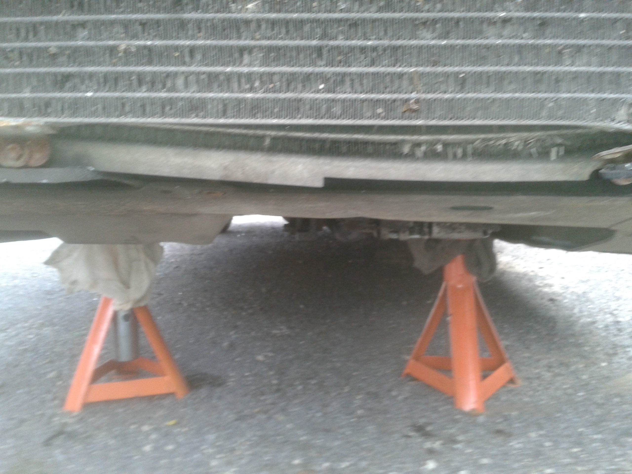

Bumper comes off easy, follow a guide on here or YouTube. Unbolt slam panel (easy).

Yes, JB weld isn't going to work on a pressurised ac pipe. Even if it lasted to start with the refrigerant would have degraded it anyway, you need to either swap the pipe, have someone solder/braze over the hole, or have a repair piece let in.
