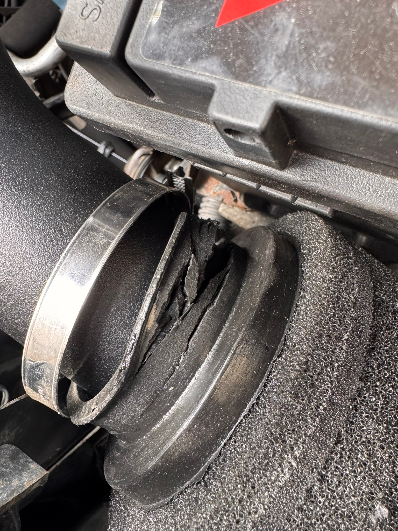

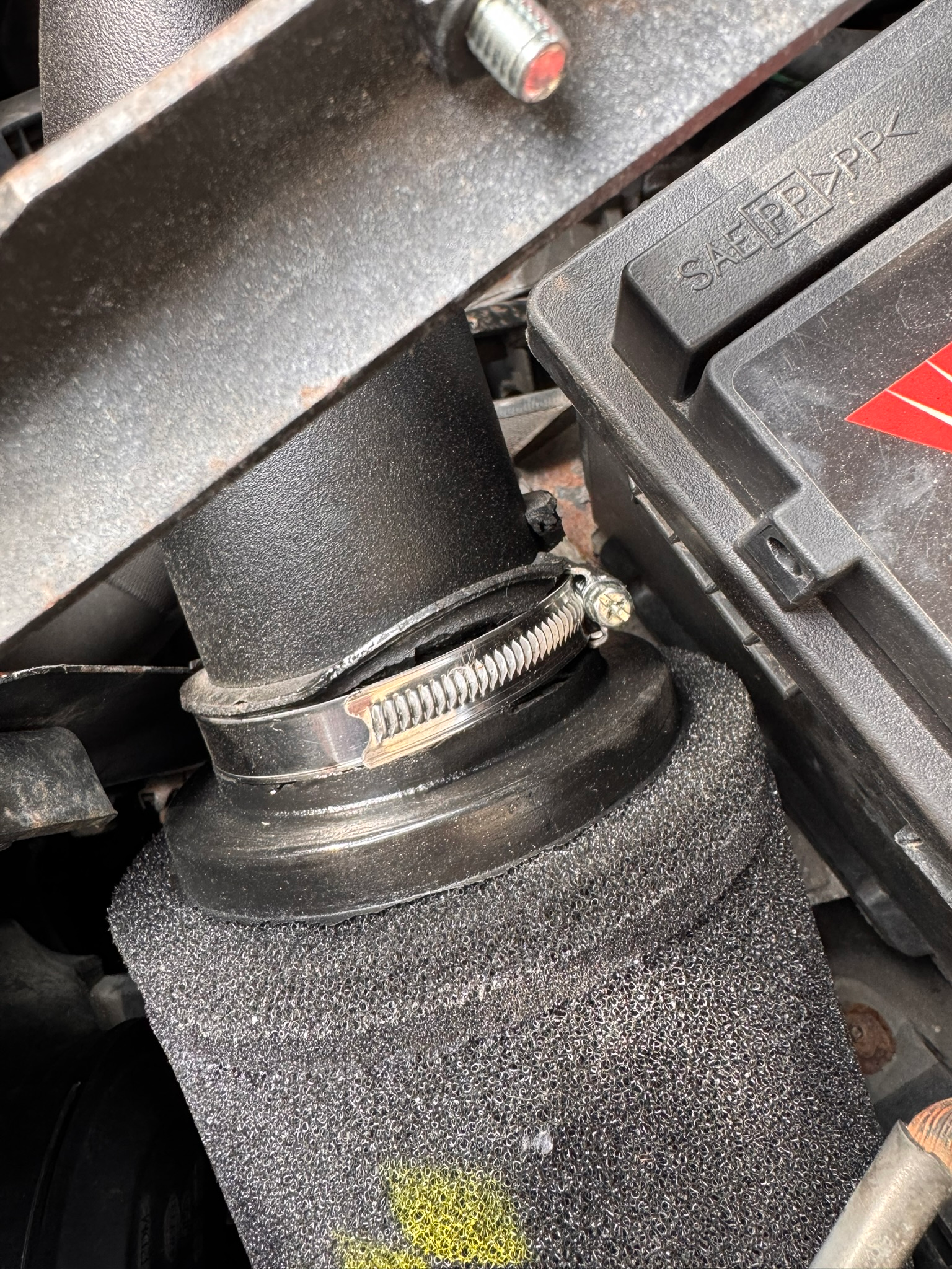

However..... The same build quality cannot be said of the Pipercross foam section, which is terrible. There is no metal or hard plastic collar on it to connect to the metal pipe. When tightened (even lightly) with the clip around it - the foam itself gets sandwiched between two hard, metal layers. The outcome to me anyway was pretty obvious - and within a week this had happened. The first pic being with the clip in situ and the next, once I had slackened it off to reveal the damage beneath it.
I've contacted both K-Tec and Pipercross about this. It's much more of a Pipercross problem as even if they sent me a warranty replacement, the result would be the same within a very short space of time.
I'll add updates to this as and when I get them if people are interested, but for now, I'm likely to put the OEM airbox back on to remove the risk of any foam parts being ingested by the engine.

I bet it sounded epic, Daz. I'm sure i've read that these filters are poorly made and bits come off easily. Can you fit a different filter to that inlet?

How can they "design" what is just 2 90 deg bends and a bracket welded to it and be a few inches out 🤣🤣
Then never even test the thing before they sell it otherwise they would realise the issues before selling any.🙄

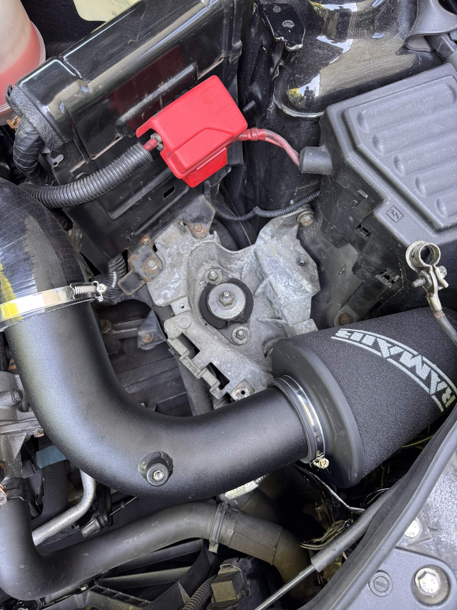

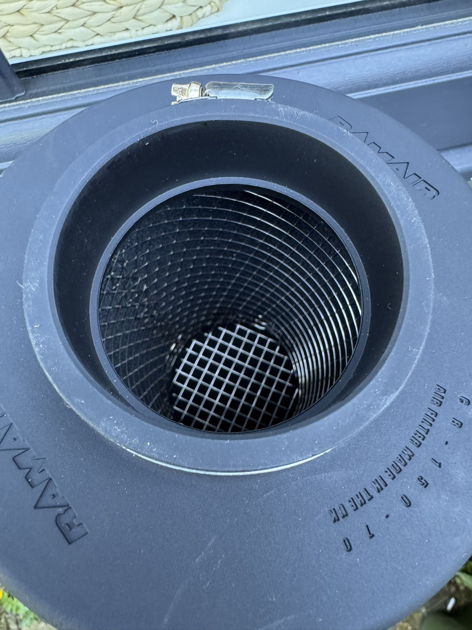

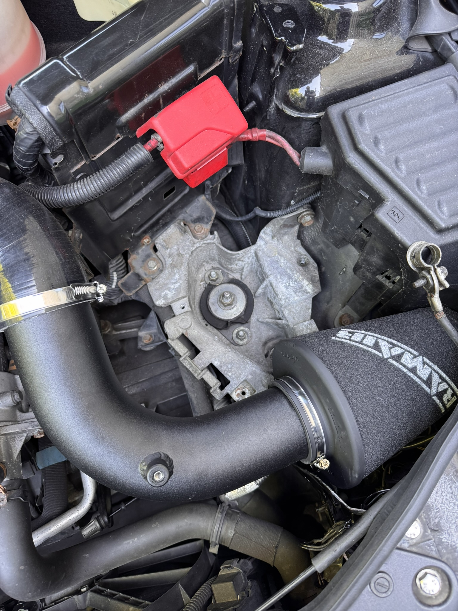

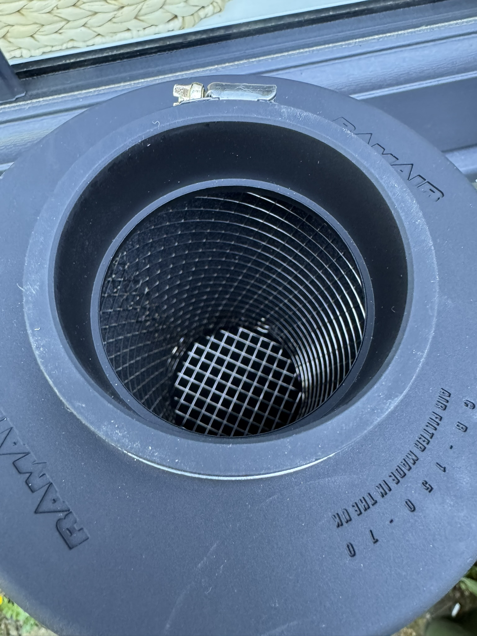

So, the Ramair filter arrived yesterday and I fitted it today.
From the outset, the manufacturing quality was WAY superior than the Pipercross effort. I particularly liked the small lip within the collar that stopped the 70mm induction pipe from sliding further into the cone filter itself.
I found it much easier to line it all up and position it with the battery out too.

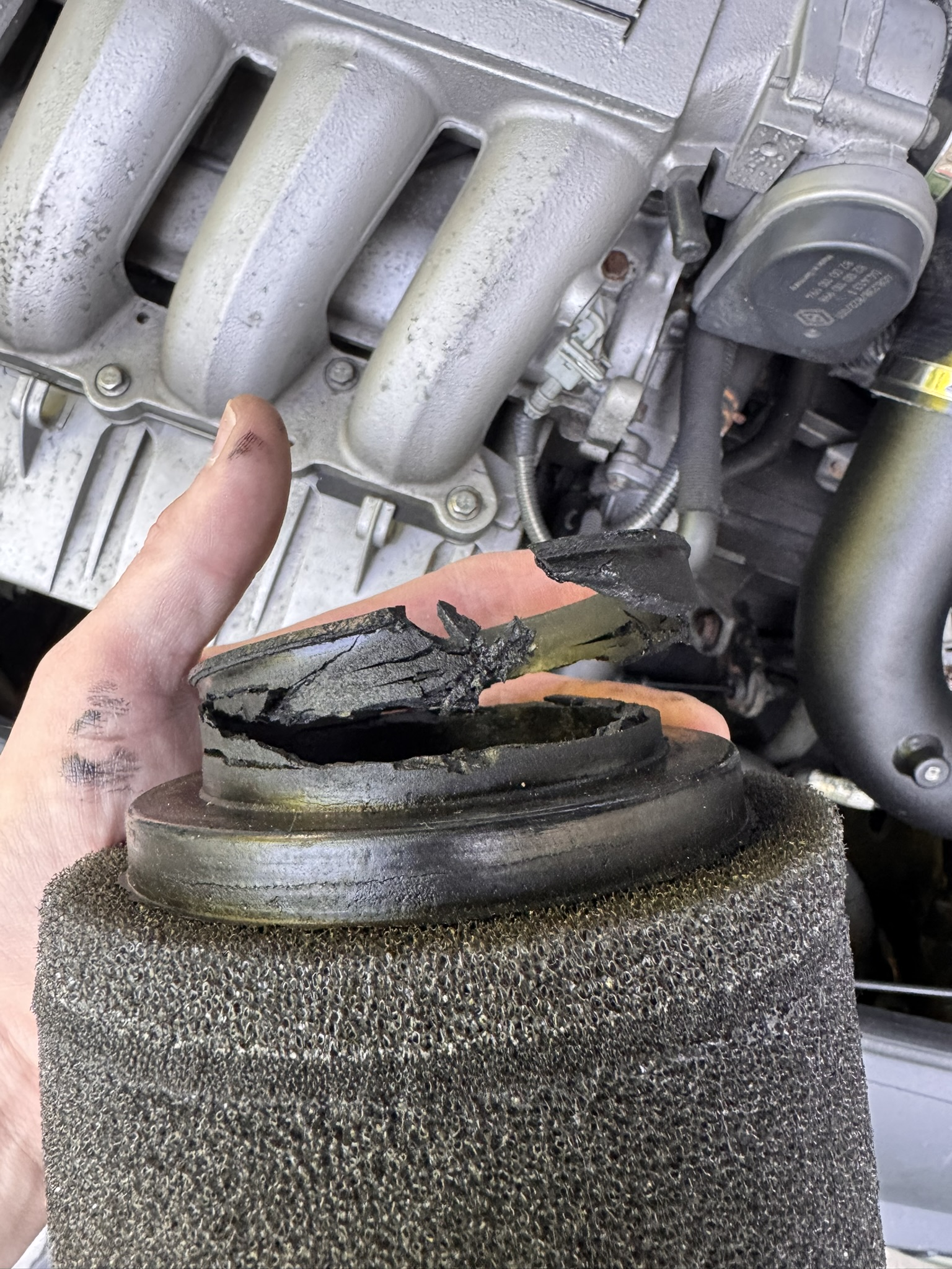

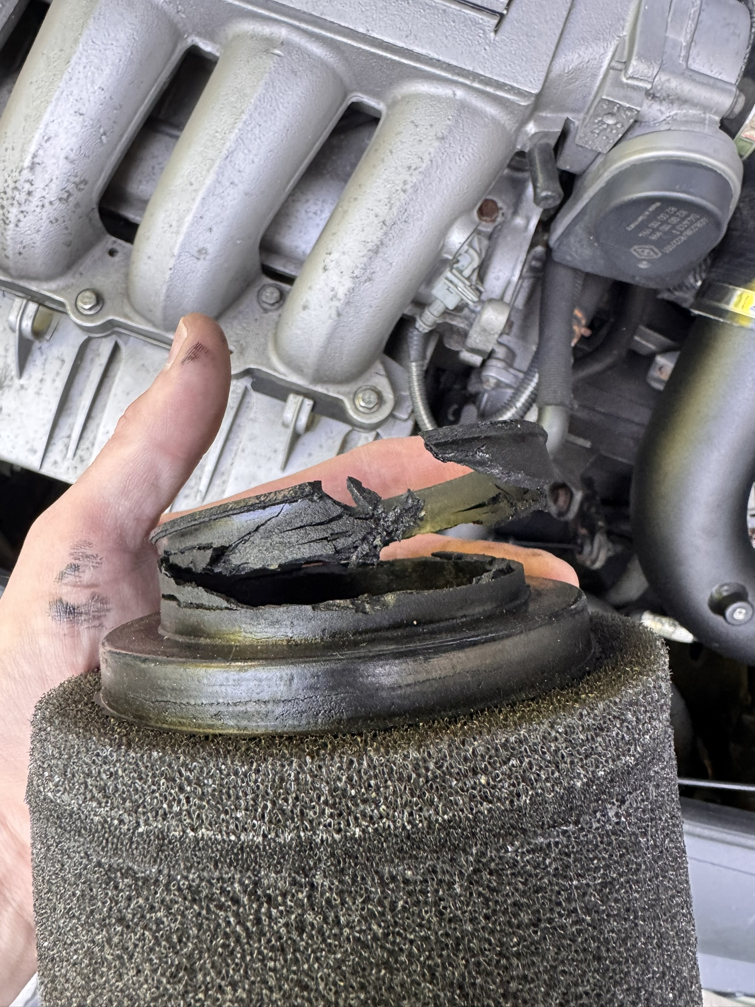

Took and image of the state of the Pipercross filter when removed too - absolutely piss-poor design.
Thanks again to @Mr Trailer Man for the Ramair recommendation. Took it out for a little blat earlier and it sounded great. Cheers!

Everything about the RamAir is better quality.
Them and ITG are really the only ones worth using.

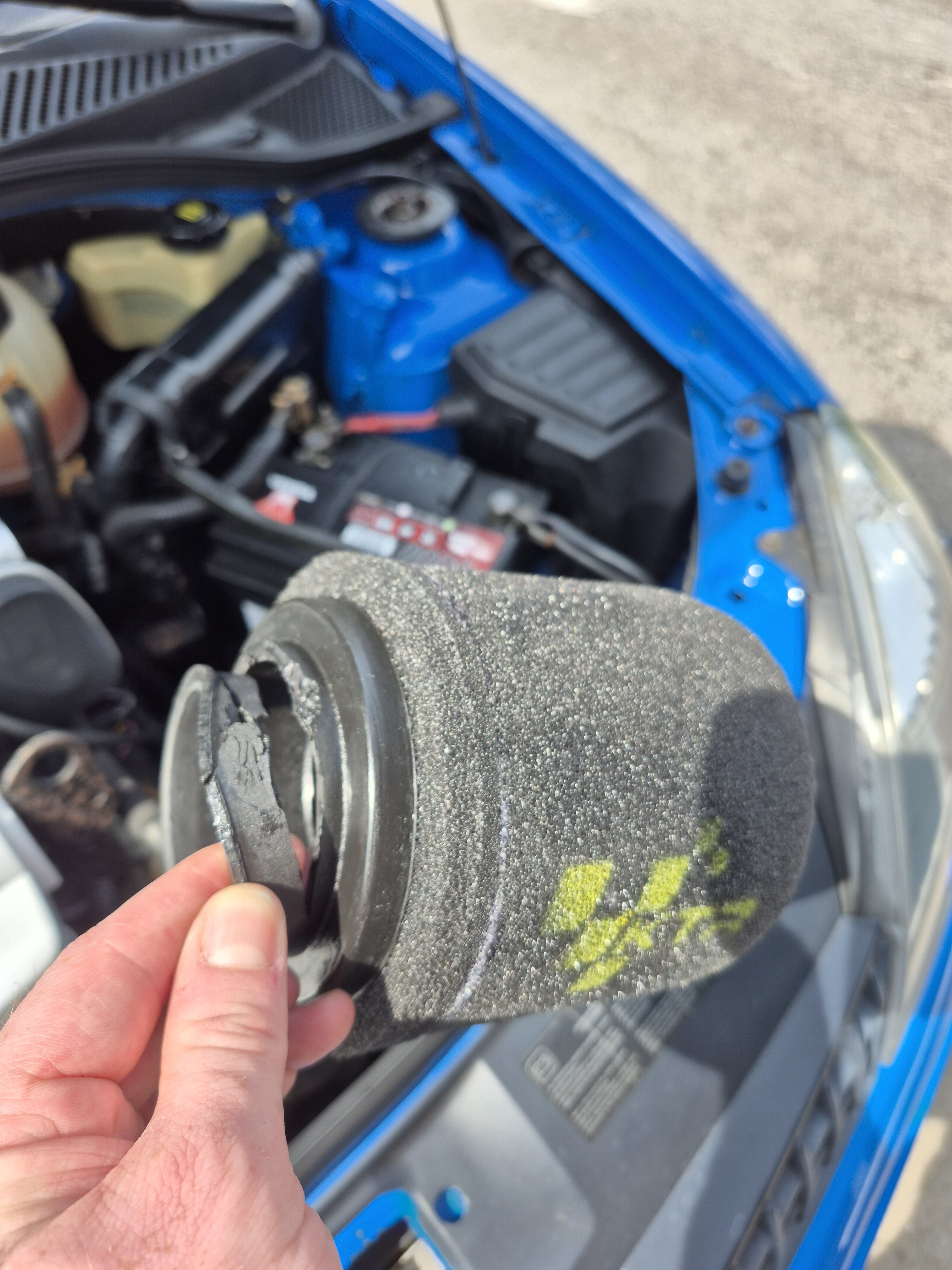

Im not the only one.. it happened to me as well.
Iv emailed K-tec and they are so say talking to there supplier.
