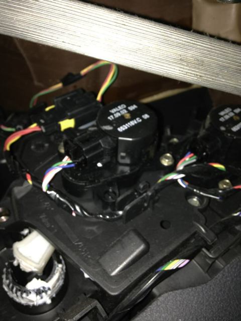

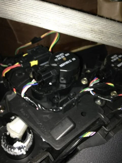

It's an ok job, got cramp in my arm a few times. I found it easier removing the two motors, and then the other three to remove to cover.
Instead of it all in one. Quite tricky getting on to the top screw with motor in place.
Each motor is held in by two screws, then the cover is three more.
Did you find the guide on here, or is it pretty much self explanatory??
Are them the 3 motors I want to be taking off? What am I meant to be using the zip tie on?
Only two motors mate. The two that look identical. When you take both off. You will see what you need to do.
The one closest to the bulkhead is what you need to fix.
You will see the cog that the motor sits in has cracked and splayed out.
Take the cover off, use a cable tie to pull and hold it in shape. Refit parts.
Done.
Damn man, had a go at this this morning and there's no chance in hell of me getting that off there.
That's definitely where the problem is coming from the as when I try to turn the heater up and down, that cog you can see, struggles like mad to get round, and you hear the motor whining a bit...

Go to a hardware store. buy a bendy drill bit!
http://www.cliosport.net/forum/showthread.php?308548-Only-hot-air-out-of-heater!&p=9618639&viewfull=1#post9618639
It will cost much less than taking it to a garage and save you some money :)
Mate, I'm rubbish when it comes to anything mechanical, lol. Although I did manage to change my full fan/blower motor set up myself
Seems like its gonna be a struggle to get around the steering column too?
Nah it's easy mate. Remove the two motors. So 4 screws. Move them out the way.
Then the three to remove the casing are very very simple .
I used a short 6mm on a ratchet and nothing else. No bendy bits etc.
Once you have loosened them with the ratchet, you can literally unwind them using your fingers and the socket.
I hate doing fiddly interior stuff, much prefer engines and the like, but I still managed it ok on our old 172 when it had that issue.
