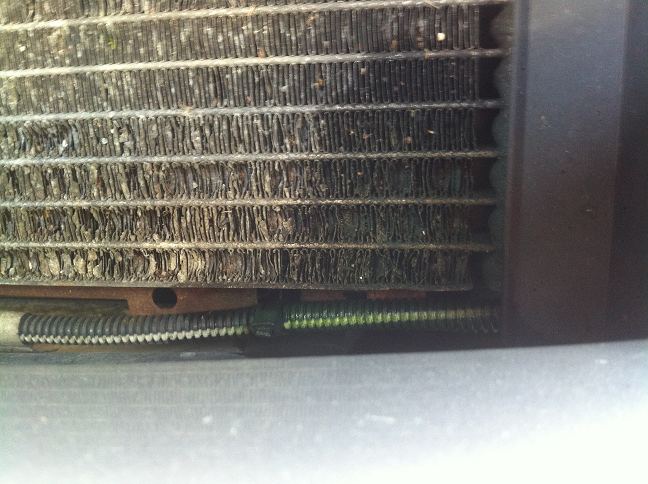

Look for any bright green oil/fluid leaking out of anywhere, particularly the AC condenser. When I hit a bird you could see it in the corner of the condenser, like so:
If it's obviously leaking then get it sorted first before you try to charge it, because you'll only be dumping aircon refrigerant into the atmosphere.

It's only green if there's dye in the system chap. So he might not be able to see it.

As said above. If it's been regassed previously then there's a chance uv dye is in the system in which case you can possibly trace the leak yourself.
