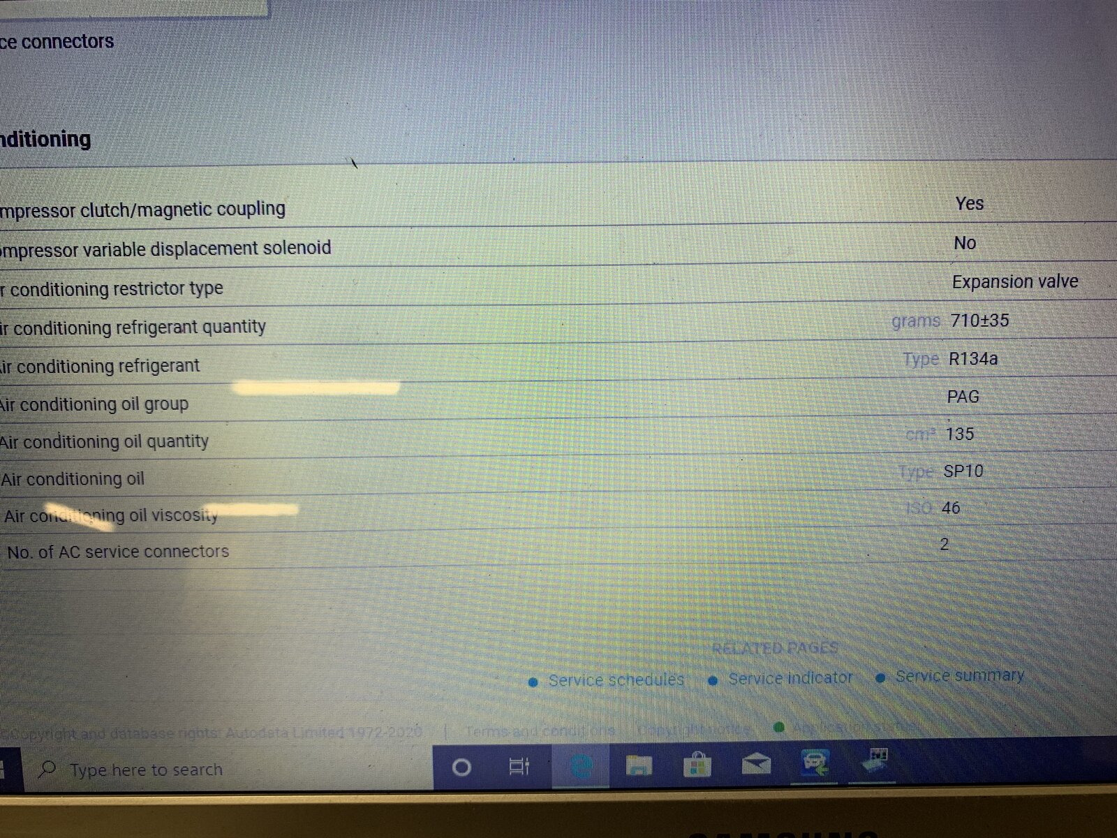

Would anyone happen to have details of the oil used in the air conditioning system of the Clio RS 182. I'm looking to replace it.

Ya they do, but my engine will be on a bench in the next 48 hours so that won't be an option. My friend has all the gassing kit, we just need to know what lubricant to use.

PAG oil for R134A systems unless stated otherwise
