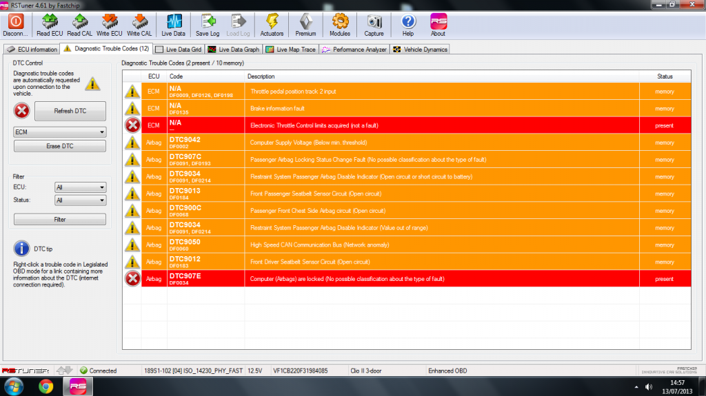

Had a couple of faults on my airbag system to do with passenger airbags, but ive cleared these with the RSTuner.
I also had:
DF060 Multiplexed network
DF034 Comp Locked by fault finding tool
DF194 Replace computer after impact.
So i sent it away to a company that resets airbag ECUs for most cars and it returned with DF060 and DF194 Cleared, but DF034 is still active.
Is this due to the RSTuner being connected or should that have been reset as well when it returned
The SERV and Airbag light is still present due to this
Anybody advise me on this?

I joke... it needs returning to be "unlocked" or you need someone with CLIP to do it for you

Thanks for the reply, ive sent them an email questioning it. Just out of curiosity, can i fit any airbag module from a Mk2 clio or are the clio 182s different. I know they are physically the same as a standard clio but are there any difference internally?

They are the same computer but there configurations are different. You can use another unit from another Clio II BUT you will need someone (like me) who can set it up for the equipment in your car (unless you buy one from another car exactly like yours
