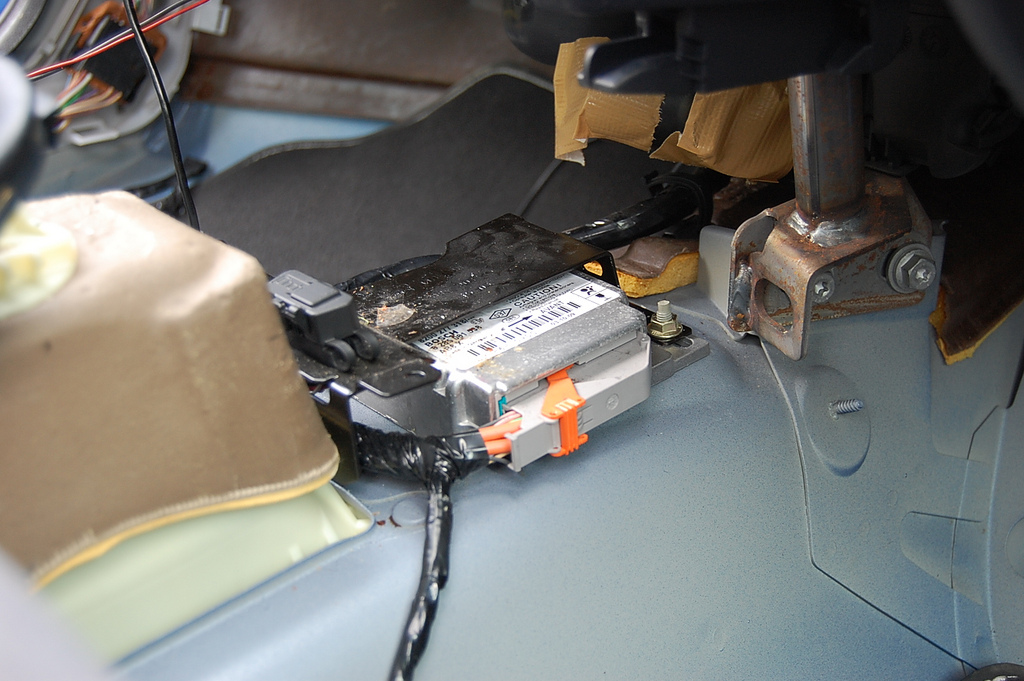

The airbag Ecu is under the centre console.
There's plenty of places that clear the data for around £20.

Louis..does a 2nd hand airbag ecu need coded to my car?? Or a simple straight swap? Thanks

I believe if you get one with the same number as on your old one, it's a straight swap but don't hold me to that.

Believe it's just matching numbers needed.
Take off your dash top and remove your existing one, post a wanted ad on here. Someone can easily pallet up and post a seat and ecu for you, paisley freight are great for that kind of thing.

Pretty sure the airbag computer is located under the ashtray section.

Email this guy Steve Berry steveberry168@gmail.com, he's normally on eBay but i had to look in some old emails to get the address!
I sent him my ECU and had it back with in 2 working days all for £20!
I wouldn't bother getting another ecu Evan if it's the same numbers / code part it will still need re programming ( so i was told when i was looking into getting mine done)
Ones i replaced the inpact sensors and put ecu BK in the Serv and airbag light went off
