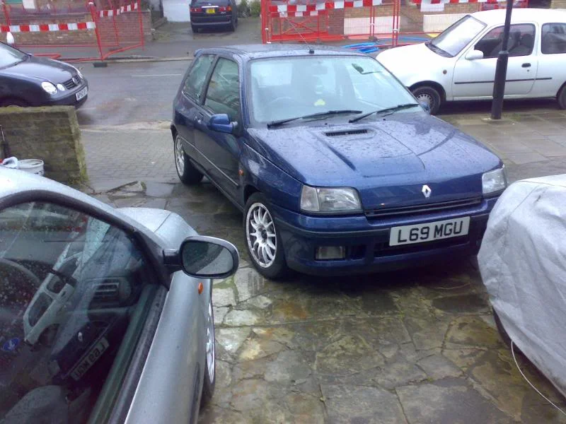

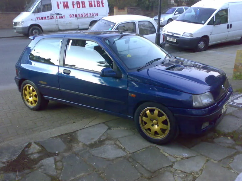

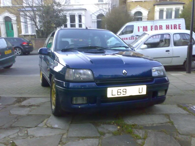

Well I have been on the look out for a mk1 for sometime - was initially planning on getting a valver + widetrack williams suspenson but decided it best to buy a more special car.
Unfortunately the williams 3 I wanted (mat brown's mate was selling) got sold last week so hunting around i found one that looked reasonable and sounded pretty decent so I went to have a look at it this morning - all looked decent enough - went back and bought it.
It needs a lotta things doing to get it back to the way it should be. The wheels are hideous might buy some new speedlines or get a pristine refurb done.
Williams 1 No.69 - Registration from factory L69 **U
123K on the Clock - fully stamped book.
Lots of receipts in folder.
Like any car of this age it has its faults - all of which I plan to sort out in my ownership. I got it for a good price. It will probably get a trip to Nick Hill in the near future for some work and a complete assessment of the car itself.
Just wana say thanks to Sean (seanofnp on wc/c16v) for the advice and lift to pick it up also.
Also to Matteh (c16v), arj256, and shackal(the lil rascal)!!
Thought I would Post up a couple of crappy pics for the time being.
The last one shows No.26 tucked away (whilst my brothers off travelling)
My dead and nearly buried Clio 16v and my No. 69 in the back

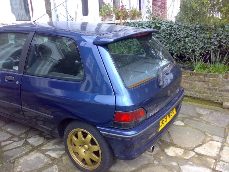

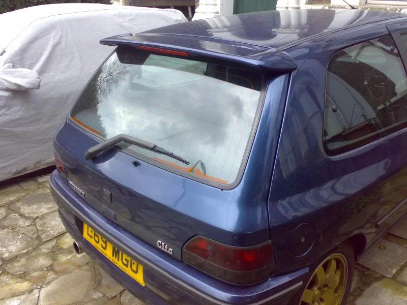

1. The rear of the car looked hugely better and the Williams factory look was restore.
2. Coolant system was nor running far more efficiently after the new rad, flush and installation of Type D. No signs of cream at all - just a clean coolant system which has made me very happy as I knocked the seller for some money due to a possible up coming HG Failure.
NOTE: On the drive home I noticed that the Oil Temperature had dropped by some 5-10 degrees compared to drive up in the morning. This suggests to me the cooling system is now working more efficiently than it was before.
3. Gearbox Oil flush - The actualy feel of the gears felt a lot better than the drive up in the morning. I had previously used the same GB oil in my Clio 172 and it made a substantial difference.
The R19 Mount could not be fitted at the present time. Although after talking with a few other people it became apparent, the PAS pipe which was in the way - could be loosened from its position fixing bolts and wireties out of the way for the installation of the R19 Mount.
Pics of the Old Rear Spoiler/Tailgate.
