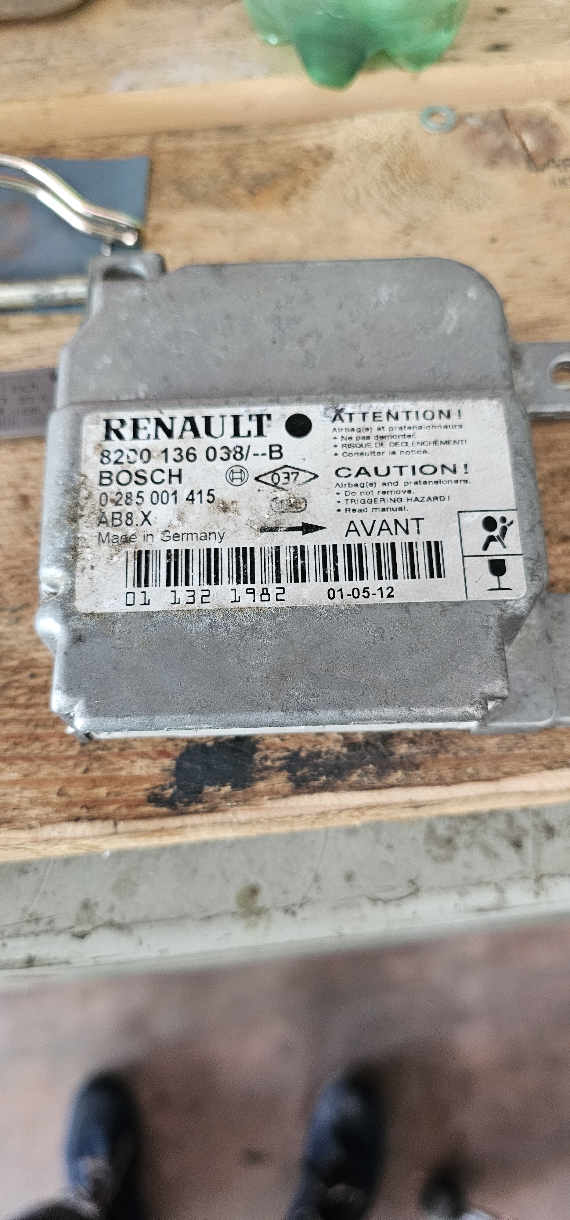

Yep. You can send them off to a guy on Ebay for unlocking or purchase a new one with no crash data.
Just match codes
Okay good enough. So i don't need to replace airbags or anything, just the ecu?
Also, which of the codes do i have to match?
I've found some similar ecus but not exactly the same codes.
Pic

So if I didn't miss any, the 172 has 1 on the steering wheel, one in the dash, and two in the front seats? Makes it 4? So basically a 3 door clio with all 4 of those intact should work fine? Did you just plug it in?
I havent owned a 172, so I couldnt say for sure.
However, yes, if the car you pull it out of has the same number of bags then it will work - mine did anyway!
Literally mate, I pulled it out the breaker car, drove home, shoved it in and my airbag light was gone. It was that easy. I couldnt quite believe it :ROFLMAO:
I know it's possible but I'm in Croatia so posting it would be pretty hard, but still its a possibility.
I've found an airbag module today will try and get back to you thanks
