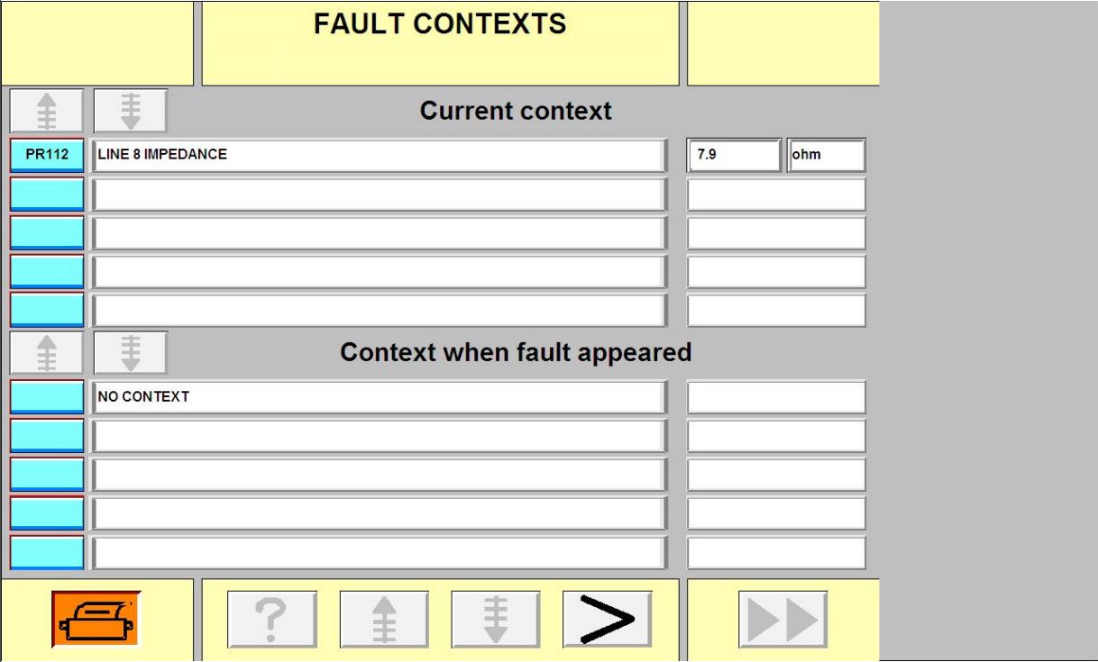

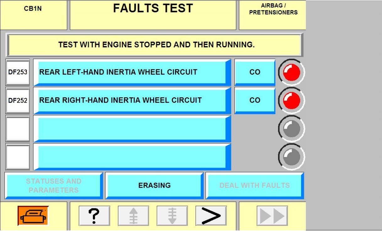

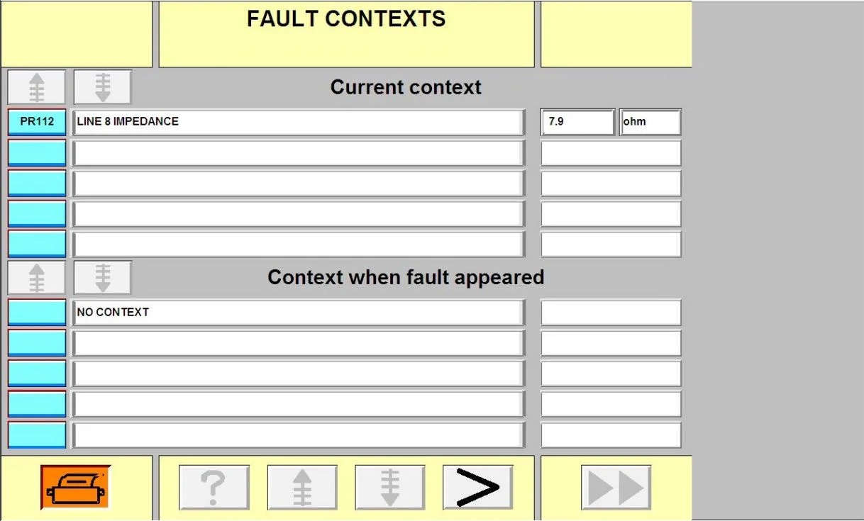

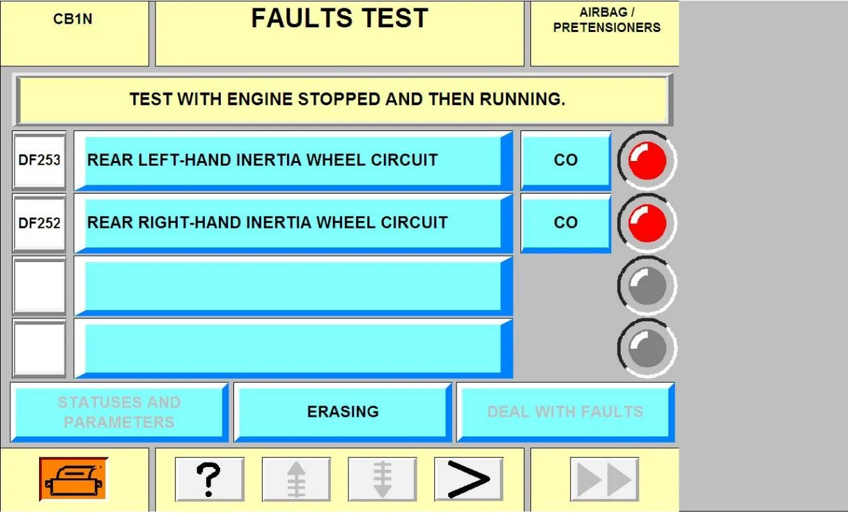

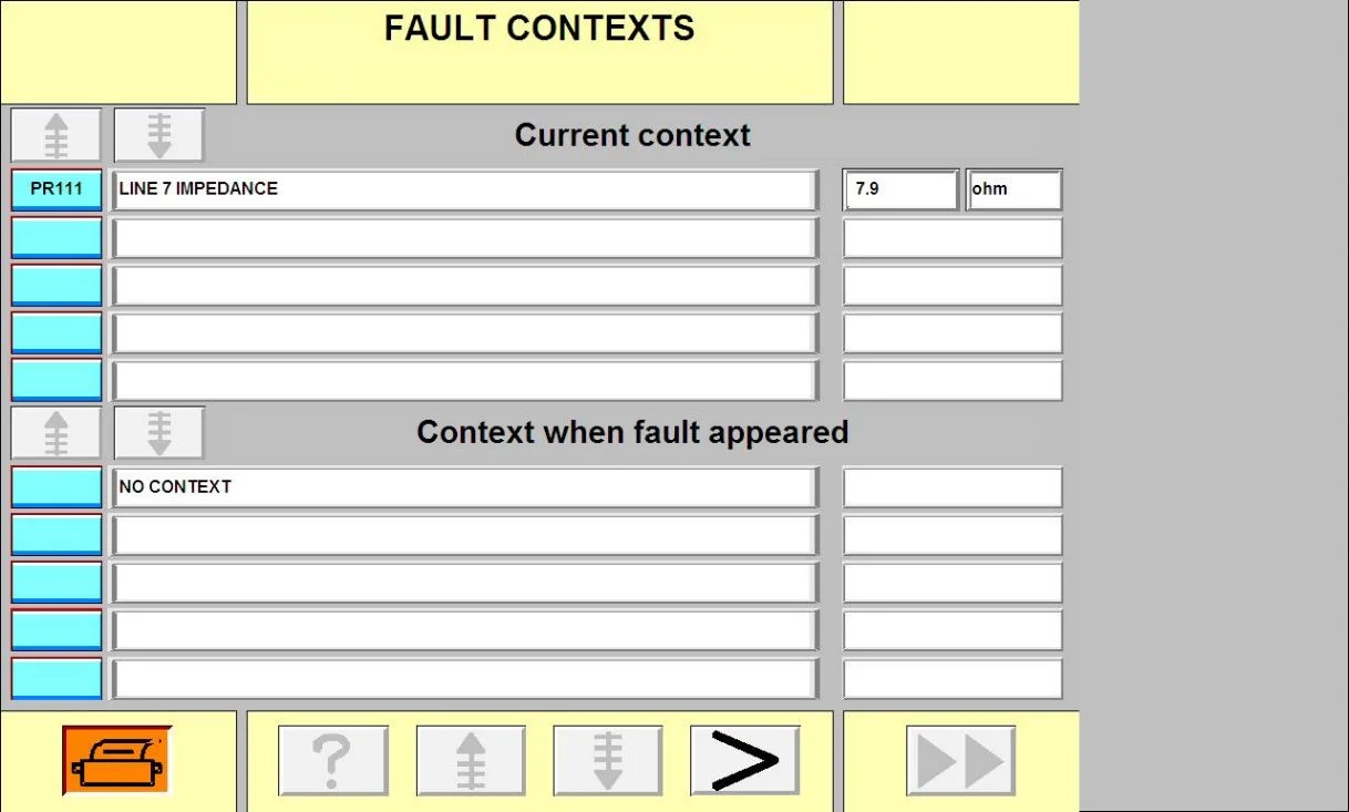

I have a clio sport 2003 model and I run some diagnostics because I have the serv and airbag lights on. The two faults I got are DF252 and DF253.
Here are some pics:
Does anyone know what is this exactly and if its easy to fix it?
I haven't change my car-battery since 2008, could it be the battery that's causing these faults?

I'm on the page that lemonnobby1 is heading to. Sounds like crash context data has been removed (which resets the module to default) and now it's looking for equipment that isn't installed.

I found this from "Little old me" a guy from another forum:
"OK DF253 is the rear seatbelt pre-tensioner has deployed, put a 3 Ohm resistor on it and the fault is gone."
