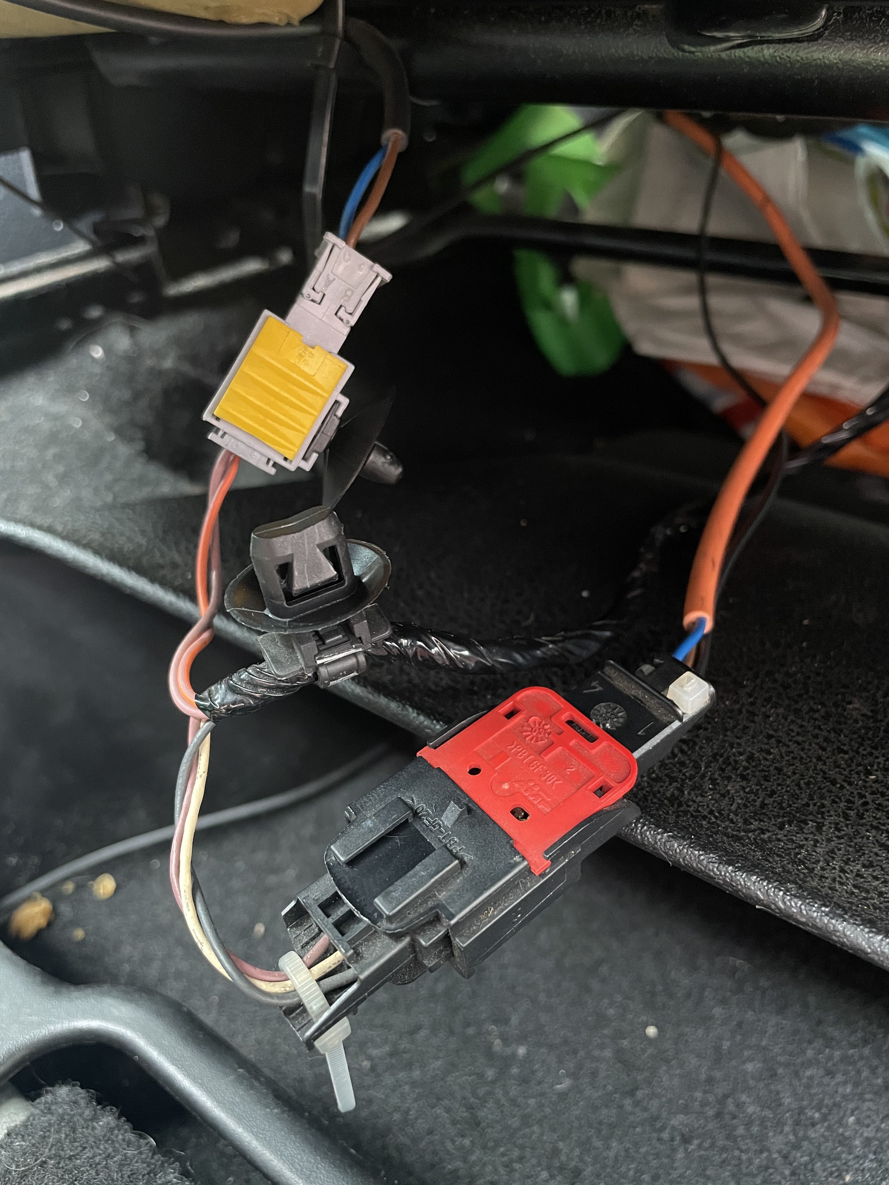

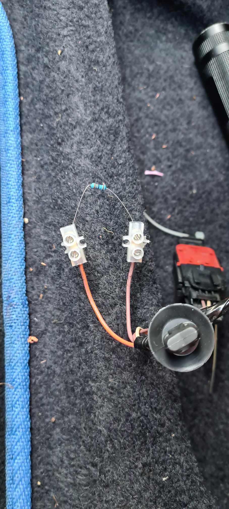

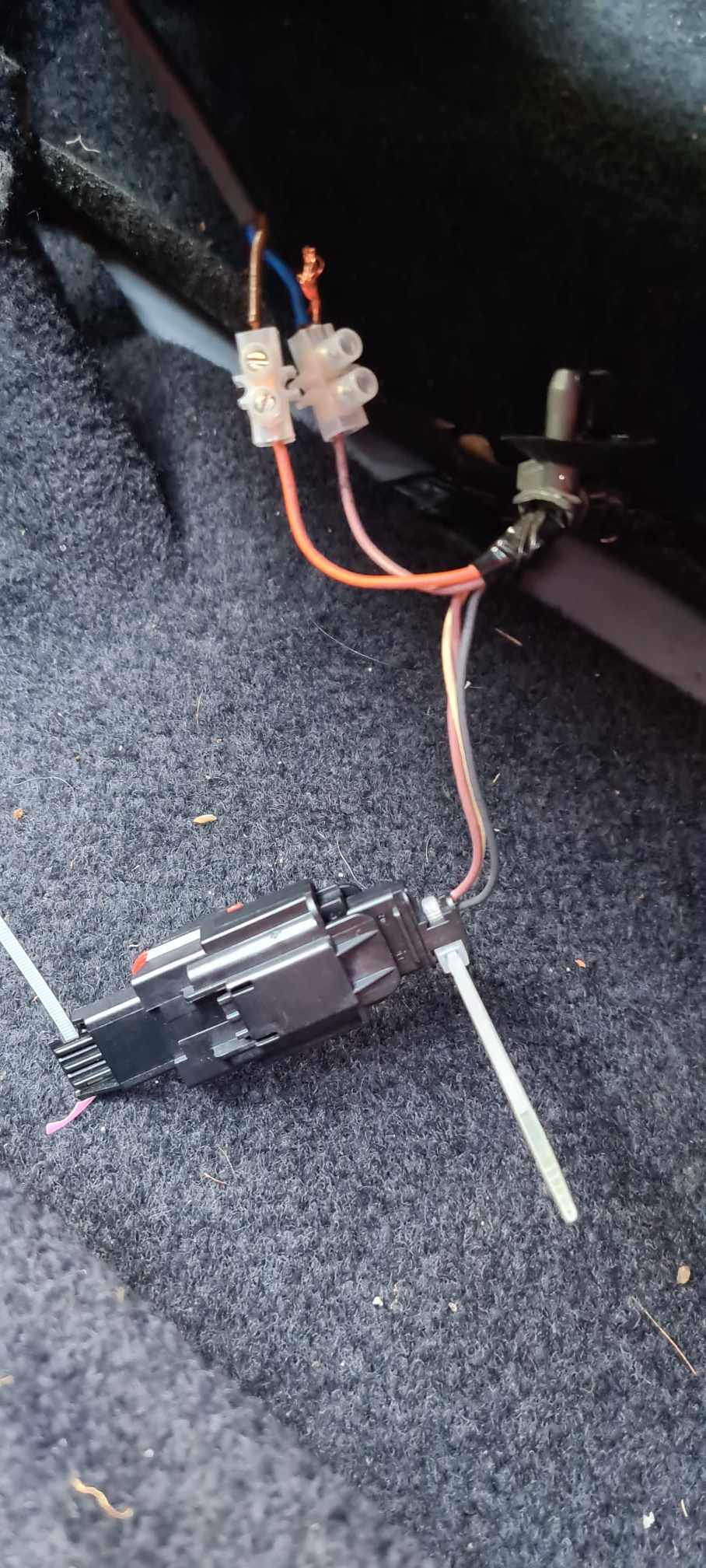

There was no grey connector under the passenger, the wires seem to have been cut and soldered. I've removed this incase it was bad and used a connector block, still no joy. I also used a 3.3 resistor but nothing.

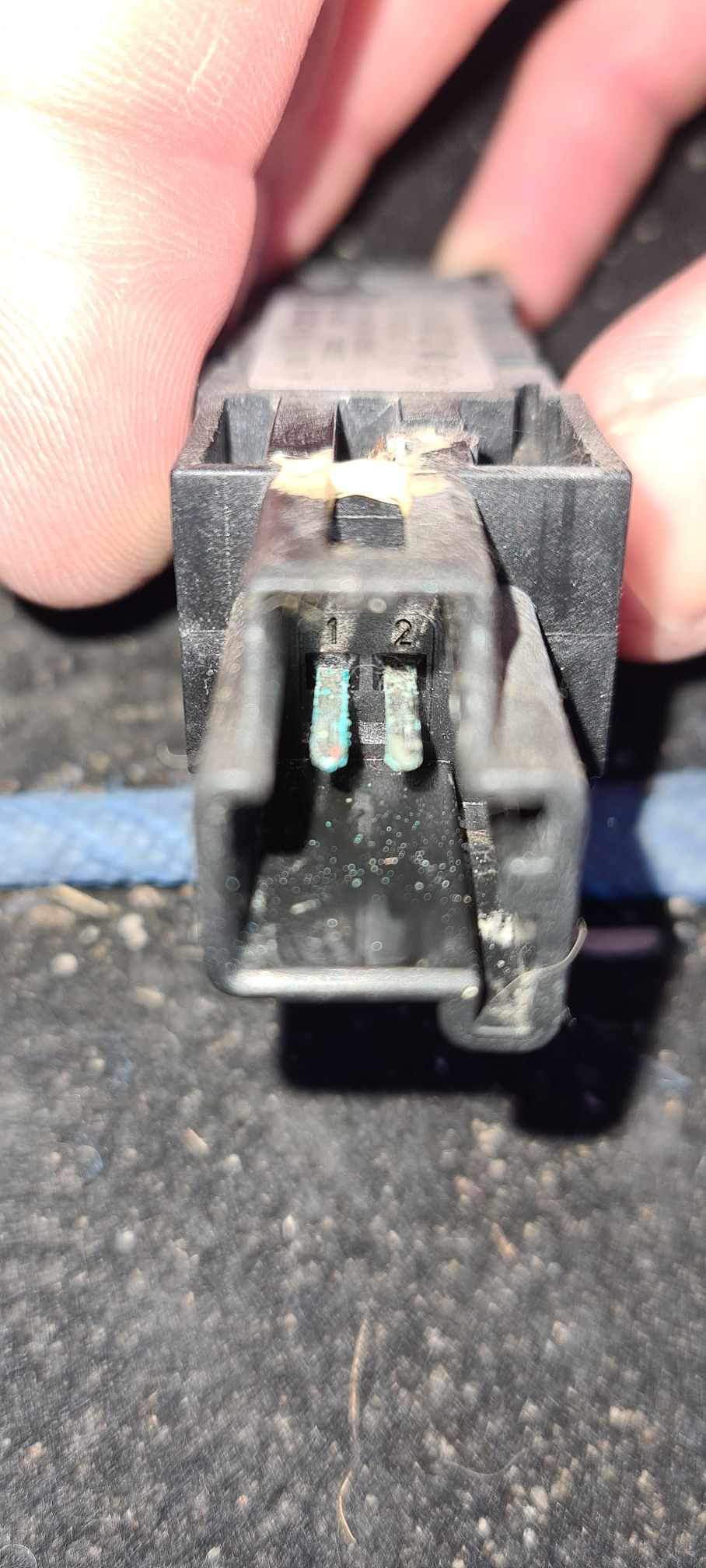

I then had a look at the side impact sensors and used a 3.3 resistor there but nothing, although the drivers side does look a little corroded, it's hard to clean up the contacts given how small they are.

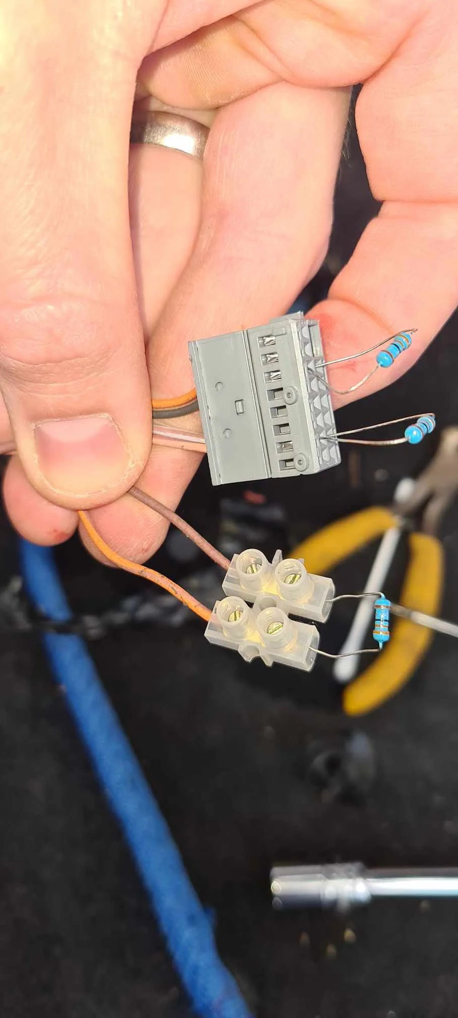

I had two 3.3 and then 3.9 resistors in the connector for the steering wheel, no change.
I've also had a 3.3 resistor in the drivers plug in the past but again no difference.

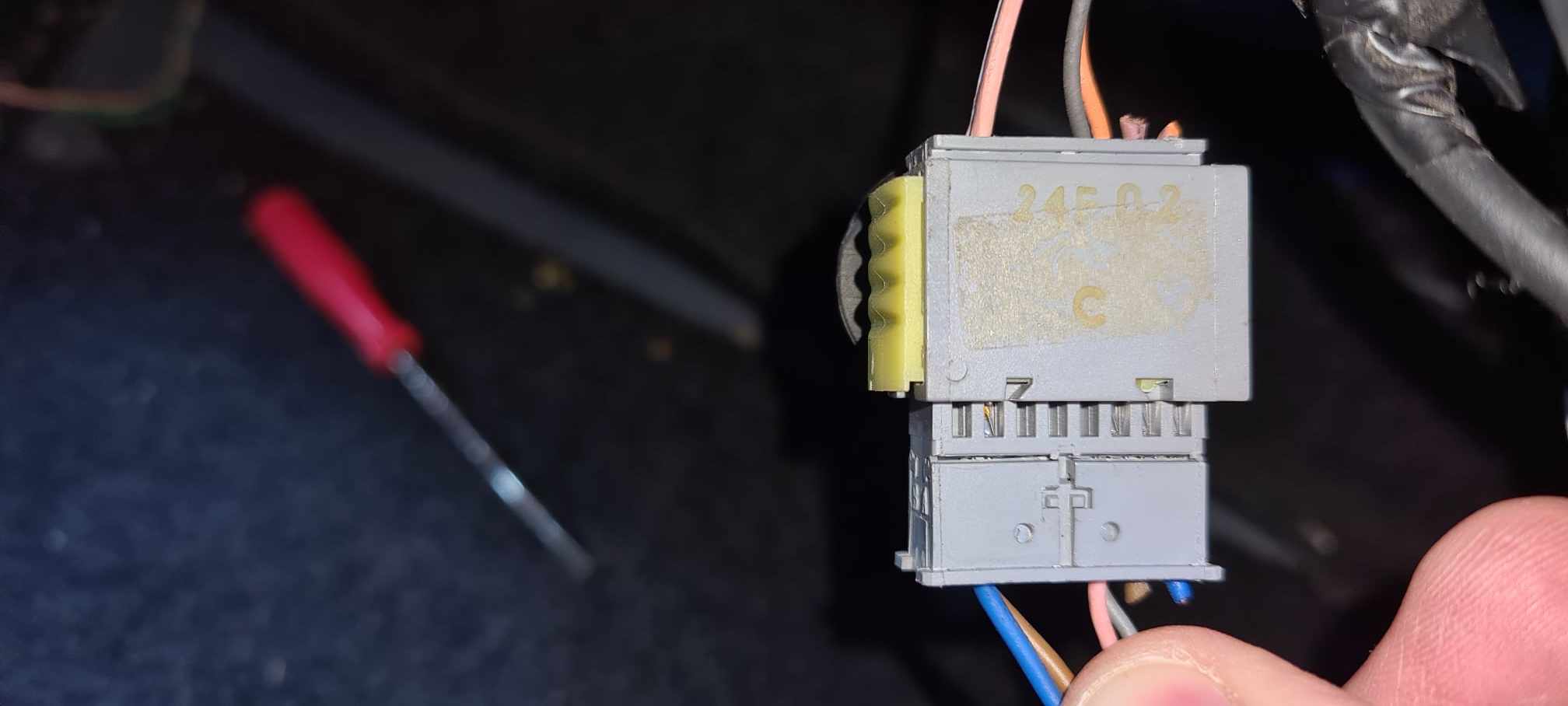

you can see on the drivers side grey plug, two wires have been cut, I traced these back and found them soldered to what I think is the pretensioner. I cut these back and added a connecting block with a resistor, I think at this point everything has had a resistor in it.

I thought the airbag light would go out as soon as the issue was resolved, seemed in my case it wasn't instant. When I went to the car the next day, the air bag light was out. Given the only issue I could find was a corroded plug, I think it was water ingress into the drivers side impact plug.
