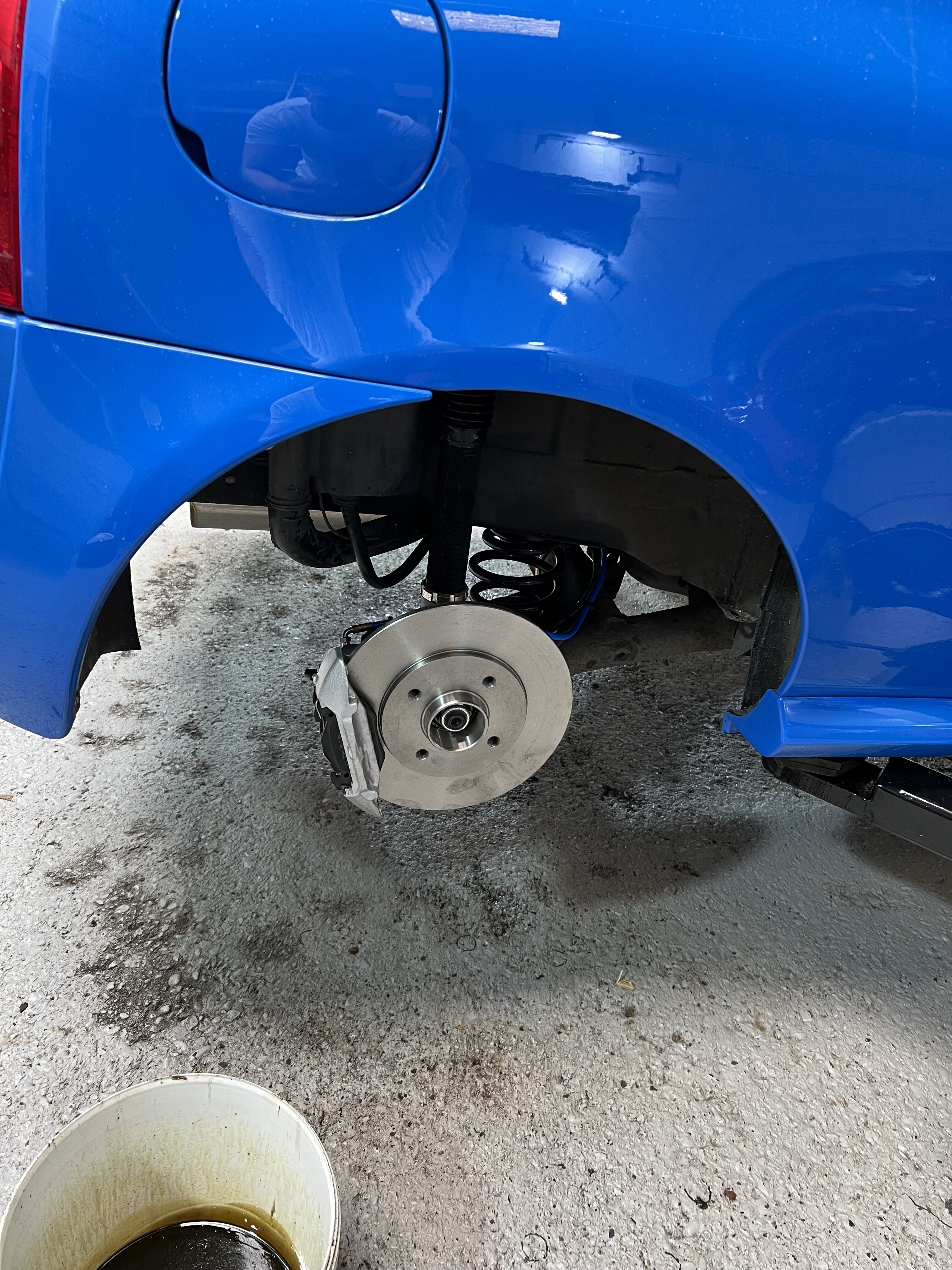

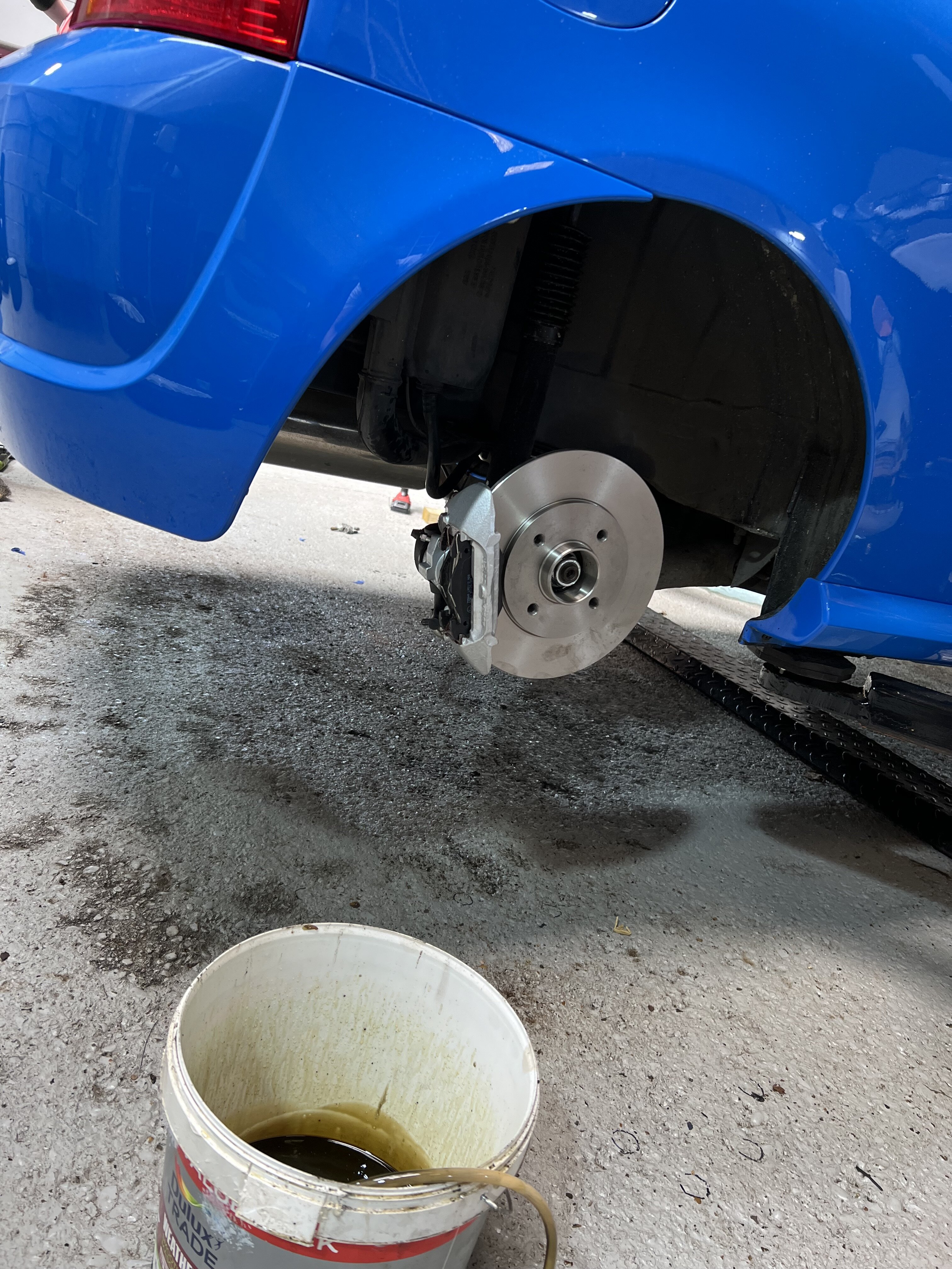

Strange one with the wheel bearing play as I've replaced both rear Discs and pads with Brembo ones which people recommend on here (SNR were OOS) so not sure what's gone on there, only the nearside had play, odd.
Any ideas on whats going on there guys?
Rear disc spacers on and facing the right way?
They are on, I will double check on the spacer as its possible I put one side on the wrong way, schoolboy error if so! It's torqued up to 175 so it isn't that.
OK, I've tried to take the disk off and it won't come off ffs the Garage said they nipped the hub nut up and I'm guessing that's the reason but may be wrong.
I've smacked it with a hammer and pulled on it with the wheel back on and it literally wobbles like the play the guy was talking about, no chance it's coming off.

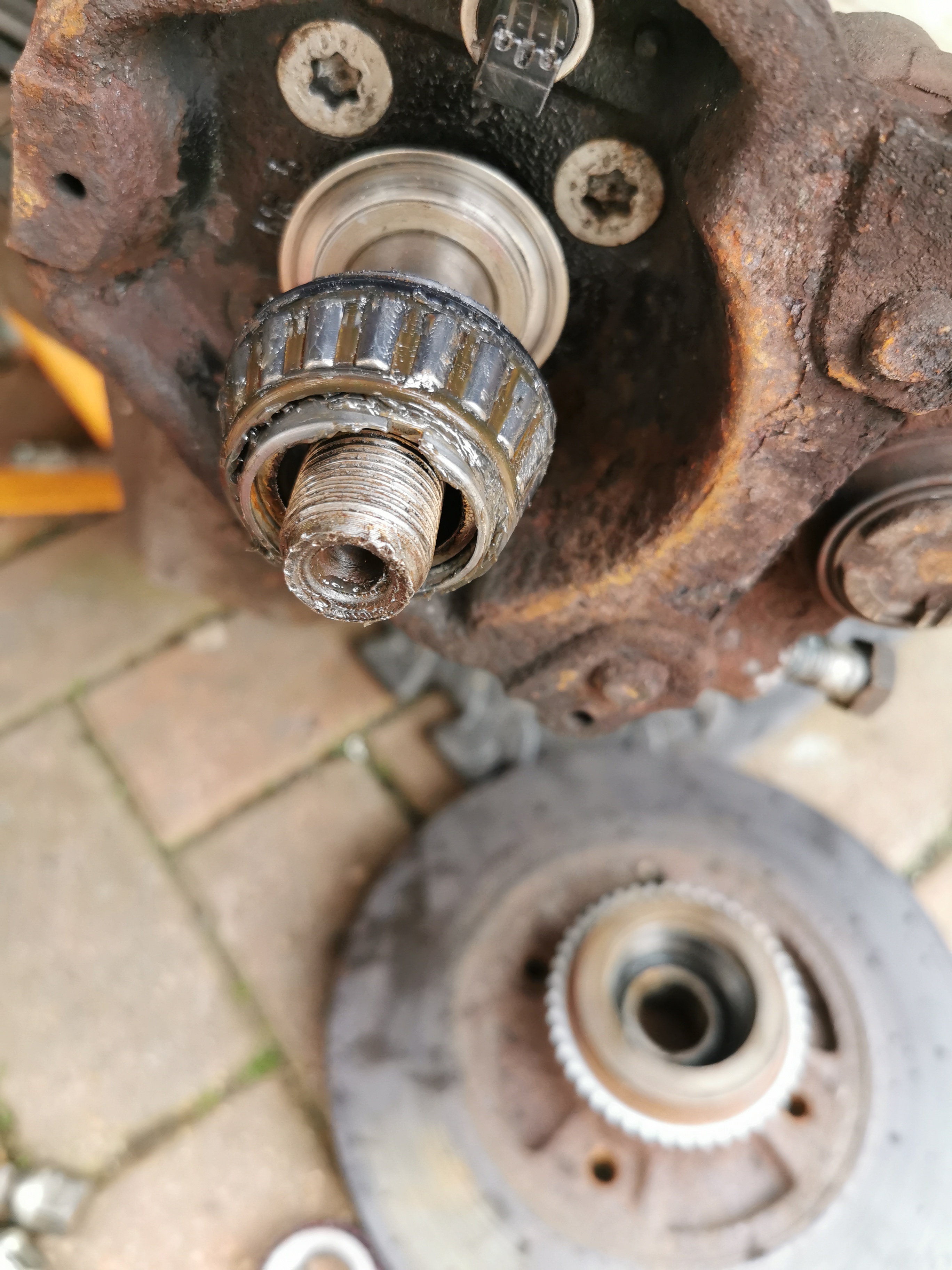

Cheers for the replies lads, I've finally managed to get it off with brute force and lots of #@£#*# at it! Disc is proper fcuked now, fell apart ffs absolute joke it was on that tight.
Oh ffs, French piece of Sh**
This happened when attempting to put my disc on, thought it was tight going on and it wouldn't so attempted to pull it off and it left this behind.
Joke.
Just out of interest, anyone know why the disc didn't just slide on with ease? I made sure everything was clean and I even lubed it up to encourage it but it wasn't having it?
Not sure, mine went on piss easy :/
Changing discs on the 1*2's should be a doddle tbh. Remove Stub Cap. Remove nut. Remove disc. Check and replace spacer. Clean off area. Lightly moly the shaft (giggidy), slide the new disc assembly on carefully. Locate. Tighten to seat. Drive down the road and back. Then re torque. Replace Stub Cap.
