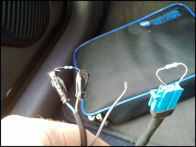

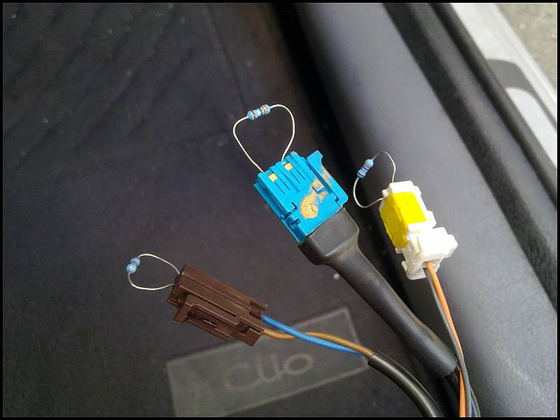

This is what i have coming out from under the seats (on the car loom side of things) and so took to jamming resistors in everything i could find, including to two wires that i can assume would have had a connector block attached at some point.
Still the lights on the dash stay lit though.
Can anyone whos been successfull in getting rid of them in a ph1 see if im doing this correctly please.
Drivers side
passenger
airbag
If it's done correctly, you need to reset the ecu using a diagnostic system through the OBD por.
Some say they go off straight away, some disagree, its a very grey area it seems. I'd love there to be a definative guide.

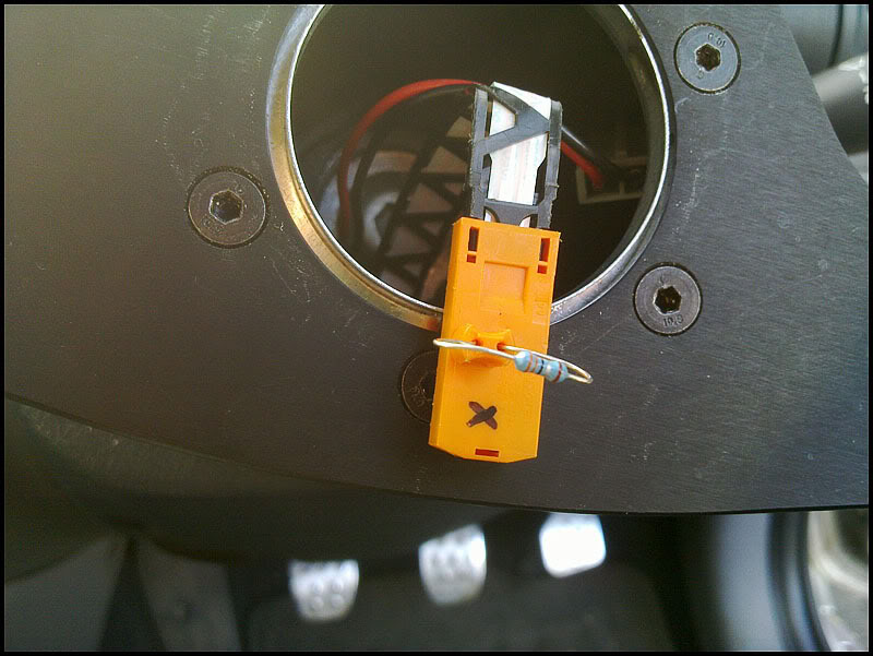

Next month my ph2 seats will be wired into my ph1 (professionally and correctly) so then the only thing left to do is the steering wheel, I'll see what it takes to get the light off and report back.
