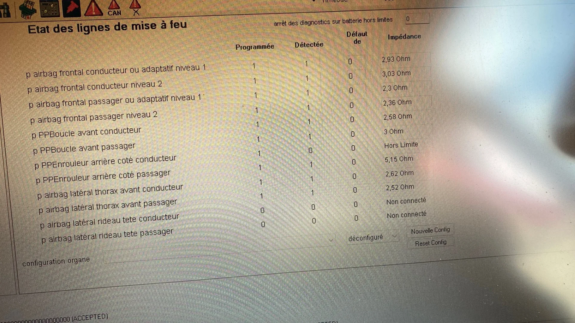

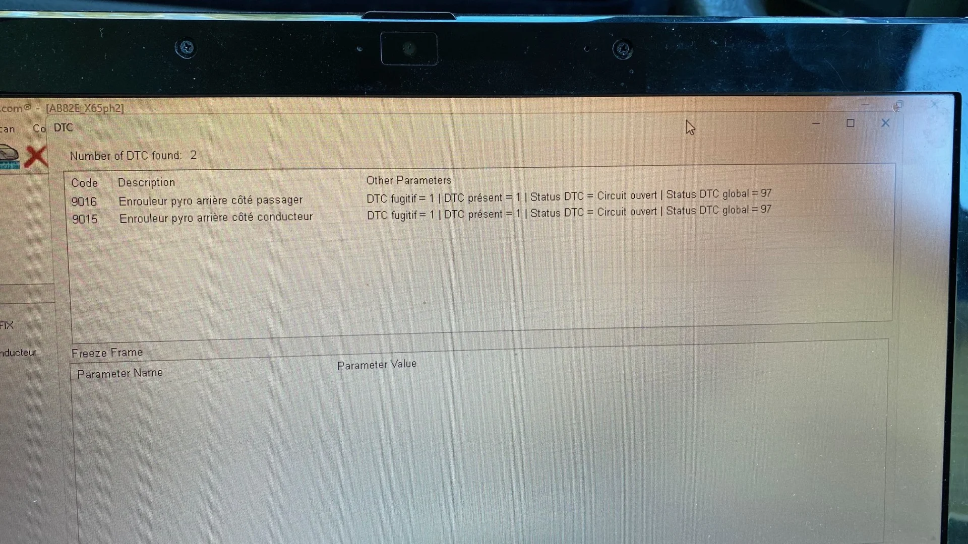

I scanned the car with Renolink, and the fault codes point towards therear seat belt pretensioners. You can see the codes in the attachedimage:
  • 9016 – Enrouleur pyro arrière côté passager (Rear passenger side pyrotechnic pretensioner)
  • 9015 – Enrouleur pyro arrière côté conducteur (Rear driver side pyrotechnic pretensioner)
  • Both codes show “Circuit ouvert” (Open circuit).
  • The fault is both present and active (DTC présent = 1).

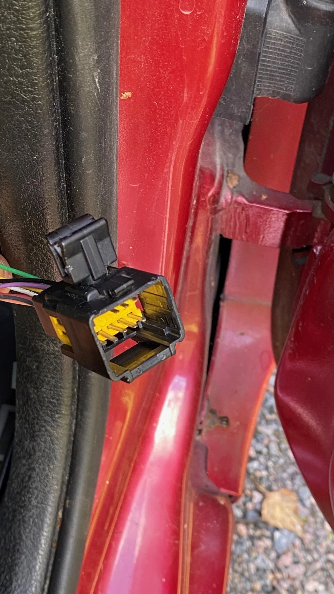

I highly suspect I’ve left a wire unplugged somewhere, but I justcan't find the matching connector for it.

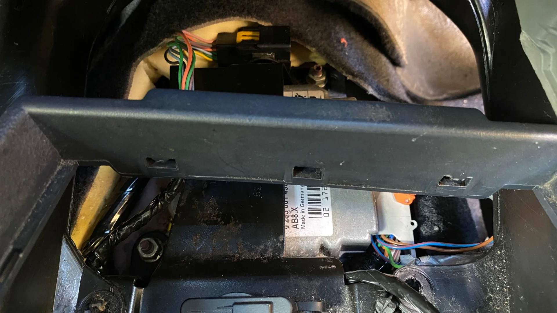

On the passenger side near the door/footwell area, there is a looseblack and yellow connector (shown in the picture) that I can't find amatch for. The wire doesn't reach very far, maybe about 20cm, so roughly to the glovebox area. On the other hand, it looks like it might come from the airbag module inside a larger wiring loom.

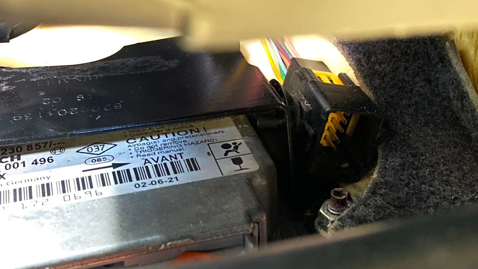

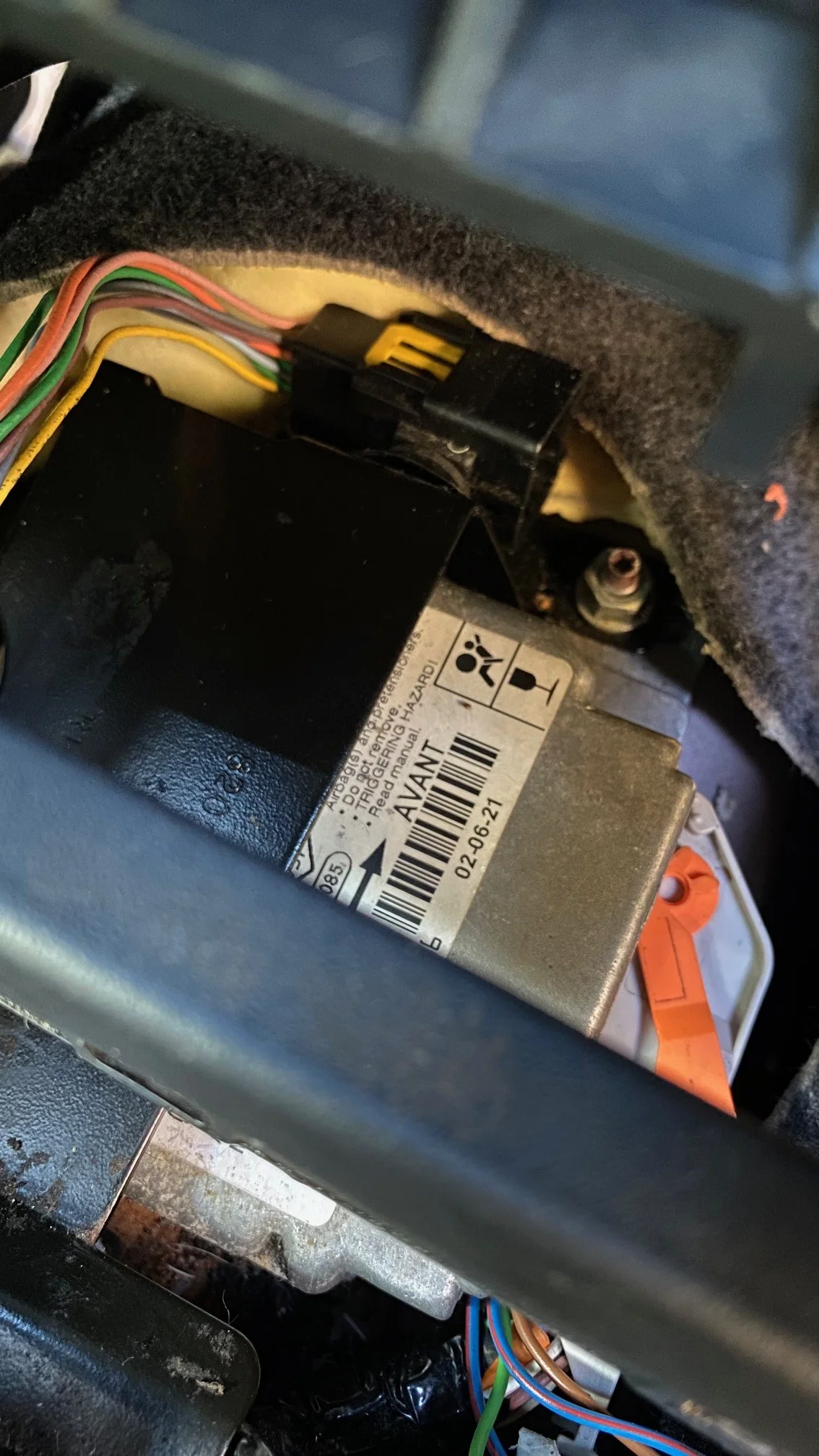

Additionally, right by the airbag module, there is an identical yellow and black connector, but I can't find a matching plug for that one either. Is there supposed to be a wire connected to it? I was wondering if a wire should run from there up along the side of the heater core housing, but if so, I have no idea where I could have misplaced it. Or could this be a completely different issue? I strongly assume everything is related to this loose wire...

5ohms does indicate some issue with the rear. Unsure about the connectors though.
Problem is that there is no pretensioner in the back of the car, I check both sides and also seat buckle, so... How do I continue from here? I get the fault codes, but there is no pretensioners at the rear of the car.
