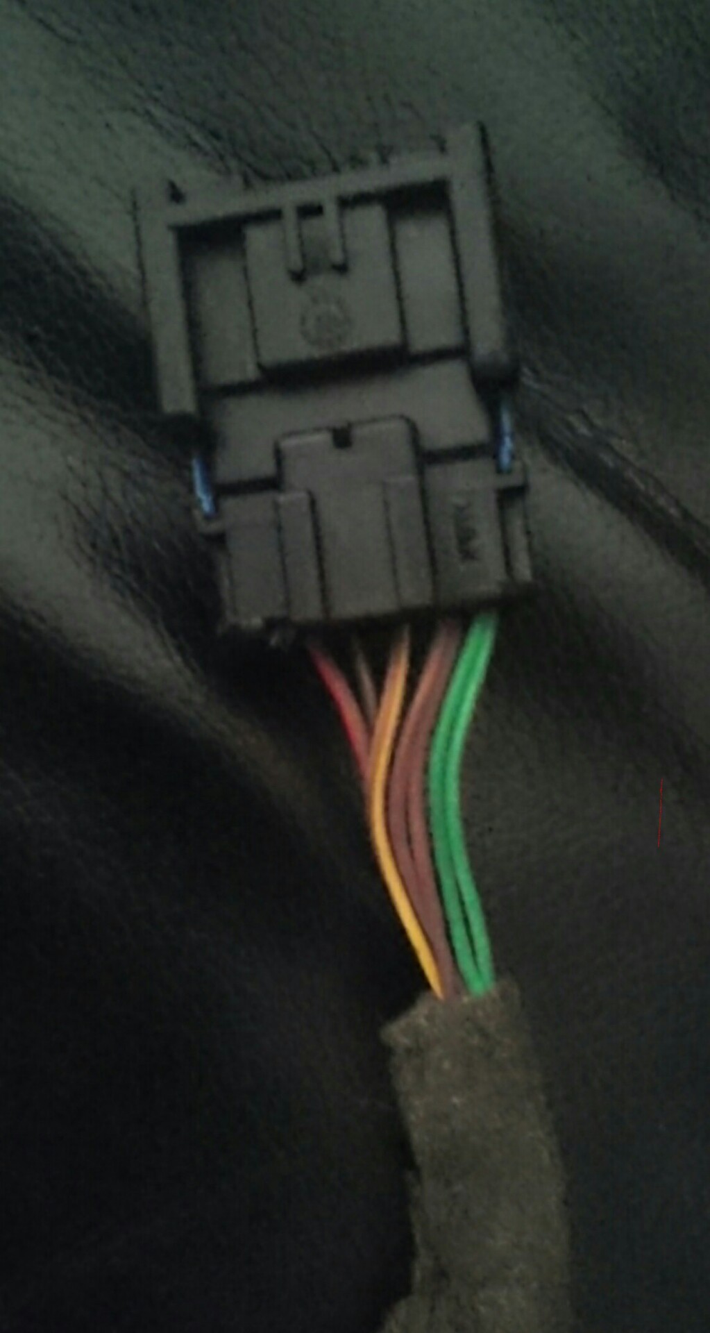

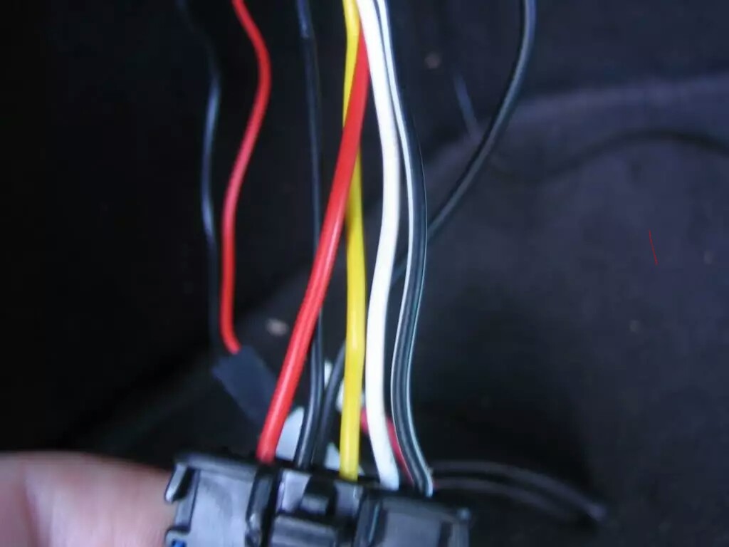

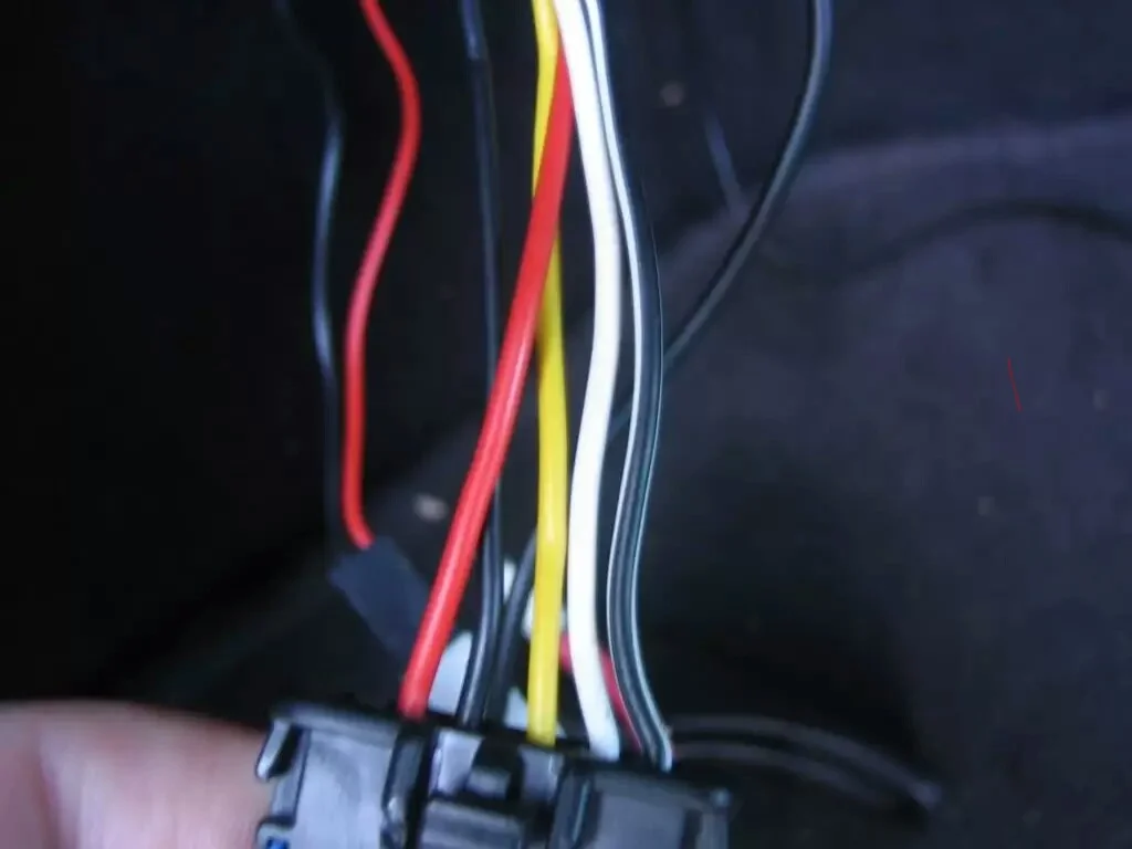

  182
I've been looking into this, i've got the plug.
So the alarm black/white goes to the 2 green wires.
Alarm white goes to the 2 brown wires.
Alarm yellow goes to yellow/brown wire.
Alarm black goes to black/brown wire.
Alarm red goes to red/brown wire.
Now i've traced these wires back in the spare loom i have and this is what ive got.
Green wires: 1 runs off to hazard switch(green wire) and the other to the uch green connector(pin29)
Brown wires: 1 runs off to auto lock button(brown wire) and other to uch brown connector(pin15)
Yellow/brown: runs to fusebox (i got s6 10A) but did find its ment to be s7 15A
Black/brown: grounds off back off speedo area
Red/brown: runs to fusebox s29 20A
Hope this helps
