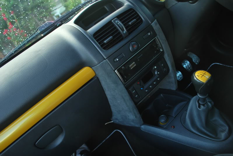

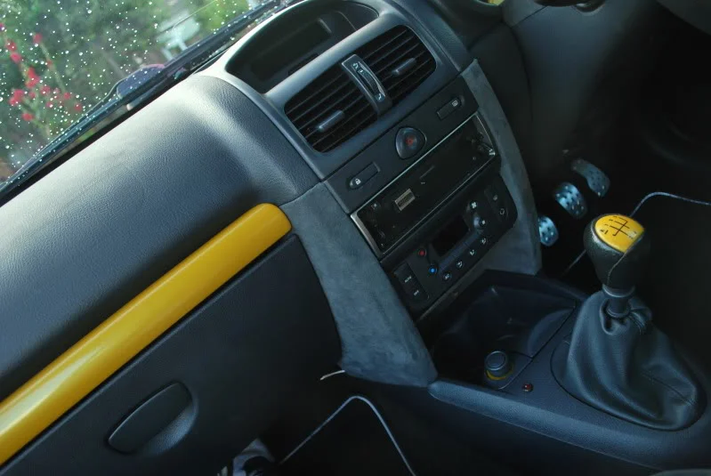

finally some pics of the alcantara bits i covered last week, hope the pics reflect the finished results

How did you do the centre console then?

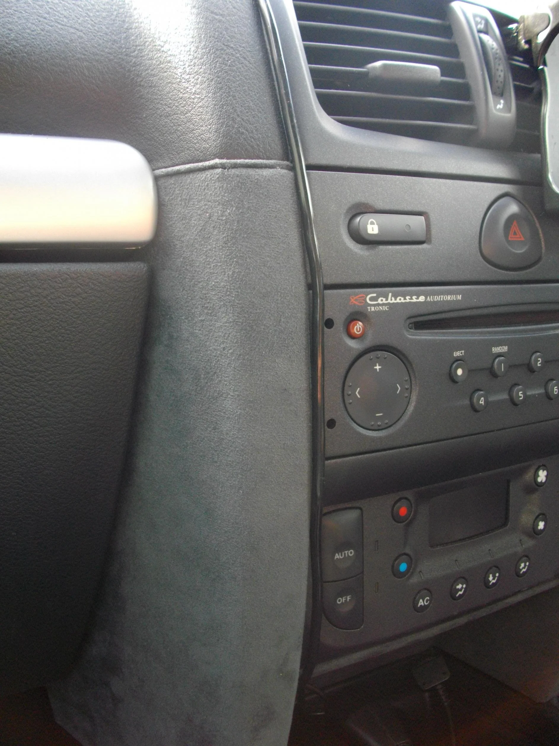

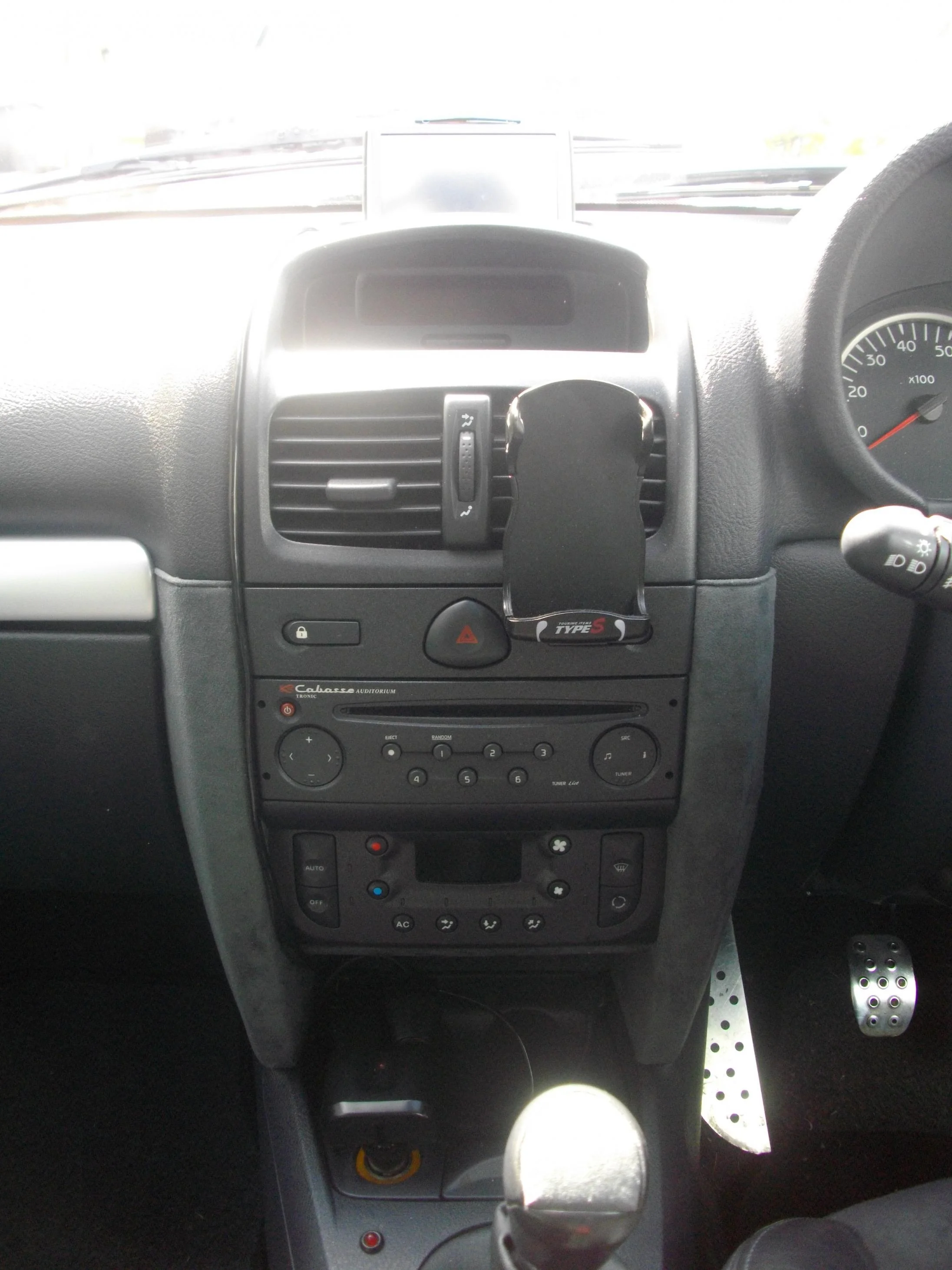

no i didnt even think about that..im going out now to have a look, the centre console was easy peasy, the parts come off quite easily(although i did break the clips) and then simply cut alcantara to rough shape, spray with carpet glue and wrap. then its just a case of making it look smart. i used a small scrap of material to make a type of beading for the top of the centre console where it joins the dashboard, it just makes it look a little more 'professional'

to be honest i did find it pretty easy, it really helps to plan everything before you start and be carefull when spraying the glue as it can make quite a mess. im really pleased with it so thanks for your comment

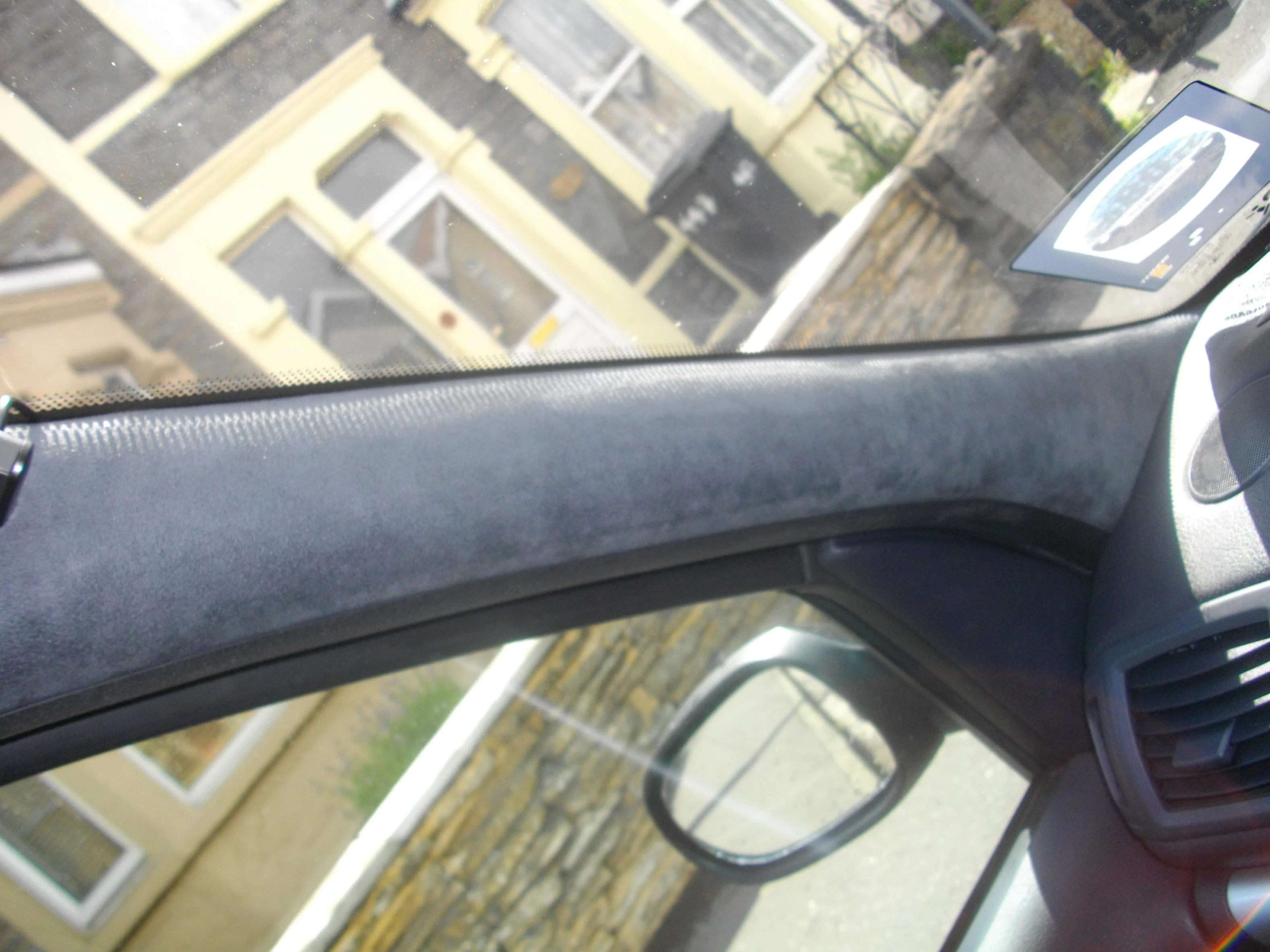

My alcantara came this week, so i'm gonna make a start on the pillars next week :D
good stuff. get yourself some good quality superglue for the edge where the material folds over. i didnt have any so i used the same spray glue which i used for the front part...it was messy!
