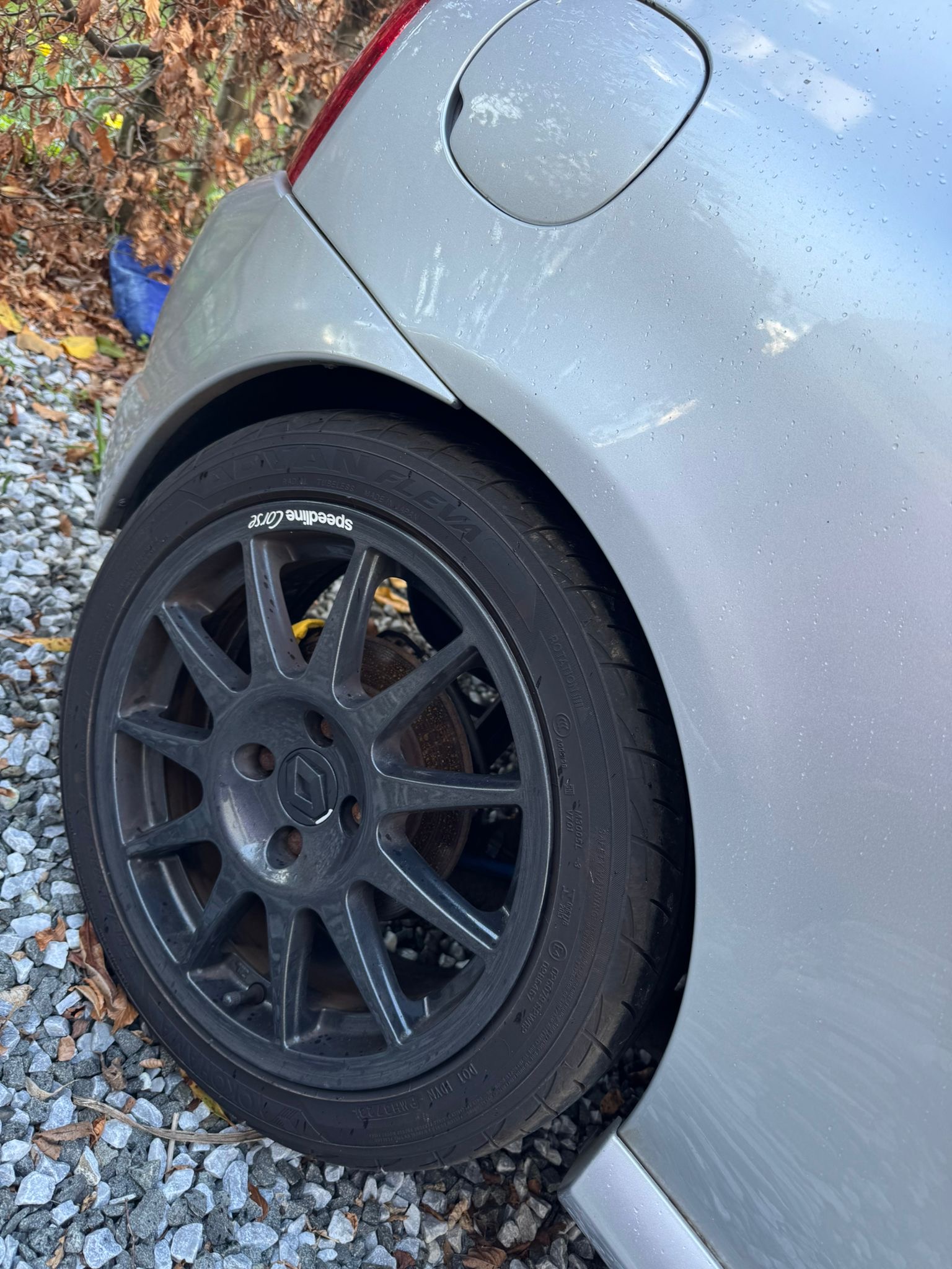

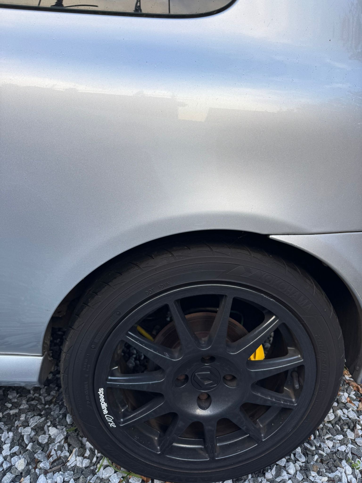

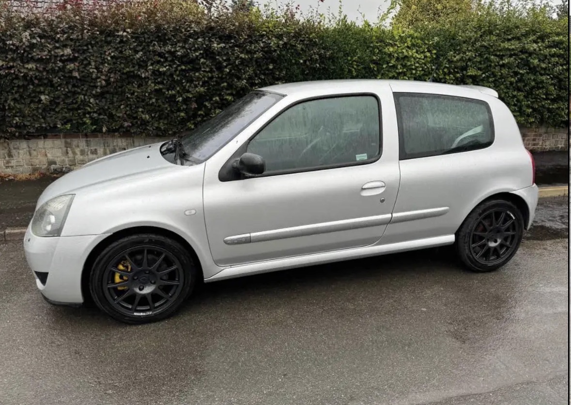

Hey, so planning on visiting a 182 near me. Asked for a few pics of what I think are hot spots. Clearly I’ll factor service history etc but hoping some of you may cast a more experienced eye. Arches look good, what do I check more clearly when seeing IRL.

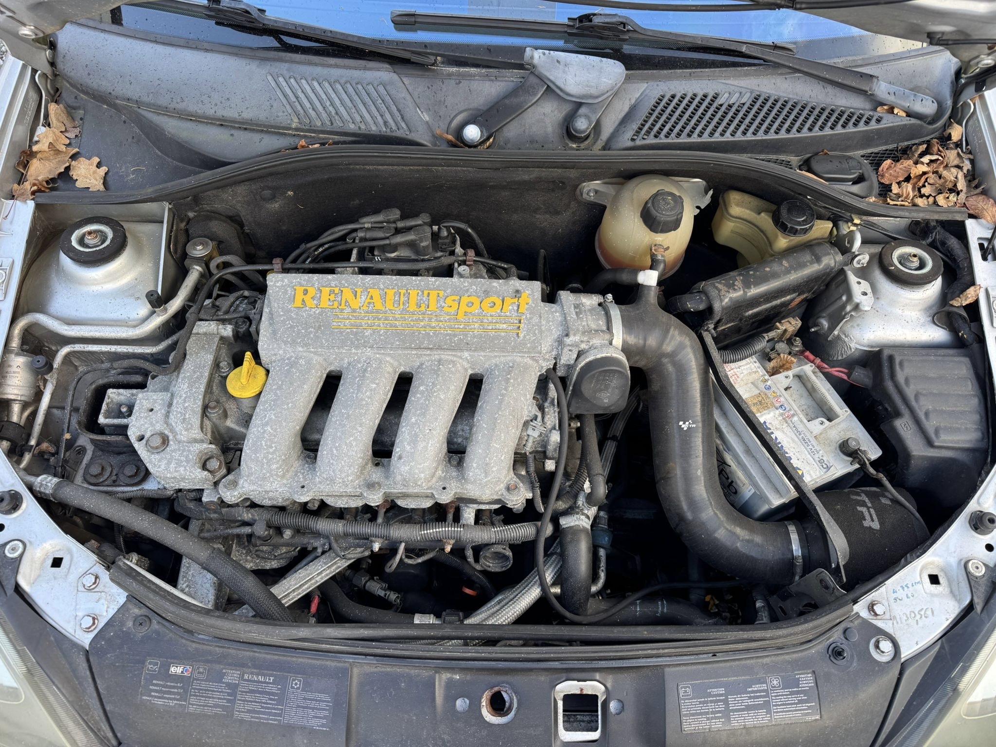

Engine bay, seems to be missing cover and injector cover, is this a concern? Any other thoughts?

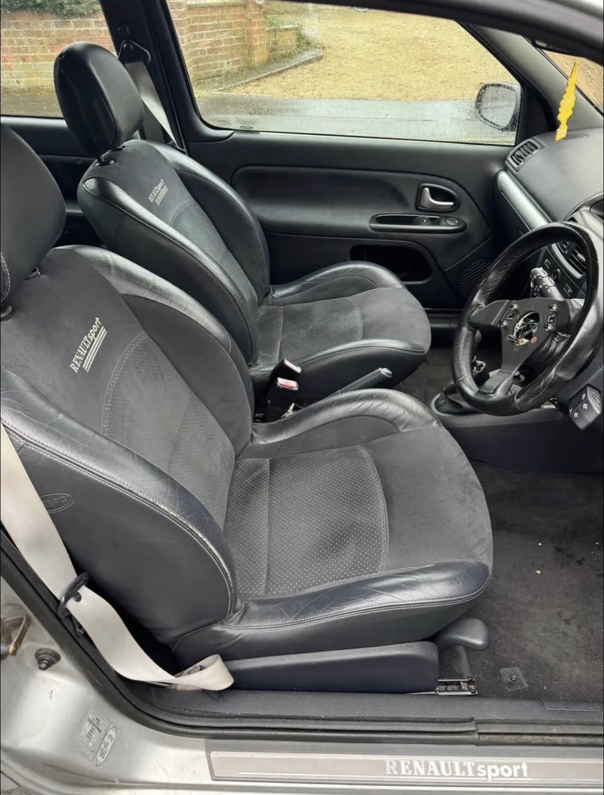

The steering wheel is horrendous.
The engine cover and injector cover being missing is pretty normal these days, they don’t find their way back on after oil changes.
It looks okay in pictures, check for rust in the fuel filler flap and around the arches.
The only little red flag for me is why wouldn’t a seller whose taking pics to send to a potential buyer not clean the leaves out from the scuttle, what else don’t they bother about if they can’t do something simple like that.
Rear sills are common for rust too, but usually you'd see bubbling in the lower rear arches before the sills are bad.

As the engine and injector covers are missing, I'd check for other things too. Under trays, arch liners, etc.
Thanks Colesy, so on the arches I’ll just get my hands up in the wheel well and feel around, will also check the fuel filler area.
Reassuring on the covers, seem easy and cheap to rectify if I want too.
Totally agree on the wheel, hoping the Momo Boss aligns to better wheels and a Voluntech panel (assuming I end up with it), if not I’ll just replace the lot.

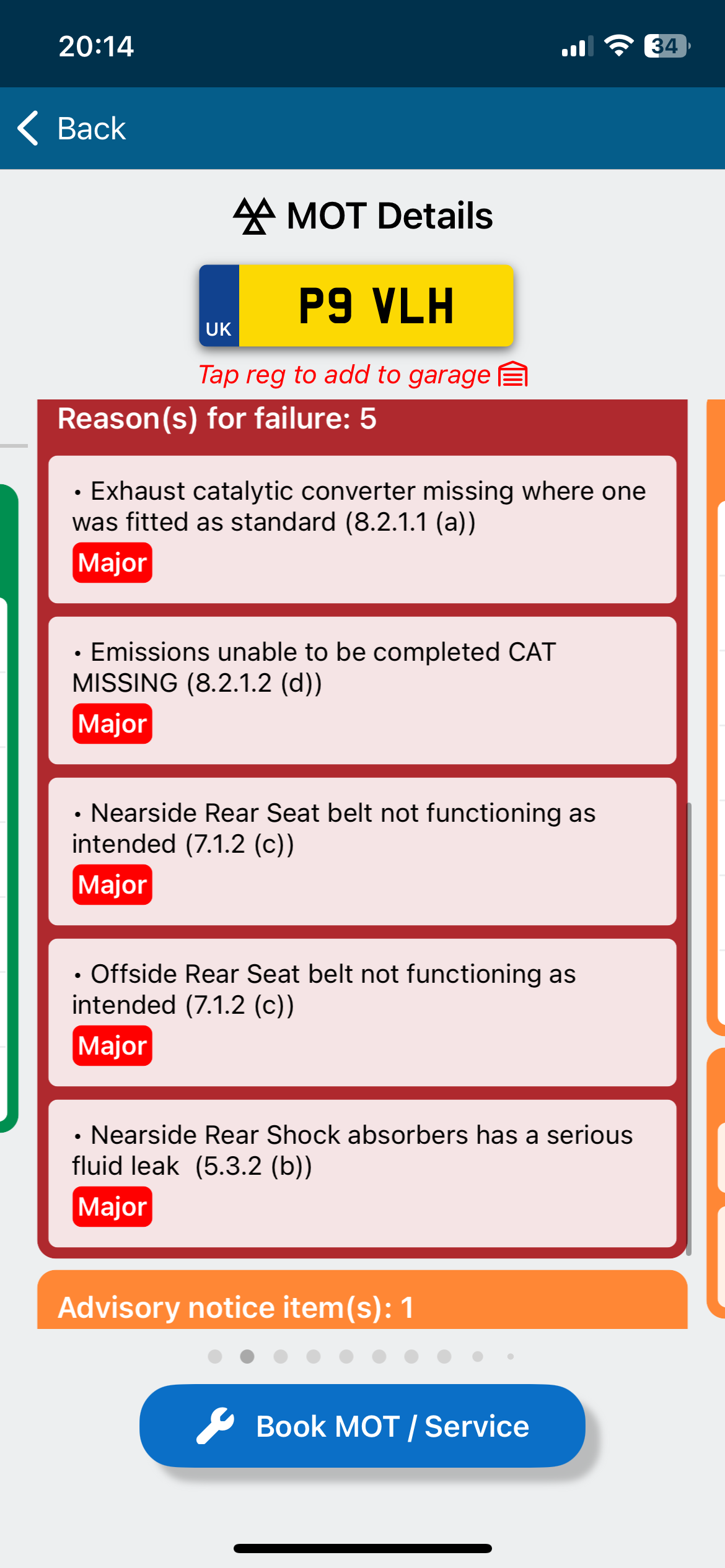

So currently a decat fitted, he believes he still has the cat but needs to check. It has a K tec cat back system - I assume any 182 cat would fit, I.e cats2u for Most, or is this going to be a case where some mods would be needed?
Not overly concerned if it’s unbolt, and bolt in but if it’s cutting and welding it’s another and need to factor into negotiations if the rest is right.
That s**t steering wheel and decat will fail the next MOT, so deffo get the originals off the seller or something off the price to sort that out.
OEM cat is worth £400 scrap at the moment (that's what i got for my 172 cat a few weeks back) , so I'd want at least that reflected in the asking price, as you're going to have to get one for the MOT, or spend £250 on a good (i.e not KTEC) sports cat and have it welded in.

The ktec exhaust is decent quality wise. Their cats only have a 6 month warranty, the last time I checked, which says it all, really. I've read a few stories of people failing MOT's with brand new cats.
Your best option is to buy an original 182 cat, they're a 200 cell cat from the factory, so they are already a sports cat. The quality is much higher than any aftermarket cat available. And prices have dropped since the highs a few years ago. I'm sure I've seen a few up for sale for £200-250.
Thank you all! Steering wheel an MOT failure due to no AirBag? It does have a boss cover and horn.

It looks solid, 4 matching new tyres Yoko Advan Fleva? On Sportlines.
