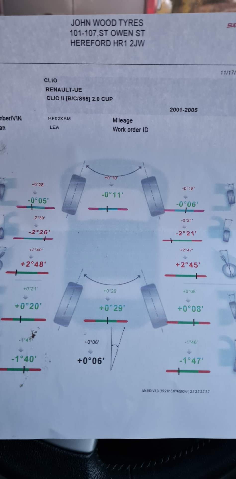

Getting my car alignment done today any recommended road set ups?
Well this is what I went with, my ghetto home camber and toe alignment wasn't all that far out. Corners so well now though, set up by Lea Wood who used to race in the clio Cup series I believe
  • Like
Reactions: MLB
Could do with a 10 minute shim on the passenger rear to be perfect, but otherwise looks good.
I've had the beam off and back on, lining it up with a tape measure so I'm quite impressed it's that aligned
