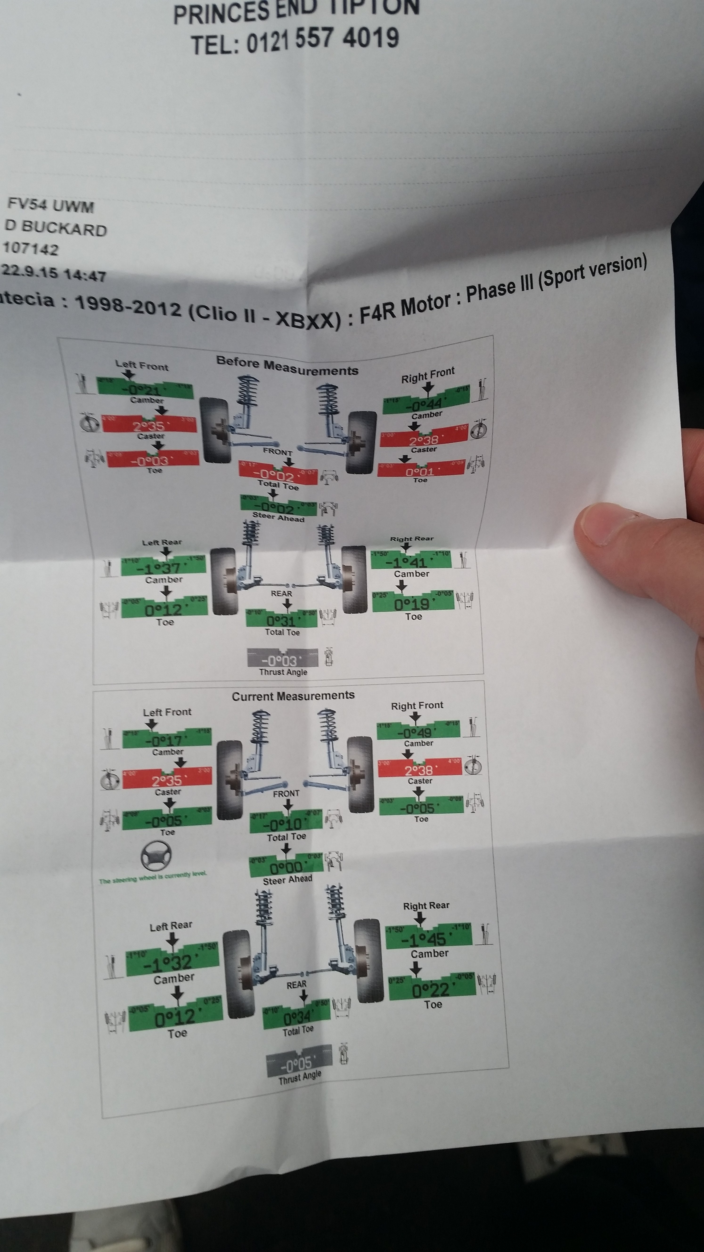

Opinions? Does this now appear correct
  PH2 172
My apoligies if I`m wrong,but the data sheet is headed Clio 1998-2012.
According to the tech manuals I have,Phase 1 172 CB0M (3286A) has 10` toe OUT +/- 5`COMBINED FOR BOTH WHEELS,& Phase 2 172 CB1N (3676A) has toe IN 32` +/- 10` combined.
Sorry I dont have any 182 figures,but it would be worth getting the correct figure from CS specialist with access to Renault data.
Guys I use always set my non cup phase 2 172 on 12`per side(24`combined) toe in,seems good on feel and tyre wear.
Perhaps 5` toe in is a little shallow?
  182
I thought this. But it seems okay driving wise.. @MicKPM can you cast your eye over this.
MicKPM
ClioSport Trader
  Clio16v/Zoe Z.E.50
Seems about right to me on a standard vehicle.
Remember, some of these cars are so old now with bushes and links that are that worn, you may struggle to achieve these numbers or even be miles away from them.
