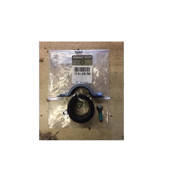

I had recently replaced my passenger side outer tie rod end as it was a MOT advisory and alignment done (toe adjustment only). I did 450 miles on the motorway with no issues. However as soon as I entered the city the alignment had been thrown out again? (steering wheel about 5/10 degrees to the right) All locking nuts are tight and nothing has moved. Could this be strut tops (did notice these rotating as I turned the wheel by hand) or steering rack bushings? I do need to change the arb bushings too.
