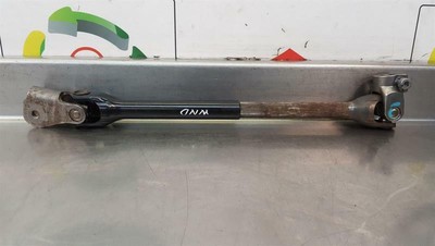

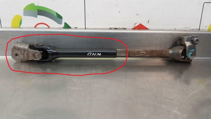

You need these solid rack bushes
And to replace the columns lower joint with this solid piece. The original is very sloppy.
You will never get rid of that play without these. I have a standard 182 with the above and it tracks dead straight over bumps/ruts, I also have a track clio with a manual quick rack and that is even better due to no torsion bar, but is heavy to say the least.

You replace this piece, it takes a little heat to loosen up and then hammer off, I use a rubber mallet to not damage it. Then measure the column to make sure it goes back on in the same place, although you have some room for error. Of course making sure its clocked the same as well.
I think the welding was done on the mk1 clios, the 1*2s have a rubber insert, thats why they are sloppy.

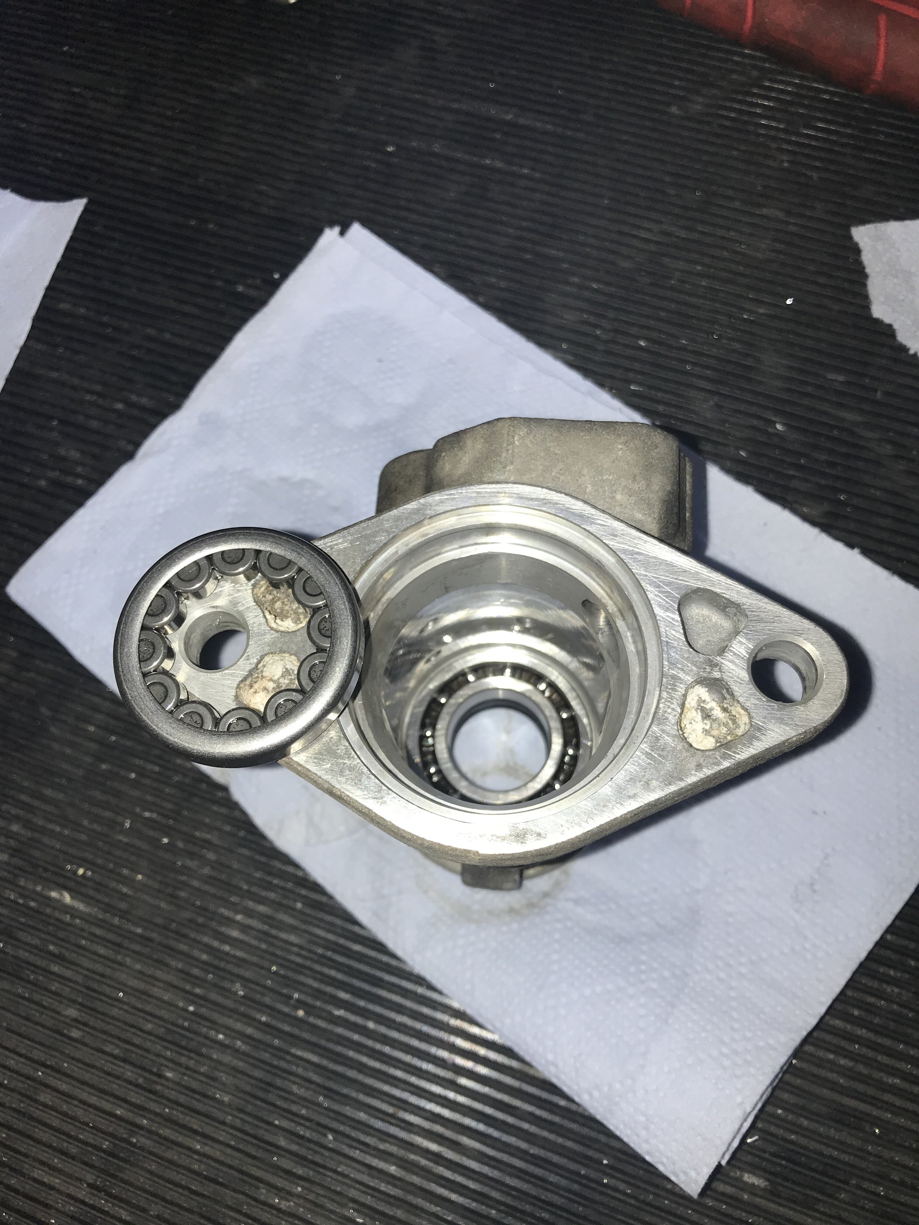

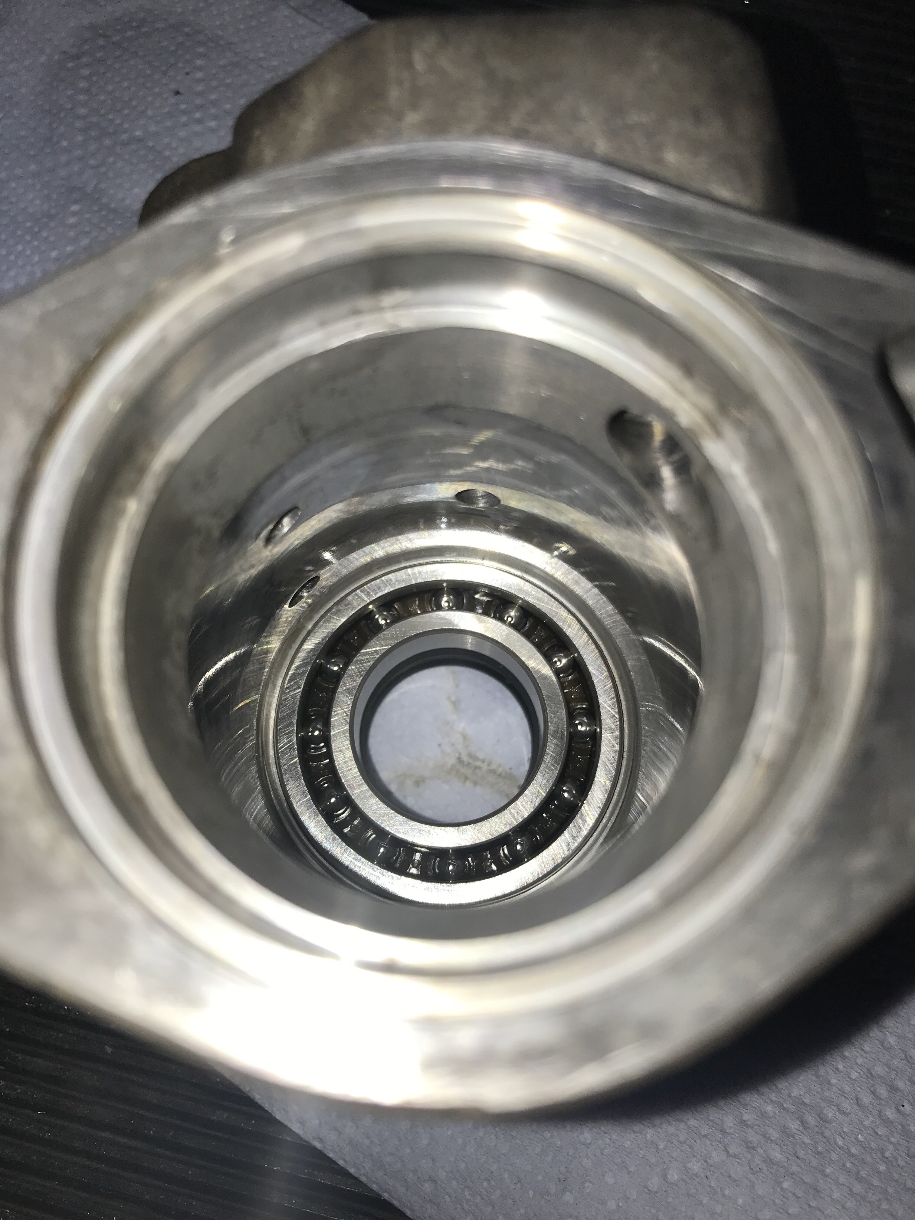

It could be the rack, they are a poor design and the pinion is not supported that well. The pre load could be out or the bearing could be gone.
I have modifed the housing to take a bigger bearing that is a press fit to the pinion, as they pinion can move by hand even with all brand new bearings built up.
Original bearing on left

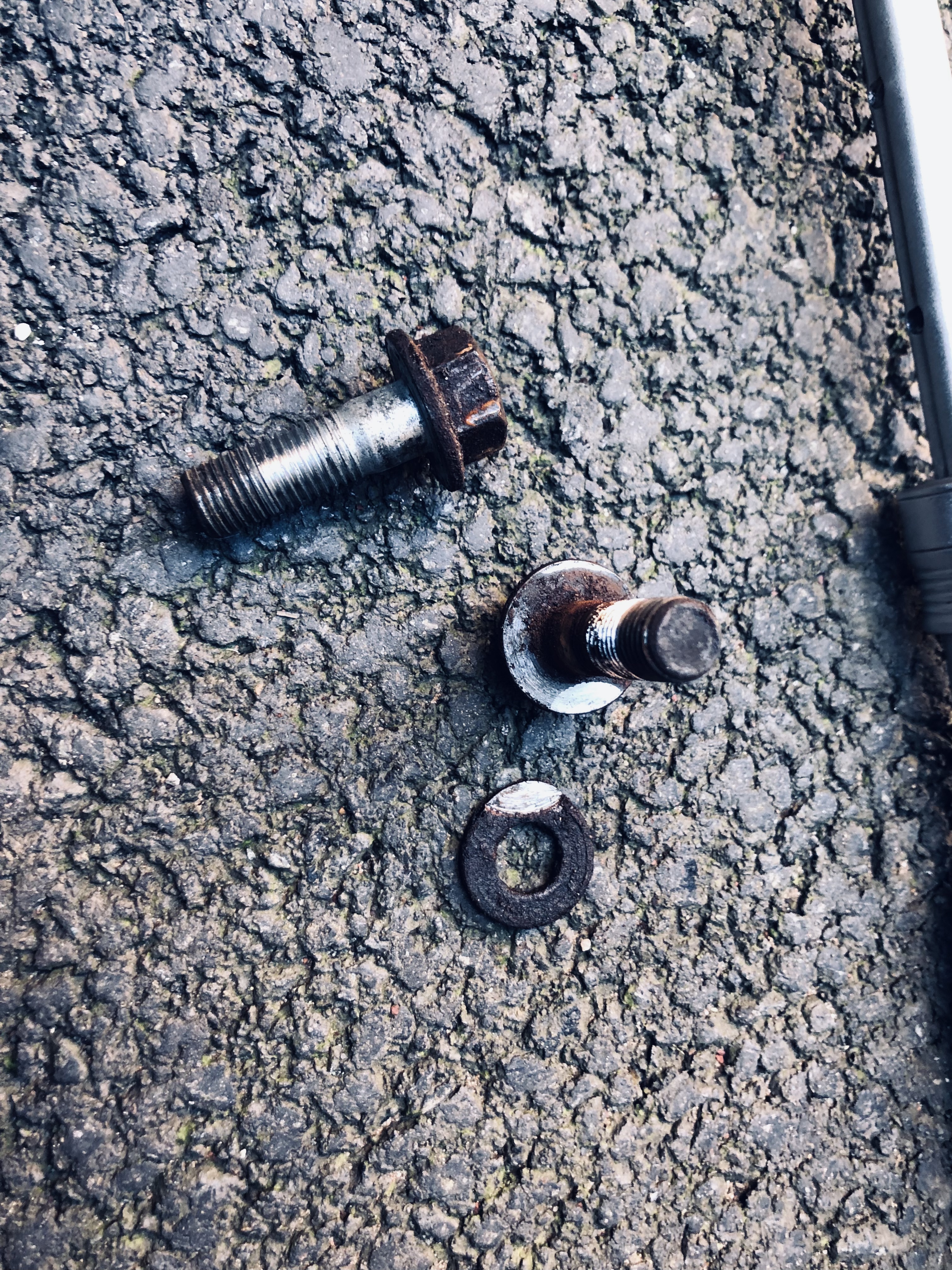

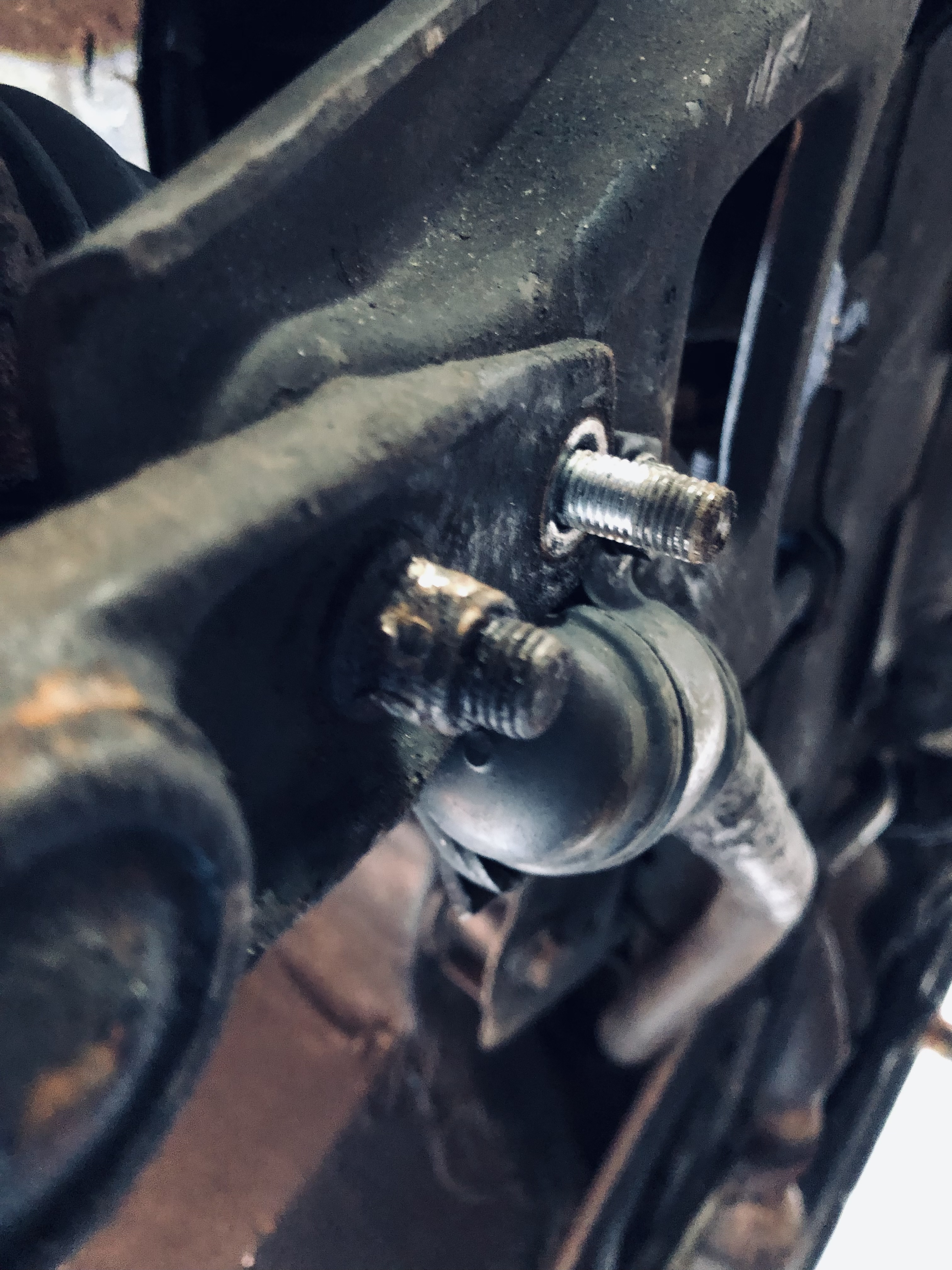

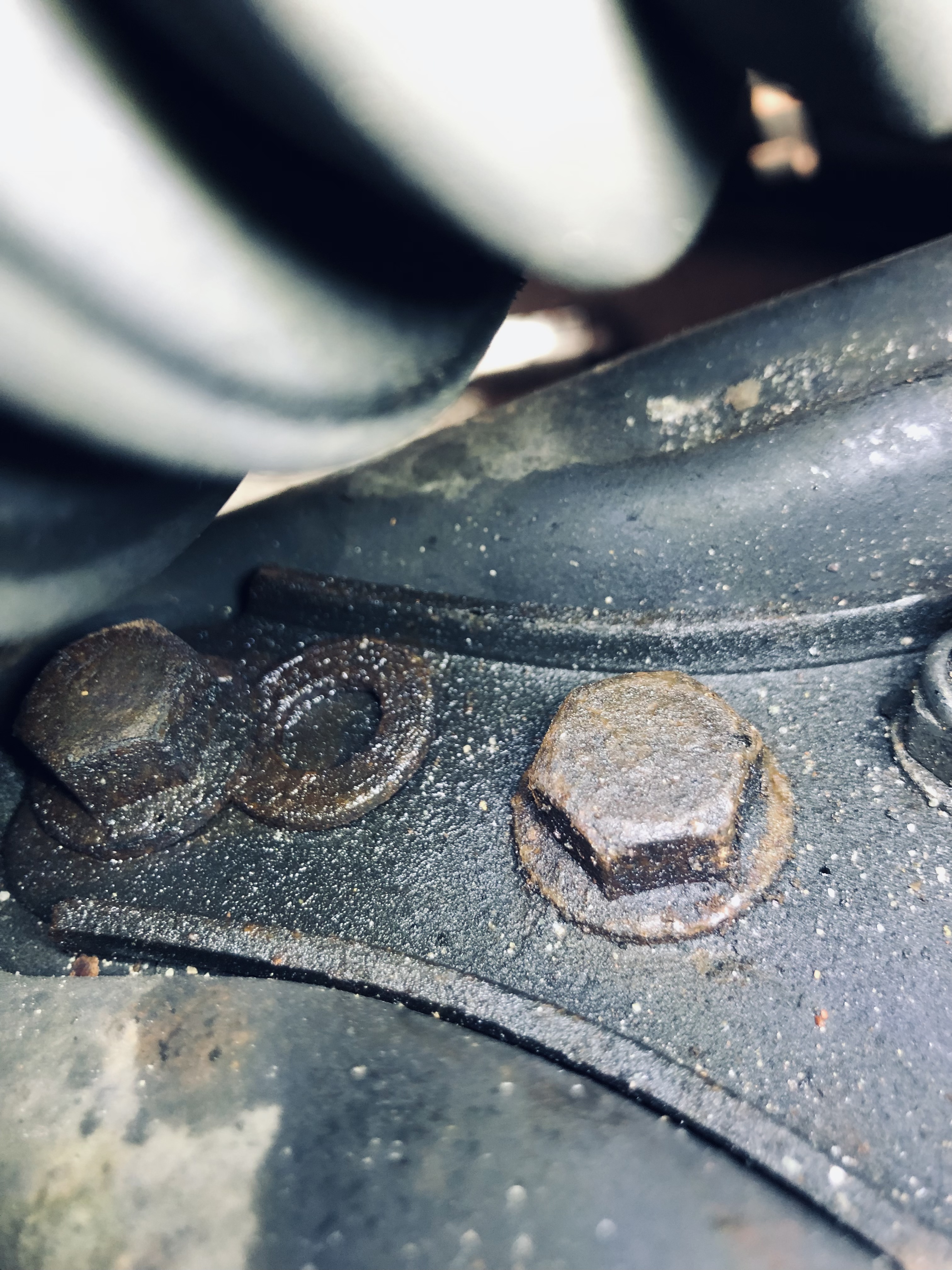

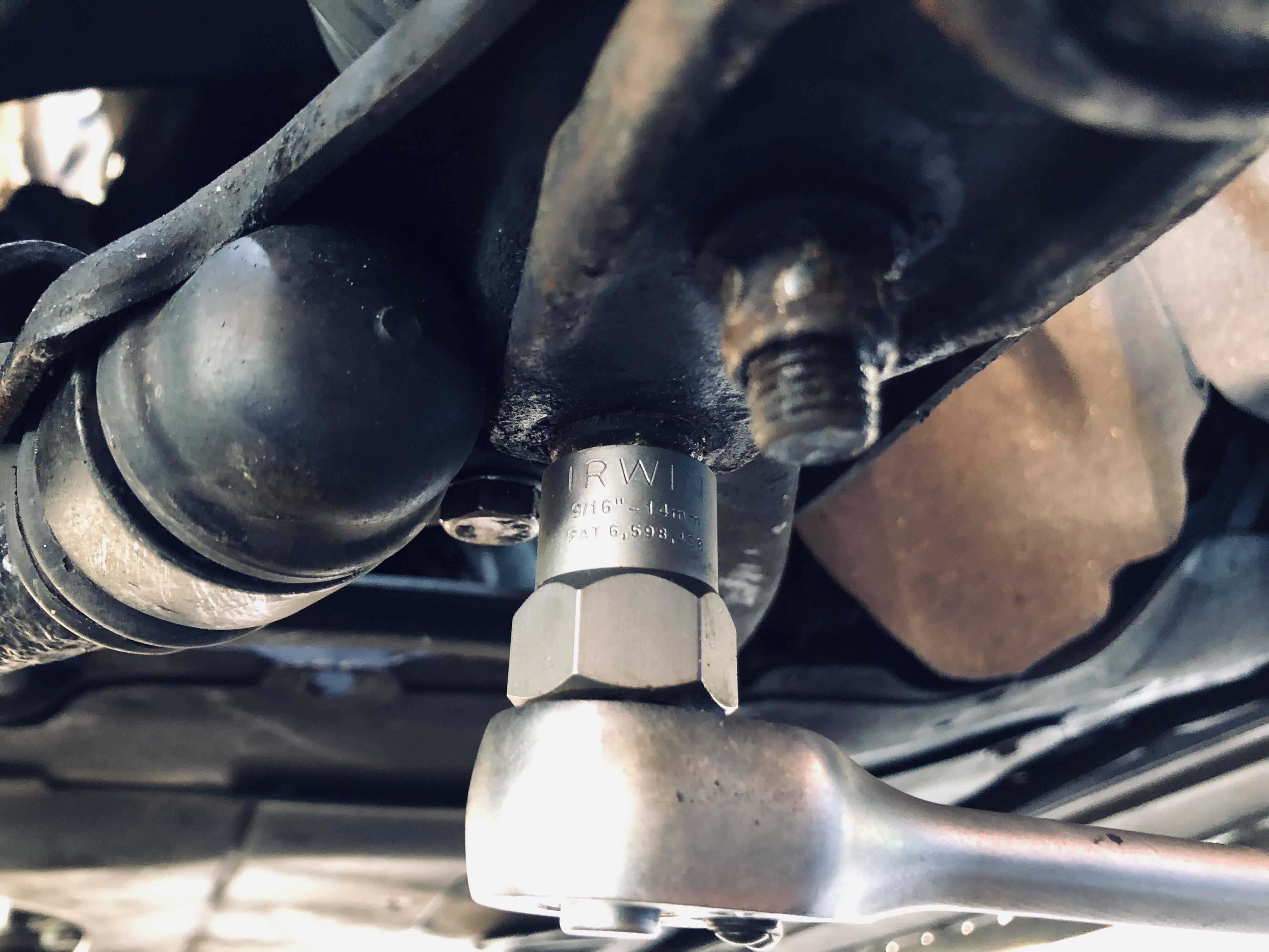

  • Popped the lower ball joints out to have a look, one side was fine but the other had been improperly bolted to the wishbone and a washer was pinched under one side of the bolt head. Weirdly, the ball joints have 10mm bolts (usually 12mm aren’t they?,the holes in the wishbones are also 10mm, they are ebay specials) It also had really odd 14mm nuts that were completely rounded, I had to use an extractor to get them off!
I reckon the angle this was on may have been allowing the ball joint to shift around on rough roads. No idea what happened there, the ball joints were already fitted to the wishbones so may be crappy manufacturing and I missed it or someone molested it later, I reckon the latter because it would be easy to see on a shiny new part. I ordered a new pair of ball joints with bolts and will see if that sorts it. Might do the track rods too depending on what you guys think

I would do the inners now if you are doing other bits, at least that jobs ticked off for a while.
That washer is funny, someone must of blindly put the bolt in and zapped it with a gun without checking.

M12 is sports, M10 is non sports. I presume you've ordered the bigger size?

I’ve ordered the M10 ball joints as these OE wishbones weirdly have M10 holes.

quick update, car is driving much better with the new properly fitted ball joints. Have got some knackered extra caster wishbones to refurb on the way too. Thanks all
But are these the 10mm hole joints? Wont they be different to the 12mm sport ones? Just guessing I dont know for sure.

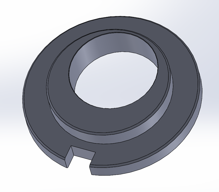

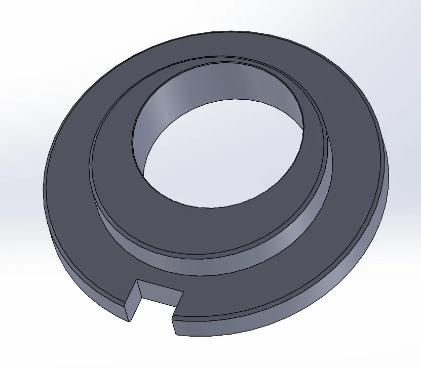

@Touring_Rob You think this would work? Concentric washer type things for 10mm hole ball joints to adjust camber, caster, king pin inclination..? You could have small markers on the 'washers' to use to align up with reference points of the wishbone for quick adjustment. Things would be more rigid than using 10mm bolts in the 12mm hole joints and the ease of alignment to. I guess you could always make them bigger and drill the original wishbone holes out slightly and keep the standard 12mm ball joints.
Very cool idea, here is a doc that leads me to believe the 10mm and 12mm ball joints are the same except for the mounting holes PROTIPS22410_GB.PDF (bilsteingroup.com). I currently have the Febi 10640 ones on my ebay special wishbones.
My lexus has similar eccentric washers on the rear upper arms, seen a few OEM's do similar so yes I think it would work. The other think that works (and might be simpler here) is an eccentric bolt that sits in a concentric cup. BMW do this for their control arms on lots of cars.
You've just reminded of the eccentric wishbone bushings that I have on my own clio 😄
If this was something I was going to make the repeat-ability of the washers would be far easier than an eccentric bolt but if there were an off the shelf option which Im sure there is something close, perhaps a slight modification would be needed but might make it a very easy and cheap modification for more control of the suspension geometry. Ive seen a while ago people re welding the holes in their wishbones for more caster but this obviously would be a plug and play sort of thing. Something to think about...
