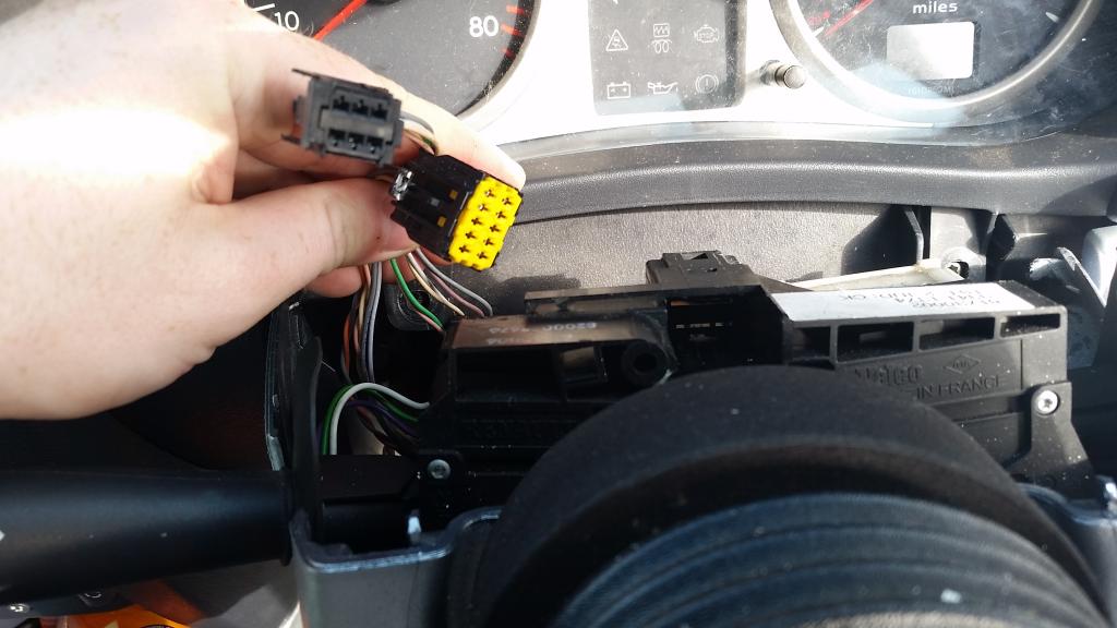

i believe the yellow connector is, cruise control, horn and airbag? from the picture, what parts of the yellow connector is for what? I want to try and turn the airbag light off, and get the horn working along with cruise control
the black connector i believe is for the angle sensor, does this work with or for the ESP? and which of these connections is the ESP.
the white one or the grey one?
Because i have these connection, does this mean the car comes with it and will work?

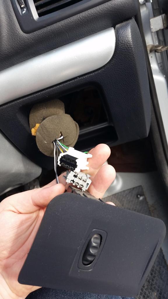

2)
the steering wheel picture in the bottom right, i'm guessing thats for the power steering? if i am correct then the fuse is still out ( as there are no mental connection to put the fuse into) nad it still feels like i have power steering. no heavyness or anything. any ideas??

In regards to your steering wheel. Why are you trying to blank off the Airbag light at the wiring loom side and not the Airbag plug itself? It would avoid having to guess which is airbag, horn, cruisecontrol etc you are just making more work for yourself doing it so far back.
This would be the recommended way of blanking it:
http://www.cliosport.net/forum/show...ermarket-Seats-Wheel&highlight=steering+wheel
lost.
i thought the airbag light was on only because of the steering wheel change? could it also be on because of the seat change?
You need to scroll down the guide to the bit at the bottom about the steering wheel airbag plug ;)
