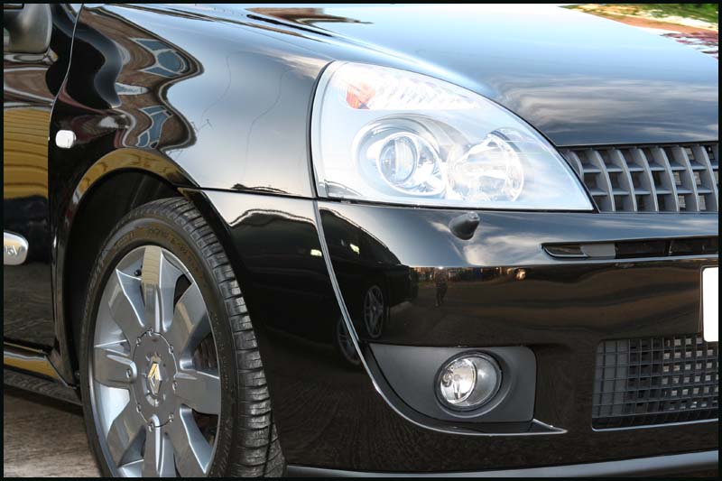

Am I right in thinking the paint looks dull/hazey at the min because I have had the PC too slow and also the car is't waxed ? :S
Hazing will have been caused by the 83 not being broken down, You need to work it on faster speeds, with slow passes to make sure it breaks down fully. 2 or 3 passes on speed 3/4 nad the same on 6. I dont like the stuff to be honest. SSR 2.5 works better and is more user freindly.
Weather the ca has been waxed makes no difference, the polished paint should look just as good before wax.

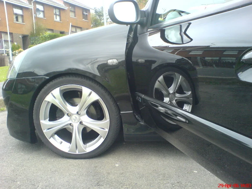

Just did a quick rinse with AG body-shampoo yesterday instead of the NXT
leaves an awesome shine :)
still a bit hazzy but that'll take a bit of work when I get time
Yeah had them bling'ed up about a fortnight ago :cool:
Can I protect the tailpipes with any sort of wax ? they tend to get a bit sooty :headno:
Polish with metal polish, then AG super resin and extra gloss, they should come clean easier then.

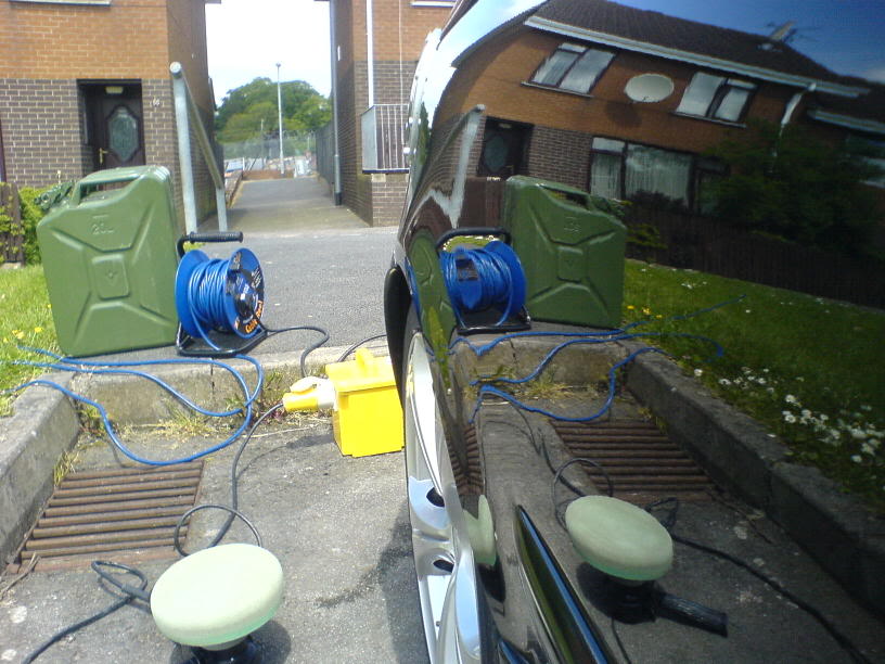

Nice work, looking good.
Agree with Guy though, the power supply ain't the best way to do things.
