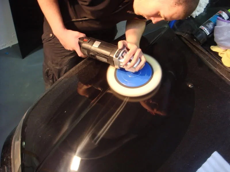

THE ROTARY POLISHER

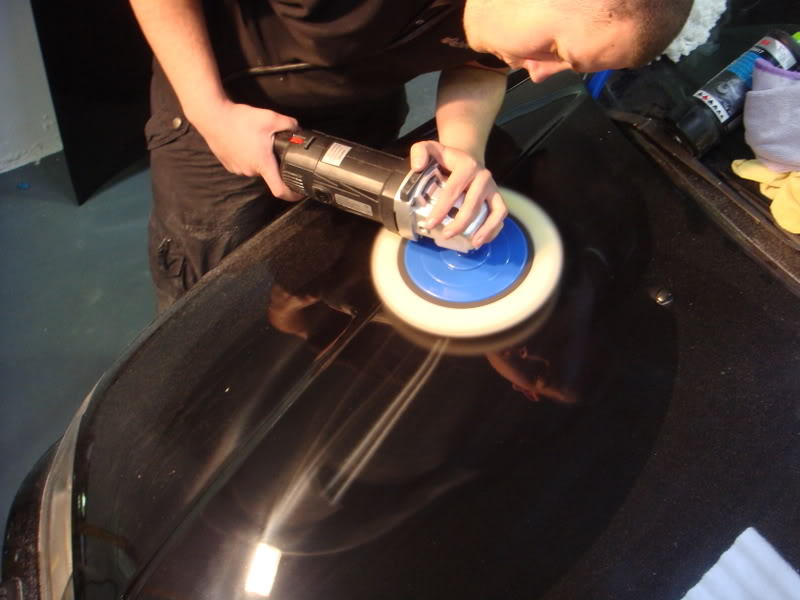

Rotary polishers are the mainstay of bodyshops and professional detailers for paintwork correction. They can be used with either foam or wool pads, the latter giving rise to the commonly used term of “mopping”. Used correctly, a rotary polisher is capable of spectacularly good results: high levels of paintwork correction; super sharp clarity and depth in finishing. In the wrong hands, such a machine is capable of severe paint damage!

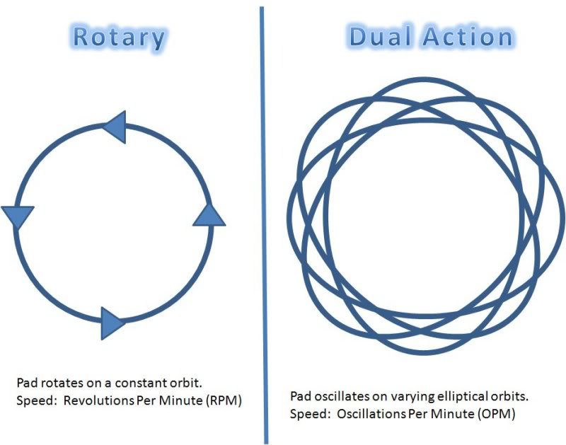

A rotary polisher differs from a Dual Action polisher by the fact that its pad spins only on a single orbit as shown below.
The single orbit nature of a rotary polisher results in a very consistent break down of polish abrasives. This opens up the rotary polisher for use with any polish from heavy cutting compounds to fine finish polishes. The rotary is a very flexible paint correction machine.

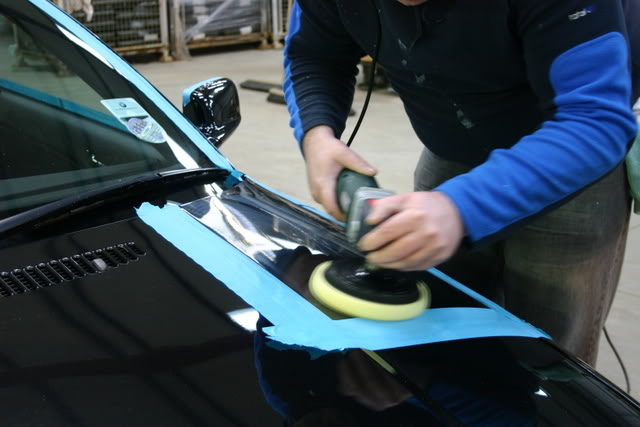

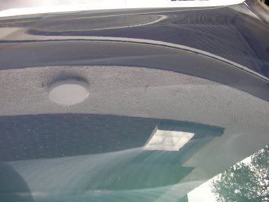

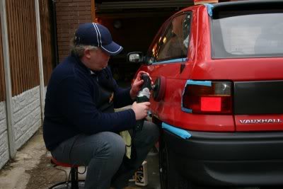

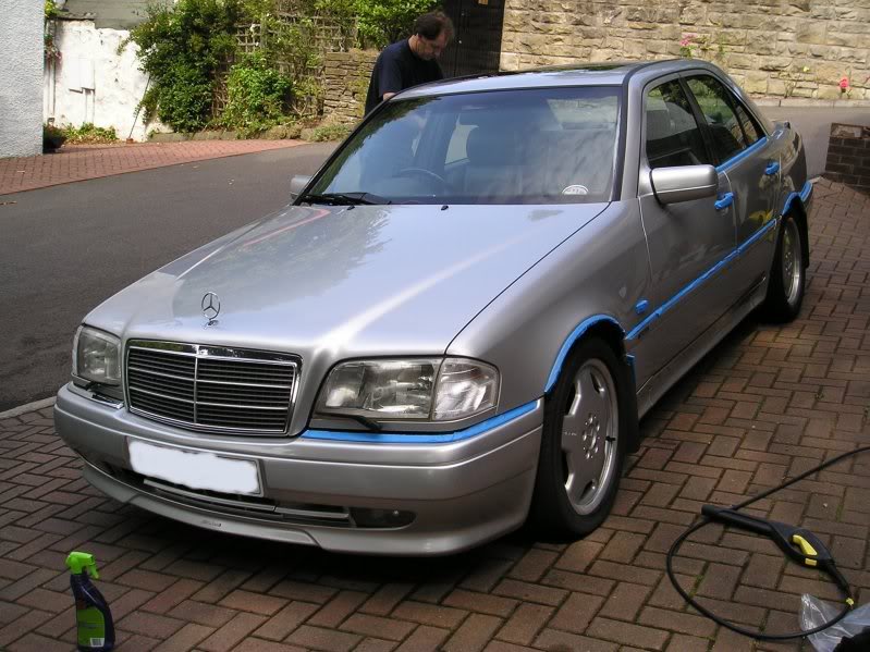

It is a good idea to tape up textured plastic trim on the car before polishing – areas such as bumpers, vents, door rubbers that protrude outwards. This can be done using painter’s masking tape. You should use a low-tack masking tape which will remain in place even if a machine pad hits it, but yet is easy to remove when you are finished. An example of a suitable tape is 3M 3434 blue tape.
When deciding which areas to tape up: you are looking to protect textured plastics from having polish residue driven into them so these should all be taped; you are looking to prevent the pad coming into contact with regions trapping dirt so the pad doesn’t drag the dirt onto the paint so these areas should be taped. When taping, ensure the area you are taping is dry – particularly important around water traps such as underneath wing mirrors.
The Mercedes in the picture below shows typical areas for taping up on a car:
Protruding edges of the indicator repeater taped up as these could catch the pad causing it to jump and also be harbouring unseen dirt that could embed in the foam and be dragged across the paint. Along the styling line on the doors has been taped up – again we have a protruding edge here but also regions of textured plastic trim which we would want to avoid staining with polish residue. The door handles on this car are black textured plastic so have been taped to avoid staining.

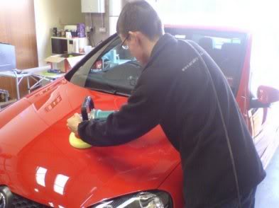

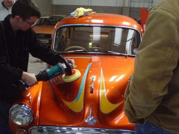

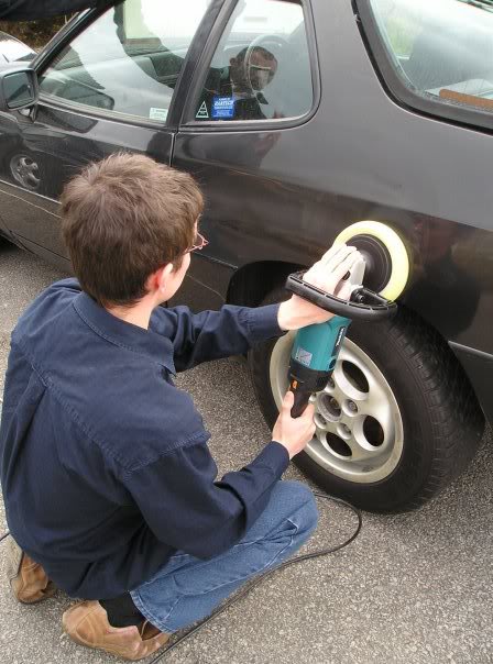

SETTING UP THE MACHINE
This part of the guide is based on the Makita 9227CB Rotary Polisher. The generics here are applicable to all of the major rotary polishers however.

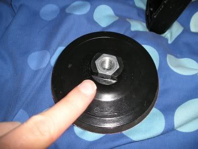

First of all, decide which size of pad you want to use. This will be determined in the main by the shape and size of the panel you are working on: small panels with complex details will require the use of smaller pads. You will then need to choose the appropriate backing plate.

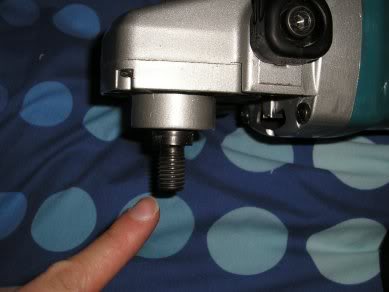

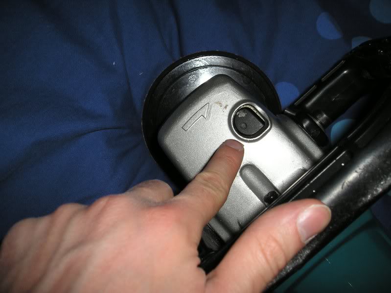

Most rotaries have the “male” end of the connection, and the backing plate is the “female” end as shown in the picture below for the Makita 9227CB (M14 thread).
First of all, screw the backing plate onto the connection until you feel a notable resistance. Take care not to cross thread – it is a good idea to turn only very lightly to get the plate started on the thread. Once you feel resistance, locate the spindle lock button – on the Makita it is the black button on the head of the machine as shown:
Push this button down and then turn the backing plate until it clicks – the button will fall down at this stage and the plate will be locked. Tighten the plate with firm pressure at this point, holding the spindle locked with the button. Once secured , let the button go and turn the backing plate to make sure it is tightly fitted. You can now attach a pad to the backing plate and the rotary polisher is ready to use.

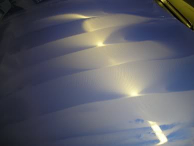

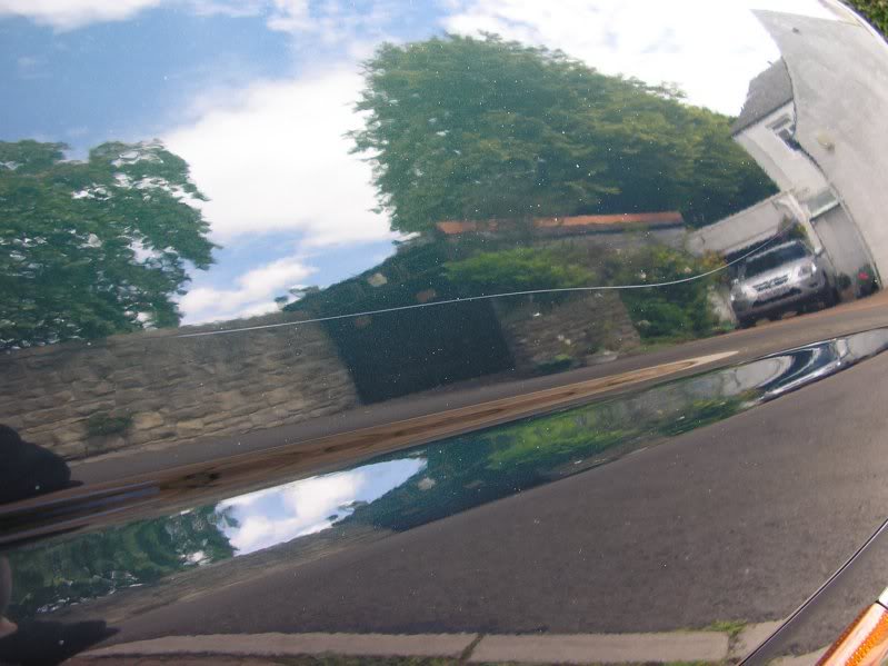

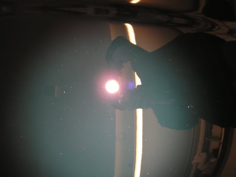

LIGHT IT UP!

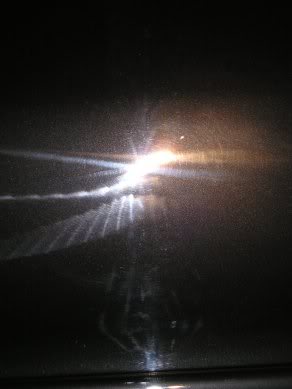

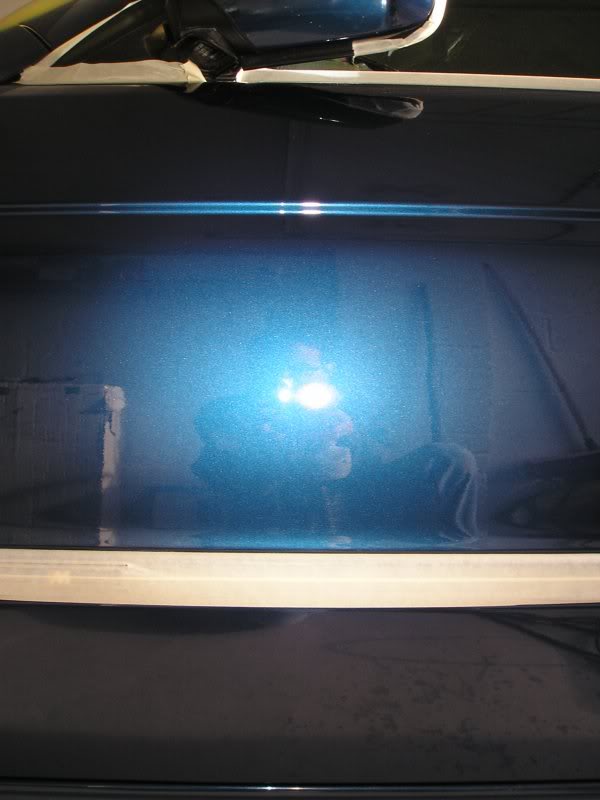

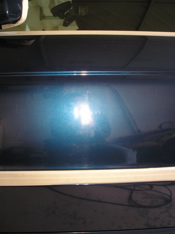

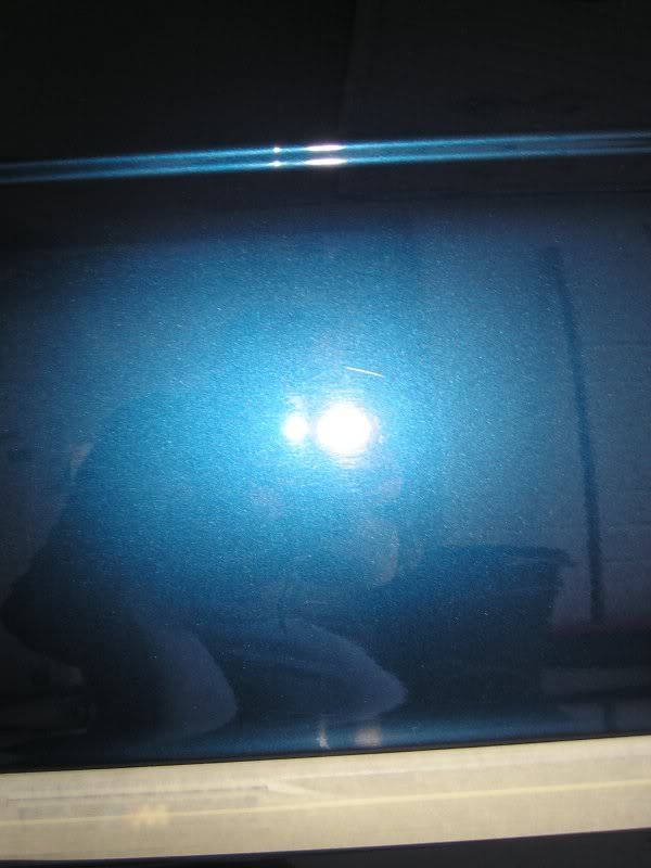

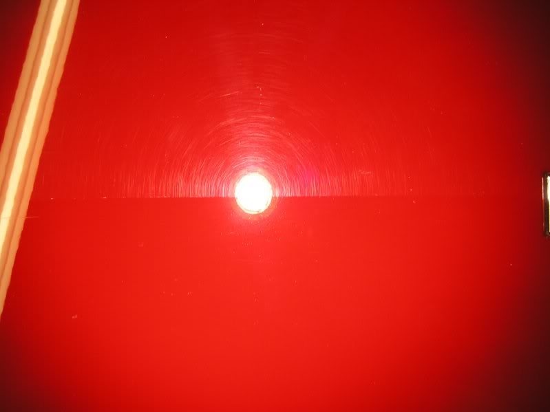

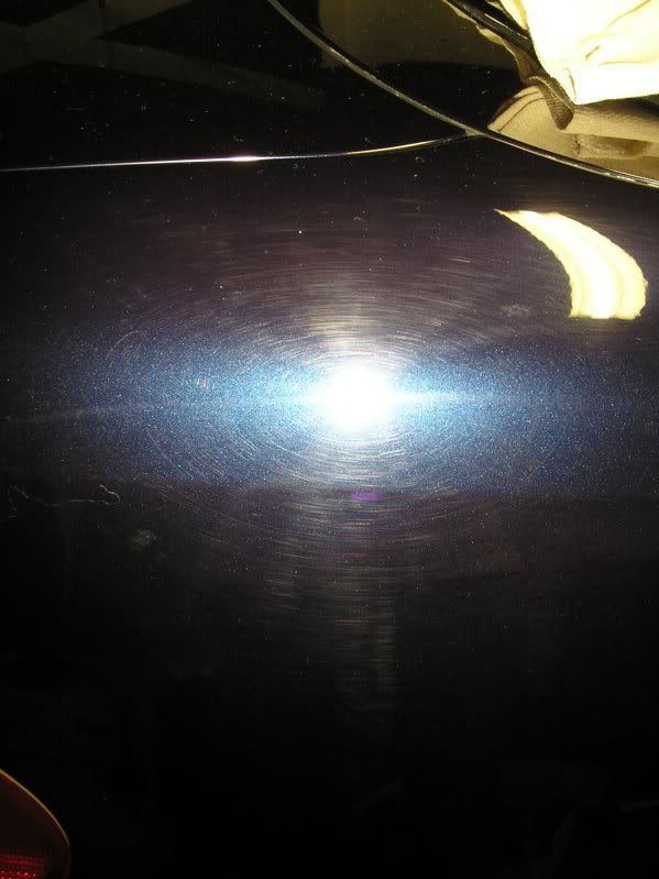

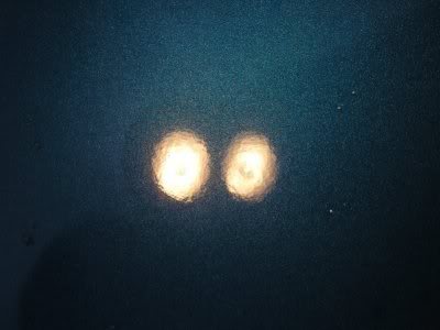

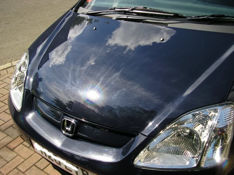

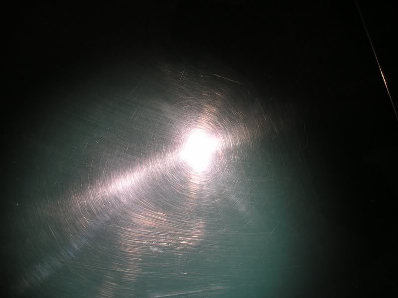

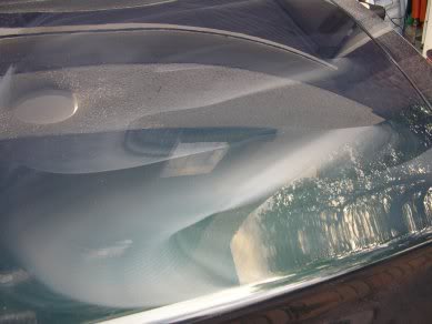

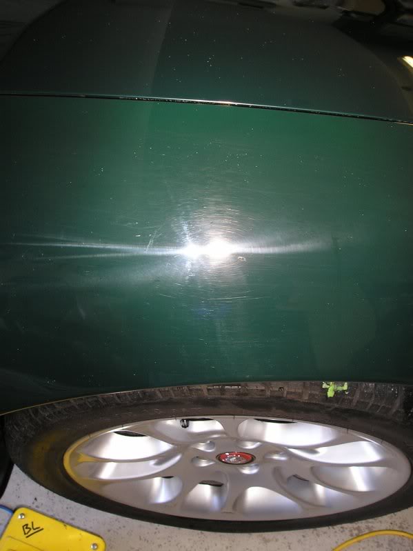

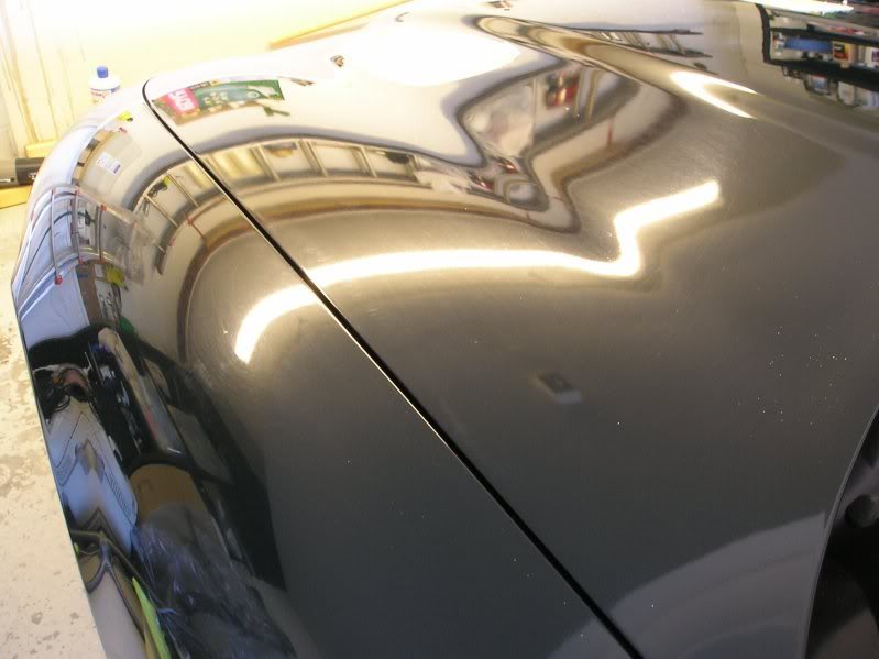

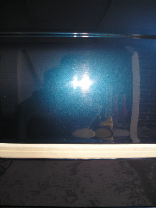

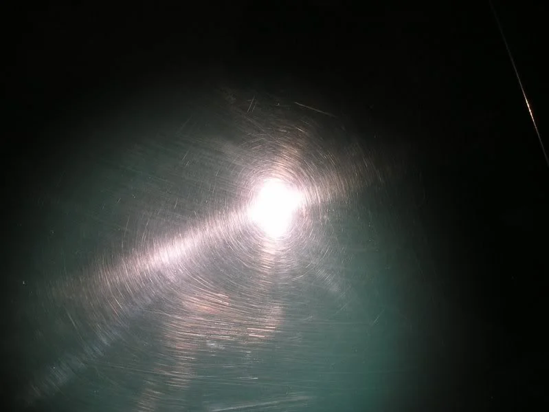

Defects such as swirl marks also show themselves in direct sunlight. Or underneath the halogen lights in a petrol station. It is not always possible to rely on sunny weather to assess paint condition though, especially in the UK! It is also very bad for you eyes to stare at sunlight reflecting directly off of a paint finish! Please be careful!

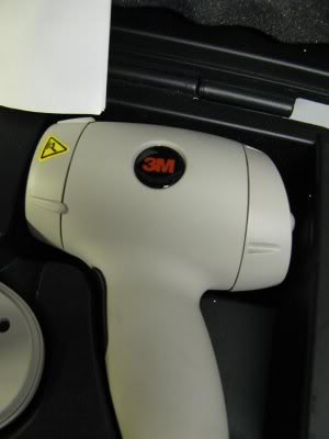

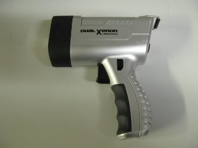

A very useful tool to have in your detailing armoury is a suitable light source that you can use to highlight the swirls on the paintwork. Two examples of such tools are the Brinkmann Dual Xenon Torch and the 3M PPS Sun Gun shown below:
This hand held torch gives a light which is bright enough to highlight swirl marks and holograms on the paint finish. In order to use the torch to its maximum effect, hold it far away from the paintwork rather than close up as this will highlight more of the swirls that are present. Additionally, tilt the to a slight angle which can help pick up lighter marring than may be missed from the direct beam. Very light machine holograms can be found by sweeping the torch from side to side and looking for a “wave” effect across the paintwork which is indicative of a light hologram.

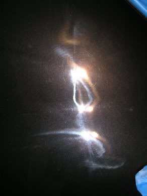

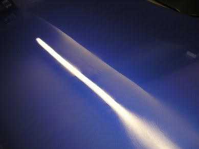

Not all paintwork marring is best seen using bright light however. Random deep scratches like the ones shown in the picture above are best viewed under a general garage strip light – the lower contrast of the dimmer light highlighting the softer and deeper scratches more clearly. A bright light would highlight all the swirls, masking the more spread out deeper marks.

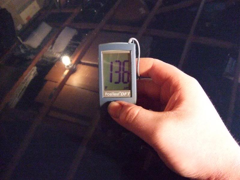

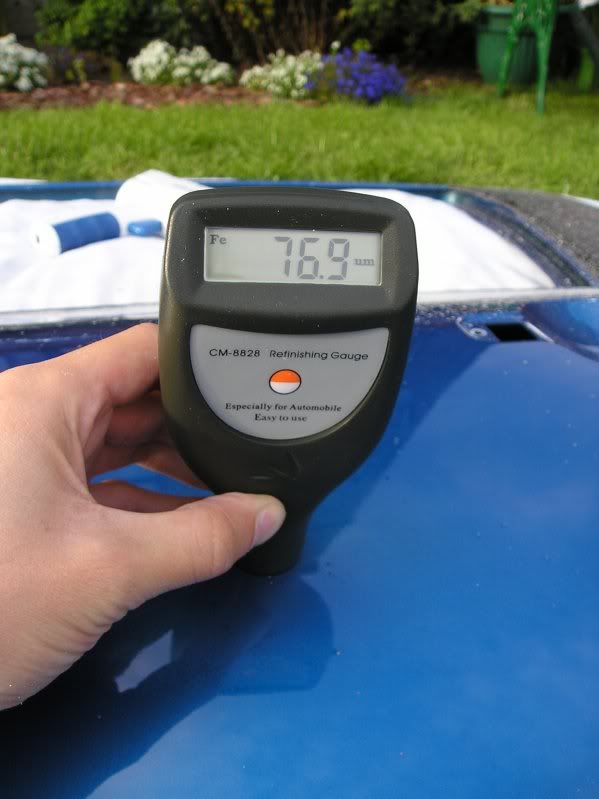

HOW MUCH PAINT?
Most machine polishes use mechanical abrasives to remove the paint defects. This means that as you are polishing, you are eroding away a certain amount of paint, the exact amount depending on how harsh an abrasive you are using. Rotary polishers have greater power than their Dual Action counterparts and for this reason greater care should be taken with regards to paint thicknesses – especially with more aggressive cutting compounds!

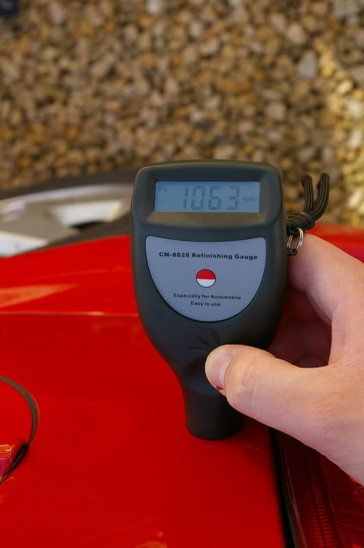

If possible, before starting to use the machine polisher, it is a good idea to check the thickness of the paintwork on the car. This can be done by using a Paint Thickness Gauge (PTG):
Most PTGs will measure to total thickness of paint on a panel. Paint generally consists of either two or three distinct layers: Base Coat; Colour Coat; Clear Coat (on most cars). It is the thickness of the top layer of paint which is of interest – going through this layer (strike through) will result in a respray being needed! So it is necessary to interpret the readings you see on the gauge and a certain amount of guess work will be required. Very generally speaking:
200 MICRONS +
This level of thickness can be expected on older cars that have been hand painted – the Ferrari F355 for example. It is also indicative of the possibility of the car having been painted at some point in its life. This is something important to note as non-OEM paint can respond very differently to factory paint in terms of hardness and polish behaviour – so if any regions appear quite thick, make a mental note of this for when you come to machine polishing them.
An example of just how thick paint can be is seen in the picture below where a reading of over 1000um was taken – that is paint that is 1mm thick!
BETWEEN 100 AND 200 MICRONS
This is normal paint thickness. Reading in this range point to standard paint (generally speaking) and shows a healthy thickness that should present no problems when it comes to machine polishing.
BETWEEN 80 AND 100 MICRONS
For most cars with clear coats, readings in this range point to quite thin paint. Many newer cars give thinner paint readings, but reading in this region should raise caution. Think twice about using more aggressive polishes on thinner paints as significant amounts can be removed, resulting in strike through and the need for a respray. Paint of this level can still be machine polished – but greater care should be exercised in polish and pad choice.
LESS THAN 80 MICRONS
Now we are in the realm of very thin paint, especially if a clear coat is present. Care should be taken when choosing a polish for these thinner paints. A big consideration should be a filler heavy polish which can achieve correction by filling the marring rather than removing any further paint. Thin paint can be a result of aggressive machine polishing in the car’s past life.

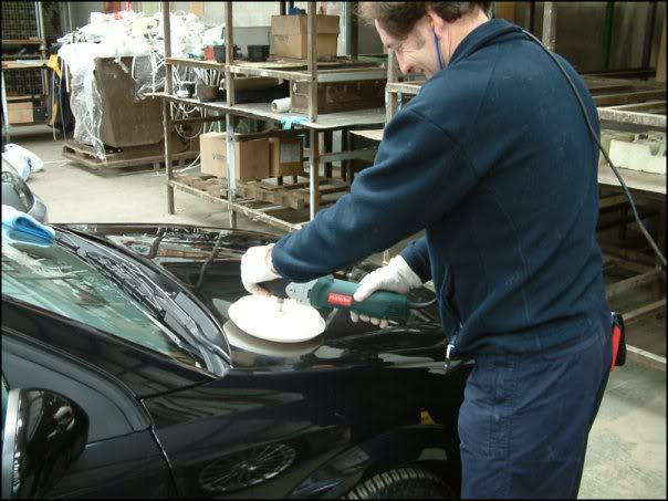

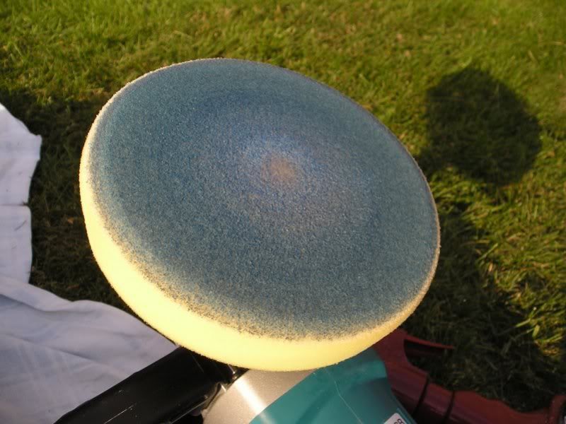

Before starting to work on a panel, examine it carefully. Look out for whether it is a wide flat area (most bonnets and roofs), or whether it has tight regions with lots of complex details and badges (most bootlids and bumpers). Pay particular attention also to creases and detail lines in the body panels which will affect the areas that you tackle.
For large wide areas, the largest of the pads can be chosen – 8”. An example of an 8” pad being used on a bonnet is shown in the picture below:
Medium sized 6” pads are the most commonly used on the rotary polisher and are useful for most areas on a car. They can happily be used to tackle large areas such as bonnets if you do not wish to use the bigger 8” pads, or for smaller areas such as wings as shown:
An advantage to the smaller 6” pads is that they can give more control over more “shaped” panels such as the bonnet of the Morris Minor below. This is because a greater percentage of the pad area can be in contact with the panel over the curved region.
For tighter to reach areas, or around badges (such as on bootlids), 3 or 4” pads come into their own as they allow you to manoeuvre more easily around complex details.

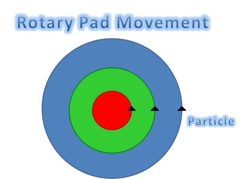

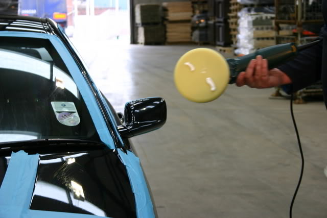

The larger the pad on a rotary, the more aggressive it can be. This is due to the fact that a larger pad will be moving faster than a smaller one.
Imagine being a polish abrasive on the outside edge of a pad, as shown for 4”, 6” and 8” pads in the picture below.

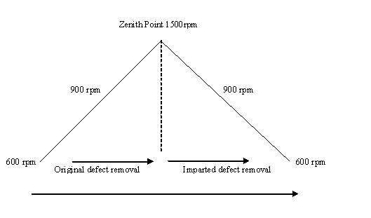

The speed setting on the rotary polisher control the speed at which the pad rotates in revolutions per minute. So if this is set to say 1000rpm, the abrasive particle will go round the circle 1000 times in a minute… The bigger the pad, the bigger the distance it has to cover in a minute, hence the faster it must be moving. For this reason, larger pads are moving faster and are typically a little more aggressive than smaller pads.

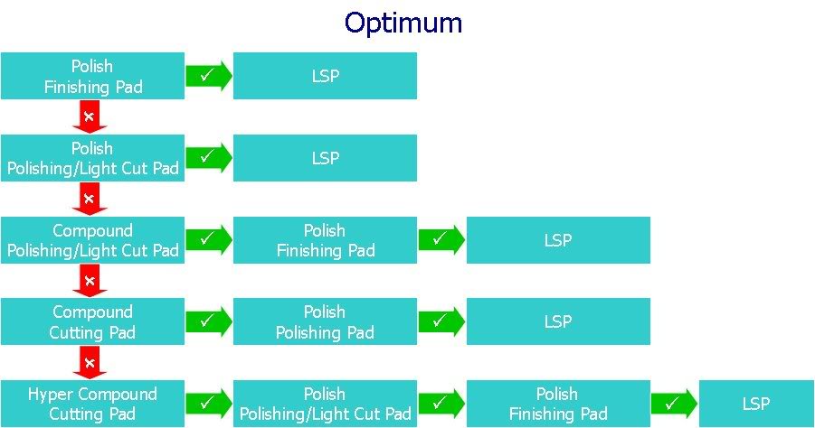

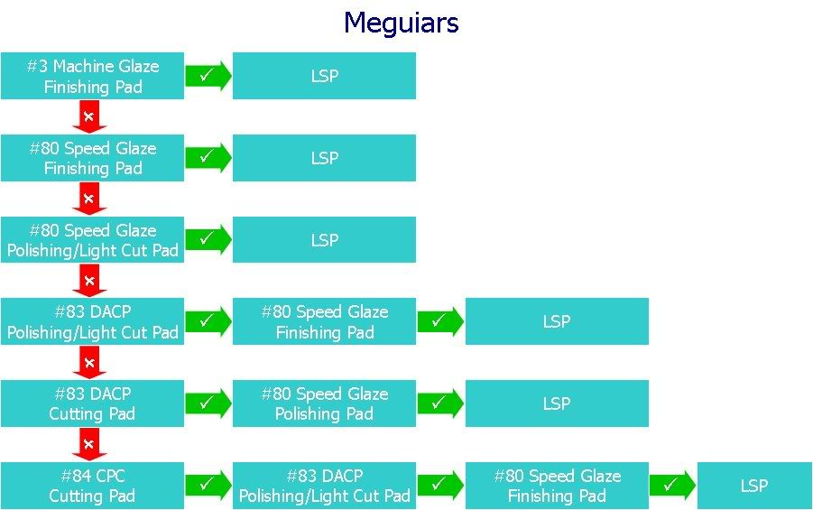

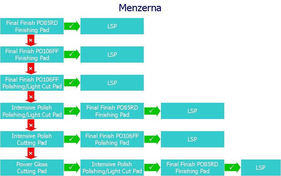

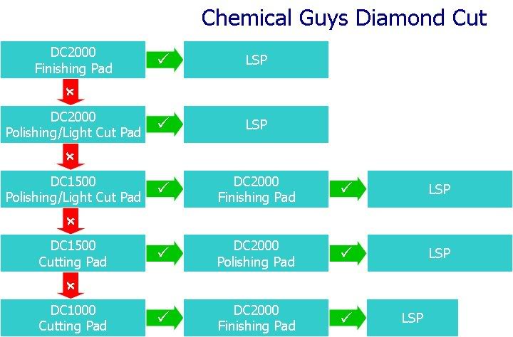

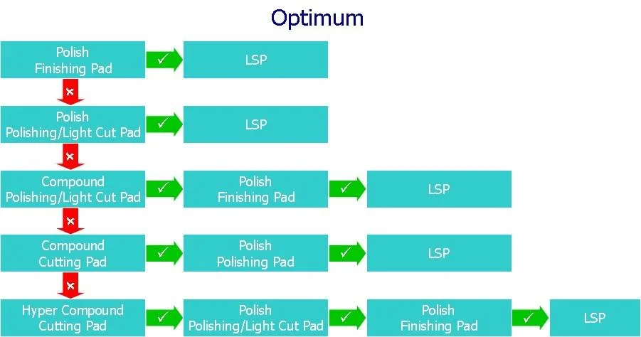

CHOOSING THE CORRECT ABRASIVE LEVEL
Shown on the charts below are typical “routes” you could take when assessing which combo is right for the paintwork you are dealingwith. This is by no means an exhaustive guide, but rather a generic guide to show you possible conbinations to try and in what order in increasing levels of aggression. Start at the top left, and follow the arrows: if the combo is successful follow the green arrow; if the combo is not successful follow the red arrow.

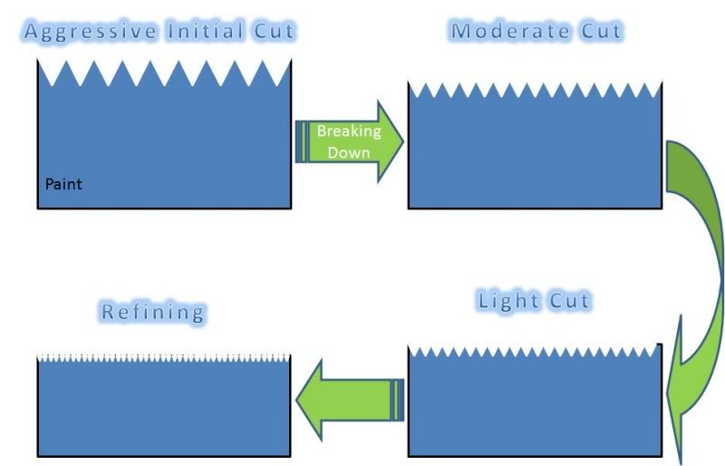

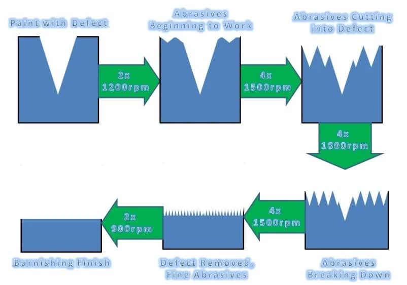

THE THEORY OF ROTARY POLISHING
In this section we look at the theory behind the techniques used in rotary polishing and the effects that they have on paintwork and the results achieved.

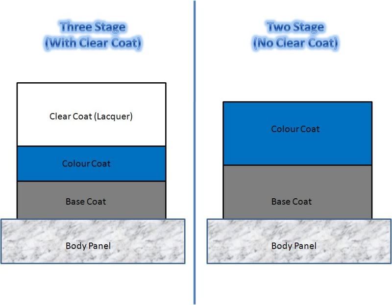

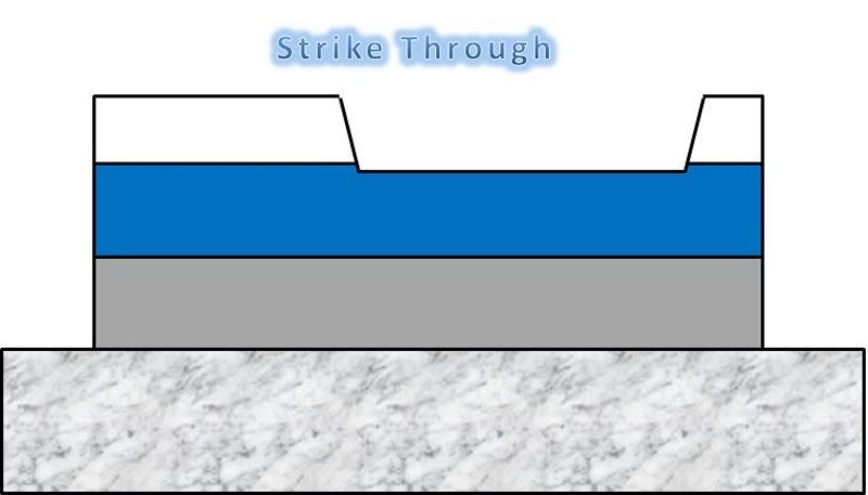

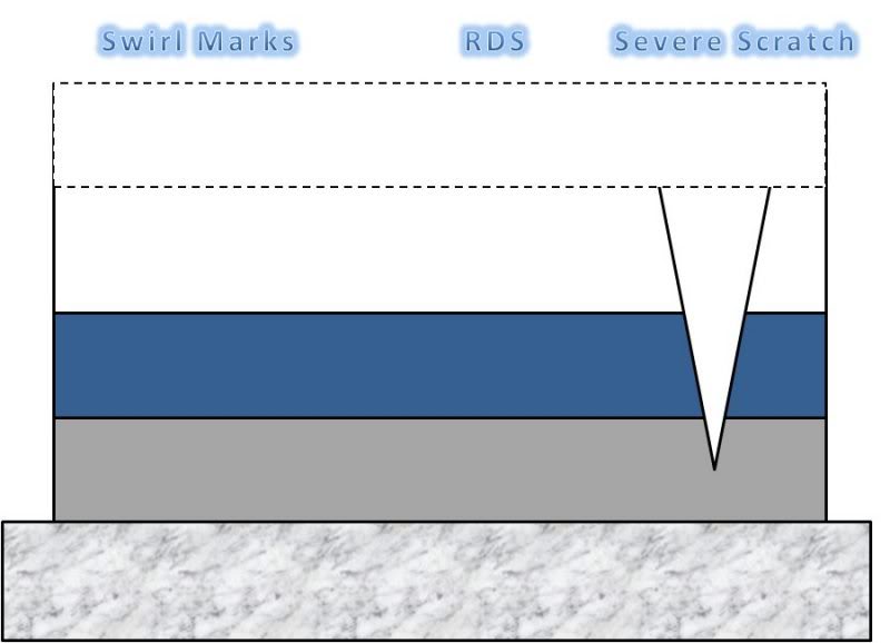

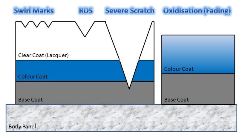

PAINT SYSTEMS
Shown in the picture below are the two typical paint systems you are likely to encounter when detailing: “single-stage” and “clear-coated”.

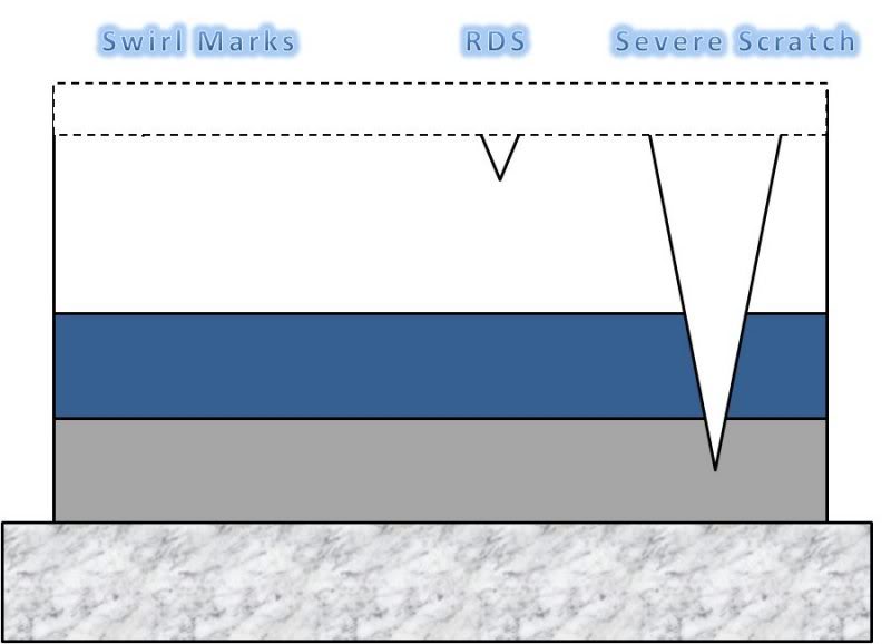

In all cases when machine polishing a car, you are working on the top layer of paint. You cannot remove more than this layer – indeed, you should always leave a healthy thickness of the top most layer. This puts a restriction on the defects which can be removed – any deep marks which go through the top layer of paint cannot be removed.

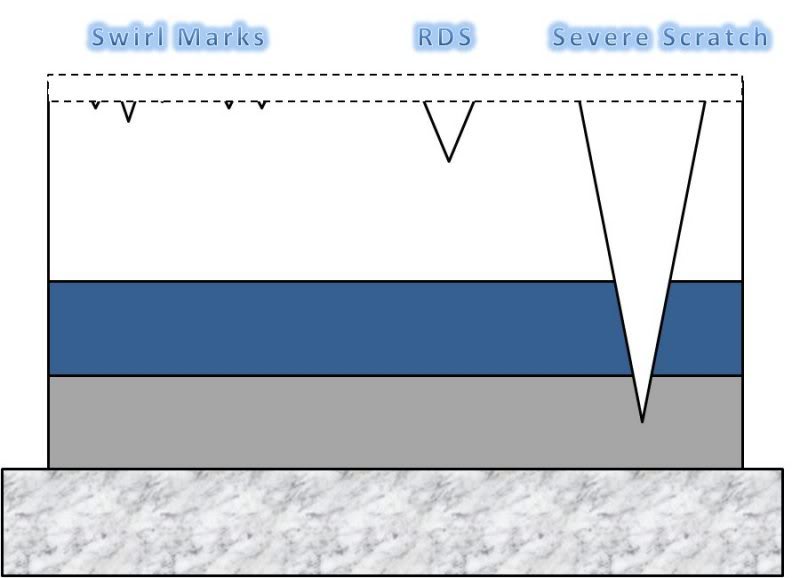

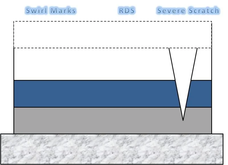

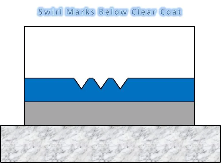

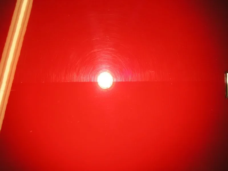

PAINT DEFECTS

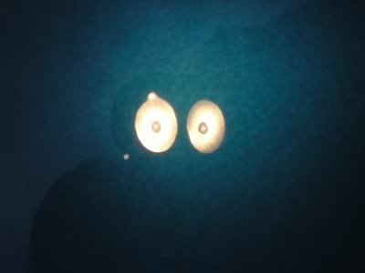

The paint defects that you may encounter are shown in pictures earlier on. We look at these in a little more detail here – for full descriptions please see separate guide.

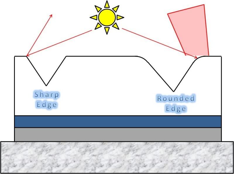

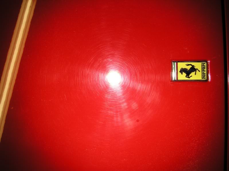

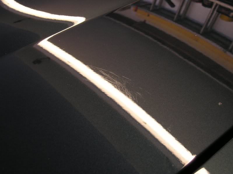

  • Swirl Marks are light and shallow scratches covering large areas of the paintwork, typically inflicted by poor wash technique.
  • Random Deep Scratches (RDS) are deeper scratches into the paintwork, typically inflicted by grit being dragged along the paint, or minor key scratches.
  • Severe Scratches are marks which go through one or more of the paint layers, sometimes down to the bare metal – these cannot be sorted by machine polishing and require painting (minor filling or section respray) to fix.

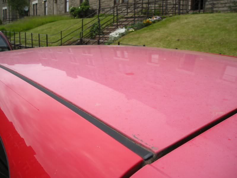

  • Oxidisation happens generally to cars with no clear coat and causes the paint to fade and look dry
Shown in the picture below is a schematic of the typical paint defects.
REMOVING DEFECTS USING ABRASIVE POLISHES/COMPOUNDS
The most popular way of removing paint defects by machine is to use an abrasive polish. When worked into the paint, the abrasives cut away a layer of the paint where the defects are. Once the amount of paint removed is deeper than the defect, the defect will have been removed. It is like “re-flattening” the paint to a level where no defects exist.
As mentioned above, when first approaching a car, always start with one of the lightest polish and pad combination that you have. This will remove only a small amount of paint, but may be enough if you have soft paint or only light swirls. Shown in the picture below are the above defects after being tackled with a typical light polish and pad combination (for example Menzerna PO85RD Final Finish on a Meguiars W8006 Polishing pad).
A thin layer of paint has been removed with the light cutting polish and soft foam pad. The combination has removed a lot of the lighter swirl marks, but has left the deeper swirl marks and the RDS and severe scratch. It is clear that there is still a healthy thickness left (can be checked with a paint thickness gauge in practice). So we would progress up the ladder to a more moderate cutting combination now to see if we can get better correction. For example, we may step up to Menzerna PO85RD3.02 Intensive Polish on a Meguiars W8006 Polishing pad to get the results shown in the picture below.
A thicker layer of paint has been removed and we have no fully corrected the swirl marks, both light and deep. The RDS remain however as it is much deeper into the clear coat. If the paint thickness permits we may wish to tackle the RDS with a heavier cutting combination to remove yet more paint. An example of this may be Menzerna POS34A Power Gloss on a Meguiars W7006 Cutting pad, to get the results shown in the picture below.
We can see that yet more paint has been removed by this process, however the RDS has been successfully removed. Great care must be taken when using compounds and removing large amounts of paint as leaving the clear coat too thin can cause it to flake off. Clearly the severe scratch cannot be removed as it goes through both the clear coat and colour coat layers.
When working up through the abrasive scale to find the best possible combination for the paint it is worthwile bearing in mind that some of the marks that may be in the paint are too severe to remove safely. Always aim to leave as much clear coat (or colour coat on a two stage paint job) as possible. There are many reasons for this, just a couple are: if the uppermost layer is too thin, it can flake off and the only repair is a respray; if only a thin layer of clear coat is left then it will not be possible to machine polish the finish again with abrasives top remove any marks that may be inflicted at a later date.
Perfection is a wonderful goal to aim for – but always bear in mind the safety of the combinations you are using for the finish you are using them on. This also applies if the paintwork seems soft – use of a compound on soft paintwork can remove large amounts of paint very quickly. So if you choose to use a compound on a car with soft paintwork, be sure to monitor the paint thickness regularly during the machine polishing process – after every few passes.
REMOVING DEFECTS BY ROUNDING EDGES
This method is one which can be used with a moderate degree of success in situations where full removal of deeper marks is not possible for whatever reason (for example, paintwork is too thin). The machine polishing process can naturally round off the edge of marks on the paintwork as shown in the picture below.
The sharp edges of the deep mark catch the light and it is reflected back in an intense ray allowing you to clearly see the scratch in the finish. When the edge has been rounded off, there is no intense reflection of the light. It is instead spread over a wider area and it doesn’t appear as easily to the eye that there is a deep scratch there.
This process is not fully removing the marks in the paintwork. Instead it is making them harder to see by essentially softening the edges, which acts to scatter the light rather than reflect it. This in turn makes it harder for the eye to see the marks. They are not fully hidden, but they appear a lot less severe.

Here we look at how the polishes work the remove the paint defects as discussed above, with a description of the best generic techniques to work machines and polishes.
Polishes which use a mechanical abrasive to remove the paint (most on the market including Meguiars, 3M, Menzerna, Poorboys, Optimum, Chemical Guys…) typically use a “powdered” abrasive carried in a solution with lubricant. The polish contains little abrasive particles which act under the action of the pad which moves them across the paint to slice off a little amount of the paint. It is quite similar to exfoliating the skin on your face with a facial scrub.
In many polishes which are widely available, the abrasives break down under the action of cutting to become finer and finer. This means that as you polish, the amount of paint removed gets less and less. Shown in the picture below is a schematic of how this works in practice.
With the first passes of the machine across the paint, the abrasives are cutting a large amount of the paint away. As the polish is worked, the abrasives break down and the amount of paint removed gets smaller and the finish finer. Towards the later stages of the polishing set the abrasives have broken down to a point where they are removing only a very small amount of paint with each pass. The finish is now also much finer than at the beginning. The abrasives have diminished from heavy cutting through to fine finishing.
It depends on the polish being used how aggressive the initial cut is and how fine the final refining is. Typically, a finishing polish (such as Meguiars #80, Poorboys SSR1) will have very light initial cut but a very fine finishing cut to deliver a sharp finish. An aggressive compound (such as Menzerna Power Gloss, 3M Fast Cut) will have strong initial cut but will not break down to a very fine finishing, thus resulting in a less sharp finish.
Not all polishes break down in such a fashion however. Some polishes remain aggressively cutting throughout the set and for this reason they will require to be followed with a fine cutting finishing polish. Other polishes rely more on the cut of the pad to determine the level of cut and quality of finish, an example of which is MarkV Mystique. These latter polishes can be used on wool pads on rotary polishers to deliver significant correction. By dual action polisher they can deliver high levels of correction on a cutting foam pad, and lower levels of correction but fine finishing on a polishing foam pad.

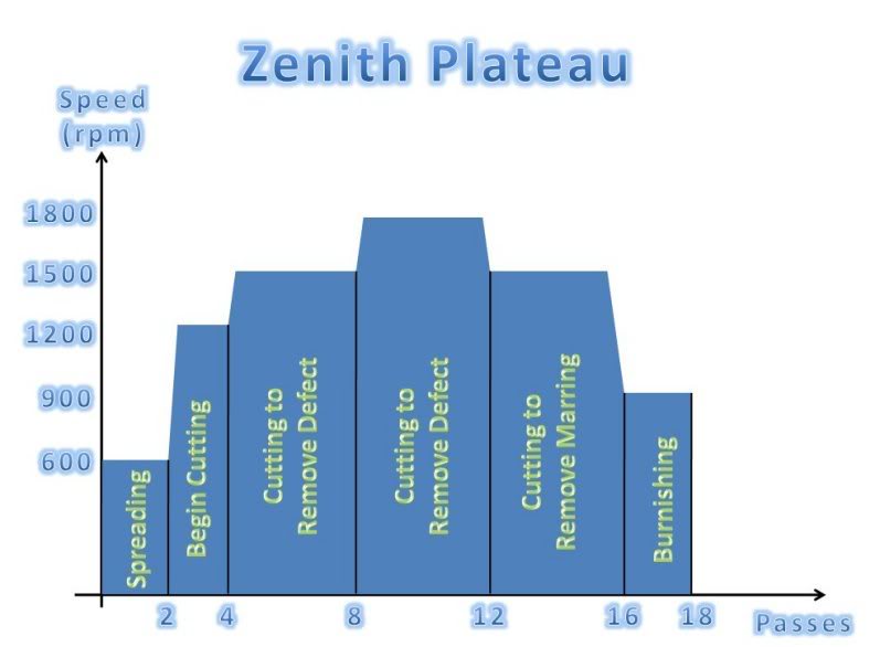

THE ZENITH POINT TECHNIQUE
A technique coined by rotary polishing expert, Brazo, to work diminishing abrasive polishes to ensure as best a finish as possible. This technique has been used and adapted by detailers – both professional and enthusiast alike – for some time. Every detailer has their own take on the method, and all will vary it according the the polish being used and the paint being polished. Here we look at the generics of the technique and how it can be varied to suit possible applications.
The basic outline of the technique is shown by the diagram below, taken from Brazo’s guide to rotary polishing:
The idea of this method is to start at slow speed, and work up to the Zenith Point. During this stage, and the passes as the fastest speed, the original defects in the paint are being removed by the abrasives. However the abrasives of the polish are also causing their own lighter defects. These are removed by the right hand side of the above diagram, slowing the speeds back down from the zenith point. This removes the polish induced marring and holograms so that you finish with a crystal clear finish.
EXTENDING THE ZENITH POINT TECHNIQUE – THE ZENITH PLATEAU
Here we look at methods of extending the generic technique above to the working of various polishes on the market today. The guide is not polish or paint specific, and changing either will affect the choices of speed, number of passes and applied pressure. Typically when machine polishing, the majority of the work is carried out at speeds of 1500 – 2000rpm. Once you reach the “working speed”, you plateau at this point until the abrasives and worked, reducing speed only for the finishing passes to burnish the paint to a high gloss and remove any faint holograms that may be left.

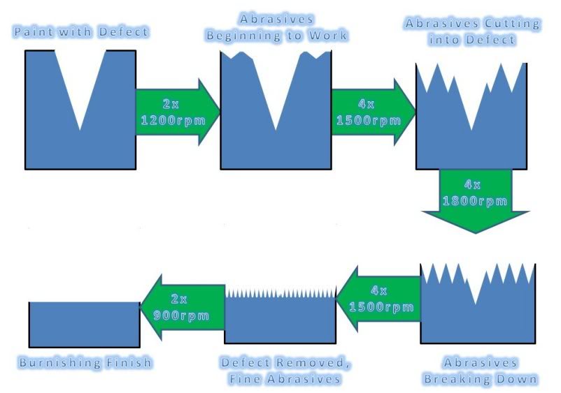

Shown in the schematic below is a typical set of speeds and passes made to work a polish with diminishing abrasives, such as Menzerna PO85RD3.02 Intensive Polish:
This method works the polish through its various stages of abrasives described earlier:
• 2 passes at 600rpm to spread the polish ready for use
• 2 passes at 1200rpm to begin working the polish
• 4 passes at 1500rpm to work the abrasives to remove the defect
• 4 passes at 1800rpm to continue working the abrasives to remove defects
• 4 passes at 1500rpm to remove inflicted marring with the now lighter cutting abrasives
• 2 passes at 900rpm to burnish the finish to a high gloss
A total of 18 passes per section may seem like a huge amount! However, with many polishes on the market today, a large number of passes are required to fully work the abrasives and get the best out of what the polish has to offer.
Shown in the diagram below is a schematic of the abrasives in a polish cutting through the paint to remove a paint defect and then burnish the finish, using the number of passes above:
The importance of the large number of passes becomes clear – not enough passes will result in poor correction through not getting the full cut the polish has to offer. Additionally it will result in inflicted marring to the finish and poor overall level of gloss.
The above is simply a suggested example for a number of passes and speeds to use. Some types of polish will work better at lower speeds, others higher speeds. Different detailers will also favour different numbers of passes and different speeds. When testing out which polish and pad combination are required to deliver the correction required, it is also worthwhile spending some time learning what speeds and pressures you will need to use to get the best results from the polish. The paint also has an effect on this!
On the face of it, there are a huge number of possible variables on the table, each affecting the final outcome. This may now look very daunting. In practice however it will quickly become clear what methods will work for a specific paint type, and on some occasions it will be necessary to spend a little more time learning the paint to get the best results. The above should give you a starter from which to build and is only intended to be a generic guide.

EXAMPLE – FERRARI 355
Shown in the picture below are light swirls evident in a Ferrari F355’s paint finish. The finish does not contain RDS or severe scratches.
To remove the defects, a light polish and pad combination is tried first – for example Menzerna PO106FA Final Finish on a LakeCountry White Polishing pad. This will remove only a small amount of paint. However as the 50/50 picture below show, this was adequate to remove the marks from the paintwork:
Having found that this light polishing combination has delivered the required correction, the rest of the car can now be corrected in the same way to deliver the finish over the whole car:
Regions of more severe marring, if they exist, can be tackled either by repeating an application of the light combination or stepping up to a more aggressive combination on the local area.

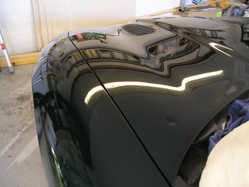

EXAMPLE: BMW E39 5-SERIES
Now let us look at something a little more severe. Shown in the picture below are moderate swirls and RDS in a BMW E39 5-series finish.
Now BMW paint has the reputation for being hard. However, a light polishing combination would be trialled first just in case this was all that was needed – for example Menzerna PO106FF Final Finish on a Meguiars W8006 Polishing pad. The results of using this polish combination are shown in the picture below.
Clearly in this case the light polish and pad combination has not had the desired effect. The swirls are still evident, as are the deeper marks. Only an improvement to the gloss is really evident and this is only slight. So, presented with this, we can see it is necessary to step up to using a more aggressive pad and polishing combo. Before doing this however it is prudent to check the thicknes of the paint to ensure that significant amounts have not been removed for little return – if this is the case, then chances are that to remove the marks will require too much paint removal and an alternative method would need to be looked into.
In this case we now move to trying out a more aggressive polish on the same pad: Menzerna PO85RD3.02 Intensive Polish on a Meguiars W8006 polshing pad. The results of this are shown in the picture below.
The use of a more moderate pair of products has results in greater correction – the light swirls are now removed and the gloss more noticeably enhanced. But the severe swirls and RDS are still clearly evident suggesting that a more aggressive combo is still required. As before, the paint thickness should ideally be checked before stepping up the aggression scale to something more serious.
In this case, it is clear that the paintwork is quite hard and that the marring is severe which points to a compound being necessary. For example, Menzerna S34A Power Gloss on a Meguiars W7006 Cutting Pad. The use of an aggressive cutting pad and compound combination should be a last resort and the thickness of the paint should be checked before hand to ensure the safety of the method. Additionally the use of an aggressive compound can leave its own marks in the paintwork as discussed above. For this reason it should always be followed with a light polish and pad combination to refine the finish – for example Menzerna PO85RD Final Finish on a Meguiars W9006 finishing pad. Shown in the picture below are the results of using these combos on this paintwork.
This combined aggressive combination followed by a finishing combination has resulted in all of the swirls and RDS being removed from the finish and a high gloss and clarity being restored.

EXAMPLE: JAGUAR S-TYPE
Shown in the photograph below is a deep scratch mark in the rear wing of a Jaguar S-Type. The area here has been polished already with a light abrasive to remove surrounding swirls and restore the gloss but the deeper mark is unaffected.
Confronted with this situation, the paint thickness should first be checked to ensure continued polishing is safe. Here, complete removal of the mark would not be possible owing to its depth and the thickness of paint available. So in this case, a medium abrasive polish and pad combination (for example Meguiars #83 Dual Action Cleaner Polish on a Meguiars W8006 Polishing pad). The results of two applications of this process are shown in the picture below.
The scratch is still visible, but its severity has been significantly reduced. The removal of sharp light catching edges of the mark have made it less visible.

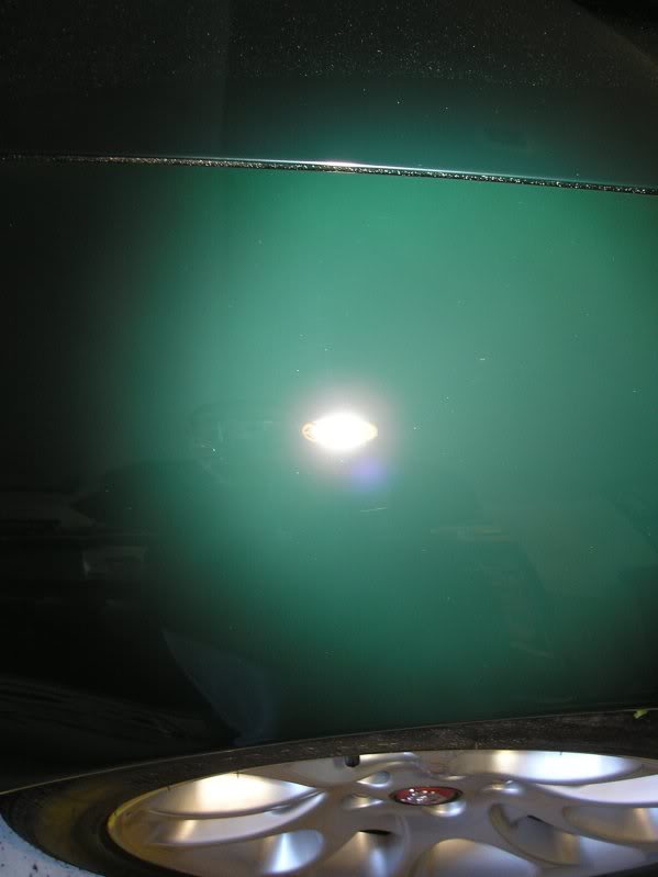

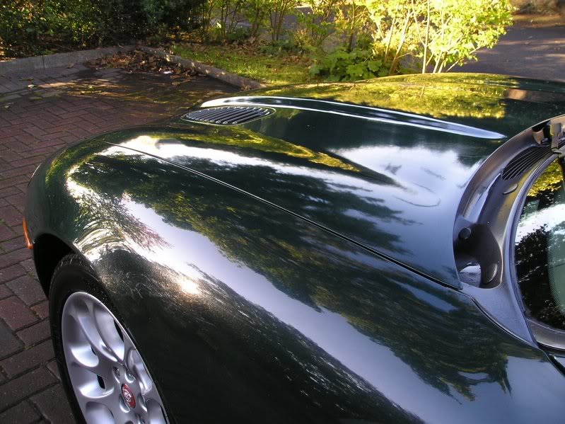

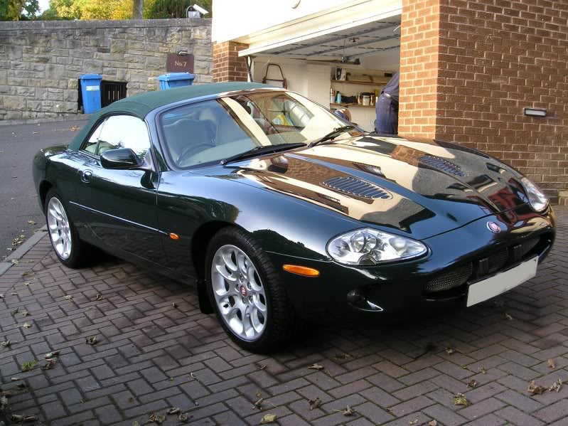

EXAMPLE: JAGUAR XKR
This car shows an example of severe paintwork defects. In natural light, the finish on the paintwork looms flat with poor reflections:
Under the lights it is clear to see why the paintwork looks this way – there are severe machine induced swirls and holograms in addition to poor finishing of respray work:
In order to rectify this by machine polishing, heavy cutting compounds would be required, followed with dedicated finishing polishes to refine the finish. For example, the defects could be removed by using a compound such as Menzerna Power Gloss on a LakeCountry Cutting pad. Then the finish could be refined with a finishing polish such as Menzerna Final Finish on a LakeCountry Finishing pad.
The results of using a rotary polisher in practice on the above finish are shown in the pictures below. The deep swirls have been removed, and the poor finishing has been resolved to restore clarity and depth to the finish:
Naturally when machine polishing, defect correction is at the forefront of your mind. However, just as important as this (if not more so) is the enhancement to the general appearance that machine polishing can generate. This Jaguar is a prime example of this if we consider the before and after pictures below:
While the defects have been removed, the most pronounced difference to the finish is an enhancement to the gloss and depth. Full correction is not required to generate enhancements like this, but time and effort in the finishing processes most certainly is! This highlights that chasing every last RDS on a paint finish is not necessarily going to gain you very much in real world terms, but will cost you a lot in terms of amount of paint removed.
The results on this car of dedicated rotary polishing are shown in full in the picture below:

HOLDING THE POLISHER
There is a huge variety of rotary polishers on the market, all with different designs of bodies, heads and handles. However, the typical method of holding the machine remains consistent for most on the market, and also amongst most detailers. Finding the best way to comfortably hold your machine will take time and there is no right or wrong way providing a few basics are observed
One of the most important things when machine polishing is to get comfortable! If you are tense or stretching awkwardly, you will find the machine polishing experience an uncomfortable one. Always ensure before you switch the machine on that you can easily reach all areas that you are planning to tackle, and that the pad is of suitable size. With a rotary polisher, which has the inclination to drive itself, you want to be as relaxed as possible to avoid inadvertently fighting with the machine.
You typically hold a machine polisher with two hands. One arm will be the driving arm, and the other arm will be used to help guide and control the pressure applied to the head of the machine. The most common choice of arms is that your writing hand is used as the driving arm.
Shown in the pictures below are examples of the popular Metabo polisher being held as described above. The users have their driving arm at the back of the machine and this is used to control its movement. Their other hand is on the head of the machine to help guide where necessary and also to adjust the pressure applied to the pad.
In the picture below is a Rupes LH18 EN rotary which has a longer looking body than the Metabo shown above and a more square head to it. However, as can be seen, the method for holding the tool is practically the same: driving hand at the back, pressure hand at the front.
HANDLE – USE OR NOT?
Some machine polishers, for example the Makita 9227CB, are supplied with a handle which attaches around the head of the machine. The use of the handle is purely personal preference. When starting out with a new rotary, it is best to try it with and without the handle to see what you feel most comfortable with.
The picture below shows a Makita 9227CB being used without the handle in function – the method above is still in play, driving hand at the back and pressure hand over the head of the machine.
By contrast, the user of the Makita below is using the handle for their pressure hand:
As with most things detailing – there is no right or wrong answer to the specifics, only the general methods. Find what method is most comfortable for you, and run with that!
Another important point is to relax! Rotary polishers will want to drive themselves across the paintwork. This can be sued to your advantage in getting the tool to do most of the work for you. However, if your driving arms is tense, you will be more inclined to fight this natural movement of the polisher which will end up in rotary hop and a poor finish. Additionally if your driving arm (arm at the back of the machine) is tense, you will be less able to easily follow the contours of the paintwork. It is necessary when machine polishing to keep the pad flat at all times – this will be much easier if your driving arm is relaxed as you will find yourself better able to follow the contours and shapes of the body panels you are polishing.
DRIVING THE POLISHER
As described above, the rotary polisher is inclined to move of its own accord across the paintwork. This can be used to your advantage as the tool is essentially doing a lot of the work for you. Rather than trying to drive the polisher in any direction you want, it is easier to move with the rotary – this will result in a smooth flowing motion that is required for the very sharpest and clearest of machine finishes.
Use your back arm to drive the polisher. When working on large flat panels, the natural motion that the rotary will want to follow typically is an arc. Try not to fight it back onto a straight line but allow the machine to do this arc and guide it backwards and forwards over the desired work area. For users coming to the rotary from a dual action polisher, this is quite different to normal – a DA requires driven and can be driven in pretty mjuch any direction you like. The smoothest rotary operation will come from flowing with the natural movement of the machine.
On vertical panels which don’t have wide flat areas, like the Jaguar S-type shown in the picture below, the flowing arc movements will not be possible.
When preparing to tackle a panel like this, examine it carefully and spend a moment planning the best flowing movements across it. Be aware that forcing the machine across contours and edges should be done carefully and can cause a sudden change in direction from the machine. This can be avoided by carefully moving the machine across said edges. Where it is not possible to follow the natural movement of the machine, focus on making steady and gentle guidance movements with your driving arms. Avoid jerky movements and changes of direction where possible as this can lead to rotary hop in some cases.
Keep your driving arm as relaxed as possible at all times – this will allow you to flow with the rotary’s natural movements far easier and will aid the gentle and steady changes in direction. Additionally, keeping this arm relaxed makes it easier to keep the pad flat over contours and curves in a car’s bodywork.
Your pressure arm is typically placed over the head of the rotary polisher or on the handle to adjust the amount of pressure applied to a pad. The amount of pressure will vary from paint to paint, and polish to polish. Generally speaking, you will use lighter additional pressure with a rotary polisher than you would with a dual action polisher. Also, on horizontal panels, the weight of the machine (which is significant for models such as the Makita and Silverline) will contribute to the applied pressure. The effects of this are less on vertical panels where you will need to use your pressure arm to give the pressure required, and to ensure that the pad remains flat on the panel.
The speed at which the rotary polisher is moved across the paintwork will vary depending on what polish is being used, what paint is being polishes, and also what speed the machine is set to. Faster movements than with a dual action polisher are quite acceptable – indeed moving the machine too slowly can result in high heat build up and the risk of burning the paint. For higher speeds, typical machine movement rates are around 2 – 4” per second, again depending on paint and polish. Ensure that the panel temperature does not get higher than warm to the touch – if so, either there are problems with the polish or you are moving the machine too slowly. Slower (1 – 2” per second) passes may be used for lower speeds on the rotary during the refining and burnishing stages.
Pay particular attention when polishing near panel edges and sharper contours in the bodywork. These regions can result in local high pressure points and high temperatures can quickly be generated. This risk of burning the paint on these regions is much higher than flatter panels when all other things are equal. It is a good idea to lift off the pressure a little going near edges and contours to help keep the heat and the risk of burn through to a minimum.

Begin by spreading the polish at the lowest available speed on the rotary (600 – 1000rpm), making fairly fast movements of the machine to start with and then slower movements for another pass or two to evenly spread the polish. If the residue does not spread easily, this may be because the panel is cold – a few more passes at low speed will get a little heat into the panel and allow the easier spreading of the polish.
Once the polish is spread, the machine speed can be raised (to around 1000 – 1200rpm) to begin working the polish and cutting away the defects:

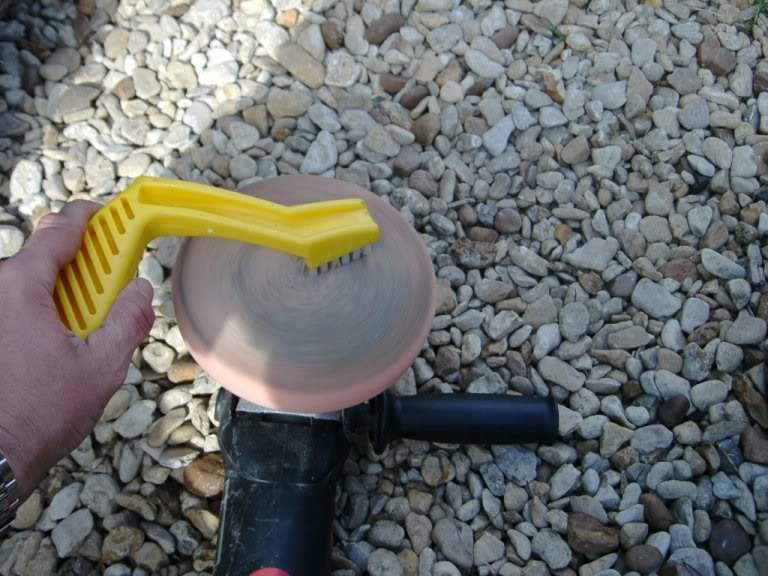

Clogged and dirty pads can result in poor quality finishes as the foam is not performing to its optimum and effectively breaking down a polish. It is important when machine polishing to regularly clean the pad surface to ensure that the foam can work at its optimum.
To clean a pad face, use a soft bristled brush on the face of the pad. Gently hold the brush on the pad with the machine polisher turned on at low speed as shown in the picture below:
It is crucial to be gentle with the pad, especially soft finishing ones as bristles from the brush can cut into the foam and ruin the face of the pad. This will result in the pad not performing to its optimum and could result in holograms being inflicted in the finish.
You can also clean foam pads with the machine off and using a soft brush, gently brush the dust and caked on polish off of the pad.

On rare occasions, you may find that some cars have swirls that are underneath the clear coat as shown in the picture below.
In the rare event of below clear coat swirls (generally a result of a poor paint repair), the removal of the top layer of paint by machine polishing will make no difference to the marks. In fact it will be impossible to correct these swirls without resrpay work!

In the case of swirls inflicted below the clear coat, the only solution here is to respray the car as to get to them, the top most layer of paint would have to be removed.
HOLOGRAMMING
Probably the most commonly known issue with rotary polishing is the infliction of holograms on the finish. Holograms looks like clouds on the paint surface that move as the light moves across it. Typical examples of holograms are shown in the pictures of a Peugeot 206 below:
While this looks very severe, the typical depth of hologramming is quite low – lower than standard paintwork swirls. The reason for the severity in appearance is that holograms are basically thousands of tiny little swirls tightly packed together and inflicted by abrasives in previously used polishes and compounds. Despite looking horrific, it is typically quite easy to remedy.

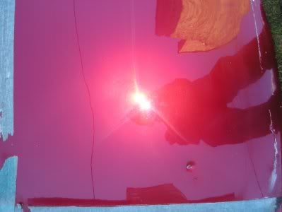

STRIKE THROUGH
So far, all of the problems discussed can be easily and inexpensively solved. Strike through is a different kettle of fish! Strike through is the term used to describe polishing through the top most layer to the underlying layer as shown in the picture below.
In this example, the clear coat has been fully removed in this area and the colour coat revealed. This is repairable only by respraying the paintwork!
EXAMPLE: PEUGEOT 307

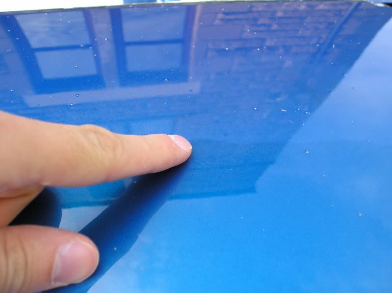

Shown in the picture below is strike through of the clear coat on a blue Peugeot 307 door.
In daylight, this damage is quite hard to see – the strike through area is slightly lighter than the surrounding paintwork (just above the finger) and lacks the gloss. The effects can be more clearly seen under a bright light as shown in the pictures below - strike through area on the left.
This is clear damage which requires an expensive repair. The first warning of strike through comes from visually checking the paintwork as you work – any evidence of a strange change in colour should raise the alarm bells! Also, the pad will turn the colour of the paintwork as shown in the picture below.
This pigmentation of the pad is normal for two-pack paintwork where there is no clear coat but is indicative of damage on a finish where the is a lacquer layer! Strike through can also occur on two-pack finishes where you would go through to the underlying base coat.
Checking the paint thickness on the struck through area we can see a reading of between 70 and 80um… While this thickness would still be okay for some cars, clearly for this Peugeot 307, this was too thin! Numbers in this region should also bring about caution when machine polishing!
CAUSES
Strike through is caused by using too aggressive a polish and pad combination on paint which is too soft. This results in the removal of too much clear coat. Do not panic however! Providing you exercise caution when machine polishing, strike through is a rare occurrence.
SOLUTIONS
Prevention is better than cure! If possible always check the paint thickness on any vehicle you are planning on polishing. Be sure to take many paint readings, as a car can have local thin spots which are quite small in area and easily missed. In regions where the paint is thin, exercise a lot of caution and don’t use aggressive cutting combos. Always monitor the thickness of paint being removed during the initial testing to see who hard or soft the paint is which will give you an idea of which combos are safe on which thicknesses.
If you don’t have access to a paint thickness gauge, then take comfort in the fact that strike through is a rare occurrence. Exercise caution, and don’t use aggressive combos unless absolutely necessary. If the paintwork seems soft, the use of aggressive cutting compounds is not recommended. Obviously there will be a small risk as any local thin spots will go unnoticed with no thickness gauge, but they are rare and you should not encounter any problems.
In the event of strike through, there is only one solution – a respray!
