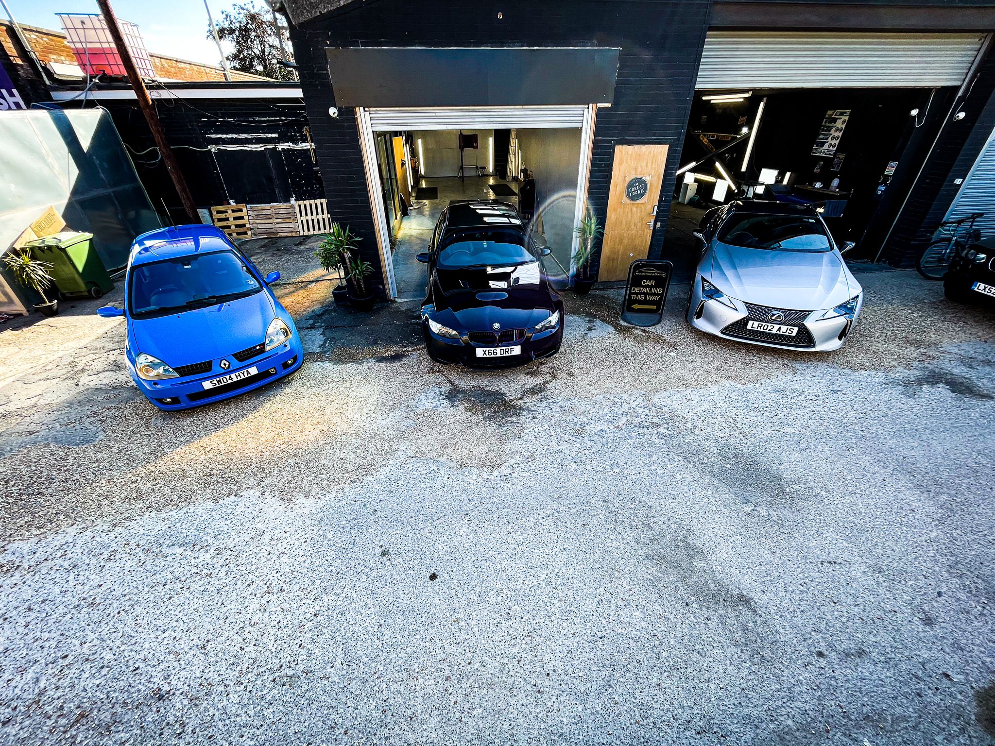

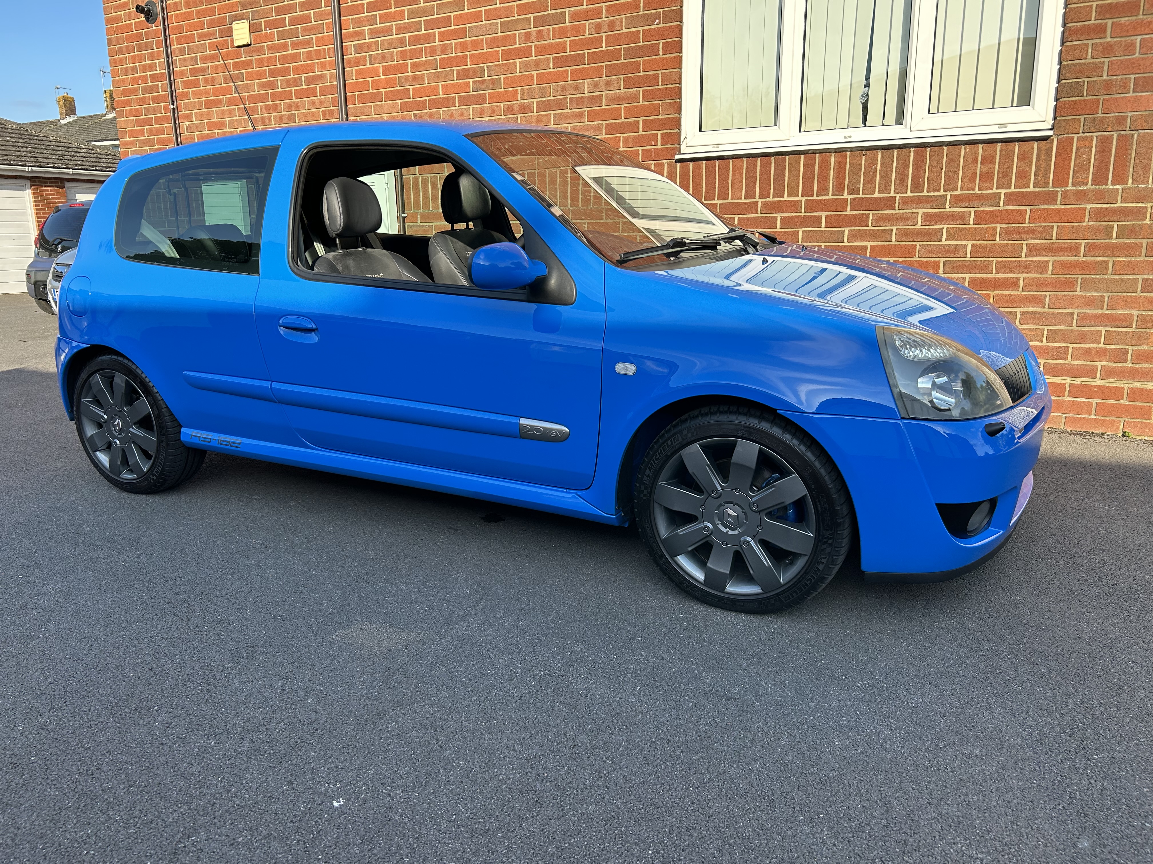

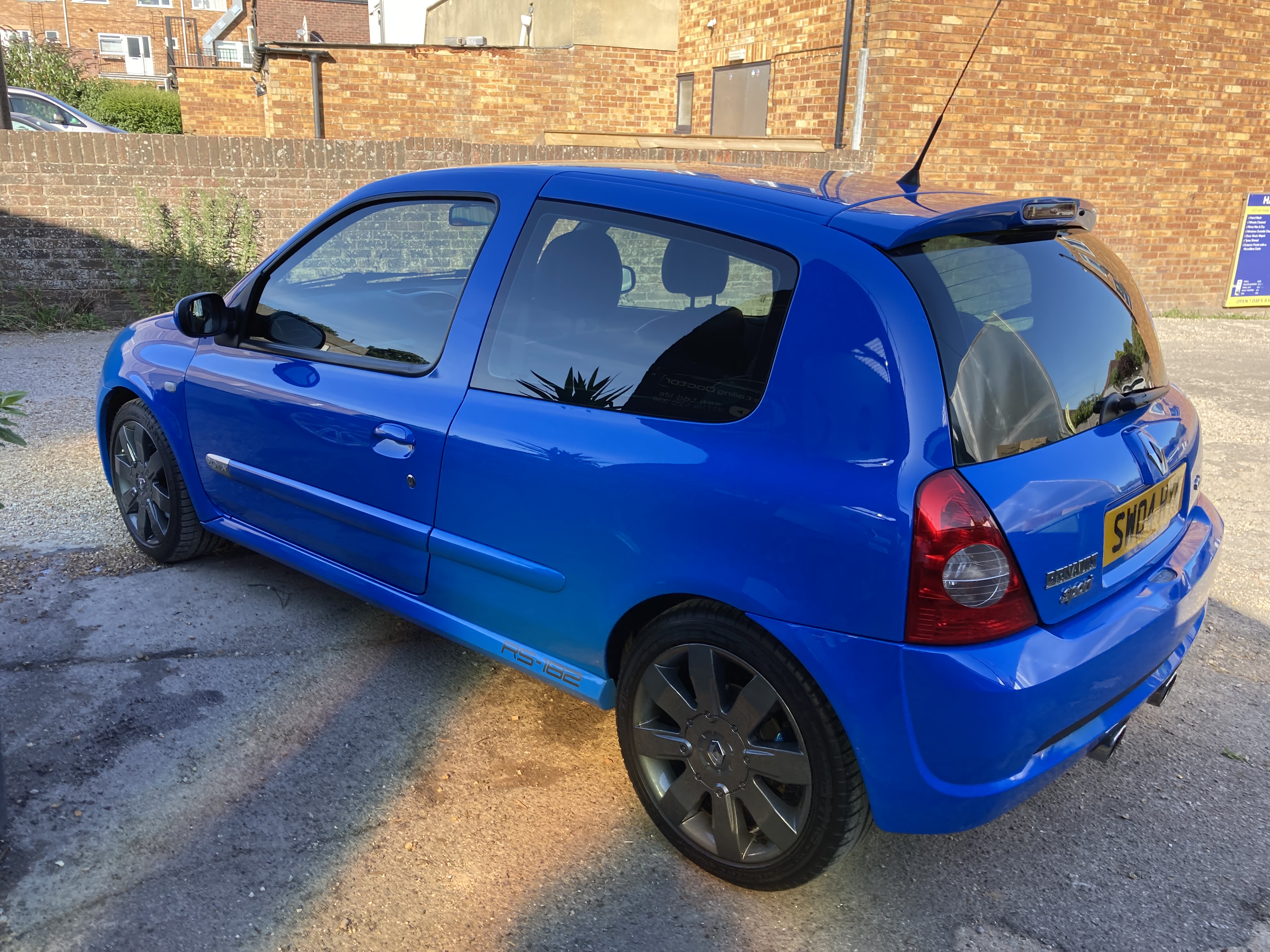

ajracer

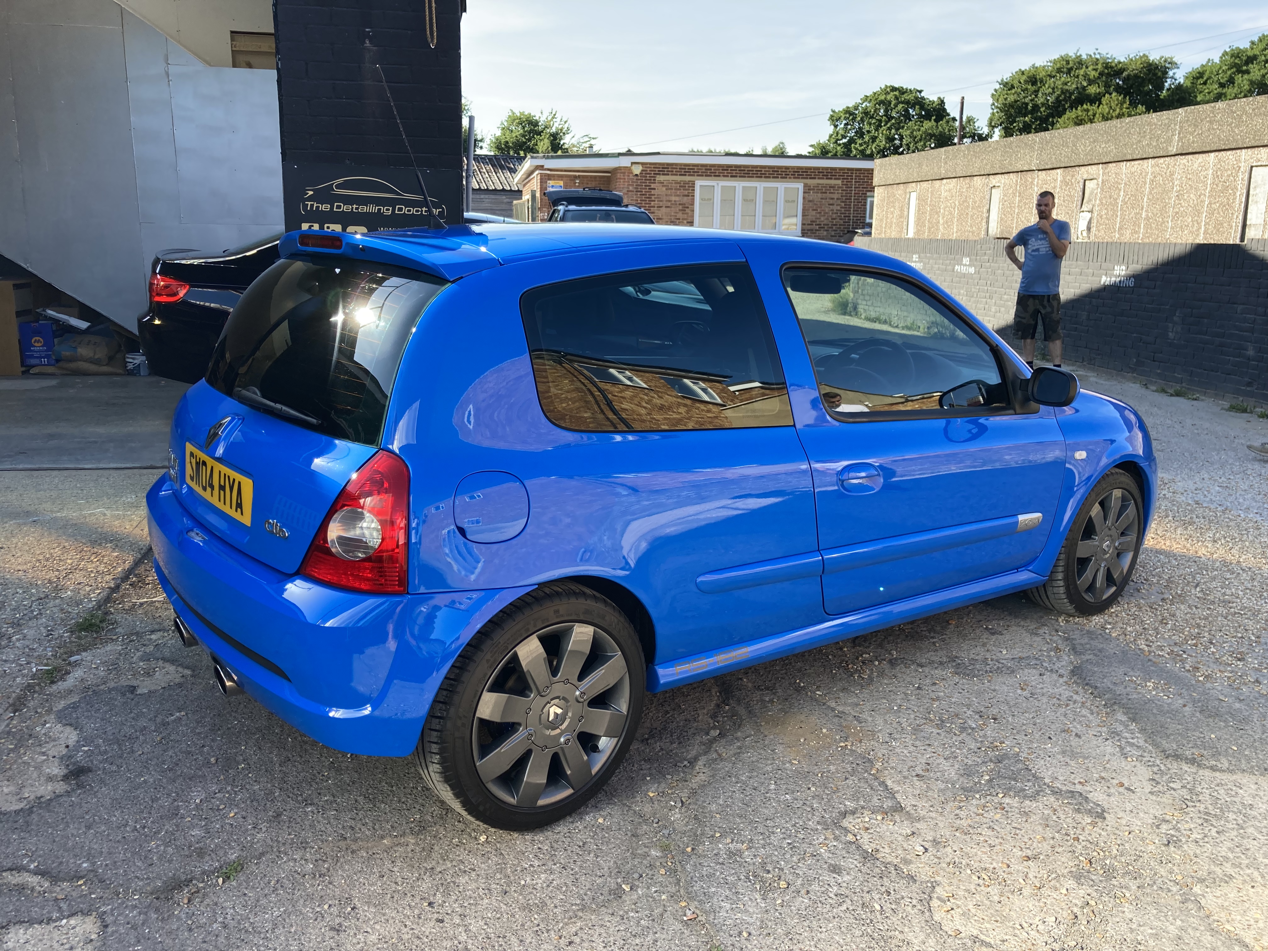

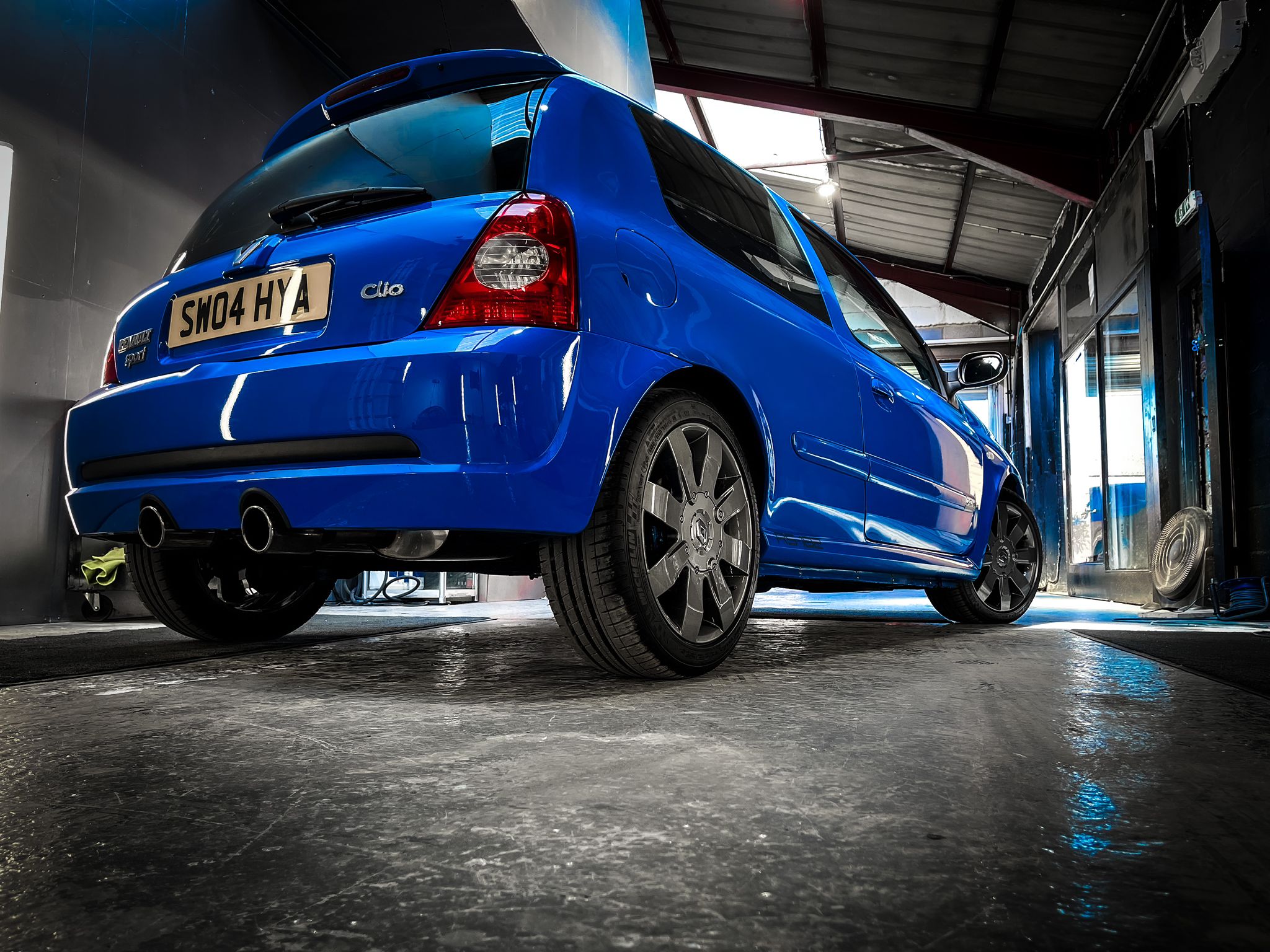

Picked the old girl up last evening and was blown away with the results.
Rather than going down the ceramic coating route of the Trophy I wanted to still manually polish the RB .
As she was such good shape a stage 1 plus swissvax Onyx canuba wax was the plan.
Studio pics first and my real world images after.
The car is bloody shiny!

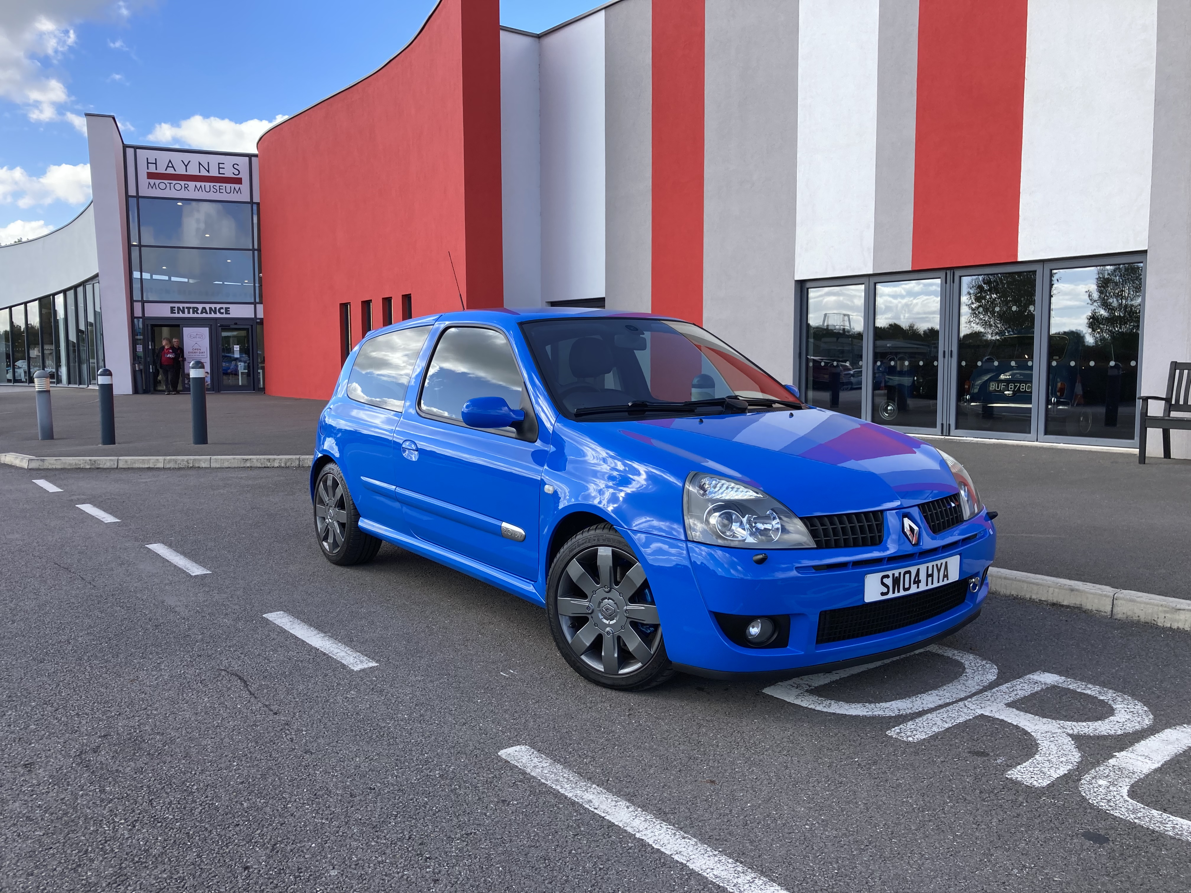

Had a free morning today and it was sunny and I thought sod it!
Bournemouth to the Haynes Museum near Yeovil is 50 miles away with country roads including ZigZag hill near Shaftesbury to enjoy.
Love this little car!

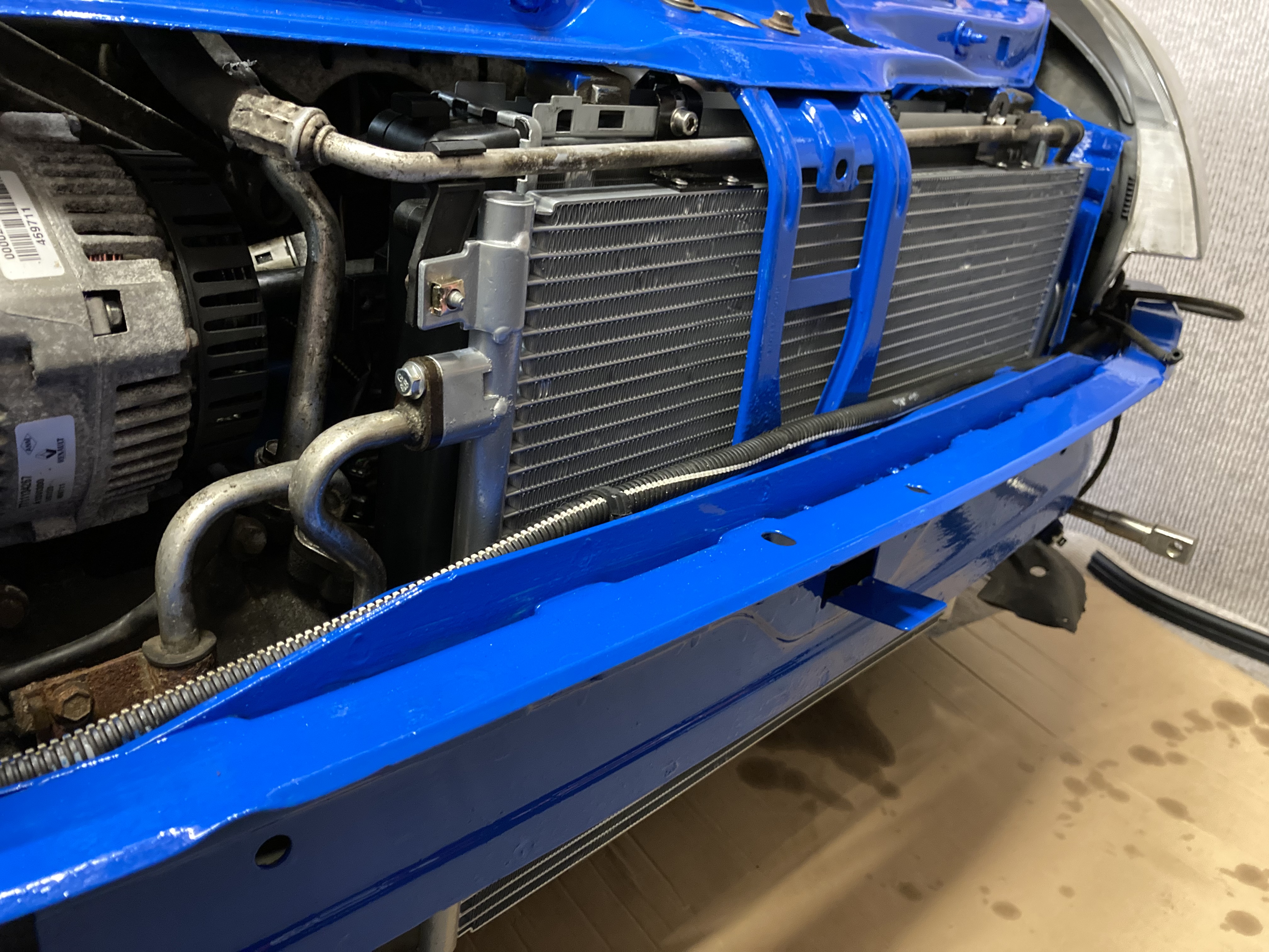

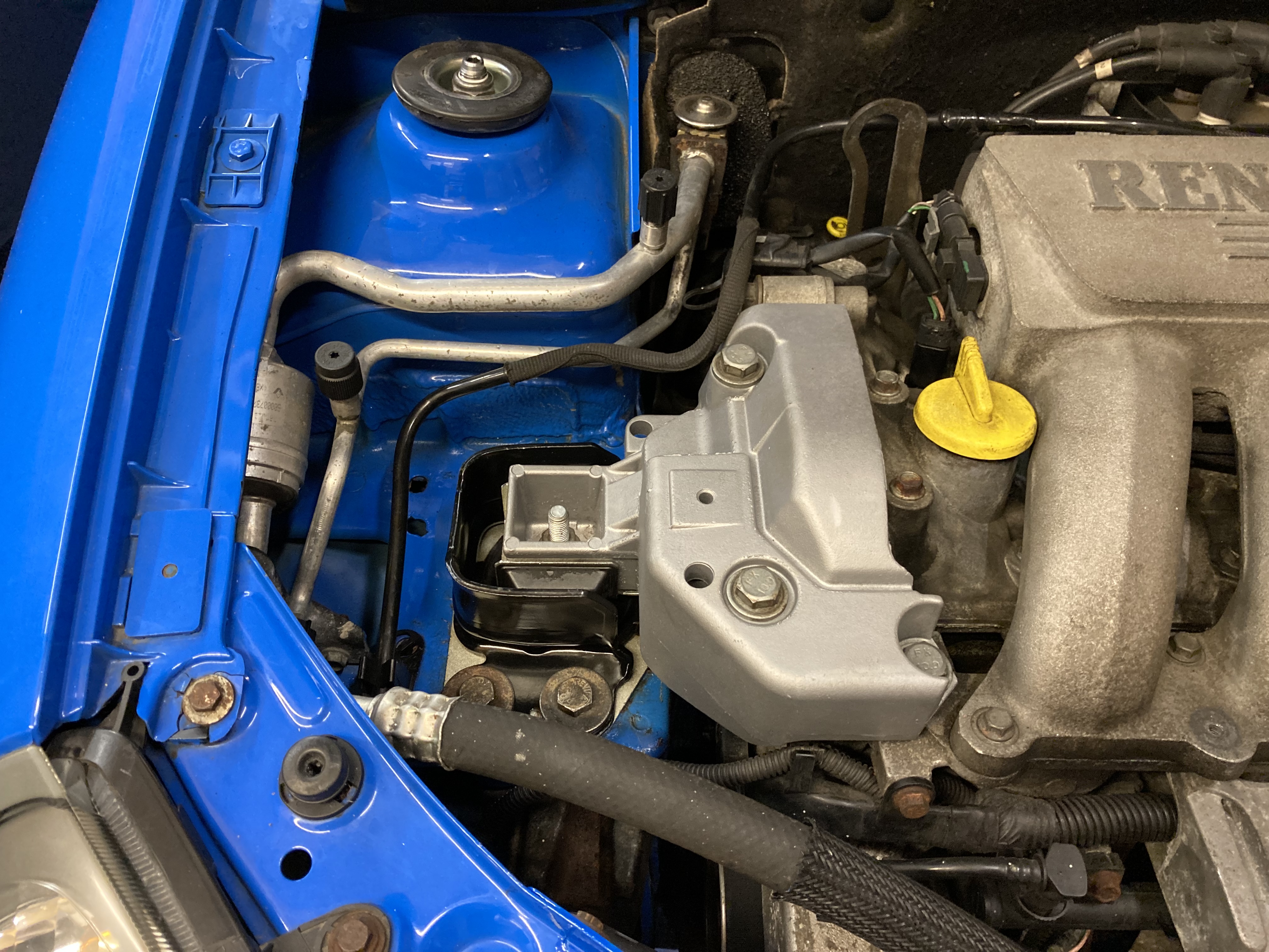

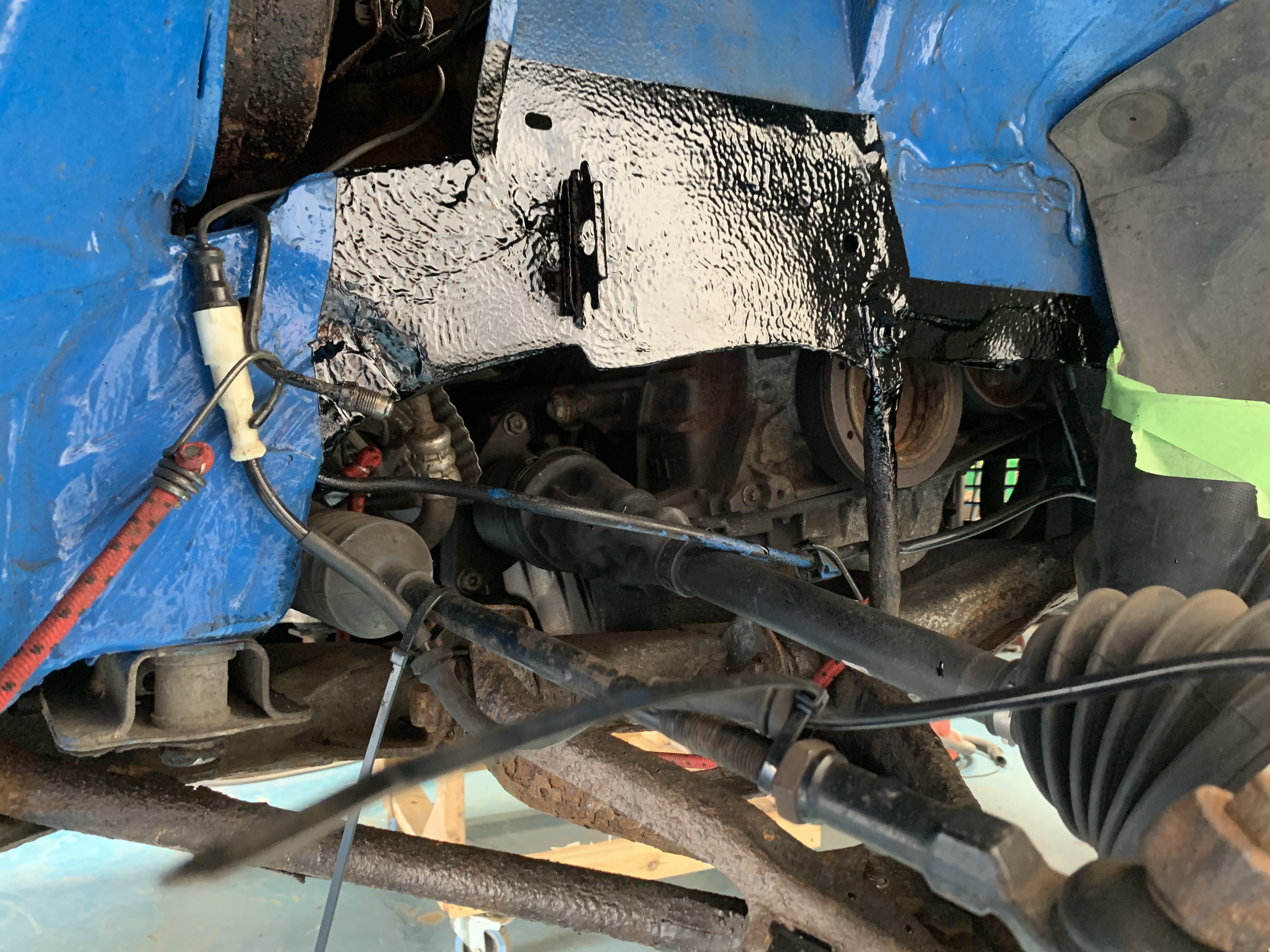

Well after just 2 weeks I’m tinkering again!

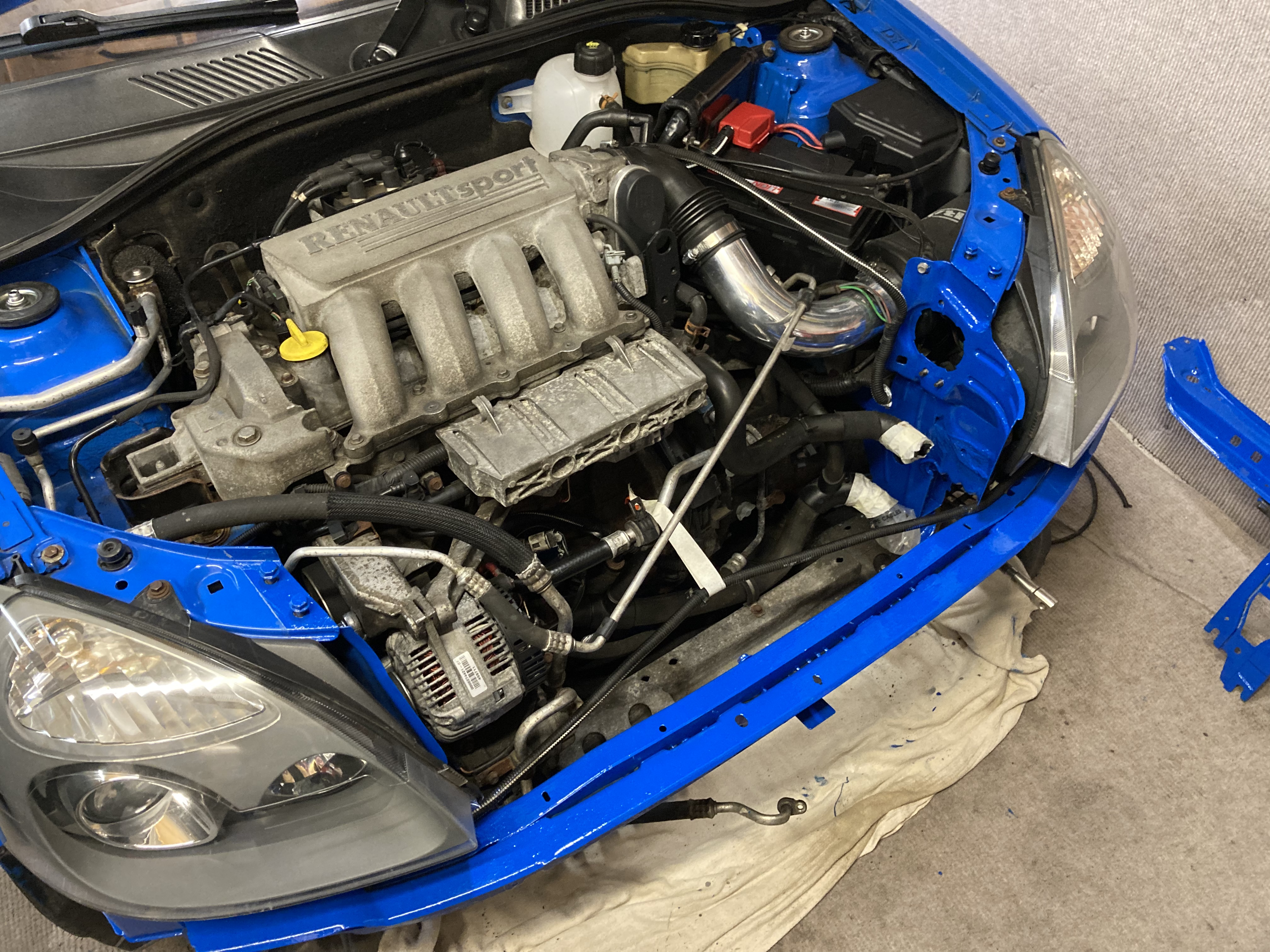

While at K-Tec the air con leak was tracked down to a corroded condenser.
A lack of time on the day and the part not being on the shelf gave me the chance to give the front end of the car some attention.
Bumper off, slam panel and faulty condenser removed revealed the radiator wasn’t looking too special either!
So after removing the fan housing, radiator, mega flush out of the coolant, sanding down some minor corrosion, applying Hydrate 80, primer, top coat she now looks like this!
I also found a spare top engine mount, a vapour blasted bracket in the war chest of parts I’ve squirrelled away and popped them on too.
Once the new condenser arrives latter this week i can put her back together with the new radiator and thermostat.
ajracer
Found some time this morning to fit the new radiator, condenser and dryer canister that sits alongside.
The flexi hoses/pipes had previously been cleaned up with new seals/O rings installed.
If I get a chance this week I will fill her up with D coolant, check for leaks and then fit the bumper back on.
If all is good I will get the air con re gassed at the weekend.
RB will be pretty much done.

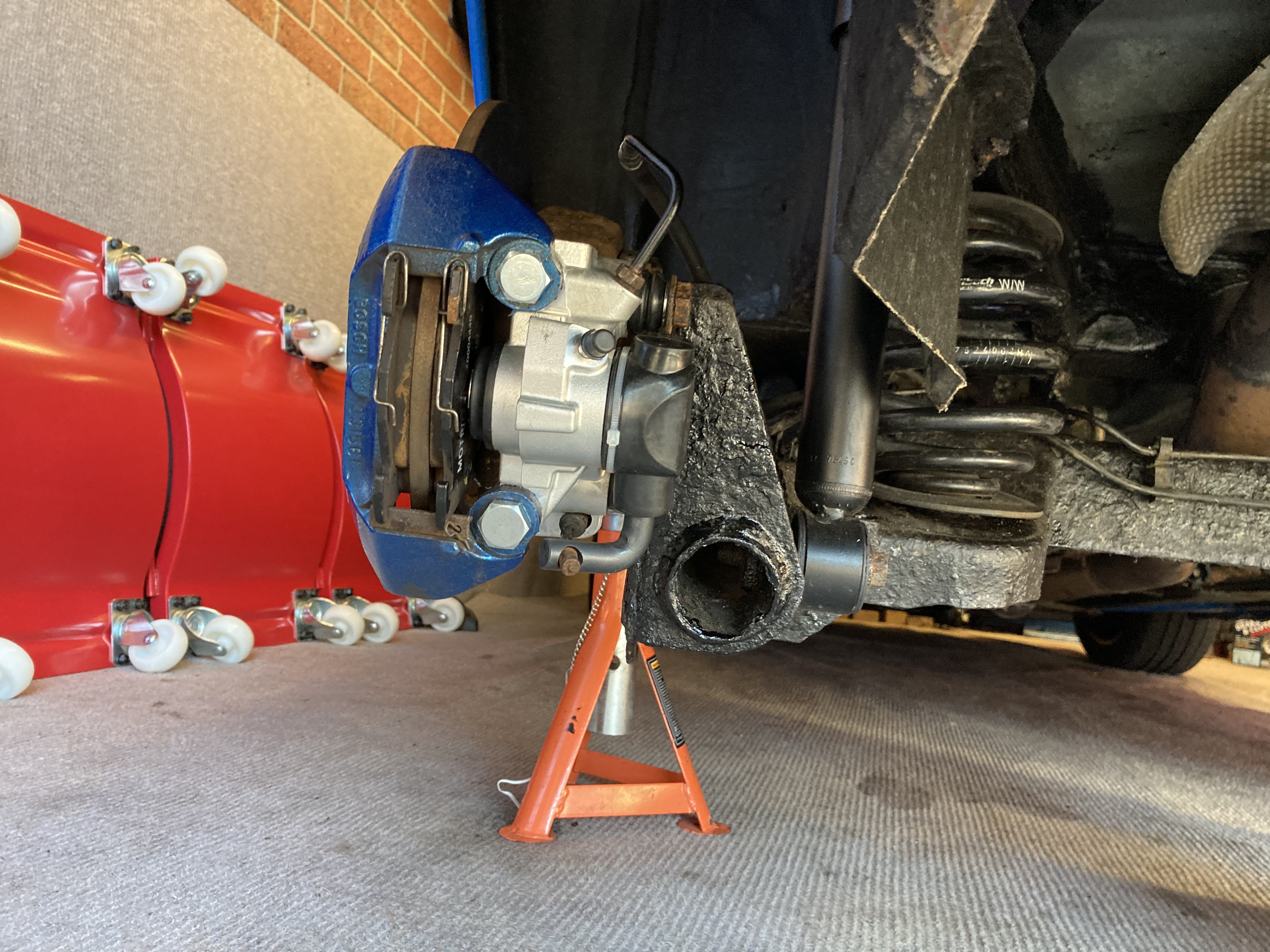

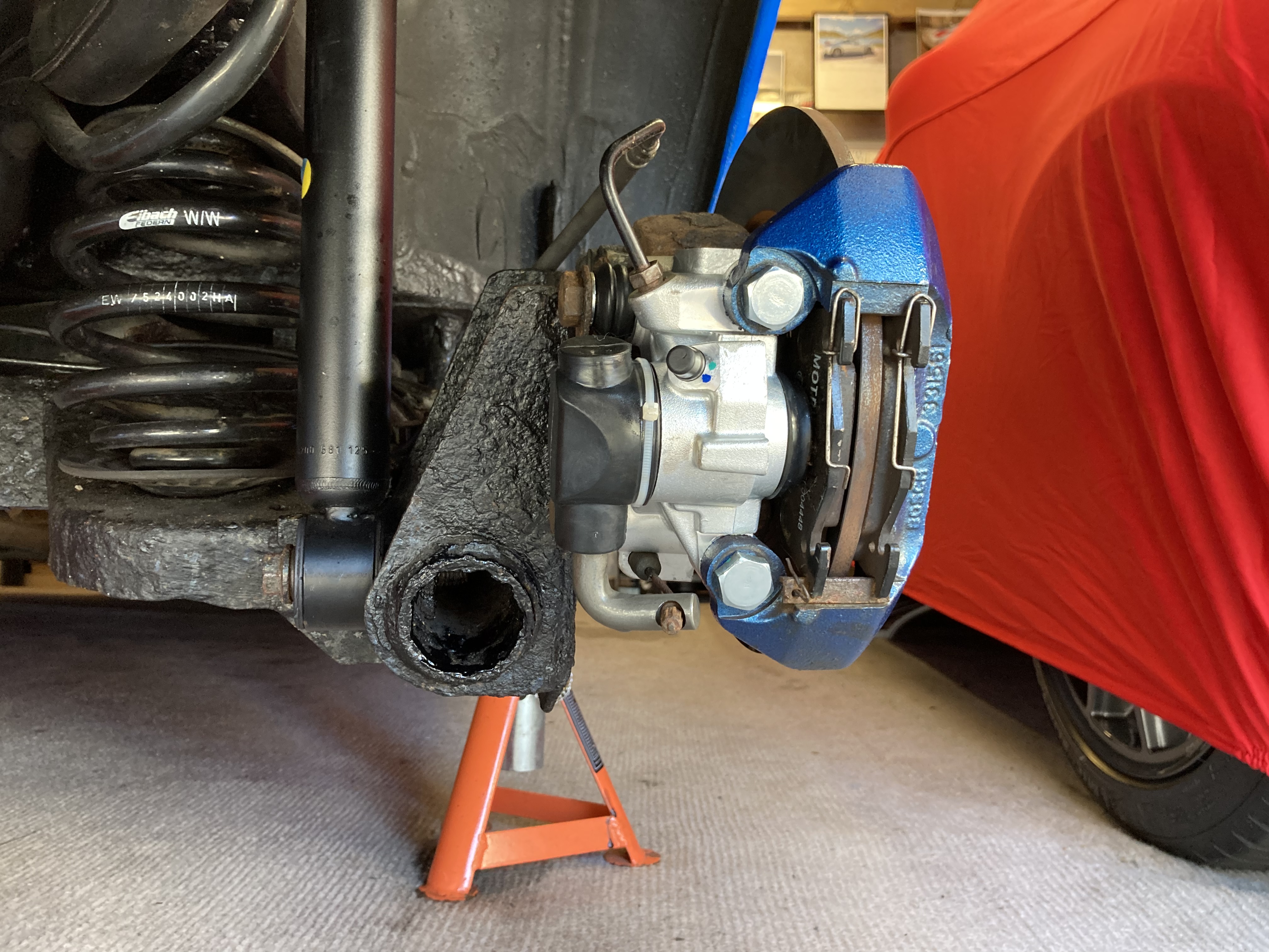

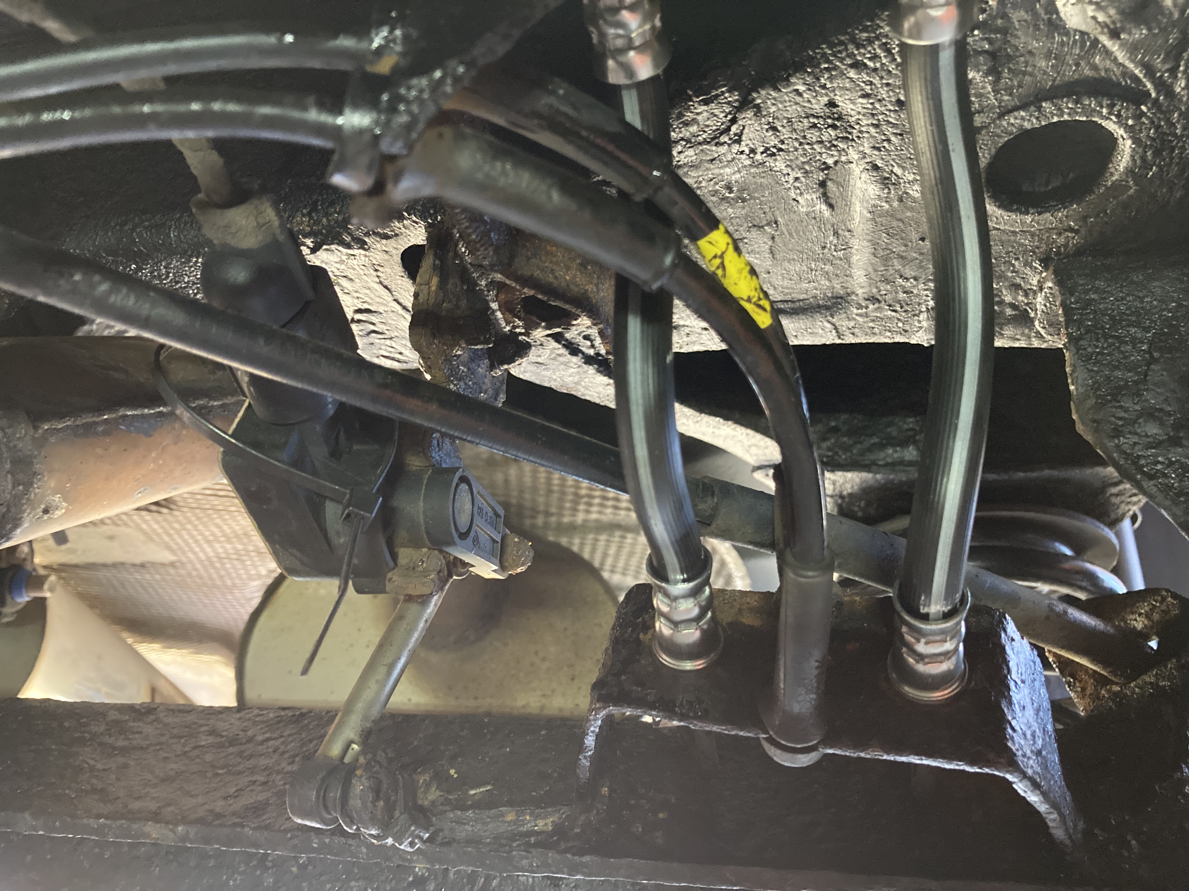

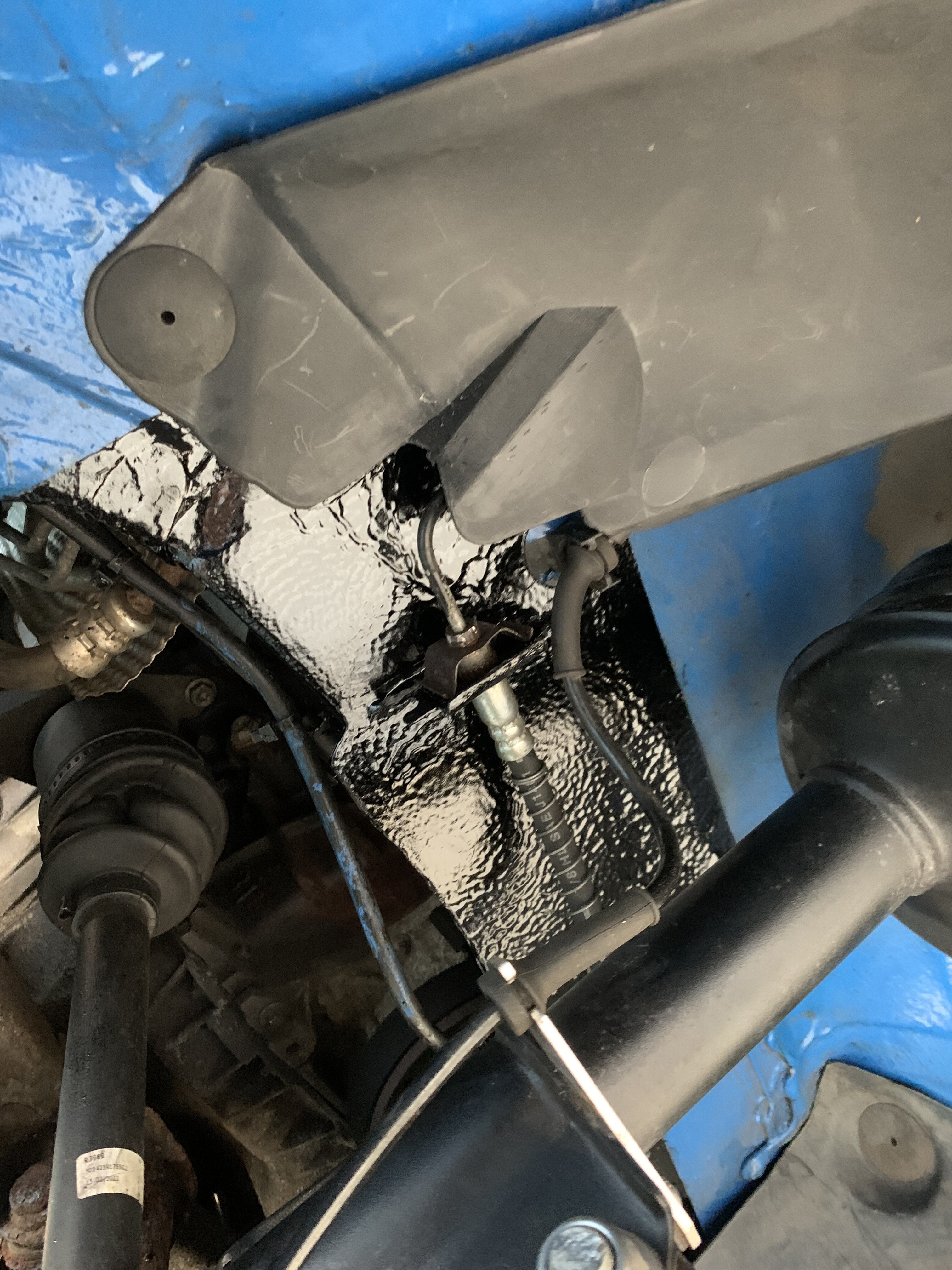

RB passed her mot late December with a couple of minor advisories.
1. Handbrake mechanism binding slightly.
2. The rear beam flexi hoses showing signs of corrosion.
As the parts are so reasonable new I fitted 2 new hoses and rear calipers.
We have been together exactly a year and I have got her to a condition where she handles and drives superbly without spending a fortune.
Having said that i am quite handy with the spanner’s so have saved a considerable amount on garage labour.
For the build thread I will post up a list of all the many new parts that have been fitted.
Think I might need a new project! Thanks for reading. Andy.

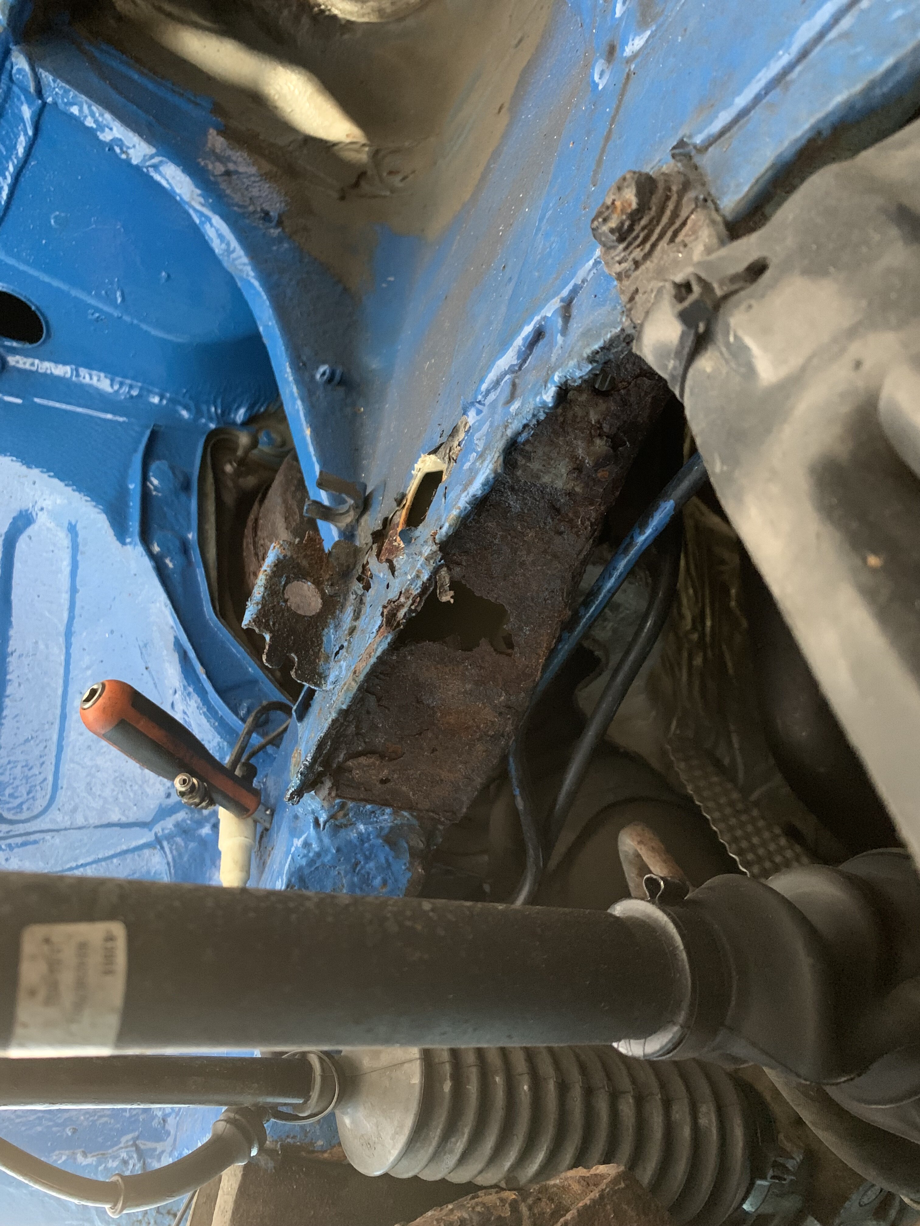

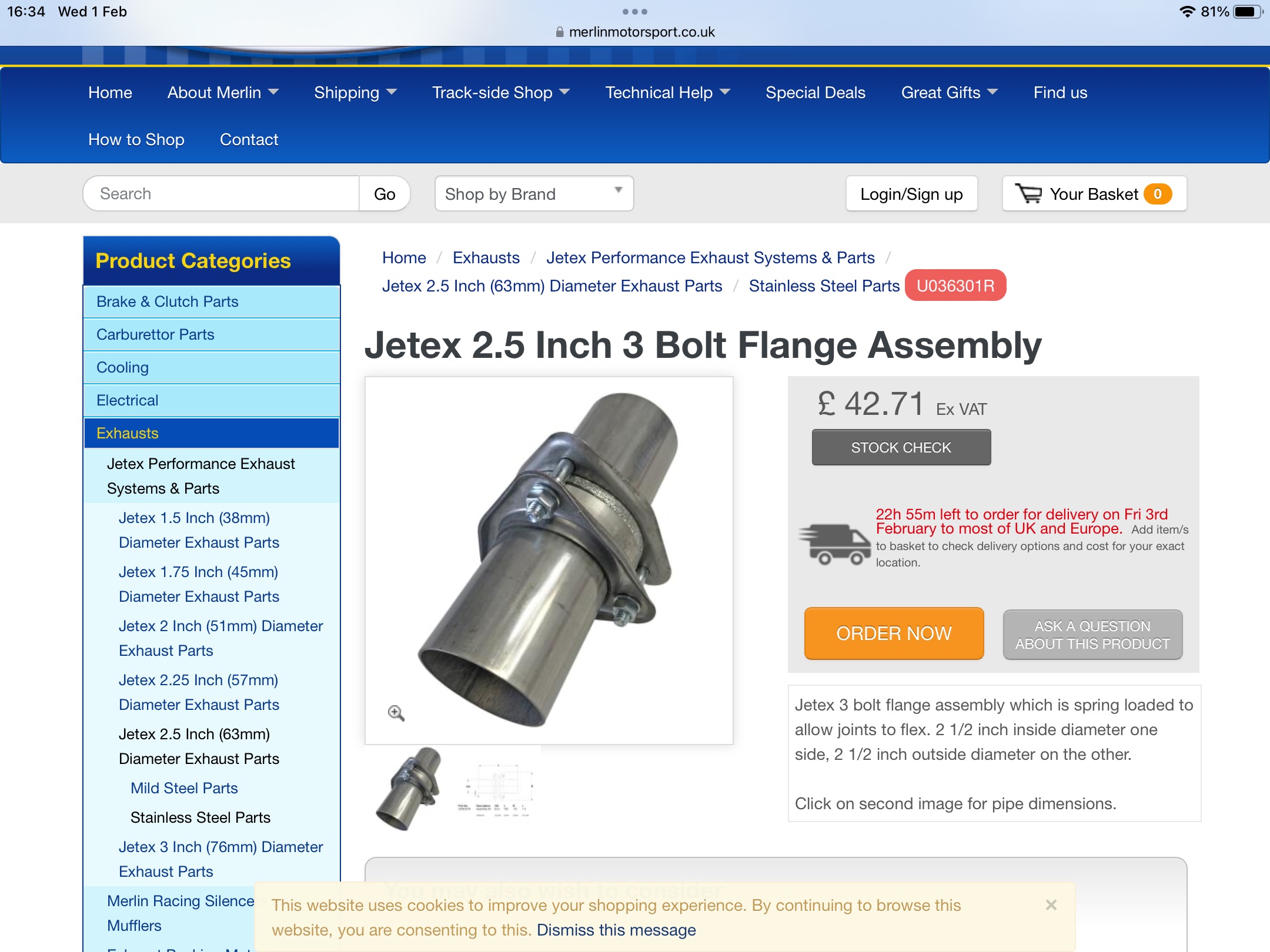

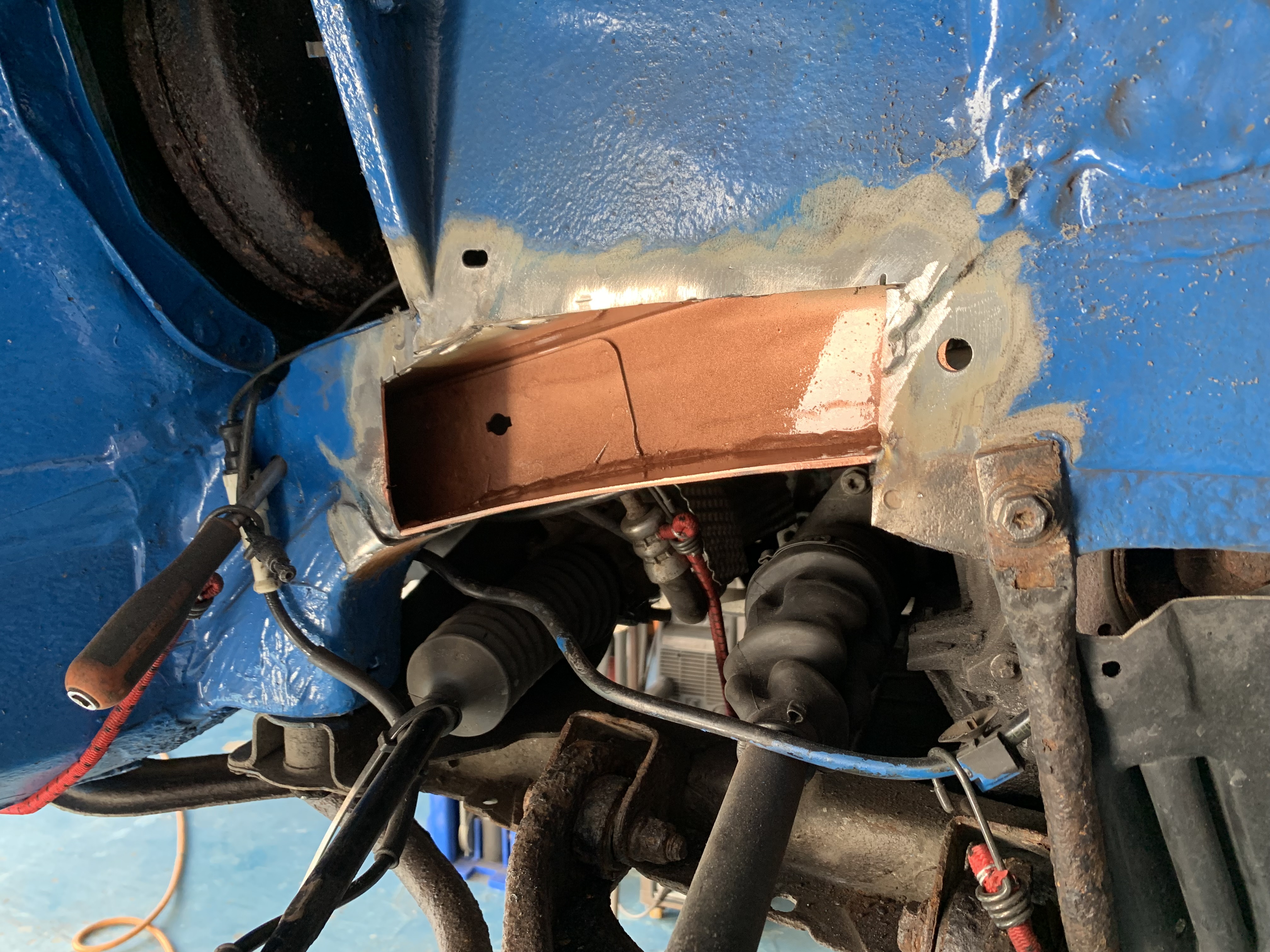

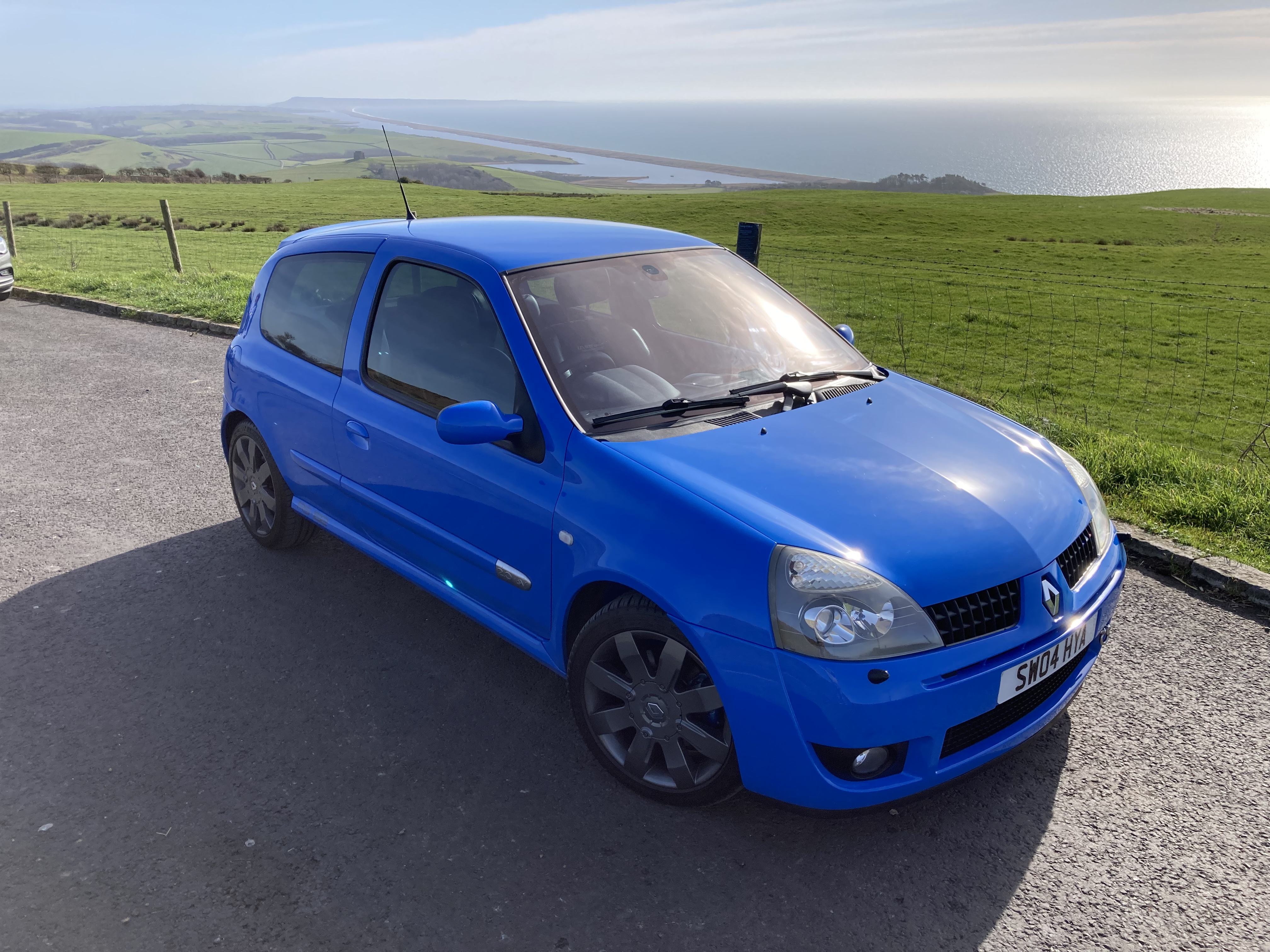

One last job which I’ve been looking for a permanent fix to is the Cat/manifold flexi joint.
There are several ways to sort this and most work well if going down the sports cat route.
My local garage has done a reasonable job in welding a couple of nuts on the end of the Oem cat so the spring bolts hold the lot together. It’s lasted several months but I might be taking RB on an adventure in Europe and don’t want the whole lot dropping off while driving through the pyrenees mountains!
She is booked in next Saturday to have this welded in which appears to be a cost effective solution.
This Sunday the weather down in Dorset was fine ,no salt on the roads and i persuaded the Doris to join me on a blast out.
We ended up at Lyme Regis for lunch but on route the coast road from Portland via Abbotsbury to West Bay(Broadchurch) is fantastic.
This is the view looking back towards Chesil beach.

To update her history for future reference the following list documents the work/new parts i and others have fitted.
EXTERIOR/BODYWORK
New oem fog lights
New oem number plate light
New windscreen
New wiper blades
New oem bumper insert stickers
New oem front arch liners
New oem slam panel rubber seal
Extensive underbody/interior cavity corrosion prevention works(sills,bumpers removed)

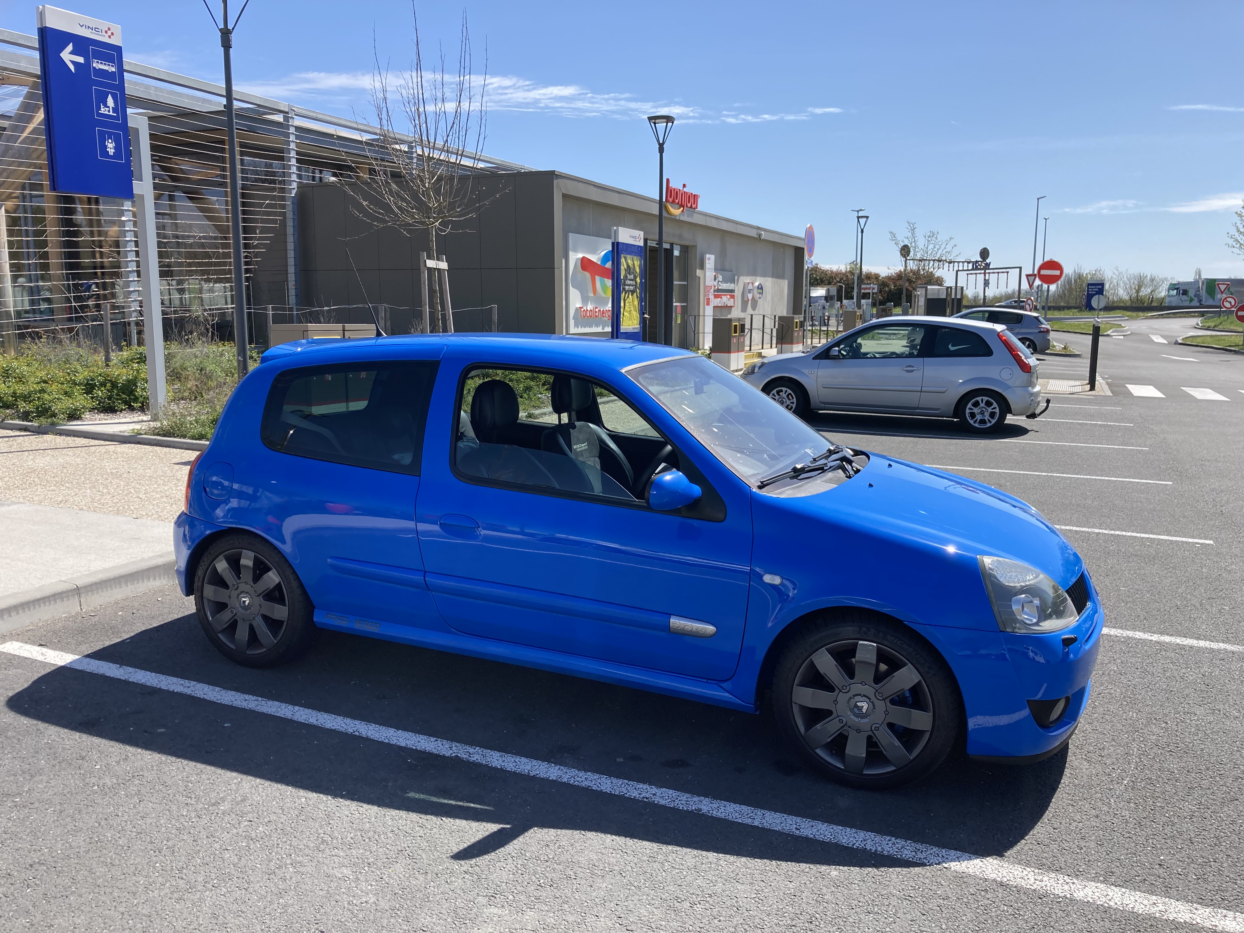

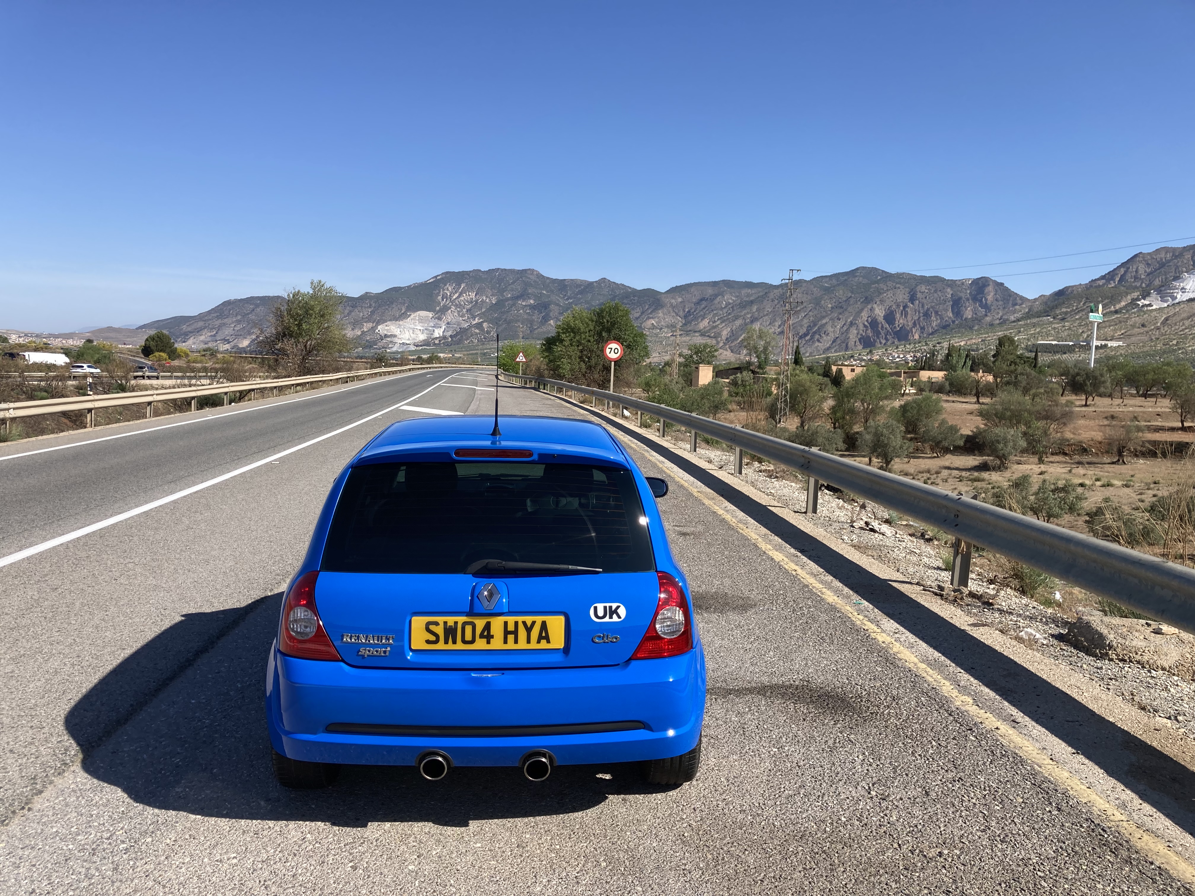

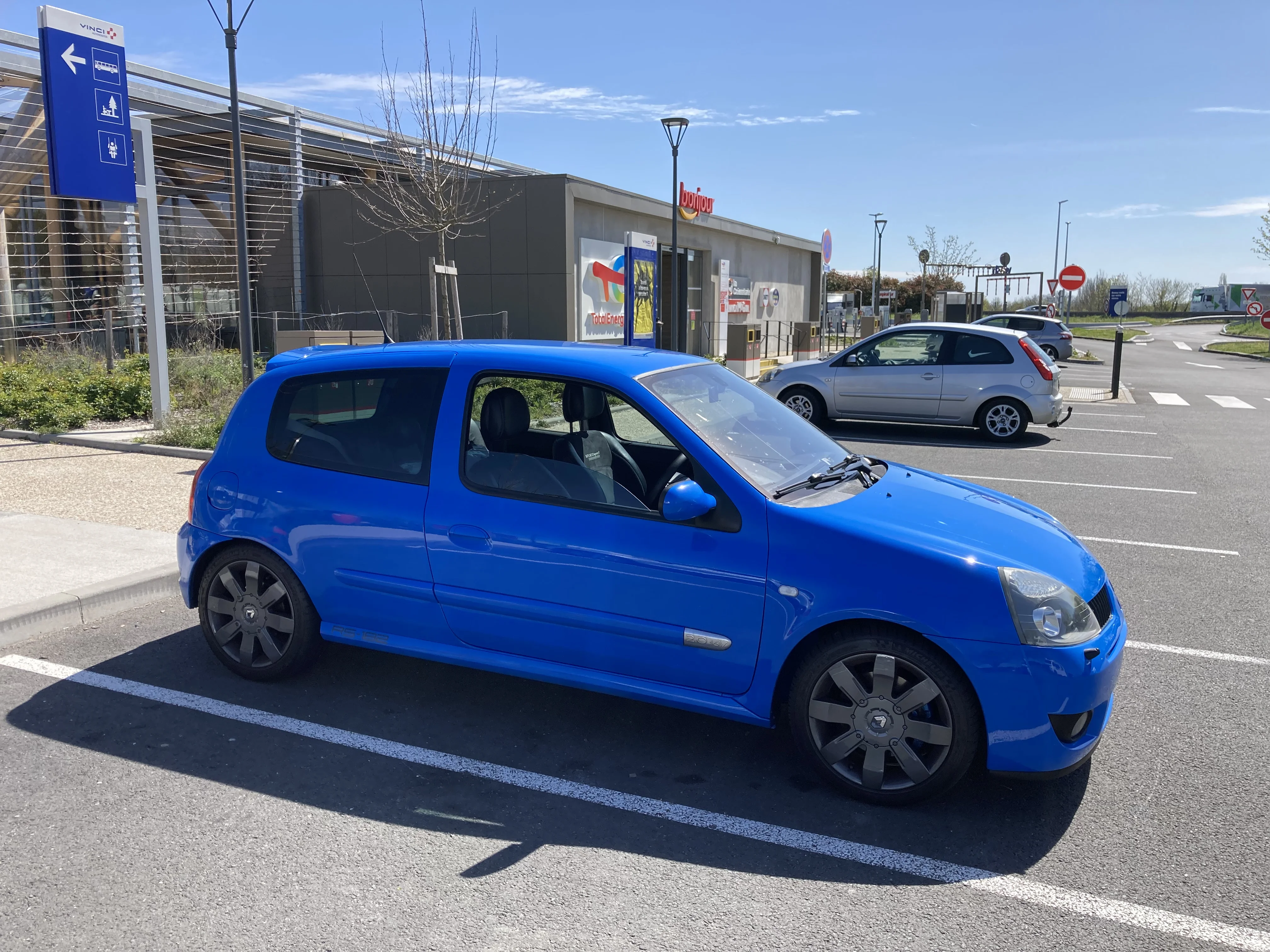

RB has been on a 3 day road trip down to southern Spain!
I split the journey into 3 500 mile chunks.
Day 1. Bournemouth to Dover, through the tunnel and stopping at Orleans south of Paris.
Day2. Orleans to Vitoria - Gasteiz northern Spain via the Pyrenees mountains.
Day 3. Vitoria - Gasteiz to Nerja southern Spain.
The car drove faultlessly throughout and averaged 39mpg at a steady 80 mph.
The french roads may not have the backdrop but the surface quality puts our network to shame.
Day 3. To be honest i was bloody Knackered. 1000 miles on my own, 500 to go in a Clio droning away and it was starting to get hot (30 deg).
The last leg spurred me on as the slight detour via the Sierra Nevada National Park near Granada was driving nirvana!
Mountain roads, views to die for and apart from a few crazy cyclists and bikers I had the road to myself.
Lots of quiet roads to explore this year and beyond. will keep you posted.

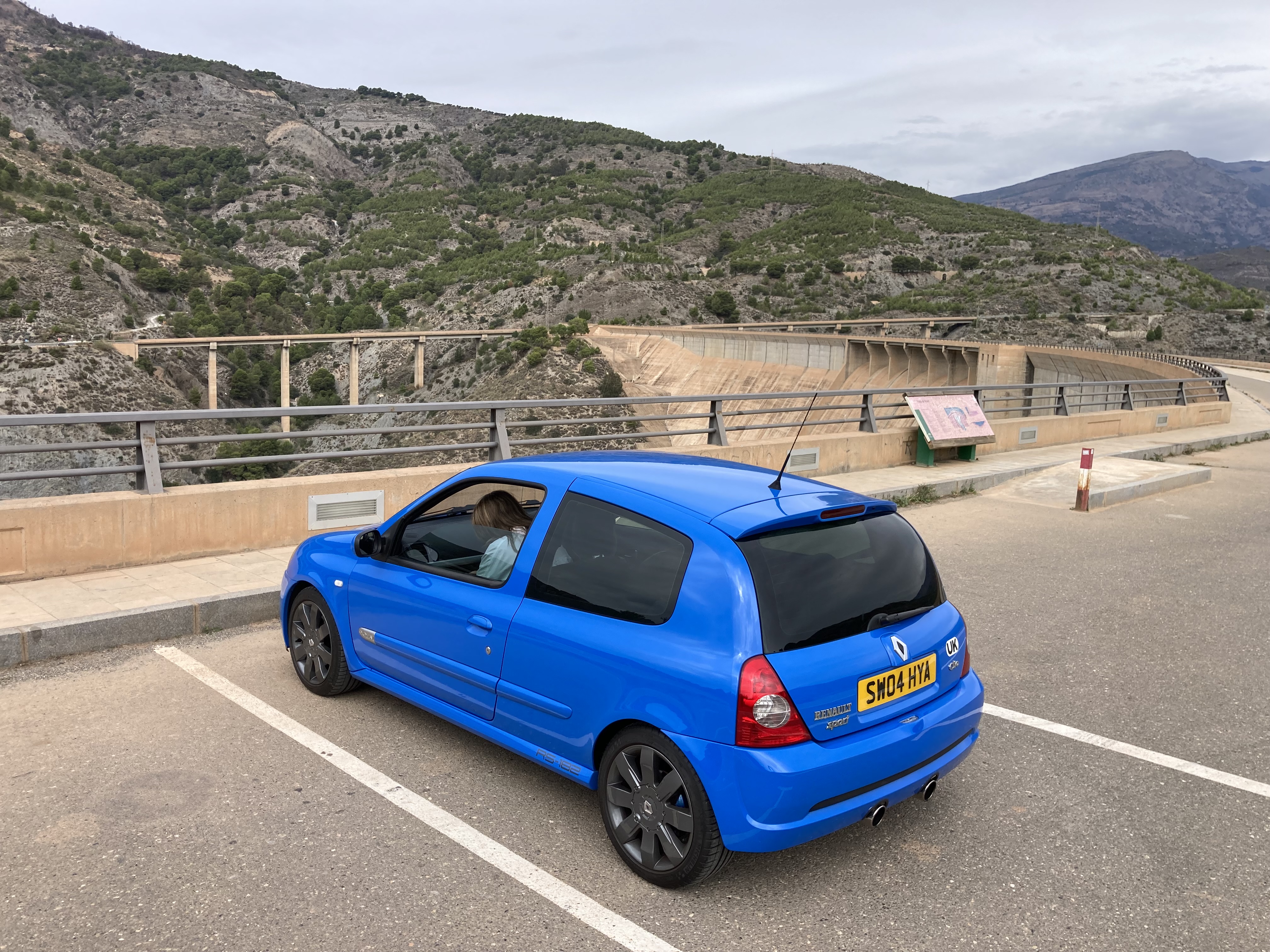

Got a bit lost on the way and stopped by this dam. Shocked the hell of out me when I looked over the railings! (zoom in on the Lorry below)!
1500m up the view was amazing.
