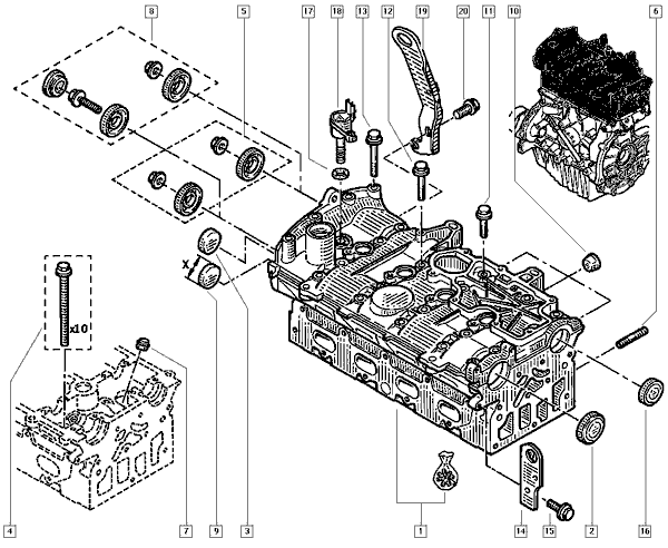

Can I get a part number for the cam seals pls so i can order them at renault?
thanks
  172 Cup & K20 Ph1
Apparently, part numbers #2 and #16 are:
2 - 7700106271
16 - 8200058022
But according to others, you need to buy kit #8:
7701471629
Can anyone confirm this?

number 2 and 16 i have in the Cambelt Kit.

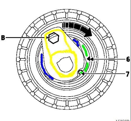

i am checking the kits and have a question about the cambelt tensioner.
I have a strange feeling smth is not right. On mine i can freely rotate the yellow part, while the blue+green stays still.
I think blue+yellow should stay together, othervise the whole tensioner will only move slightly due to the hole being off center slightly.
Maybe its ok and there will be some presure made when at place so it will tension the tensioner spring. Just asking.
  Cup In bits
If your playing with it loose I.e not attached to the engine it will do that. There is a tab at the back which needs to locate into the engine so it can operate correctly and be tensioned, check this when fitting and that its in the right hole.
  PB172,dci100,dci65
I know what you mean with the tab , its in the manual. Even if I grab the tab, the middle part where you insert the allen key and set tension rotates free. I try to make a video.

For information:
cam seals kit (7701471629) includes:
- dephaser blanking piece with seal (8200539622)
- dephaser bolt with hole in it (8200545704)
- exhaust pulley nut (8200793248)
- exhaust cam seal
- intake cam seal
