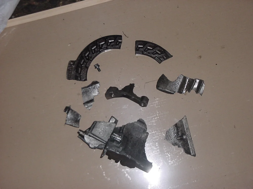

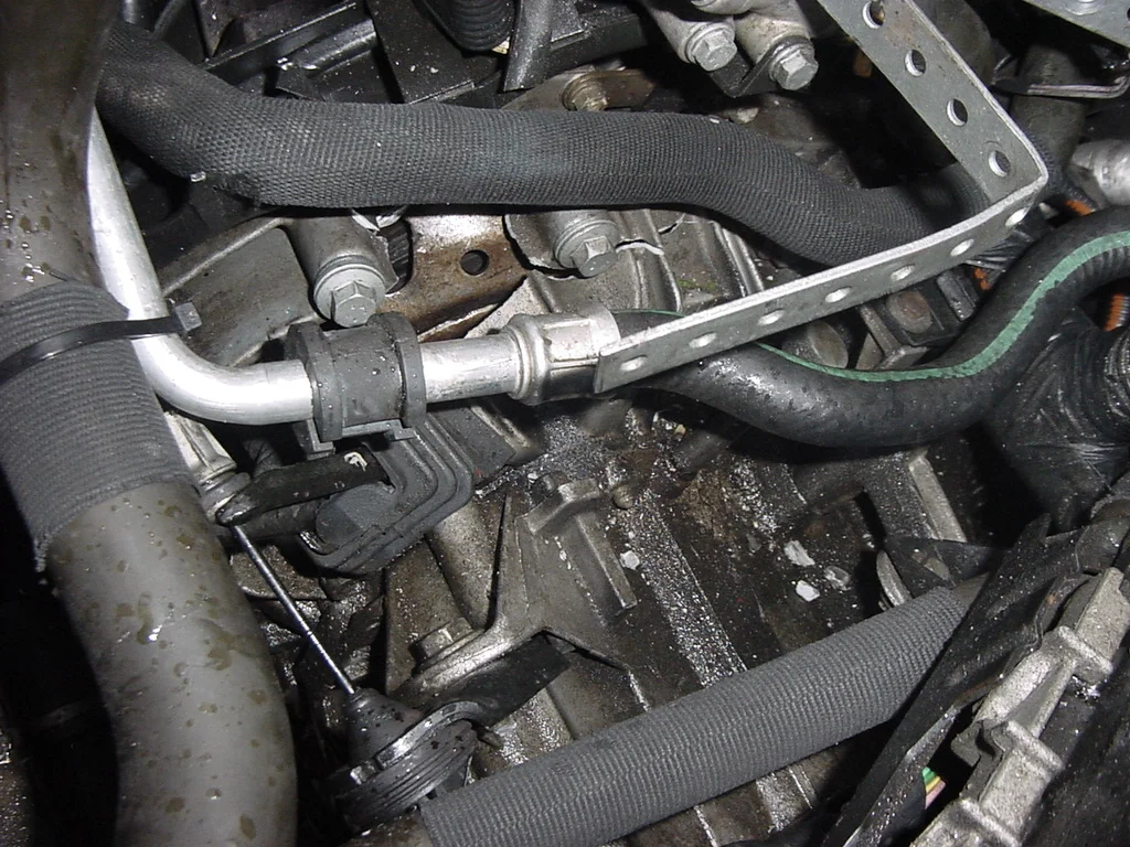

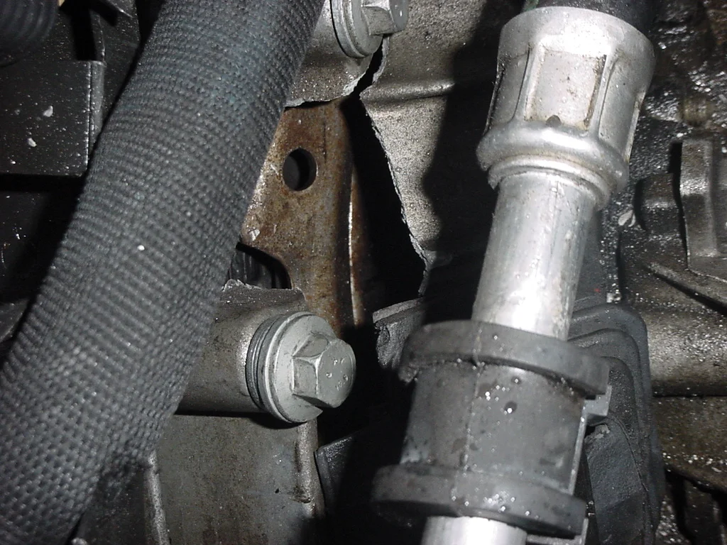

the pictures probably explain the rest.:(

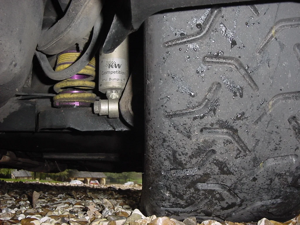

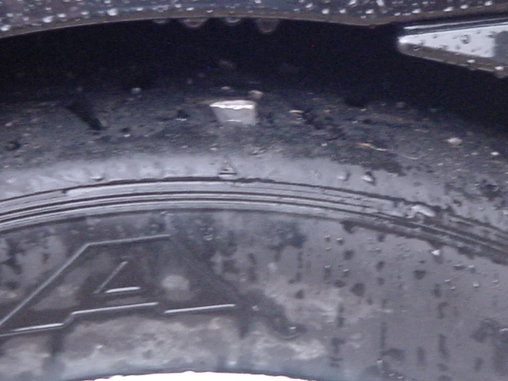

these are the bits we picked up from the track. and just to finish the day off in style, here is the one that punctured a brand new slick.:mad:

the damage turned out to be even worse than it first looked! one of the mounting lugs had snapped clean off the front of the block, fortunately the chunk that was missing ended up in the radiator and was able to be welded back on. one of the lugs behind the block had also cracked and needed reinforcing. all the flywheel bolts had sheared off and the tdc sensor was written off too.
finally after a lot of messing about. finding that my box was a 130, and the box shop i went to didn't have the correct case (nor did anyone i spoke to!), buying and returning a damaged box, and organising all the other parts i needed. it was all due to go back together on friday.
so obviously pleased to be about to get the car back i phoned in the afternoon, to be told "we are just putting the fluids in now, but neil (garner) is away and he will call you when it's all done". i waited for 30 minutes before getting a call saying "um... i've got some bad news. it's all back together but it won't start. i've just done a compression test and there is 0 compression!!"
basically i've now found out that when the clutch locked, the timing belt jumped 2 teeth! and will have almost definately bent a lot of valves!

Flipping heck, I've never seen a bell housing shatter like that. Renault boxes really aren't the best lol!!
ive only really ever heard of anything quite that catastrophic happen with lightened flywheels!
