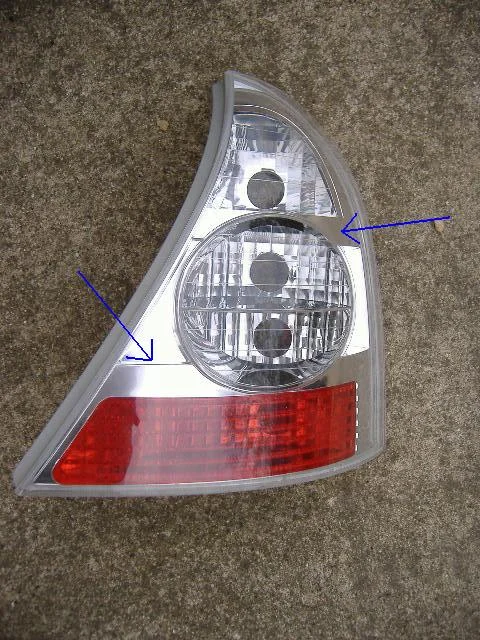

What I was thinking about doing with the spray paint, was to colourcode the areas pointed at with the blue arrows...
If you look, the light bulbs are set back in recesses, and thought I might just paint the areas that don't cover the bulbs and the recess (clear as mud again, eh? lol)
What do you reckon?
Been thinking about this and wondering if I do spray the areas highlighted above, will it end up looking like I've got those crappy light masks on?
lol, you should have said mate! Otherwise I could have ended up with them looking like a bag of sh*te!
Might tint the whole unit then I reckon. Do they do different shades of tinting spray or is it just a case of applying layers until you reach a suitable colour?
