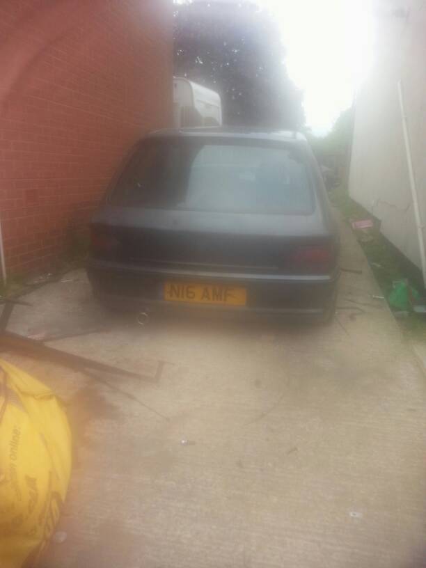

Anyhow, since then my girlfriend bought me this for my birthday :D

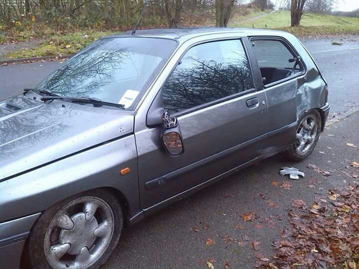

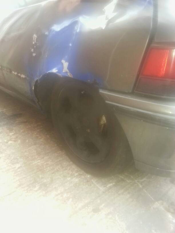

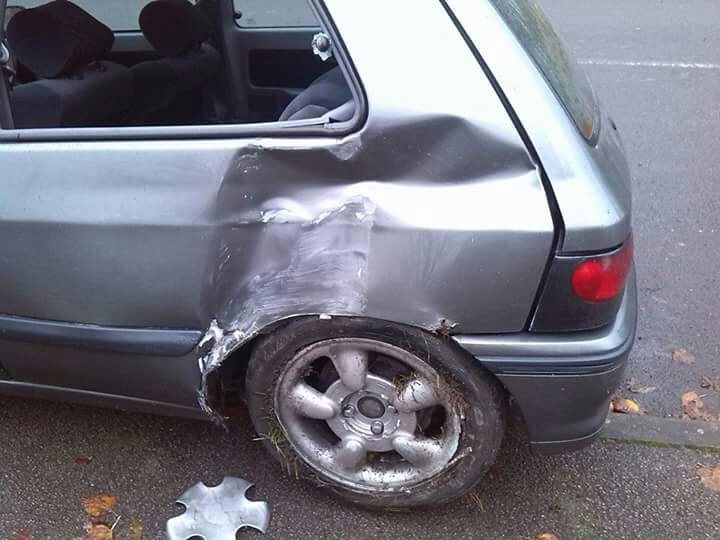

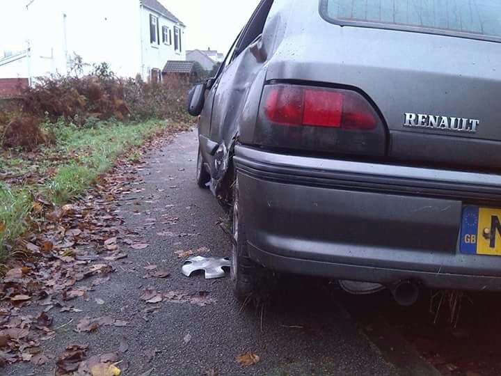

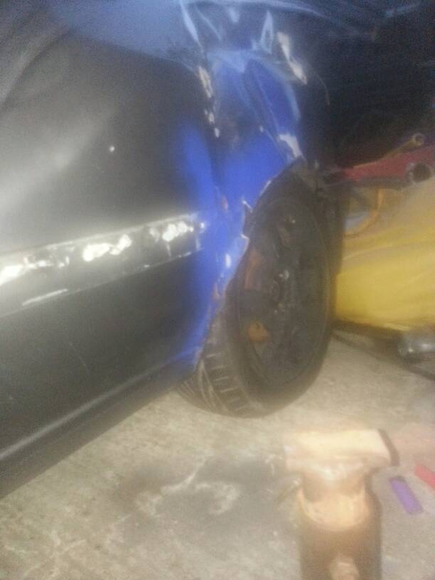

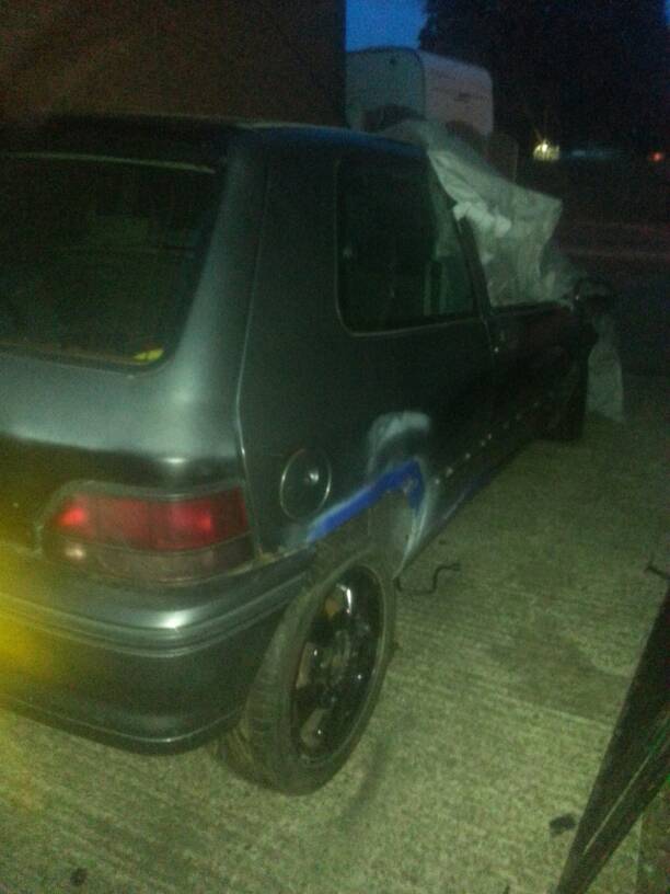

She's in a bit of a state at the moment after the lad I bought it from lost the back end in the rain, span a few times and took a signpost out the ground
Results are;
Fooked O/S front shocker

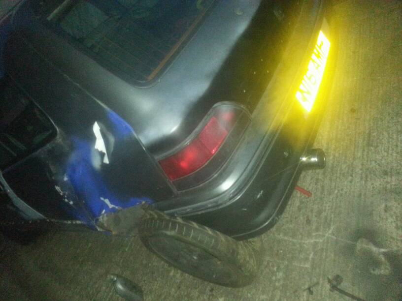

Smashed N/S rear quarter window
Badly dented rear quarter :cry:
Fooked tyres and a bent rear stub/hub.
I know for sure the chassis are still straight and the rear beam is too surprisingly, haven't had a proper look yet as haven't got all necessary tools.

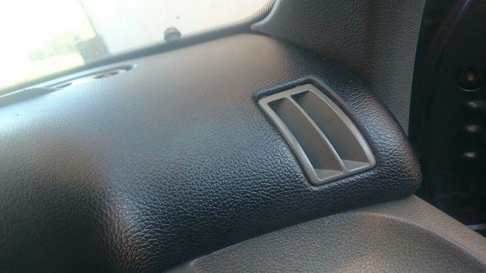

Looks like new! I've also done the whole dash in the same colour and done the top dash satin black, I've even painted the torx screws as they were chipped and messy.

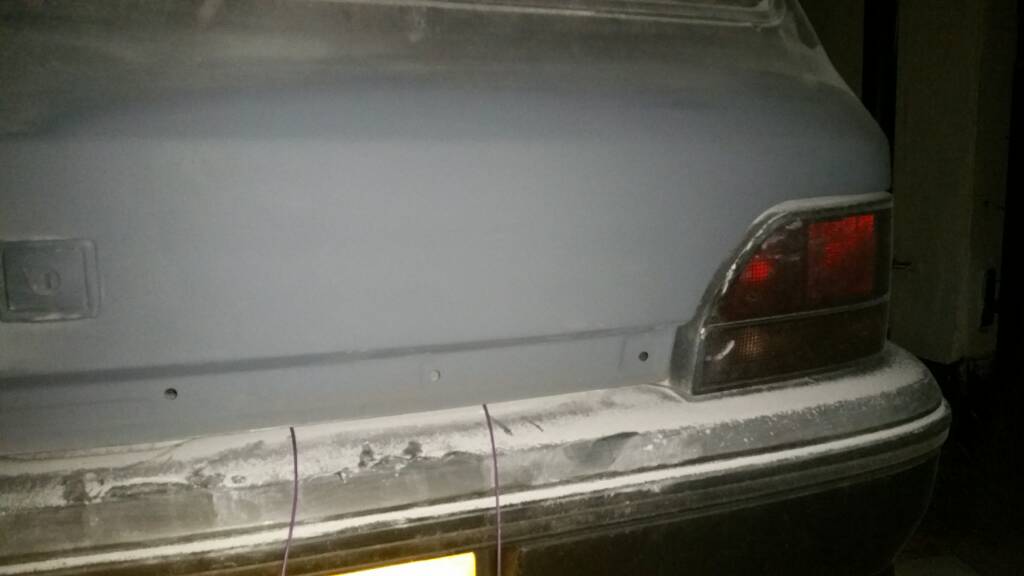

I put a new rear quarter glass on it also.

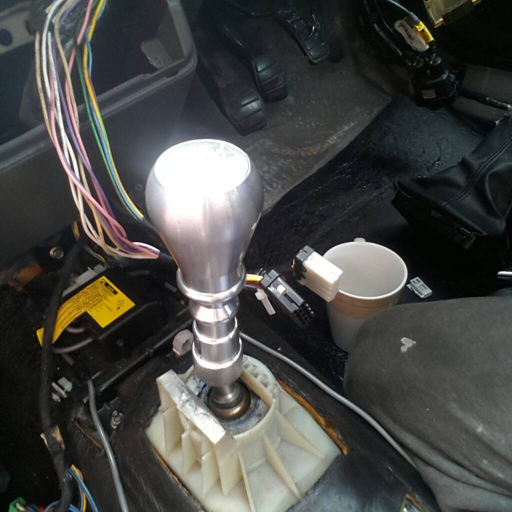

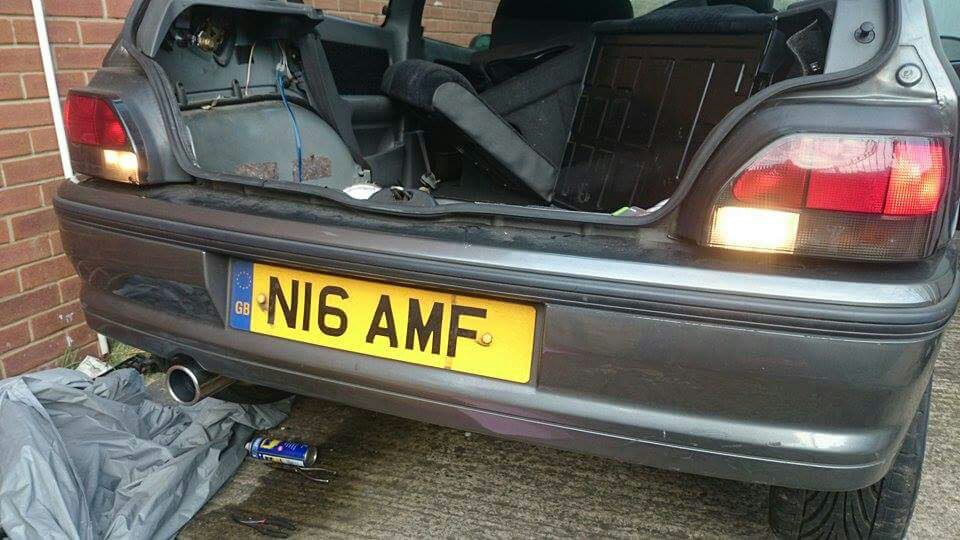

Most recent things I've done are put a magnex on [emoji14]
reverse lights [emoji38] sounds great with the decat, and set about removing the old dash and loom for tomorrow as it got dark. That about brings it up to date but I will update as and when. Sorry for the lack of photos, my phones broke so have to borrow the Mrs phone...

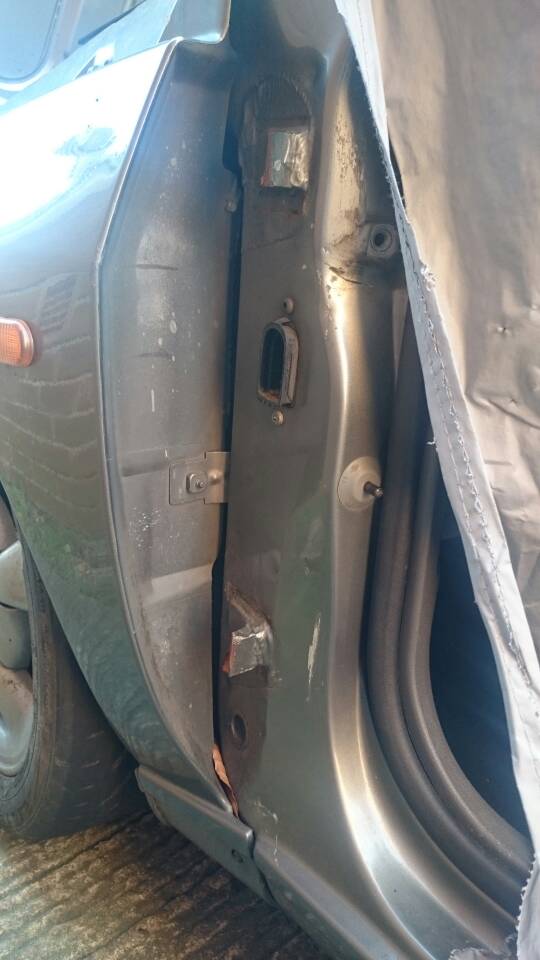

Door hinge posts needs welding as some tosser couldn't be arsed to undo the 2 torx pins holding the door on so they cut it off!

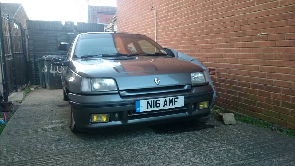

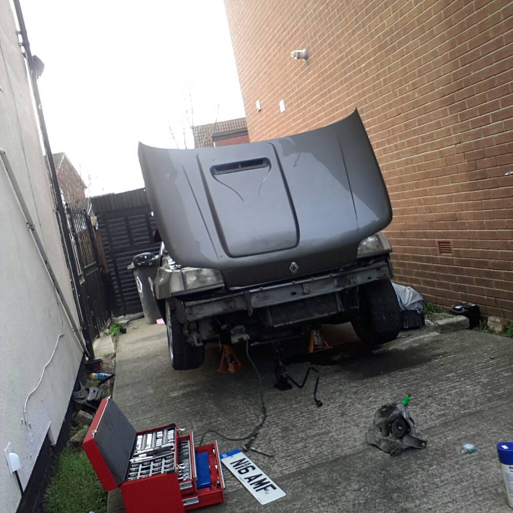

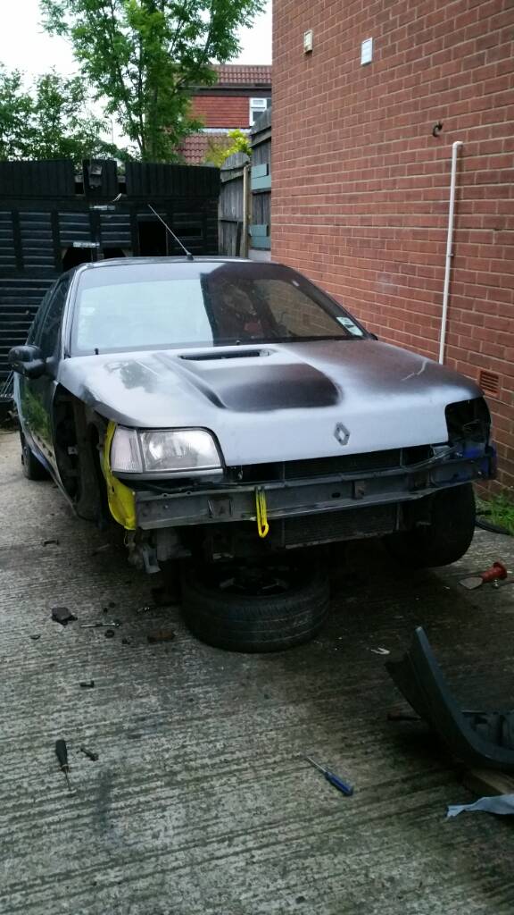

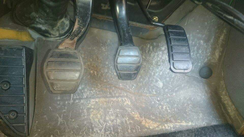

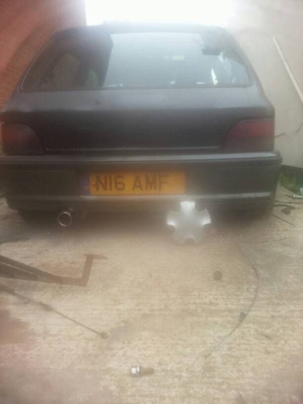

Yesterday I left the car looking like this

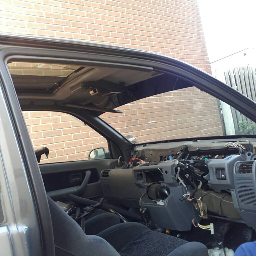

So today I went out with the intention so fully strip the inside and refit the new dash and loom etc, roughly 20 mins later she was looking like this
Also dropped off the jack lol. Luckily it hasn't caused any damage.
I was surprised to see no rot! Only surface rust from what I can see.

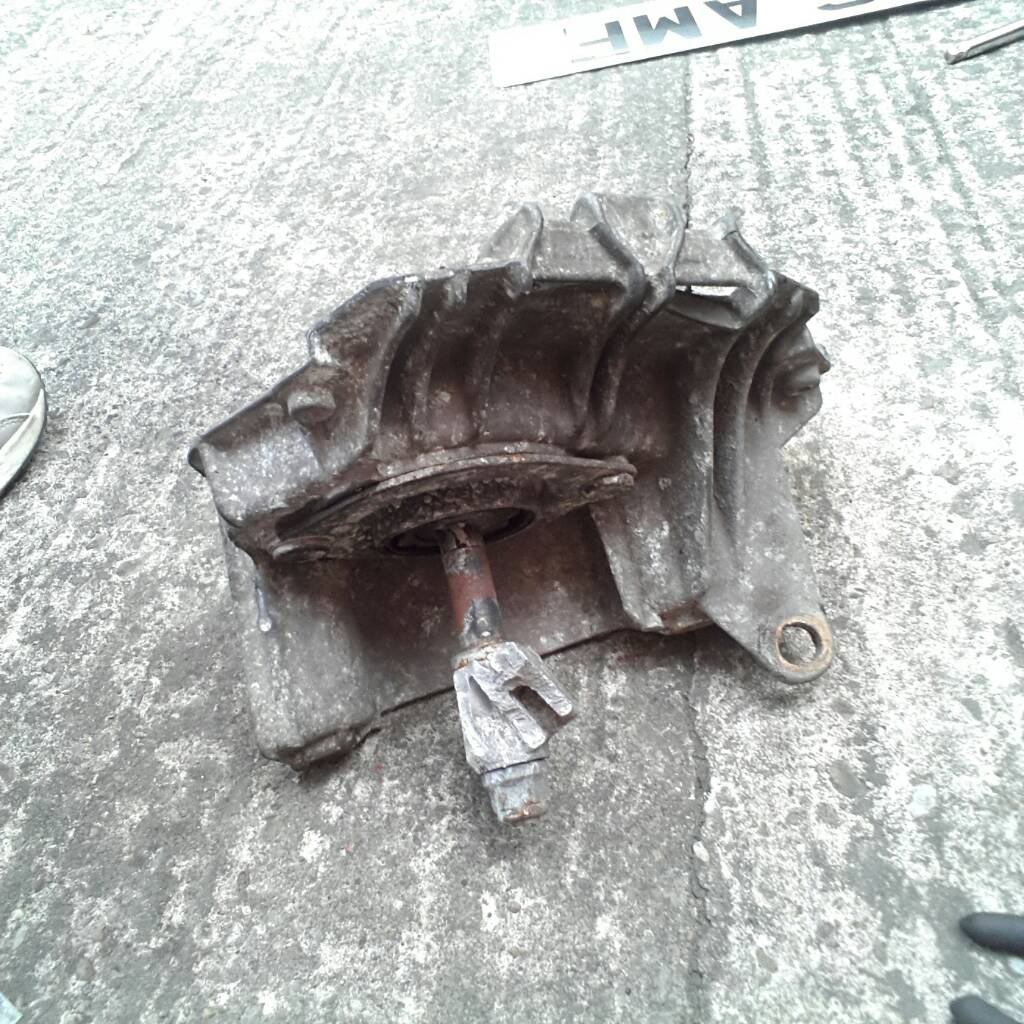

So yeah, not much really happened today except for the gearbox mount has been changed as, I'll let the pics tell lol

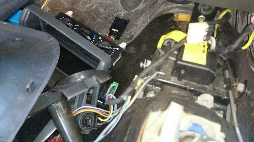

I've removed the loom (just need to pull it through the car now) also struggled with that as somebody had managed to squeeze some of it through the wholes in the chassis rails :/
Discovered why the power steering shat itself, when the gearbox mount snapped it allowed the gearbox to drop on the pas pipe, not sure as to why it ran under the gearbox...

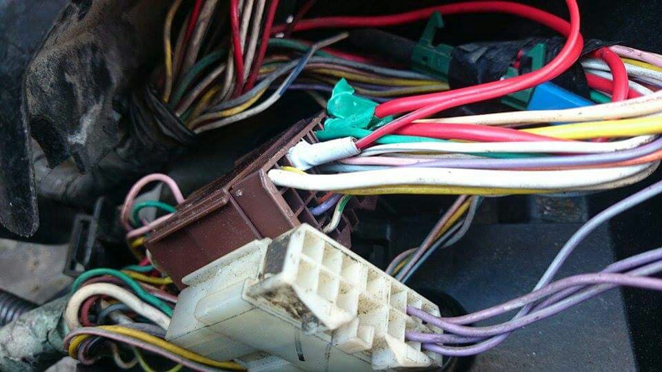

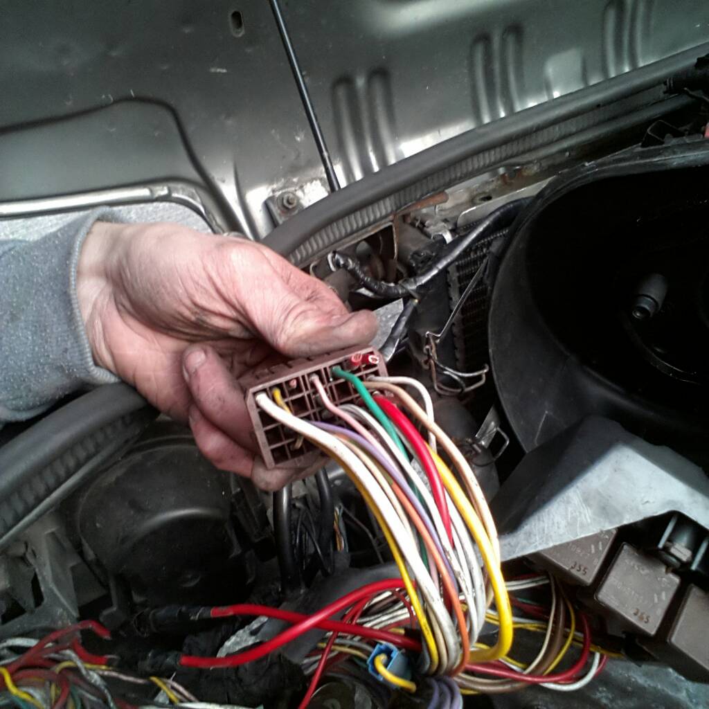

Here's the reason I'm changing the loom
cut wires and there's more within. I honestly don't know why people do this, it appears that whoever did it cut the wires and taped them back together! Just twisted and taped, that explains the intermittent issues with starting etc.

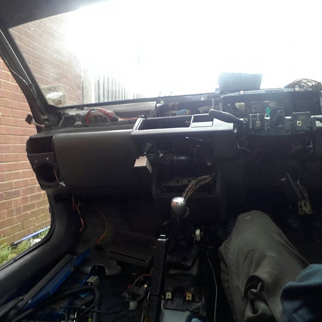

Today's update.
Sadly not got any photos but will get some tomorrow,

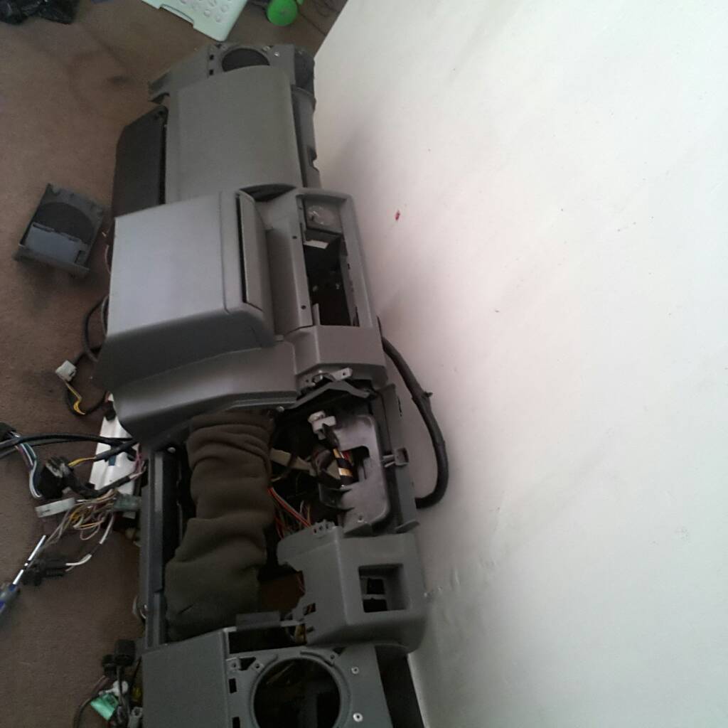

The dash is finally out! As is the carpet, underlay etc, they were soaking so they're hung over the fence to dry lol. Also come across yet another poor bodged sill repair, not sure how they're still in bussiness, you'll be able to tell more when I get pics tomorrow but basically they've cut part of the old sill off, put the new one on top, tack weld it it about 5 times then put loads of filler on, no rust prevention or anything so it's just rusted back through, luckily it's not too bad and hopefully I've caught it early enough as from what I can see the very bottom (about half inch upwards) is rusting on the inner sill. I've also took the seats out (obviously I had to lol) to give them a good clean along with the carpet. Leather interior will be going in soon though. Tomorrow I'm going to fit the b&m shifter, the cat back magnex (already put the back box on)

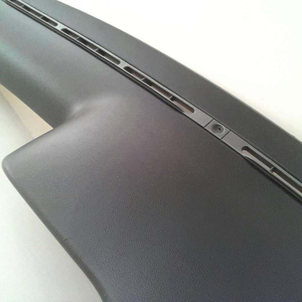

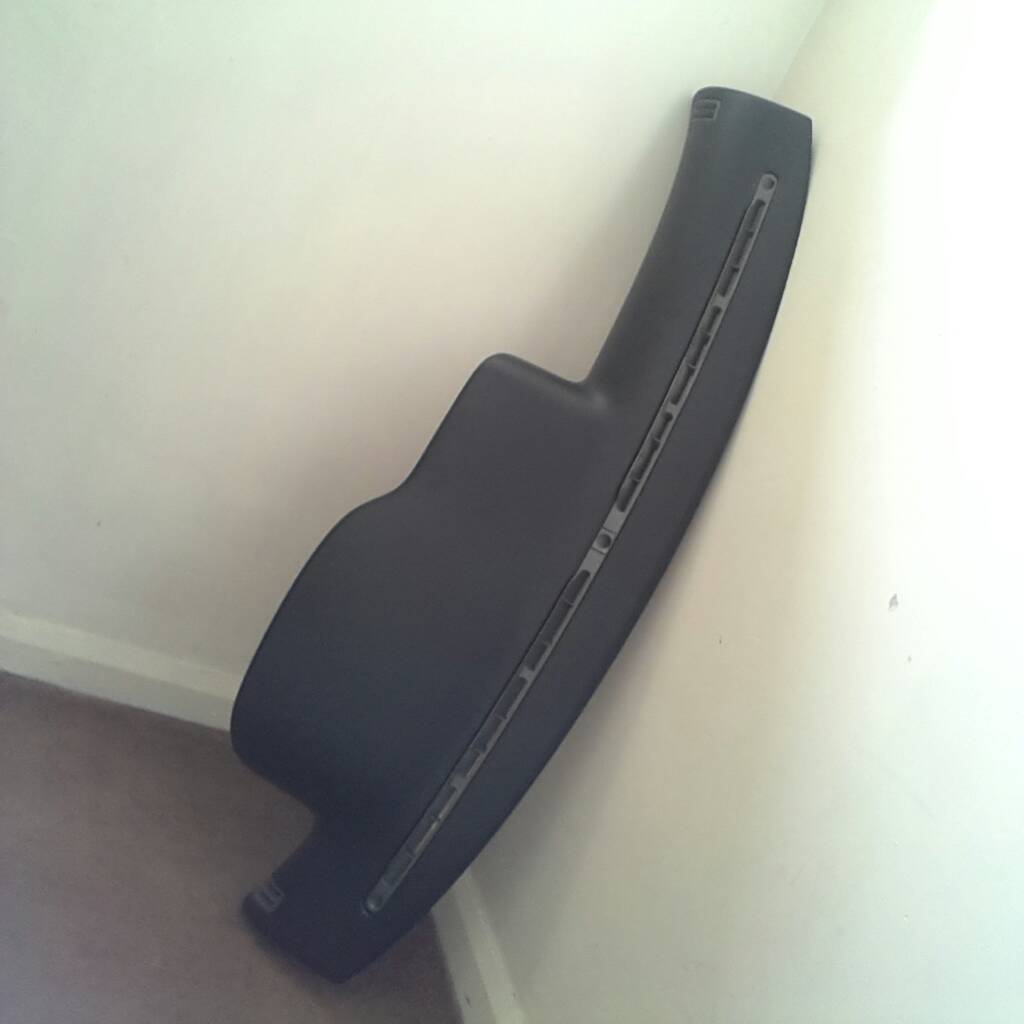

Here's a few pics of the dash that will be going in when the inside has been stripped back to bare metal and repainted (sorry for crap pics)
Needs another coat of paint yet but it's looking better, also need to redo the slat type things in the top dash as the paint has shrunk as I forgot to clean em lol.

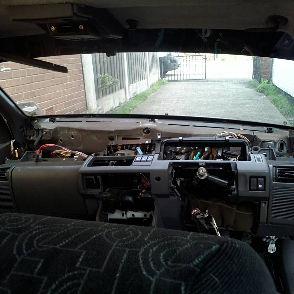

The past few days the car has been fully stripped (dash, carpet and underlay etc) I have installed the new dash along with the inside loom. She's looking like thus
Also fitted the b&m
sorry for poor photos. I have to use the front camera on my phone, technology eh lol.

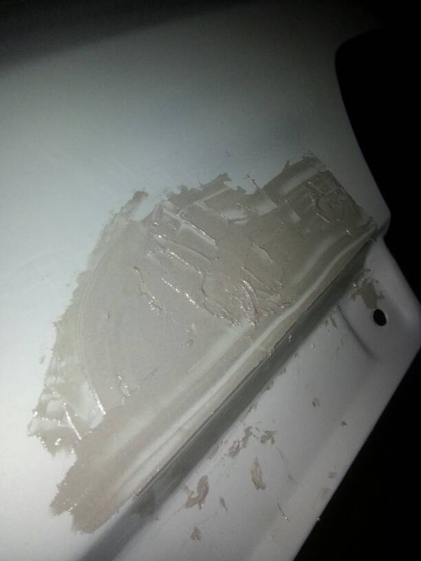

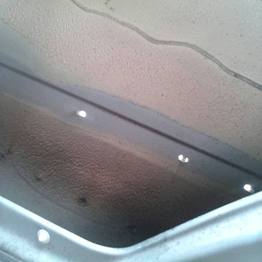

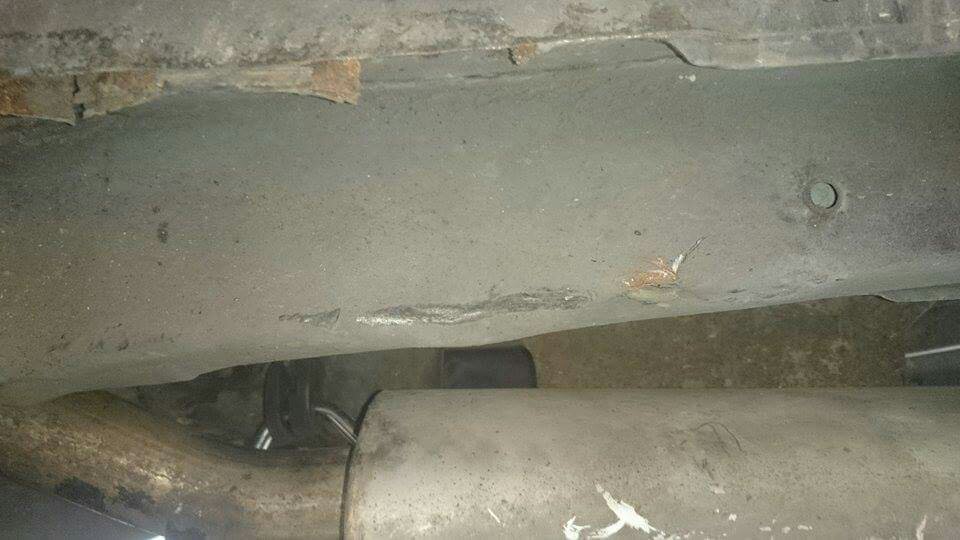

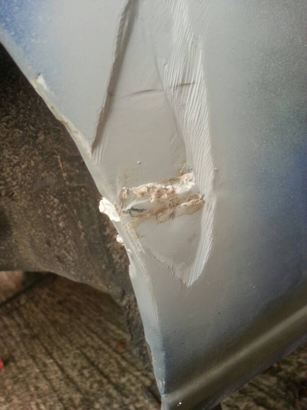

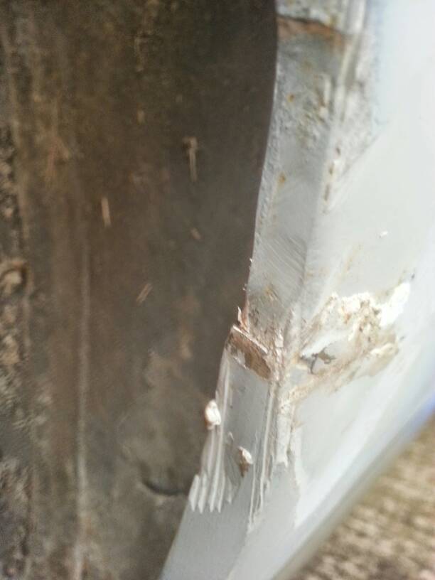

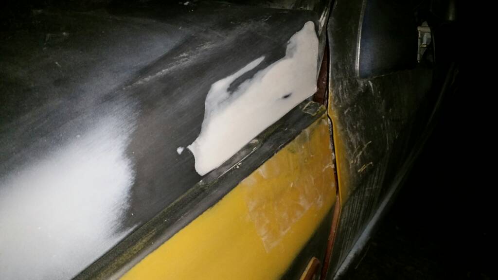

Here's a pic of the bodged sill repair
you can see 5 black dots, they are spot welds, the rest is just filler. You can feel along the bottom of the quarter where it's cracking. Bodging gits. The front end is also stripped (bonnet, wings and bumper) and I've sorted the butchered engine loom. Will upload pictures later on.

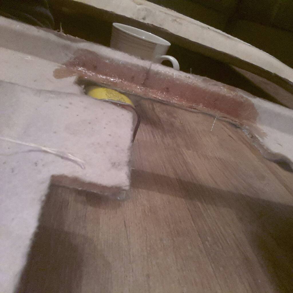

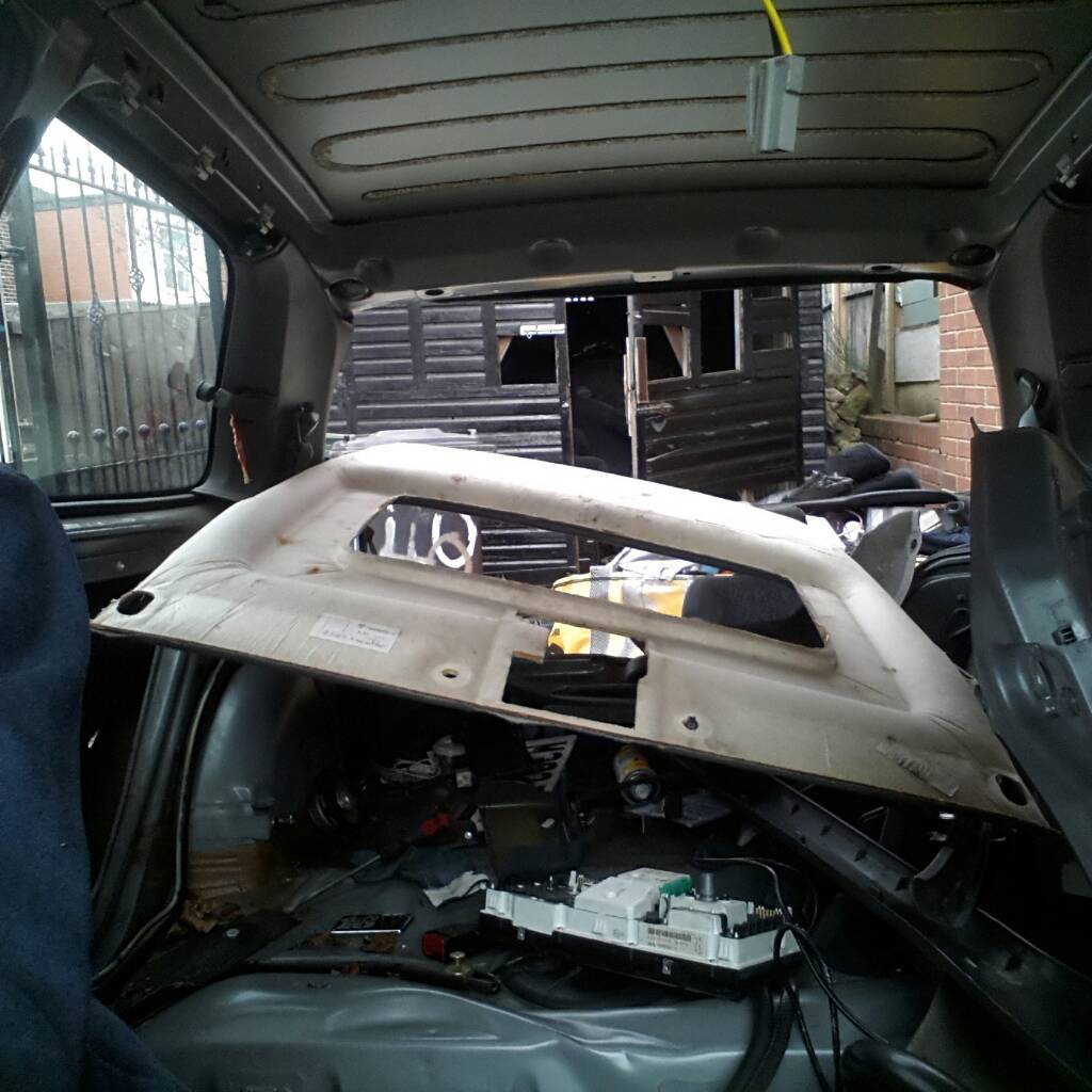

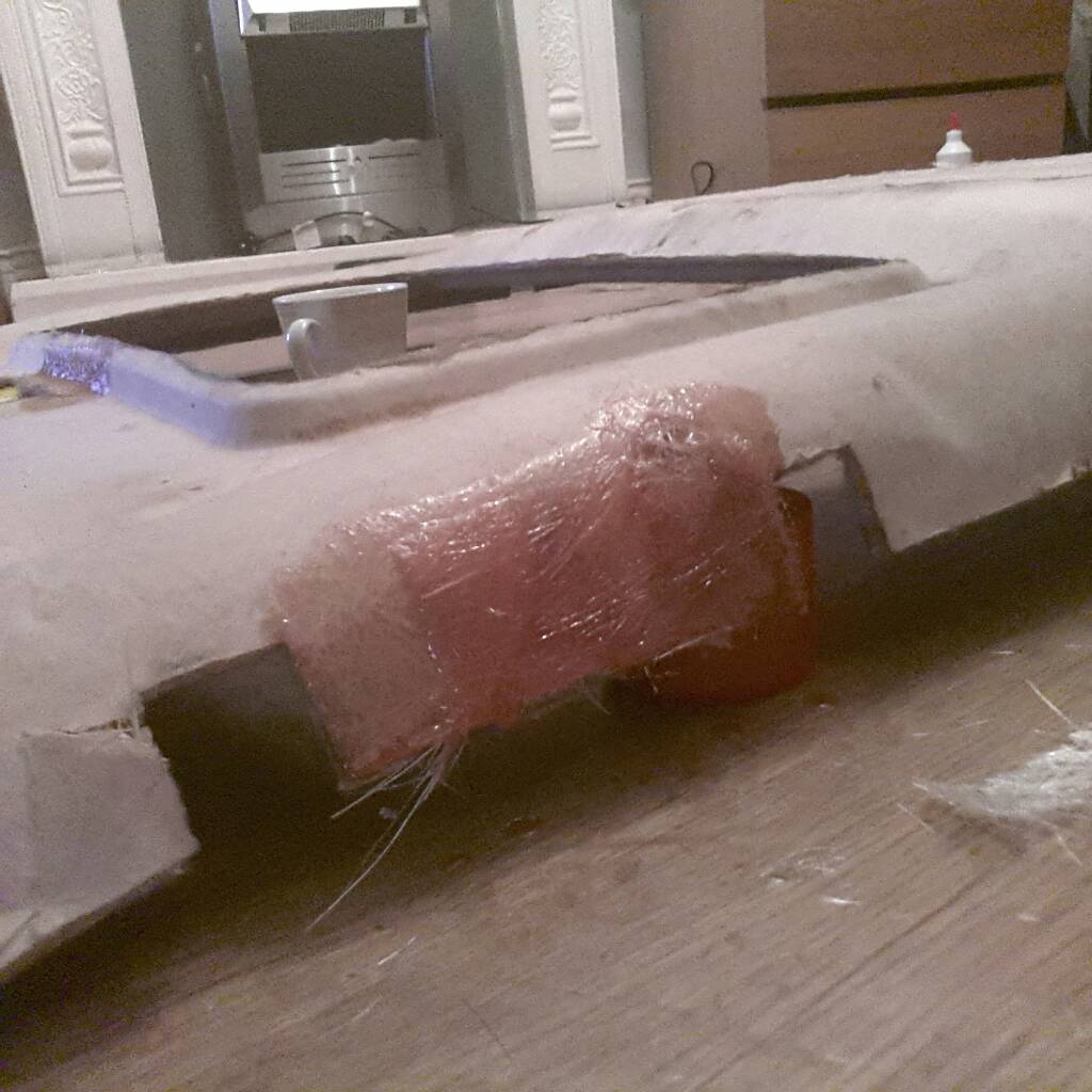

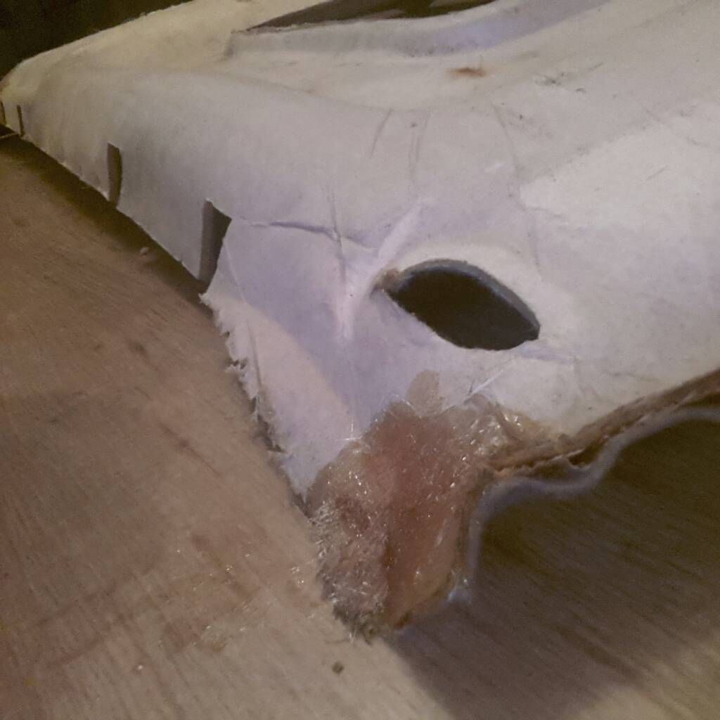

The roof lining was a bit tatty, fag burns and mucky patches and a few cracked areas so brought it in to fibreglass it, also it will add strength to it.

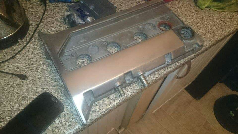

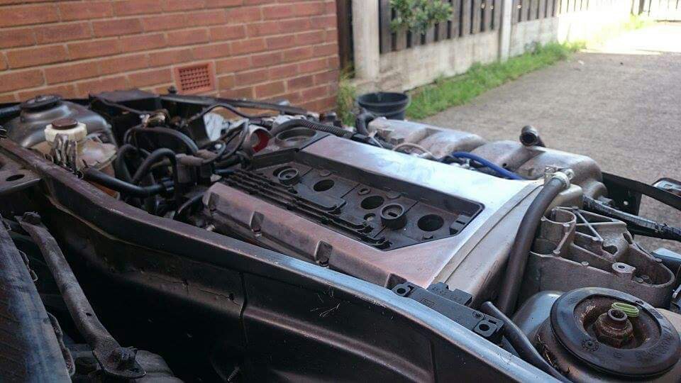

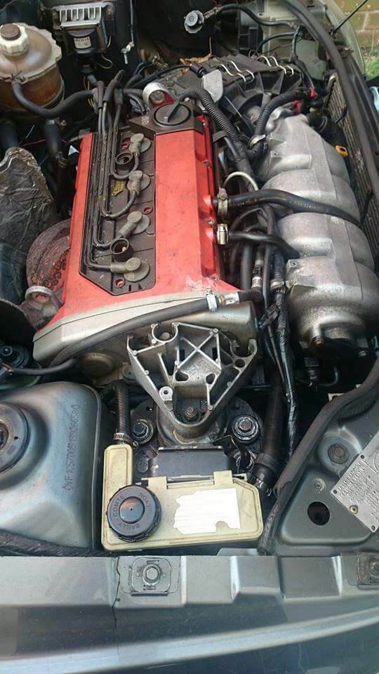

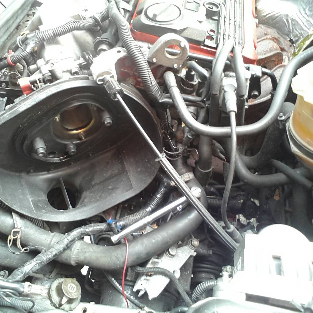

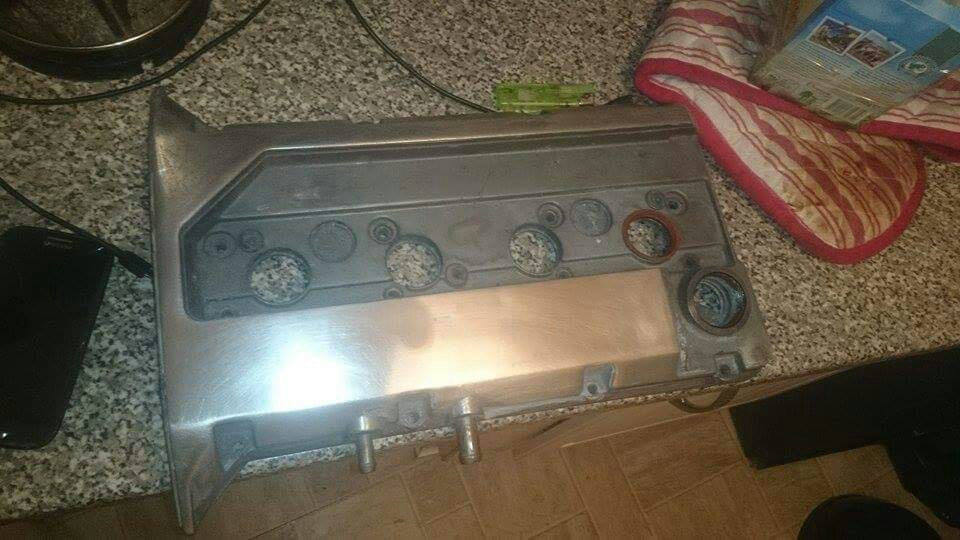

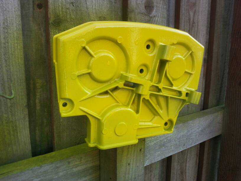

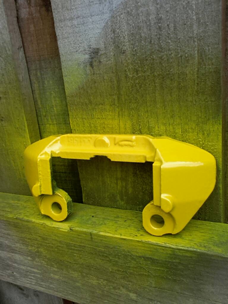

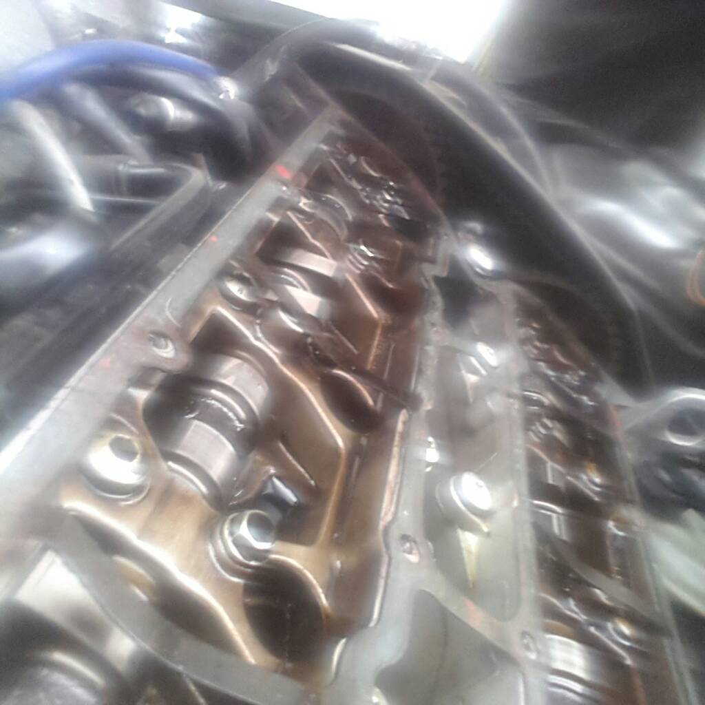

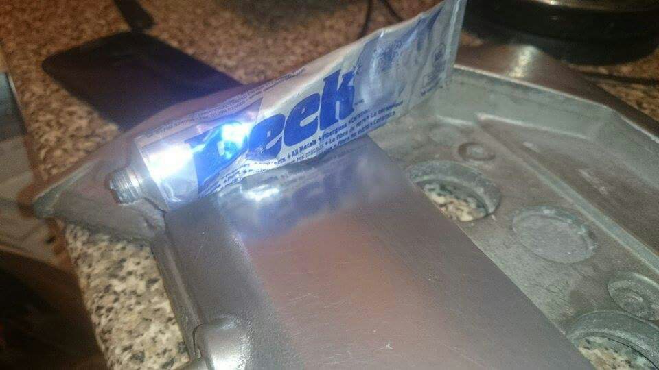

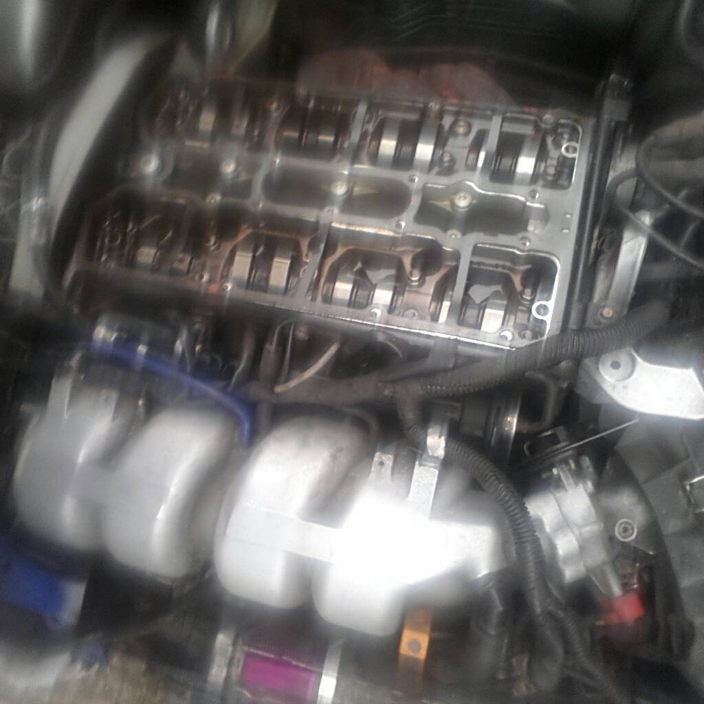

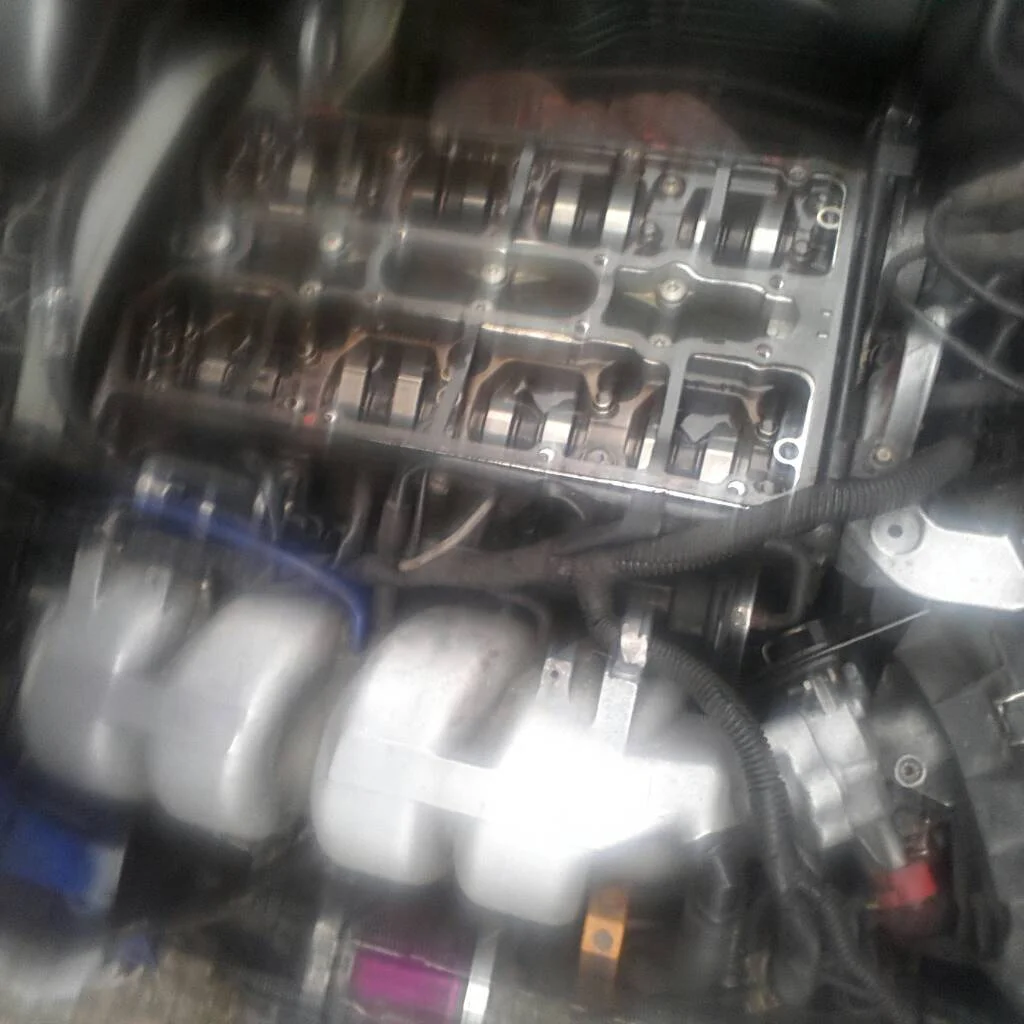

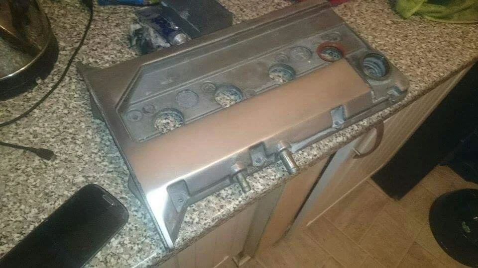

Bit of an update here too. Not much though I'm afraid. Engine had been painted in various places without the parts even been removed, looked like this
.Took the rocker cover off and brought it in to polish, it's looking pretty good at the minute and I'm still in the first stage
. Going to finish it off possibly tomorrow and do my other plenum to match, oh and the throttle body too if I can be arsed lol.

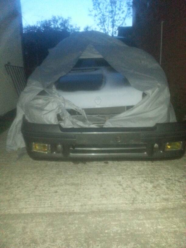

Update time.
Yesterday I met coops as he delivered my longtime purchased phase 1 goodies lol. He's a genuinely nice chap :) big thumbs up to him for the stuff and taking me for a blast in the track car...
Anyhow, here's the phase 1 bits fitted
Close up pic of the dash after new paint

Few pics of the looms, no more cuts! Yay.
the tape is temporary until I get the new pins for inside..
Everything is working now more or less, just the inductors aren't and the reverse lights are still stuck on. Think that's down to the switch tbh as I've checked all the earth's and everything else seems fine too.

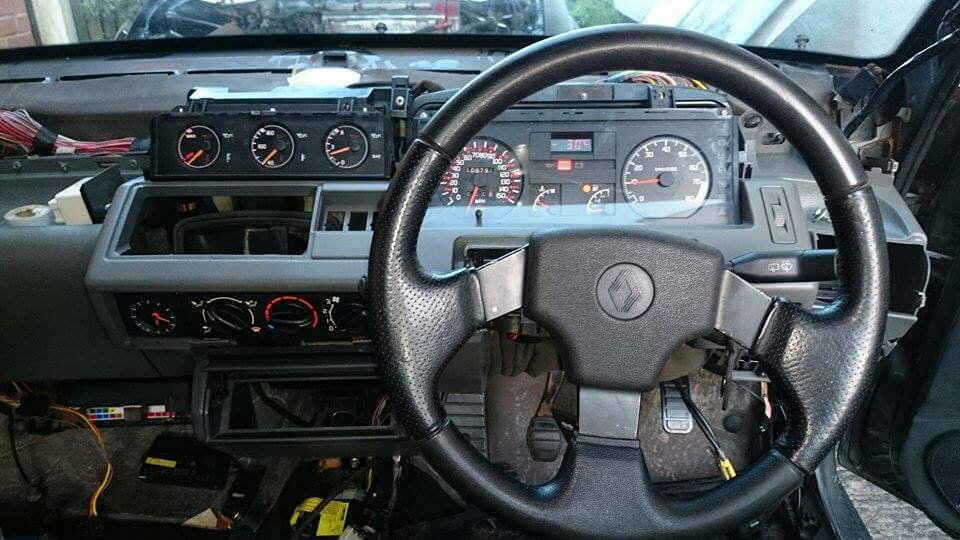

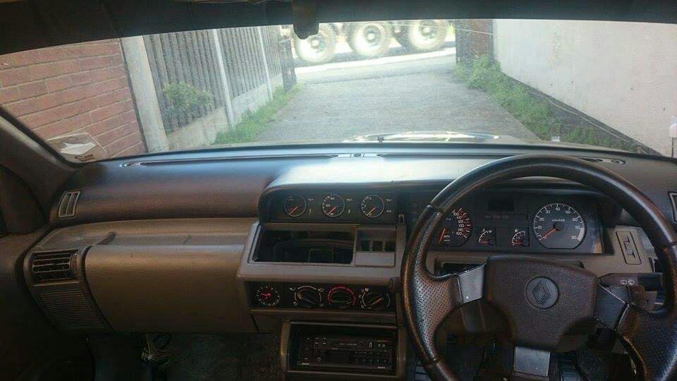

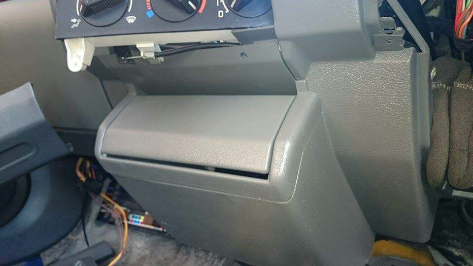

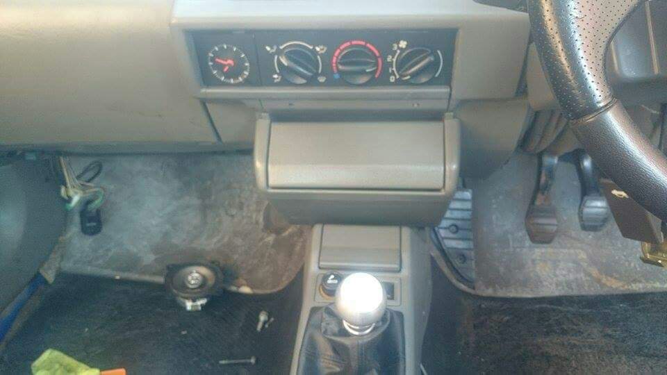

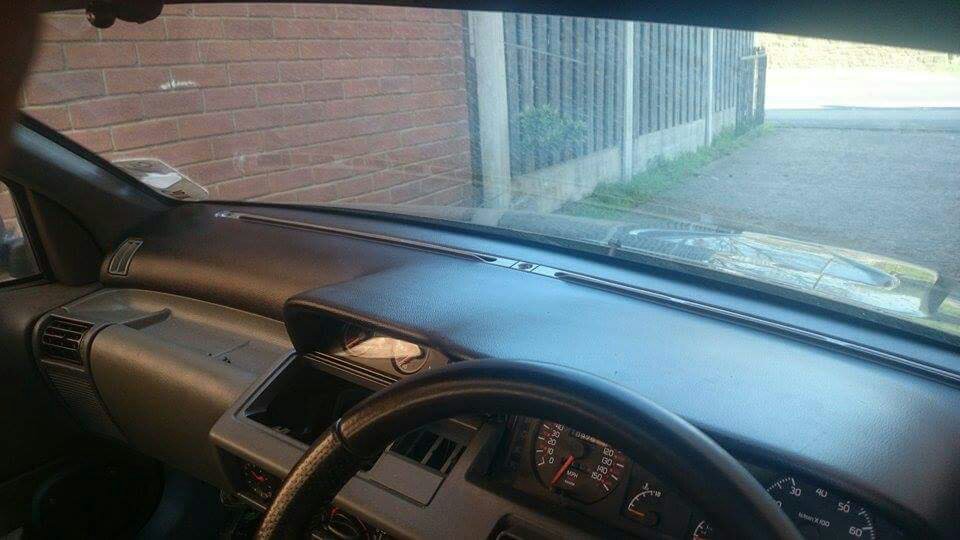

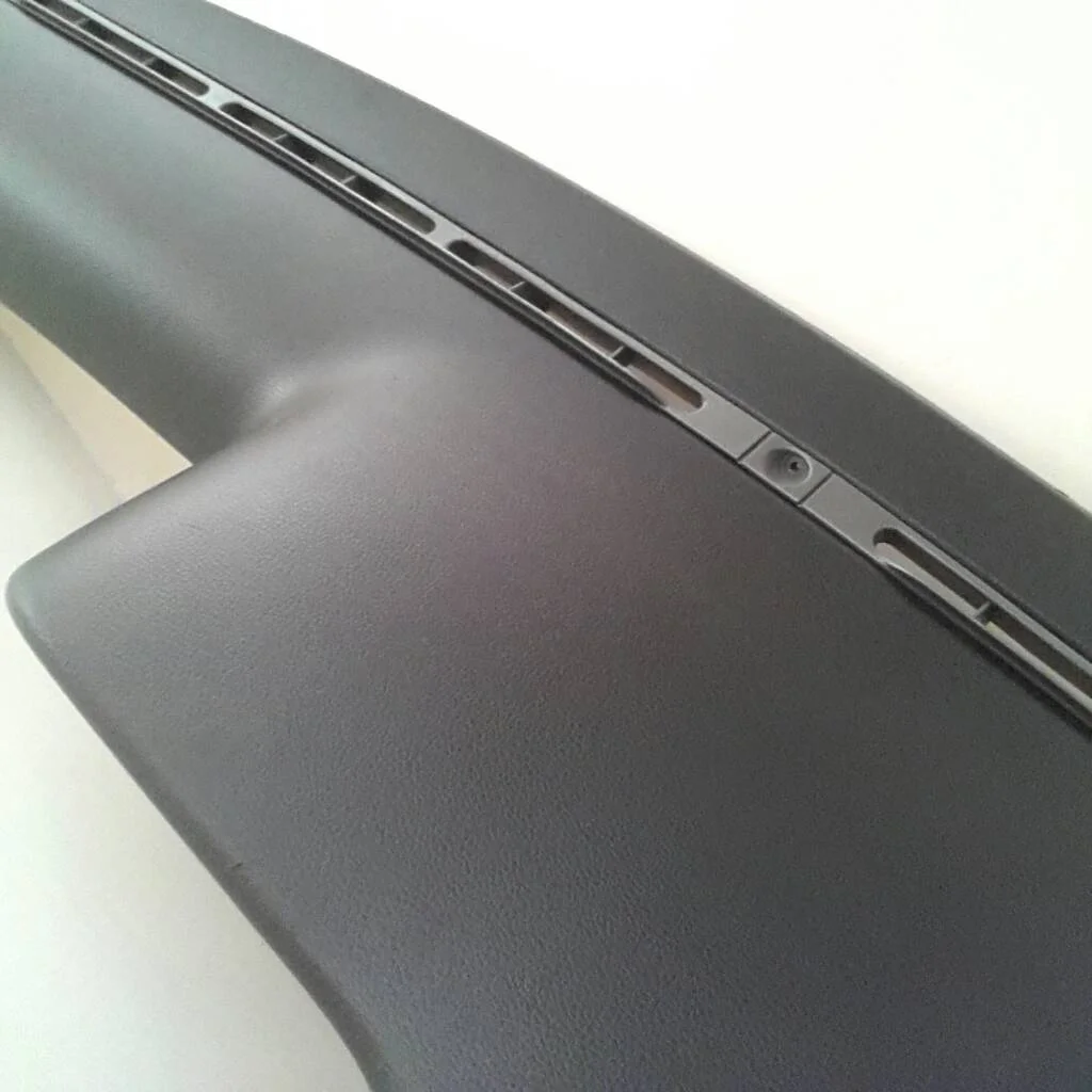

Bit of progress! Got the new dash installed.
Not one to blow my own trumpet but I think it looks mintosa :winkey:

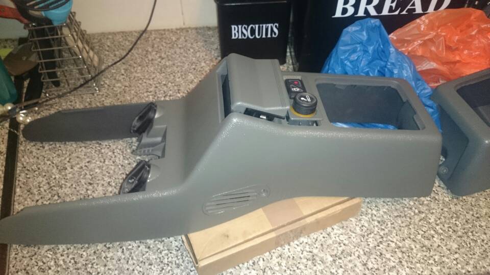

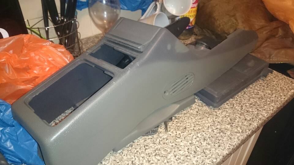

Here's the centre console

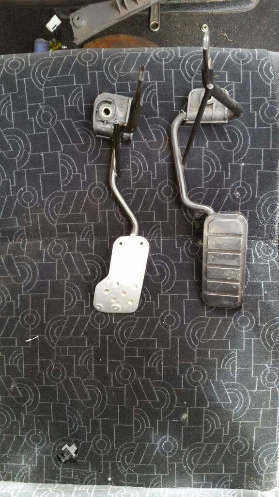

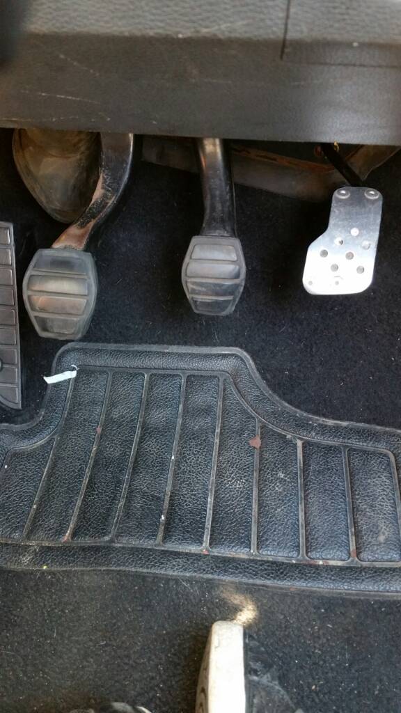

Even put some new pedal covers on. Genuine renault ones too that I bought a couple of year ago
it's all in the details lol.

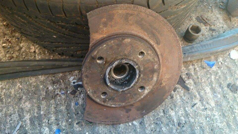

brake disc held up pretty well ;-)

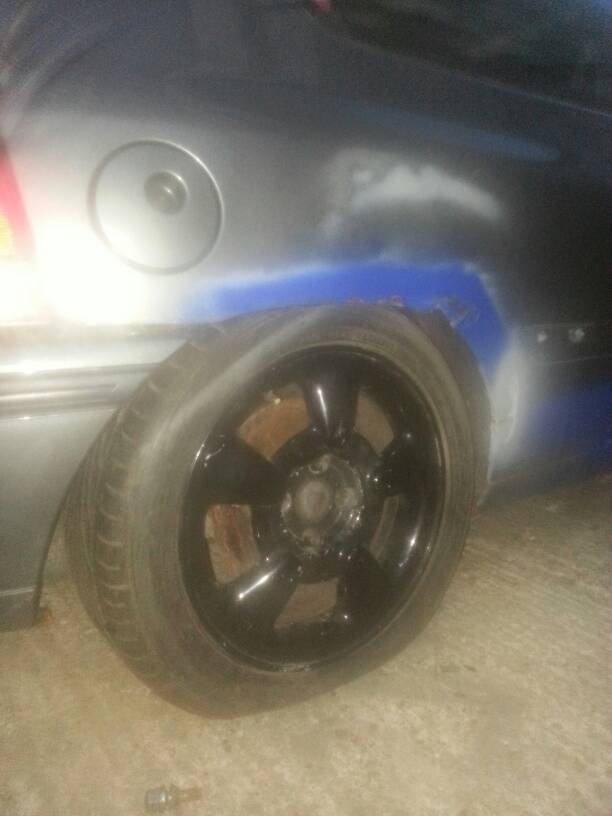

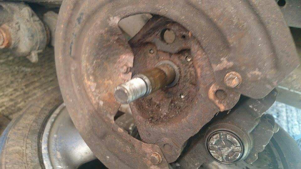

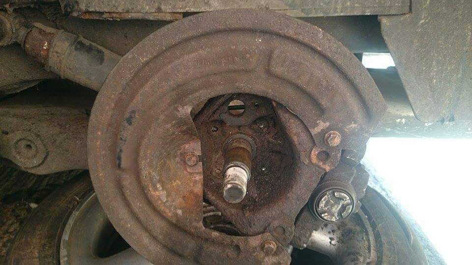

Here's the result of the crash damage, bent stub axle which I pinpointed it to be
Think it's time for 17poo stub axle mod ;-)

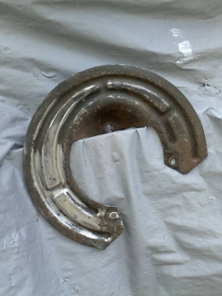

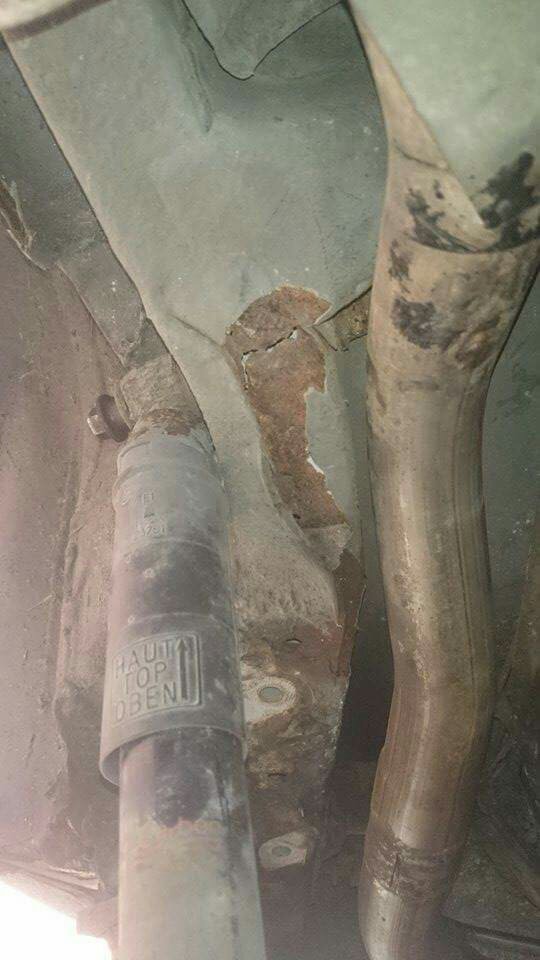

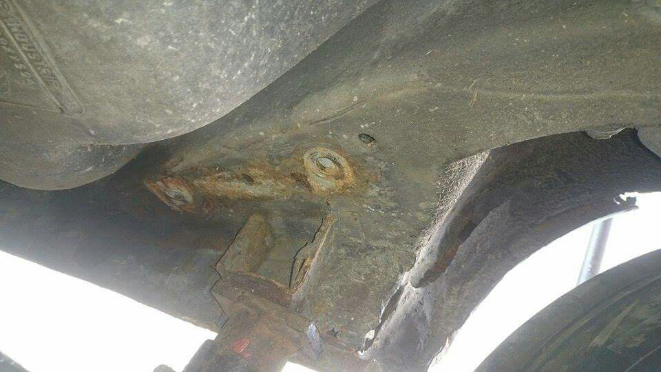

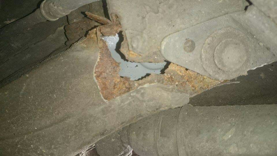

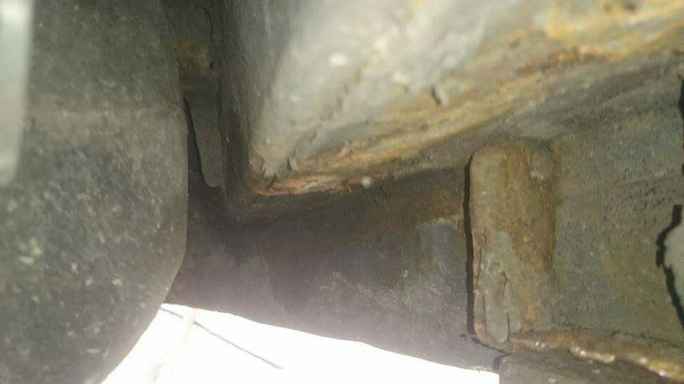

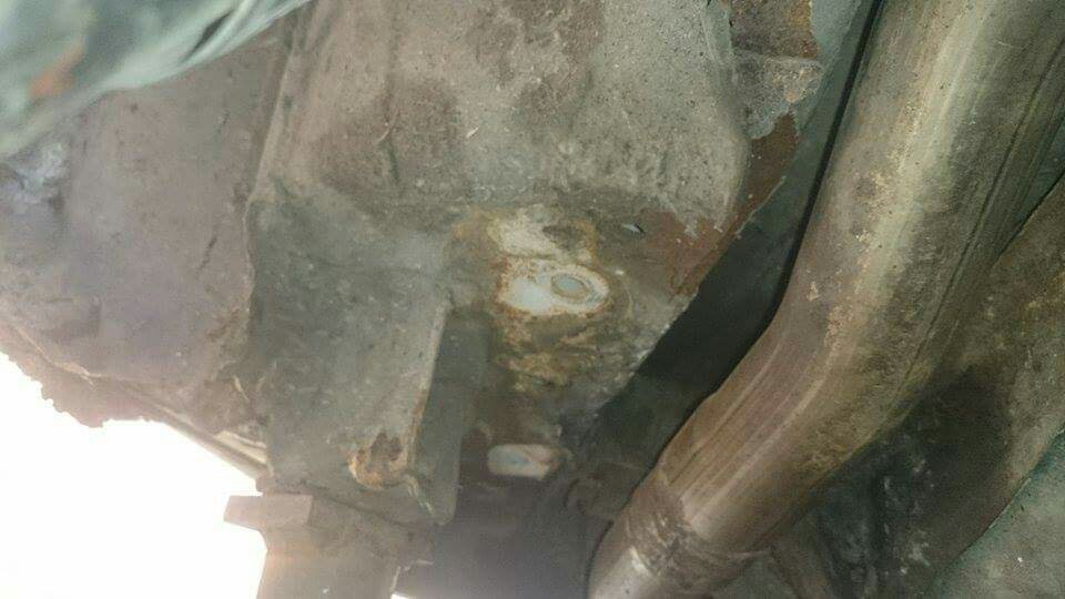

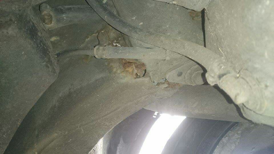

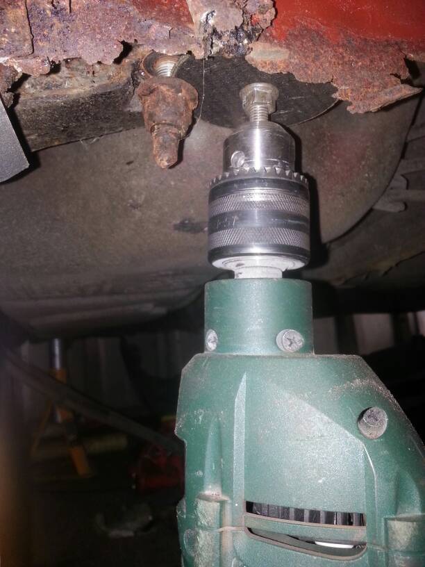

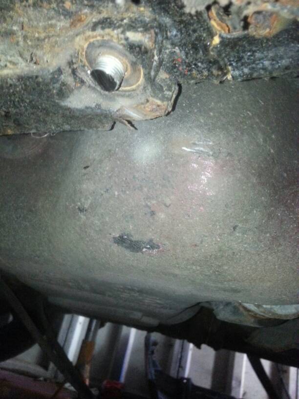

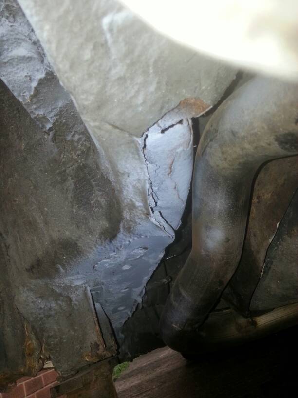

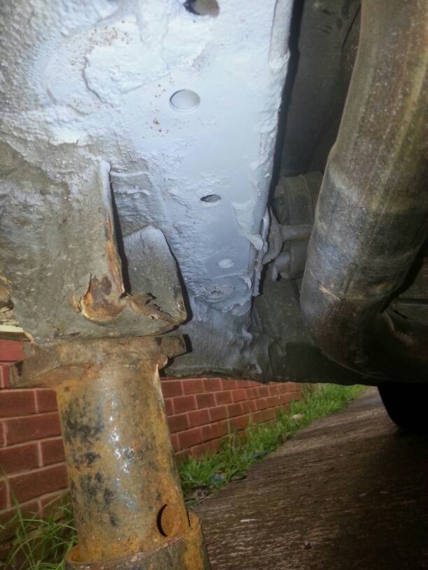

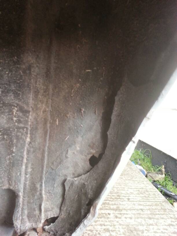

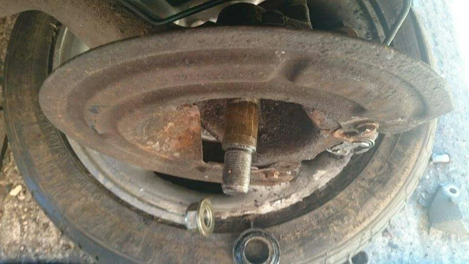

So I thought after I'd removed the rear beam I'd take a look around to see what rust or rot there is, surprisingly it is only rust a lot of it,you can see the rot though which tbh isn't bad at all for a mk1!

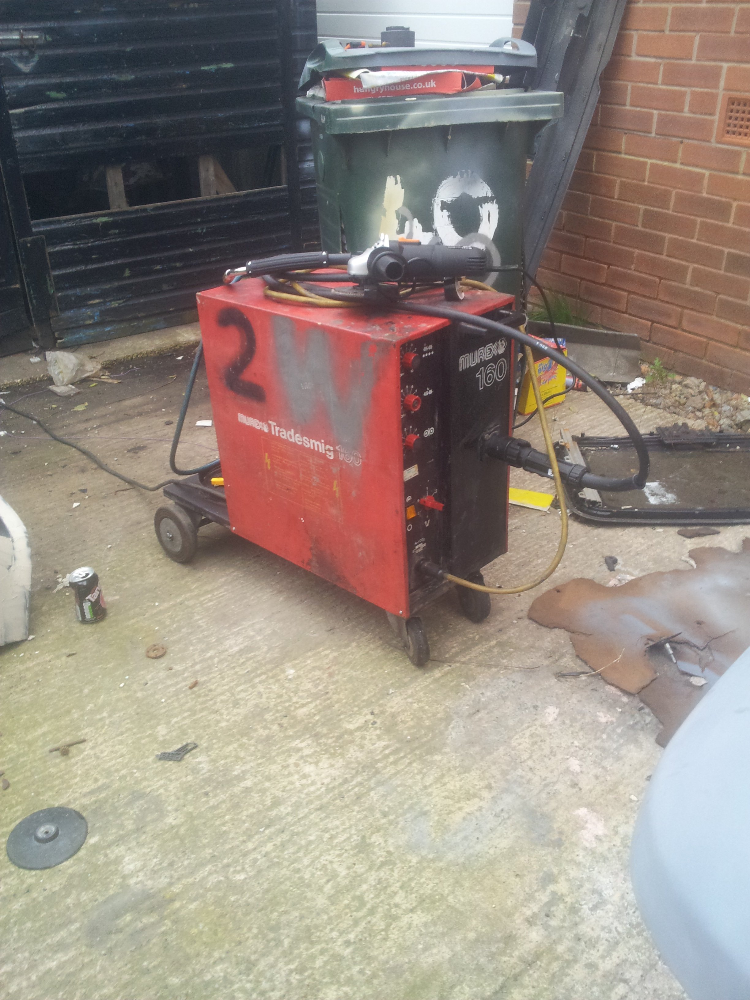

I'm going to be ditching the reserve tank (or at least I think I will be, haven't made my mind up yet)
Proceed to get all the crusty crappy rust off with a wire wheel on my drill ;-) then pit some epoxy on there until I can afford my welder :)
didn't photo all of it but you get the idea, this is the beast of a welder I'm getting

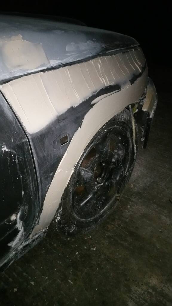

Here's a pic of the f*cked up bodge repair to the sill
Ground through all the filler to find that, can't even call it a weld, it's more like a bead of sh*t! No penetration whatsoever and isn't on both bits of metal.
not flanged, welded or anything, and none of this had any sort of primer on either, hence it rusted, and here's the inner wheel arch repair.........
Anybody want some bondo? About a ton of the stuff? Lol. Can't see why anyone would do this really. Anyway by the by, I'm gonna be doing it all right.

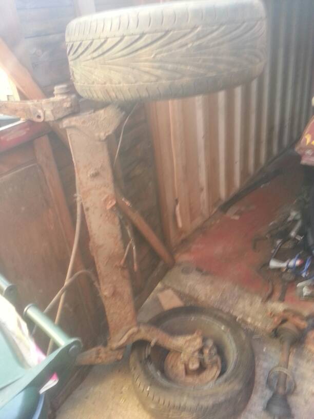

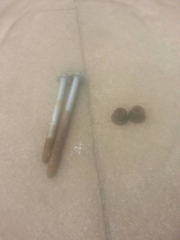

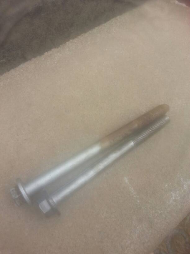

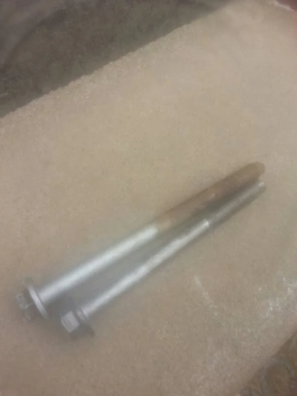

rear beam removed from Naples shell, one of the bolts ceased half way, would tighten or loosen no more so out came the drill, with a homemade grinder attachment :cool:
was daringly close to the fuel tank but no fire wad caused so it all good
and the rear beam is now provisionally fitted to AMF,
NO MORE BENT WHEEL! YAY LOL.

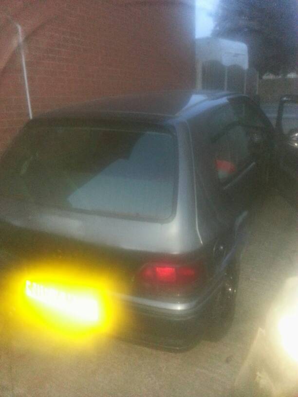

Packed up and left her looking like this
Sheet is my window as french electrics are naff and I can't wind my window up lol.

cleaned with wire wheel on drill again (only photo'd one)

Once I've got all the underseal off I'm pretty sure there's gonna be f*ck loads of rust as the underseal is built up in about 3 layers! Never a good sign.

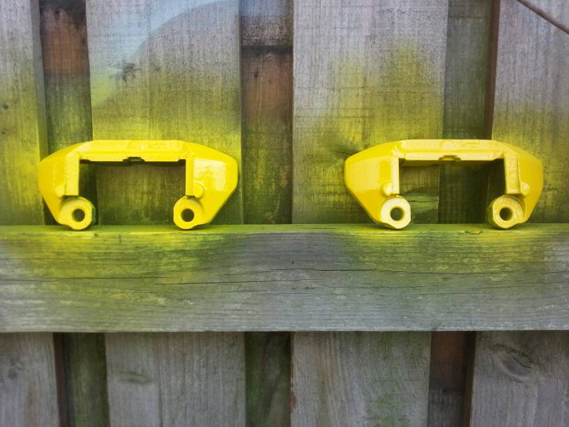

not really done much tbh but I'll share what I have, cleaned these up then primed them up, ready for hammerite.
cleaned a bit.
can find a photo of them in primer but will get one. Also painted my calipers ;)

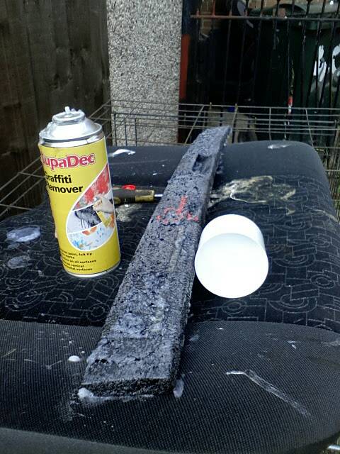

look better in the flesh tbh. Also bought some paint stripper (Supa Dec graffiti remover)
worked mint. Need to buy a few more tins though as the first one leaked out from under the nozzle and I need to do the bumpers etc. More later :)
  X2 Clio Valvers

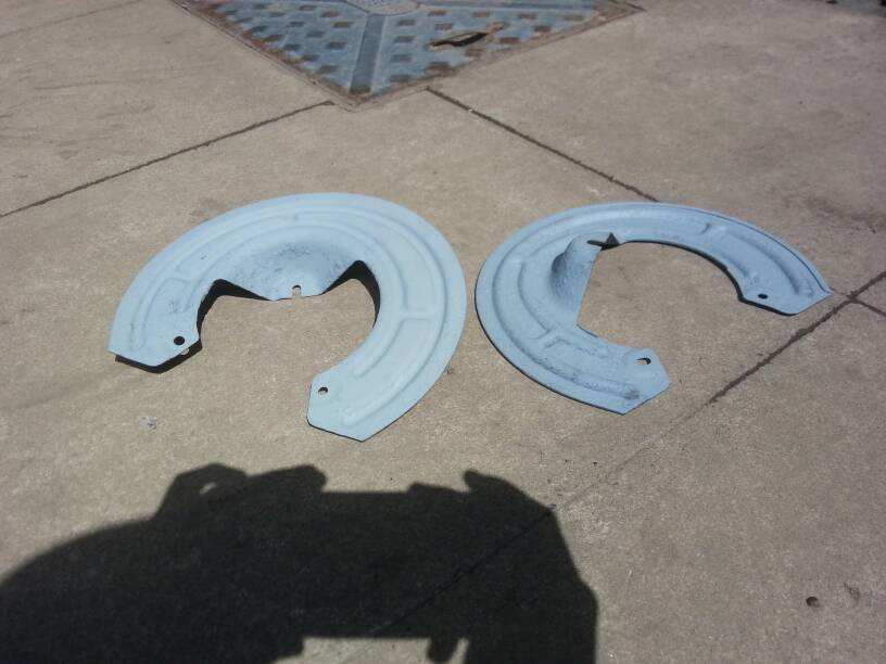

Photo of the brake disc backing plate in primer
Better photo of the carriers
Got the final bit of short shifter kit ready to be fitted when I get a 172 box, going to fit lsd too B-)
I'm also toying with the idea of painting this
already gave it 2 wet coats, but now I'm thinking what would look best? Xerus grey with yellow bits or Xerus grey and orange bits? I know I'll be doing my naples bits yellow but can't decide on this one :/

All I've really don't is ordered this to go with the phase 1 goodies
But as you can probably tell it's smaller than it should be which confused me as it's got a genuine Renault part number on it so I'm guessing it's either not a bonnet badge, it's not really genuine Renault or its not meant for a clio.
I've started stripping the drive train off too as I'm going 172 so she's sat like this at the minute
And I've started drilling spot welds out.

Added this today, apparently they don't fit mk1s
172 pedals. Will also be adding the brake and clutch pedal.
Feels nicer and looks better tbh :)

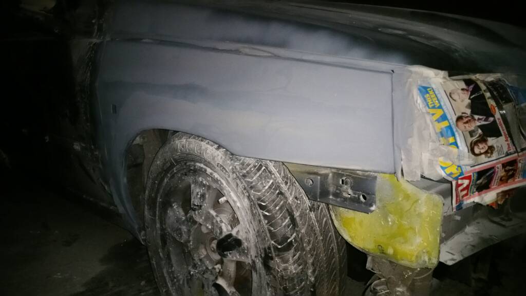

All I've really done is some bondo work. Filled in the holes that held the badges onto the boot (didn't just straight bondo them either, I used JB marine weld stuff that dries like metal and tbh is pretty good stuff!
Doesn't look pretty but had to layer it up and then flatten it with a grinder or file. After it was bondo'd, feathered and primed it looks thusly
Also on the bonnet and wings, either side there was holes where someone must have fitted bonnet pins or something. I did the same to these
didn't photo the other stuff, but used the same method as per the boot.
The OS front wing needed a fair bit of work so it was rubbed down, far enough to see highs and lows then filled and primed
needs another coat of primer yet but it's all flush and once painted you'll never tell it was filled up. I'm basically trying to get as many bits as possible off the list and save the fun part for last.

If you've got the headlining out, I would look at replacing the sunroof rubber / sealing it up / welding a plate over the bloody thing - mine has only ever leaked!

due a bit of an update i think! i now have a mig welder so the good stuff can start soon!
its an old school murex tradesmig 160 made in 1986, bought it not working and fixed it, its now working and welding beautifully. me and my girlfriend are relocating soon and i will be renting a garage/unit to not only carry on with my 2 but to get on the business ladder!
sorry its not much of an update but they will start flowing soon.
